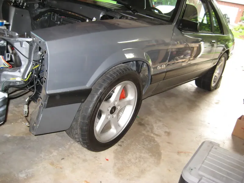

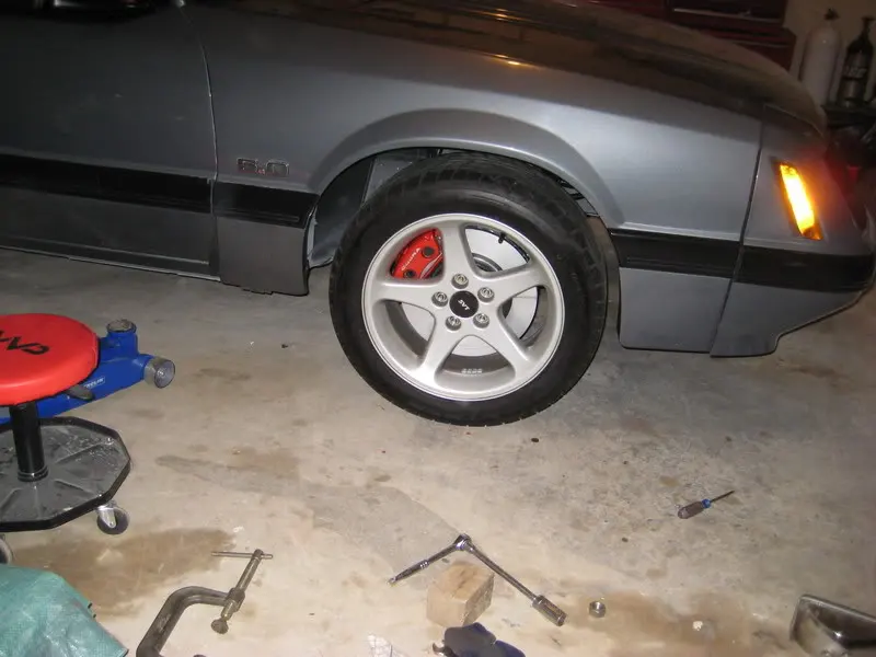

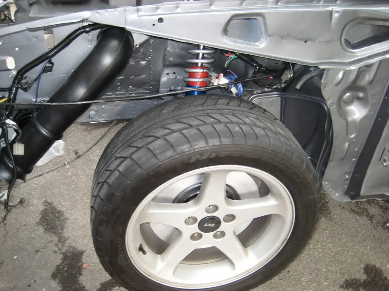

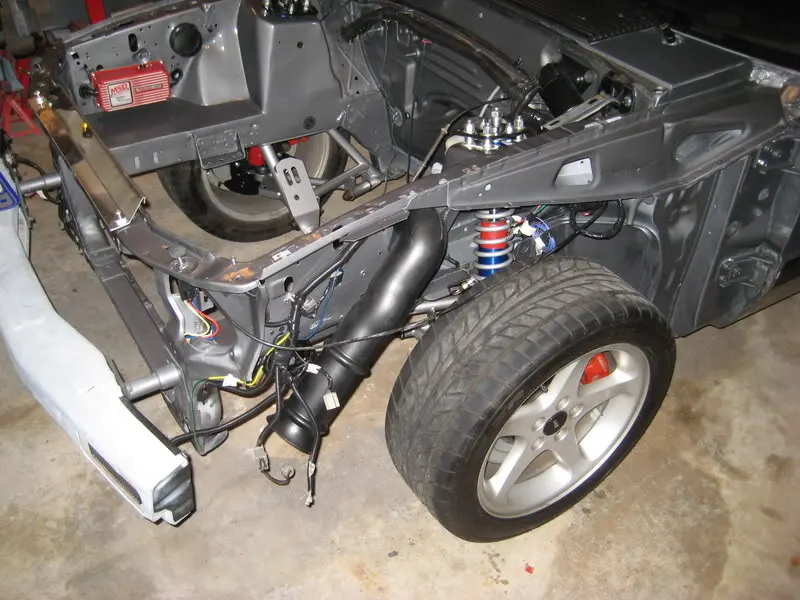

Heres the front of my car (no motor, body panels just sitting there not lined up)
The front is questionable with coilovers. I assume you have 17x8s right now? How much room do you have when the car is compressed? That is the ultimate question. The wheels should sit in a similar location as the ones on there now.
The rears are 18x10 and with fox length axles, rolled lips and no quads they fit perfect on my car!
