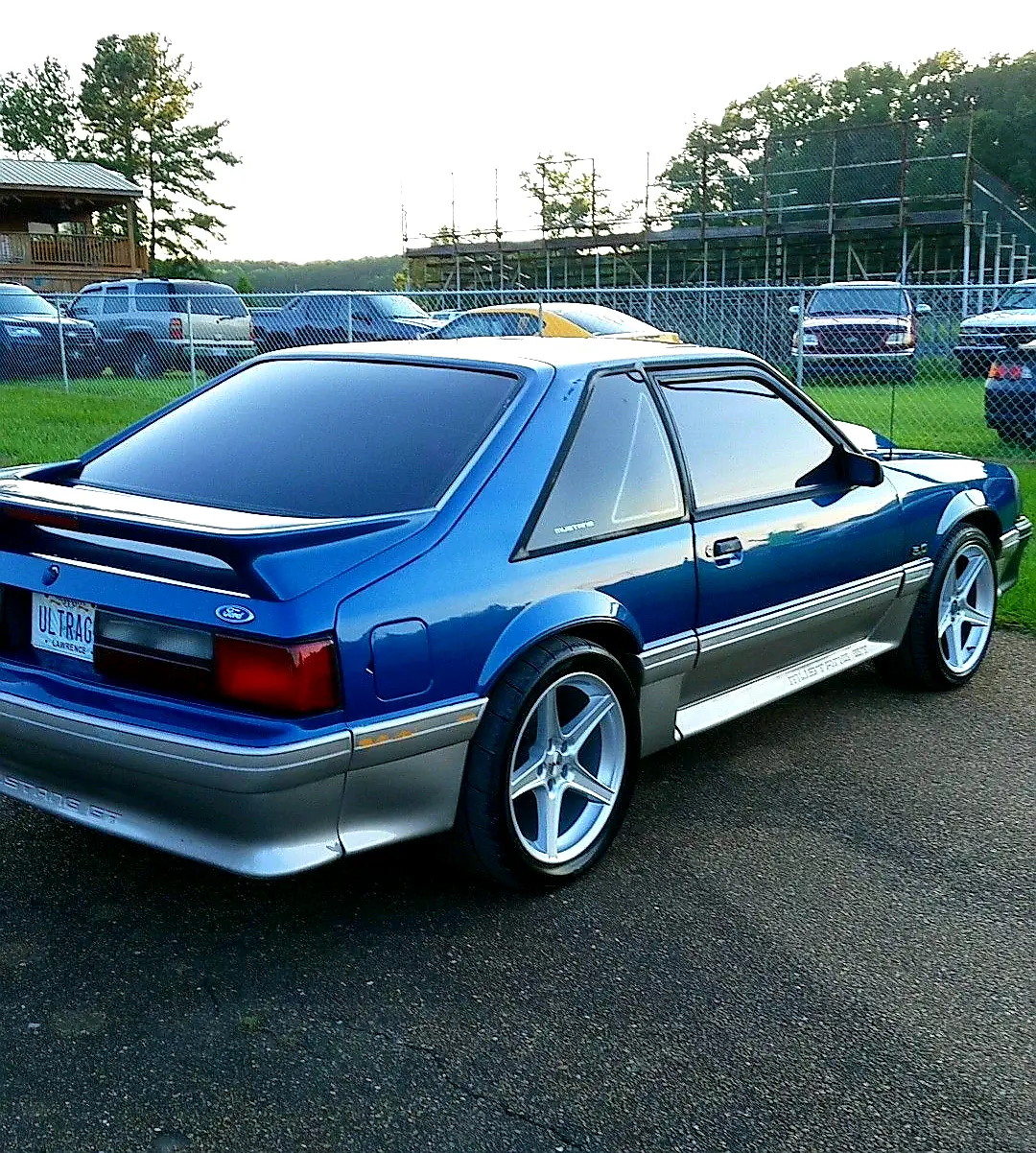

I ran the same as @FastDriver except for 35 series on the rear. No quads. Rolled fender lips. Massaged inner fenders with large hammer years ago for slicks so that was already done. That's the only two things I had to do on the rear. Zero mods up front at that time. The car looked great with that size. Was it a perfect fit with never a rub? No. But it was good.

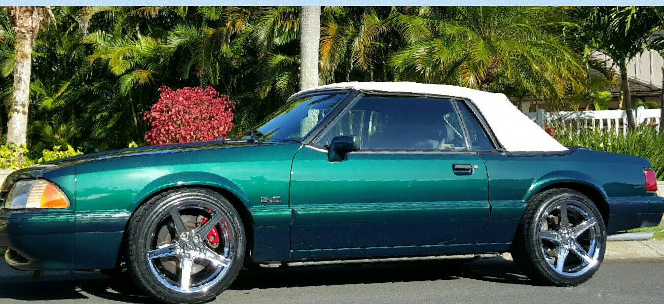

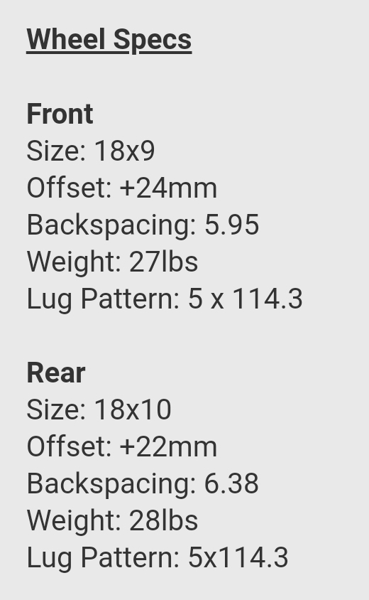

Yes I had 18x9 saleen reps on the front of my 90GT from LMR...245/45/18 tires. Rubbed just a touch at full lock but other than that, no issues....18x10s rear with nitto 555r 305/35/18
