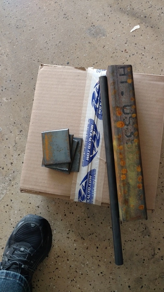

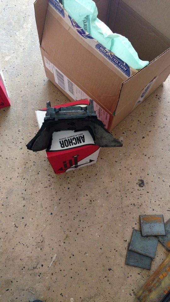

Thought I'd better update again before @RaggedGT gets at me again
The parts man came. While it wasn't anything special, it was a much need piece to my puzzle. Plus, it was the first time I ordered from Rock auto..... I think... Either way it was painless and, even with shipping, cheaper than I can get it local.
Some 302/motor mounts.
And some steel stock
Sad part is I'm busy this weekend so I won't be able to dedicate much time to it aside from thinking about it.
