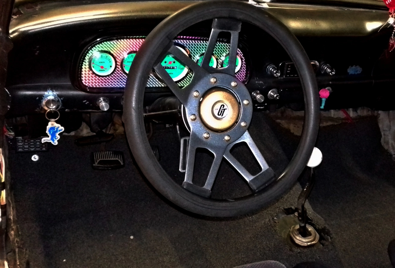

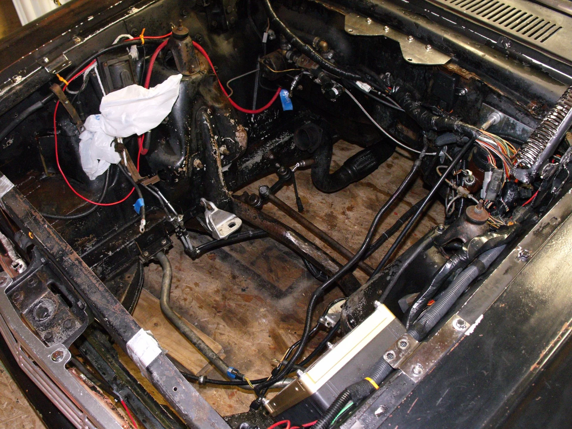

Wires Wires Wires .. All those unsightly wires hanging under the dash...gone. Finished the dash wiring, mostly. I need to do some work on the gauges but for the most part that rat nest is under control. Hanging under the dash IS NOT a sport for those with bad backs! I have to pillow and pad the floor so I can just lay under the dash and work, sure seemed easier when I was a younger man!
I have been keeping and working around the previous owners wiring mess so not to make MORE problems I don't need as the P.O. said that it did run and operate properly at one time. So I worked around his mess keeping it till all the other issues were gone. So that's where we're at, UN doing all those wires and my workarounds. I have to go in again though to replace fried bulbs in the gauges, wire in blinker indicators and a horn. Re wiring this mess I found many issues and fixed many. Now I have a working gas gauge, once it was wired to the resistor which was previously wired to ALL the gauges except the gas. Now the volts read properly but the water temp is still wonky. Before when I had a 190 degree thermostat in the car the gauge read 140 at full heat. Thinking it was a 140 thermostat I replaced it with a 180 degree stat. That brought the gauge to 120! So thought must be because it was wired to the resistor, so I removed it. No change just gets there faster. The resister makes the ford gauges move slower not to slam to position.

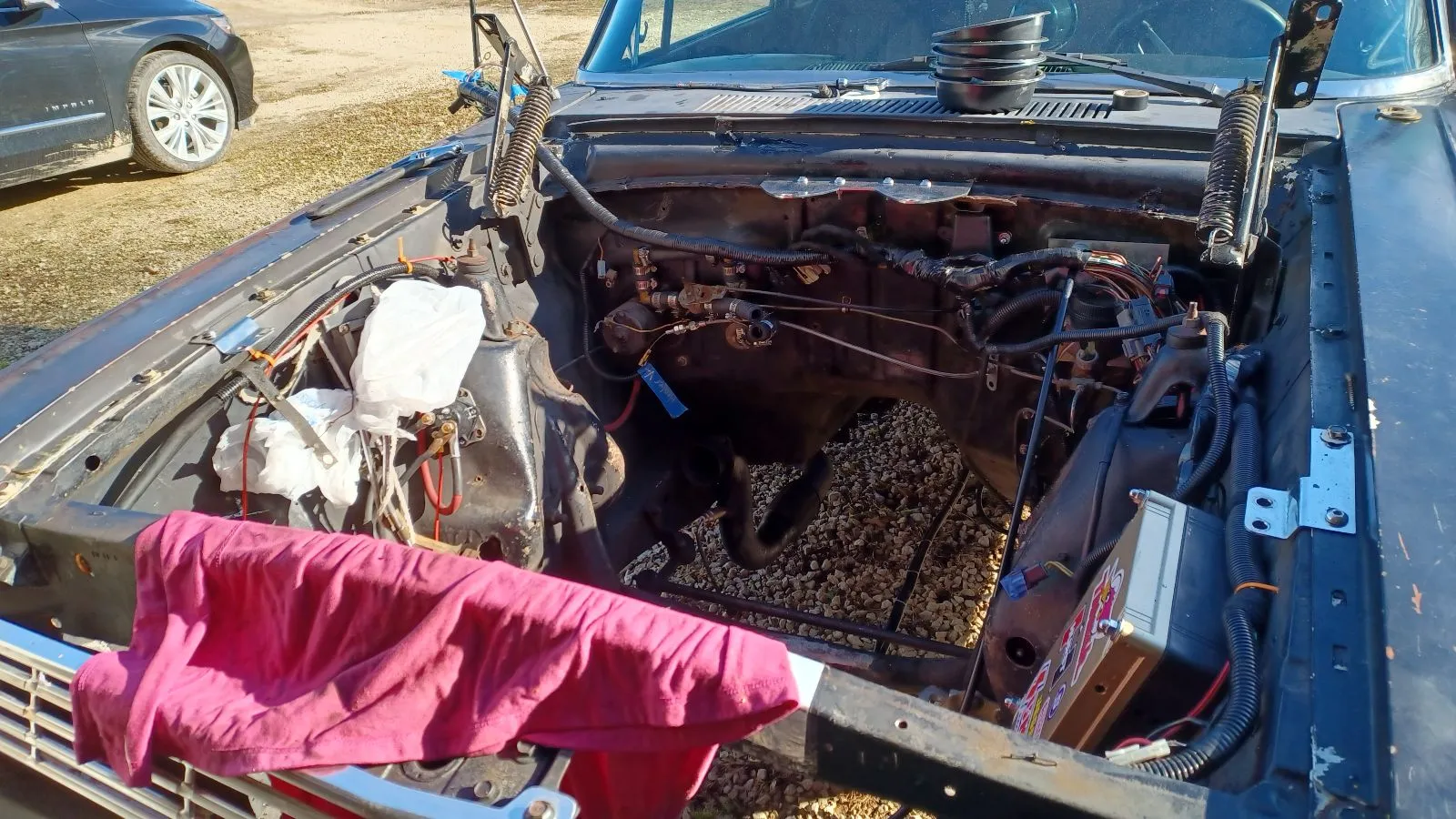

OK so here we are on the other side of things. Didn't know right where to begin on this project so I just drained fluids. Then they were done so I started takin stuff off. One thing after another. Thats where I am at now is taking stuff off. This whole endeaver will take longer than usual due to so many breaks. I worry about taking on a rebuild as its a big deal, for me mainly physically. I question if I will be able to follow through and finish it? I decided as long as I treat every part as an individual job with its own steps I can move towards the final goal of engine removal a little at a time. Just gonna take a bit longer. So if you dont see no posts it must mean I'm slackin! Better gimmie some ...crap to lite a fire under my ass for me!

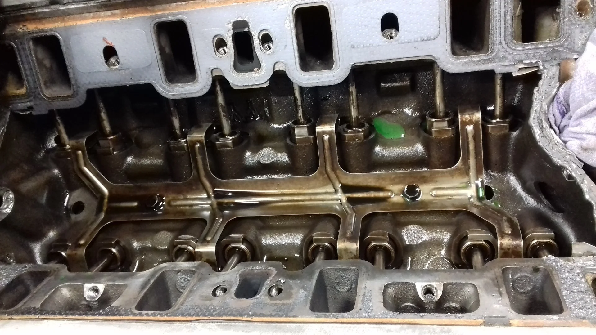

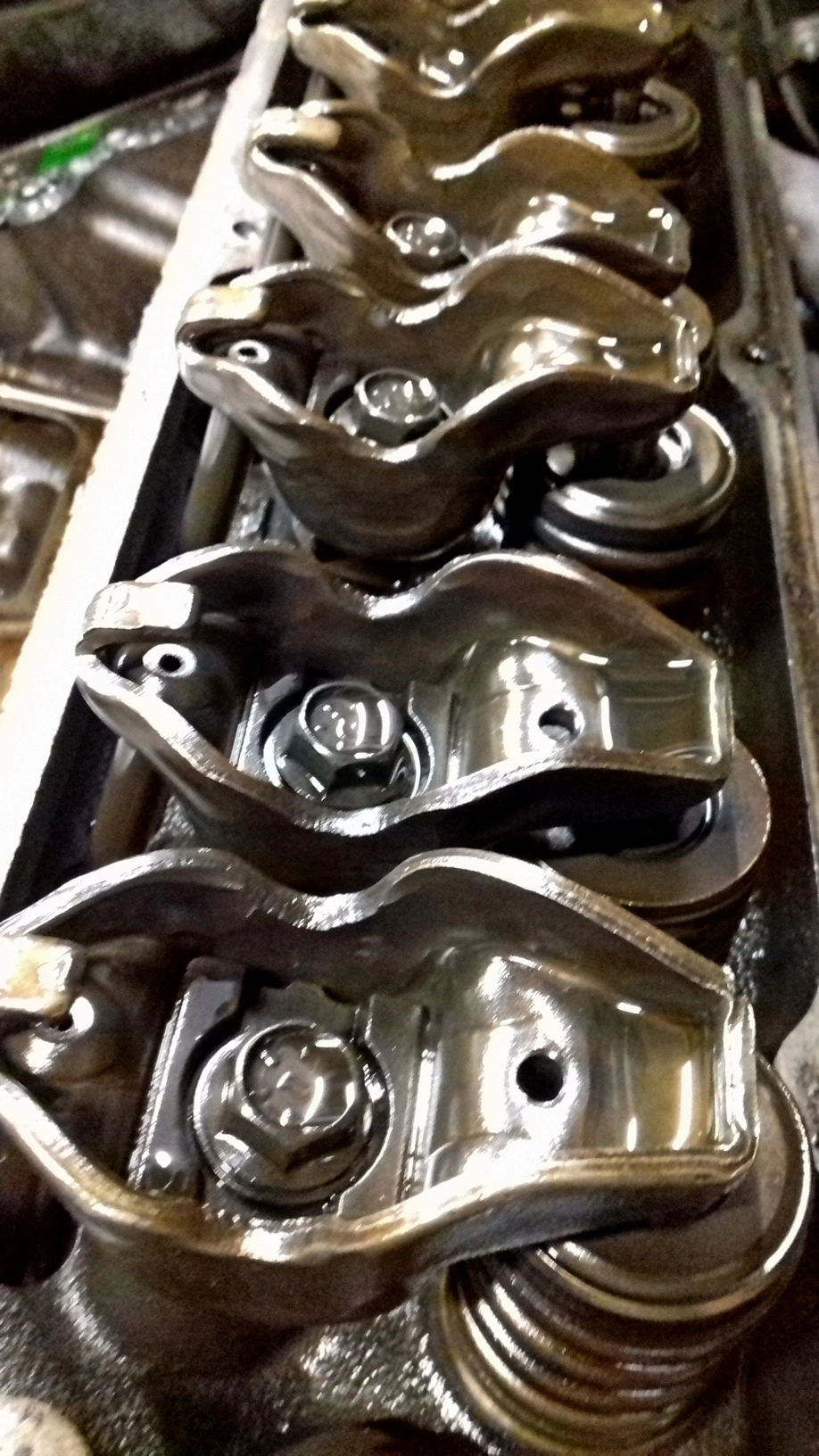

First is the inspection phase Break it all down to decide the main over all plan. Don't cost to find out where I sit. Maybe it's not so bad after all. I did get to remove the intake and under there and in the rocker areas, there are no sign of foreign baddies looking to reek havoc in my engine!
Everything seems good so far. One thing about having recently redone the top end is not only is it easy to take apart but you can check your sealing techniques and how well they held!

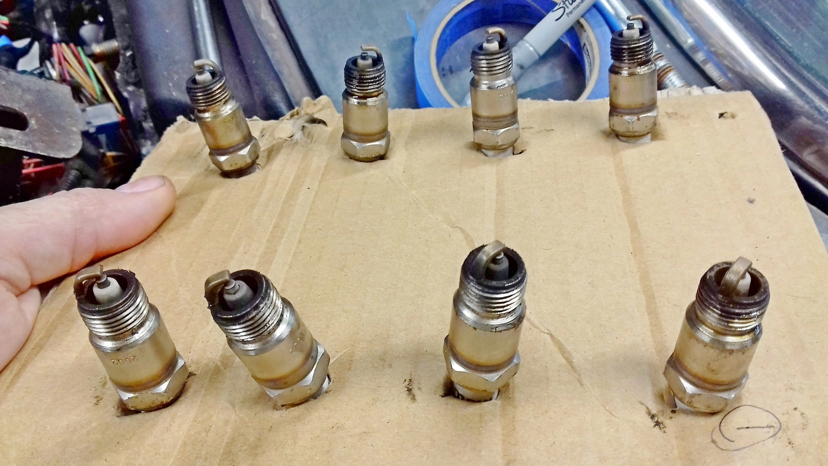

Number 1 down there to your right. I tell ya they look great! At first run they were all black n sooty now after gettin it sorted they got a nice tan goin on!

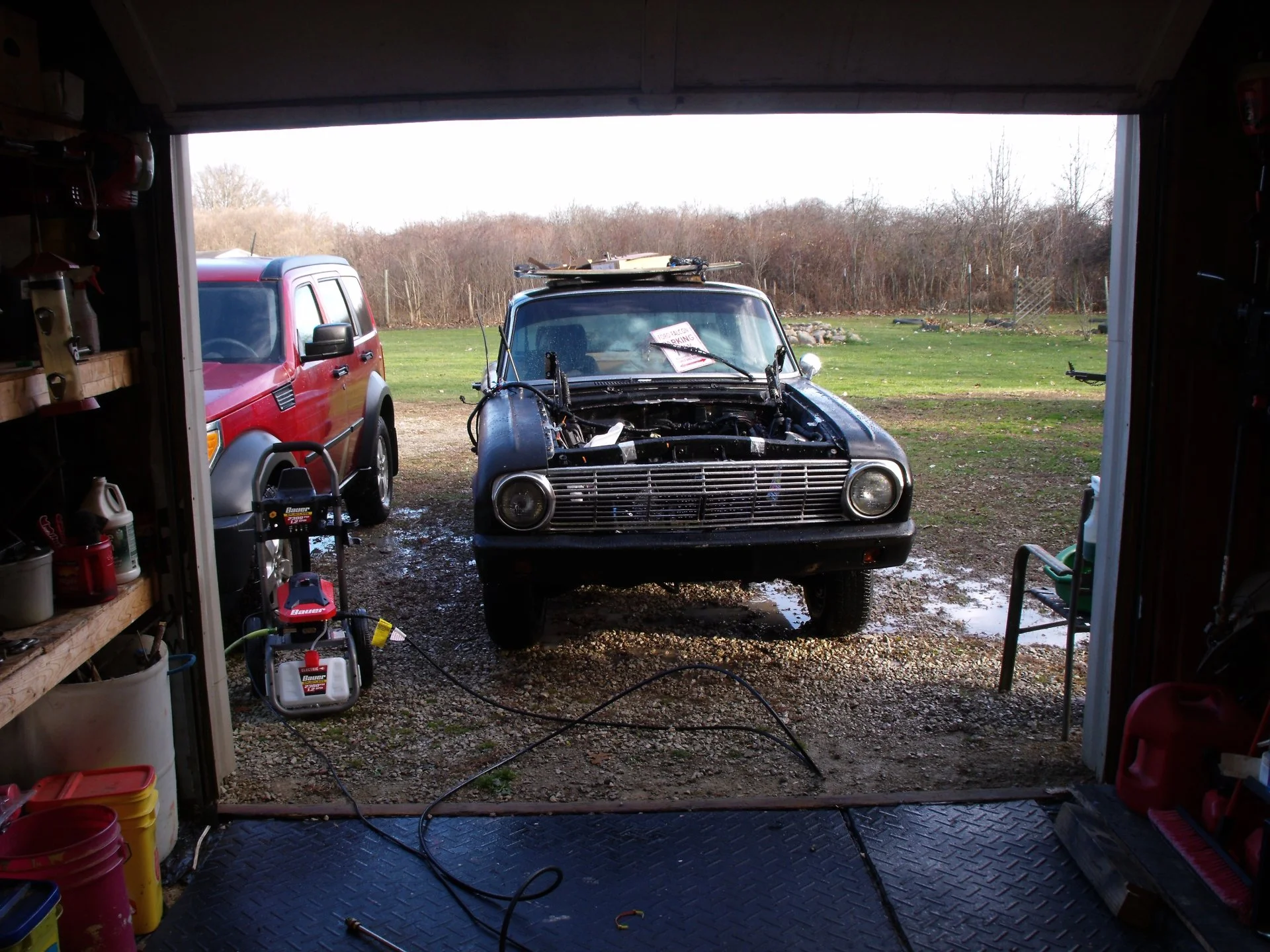

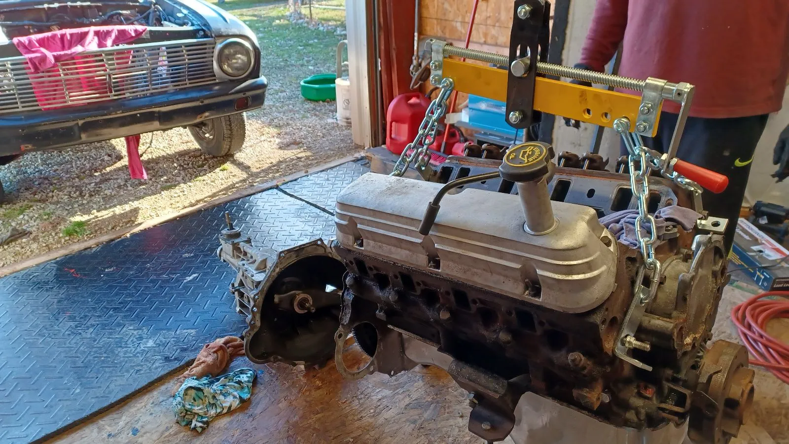

My wife and got up early this morning got morning things wrapped up pretty quick, as far as the cofee drinkin and stuff. Put on our warm clothes, here it is 41degrees, went to open the garage, set the car up AND had the engine out in 2 anda half hours! Went smooth. So much easier with a cherry picker and stand than as a kid using a swing set with rebar shoved through it to stop it from totally bending in half! My last engine was a 69 283 small block chevy. I popped up the compression and a 3/4 cam put the engine in a 82 camaro. That car was done in 86. The back seat was ALL speaker box! ALL the best music in those days!
Thank You wife, for your help, She gets credit for being the muscle, the strong arm!
Soon I'll get it cracked open and see whats goin on. Now it can get power washed before the freeze sets in. Then I'll be back on schedule minus engine. Back to getting the floors done was the plan for winter. The engine has a deadline of spring, that should be fine. Time to get funds and tools and stuff.

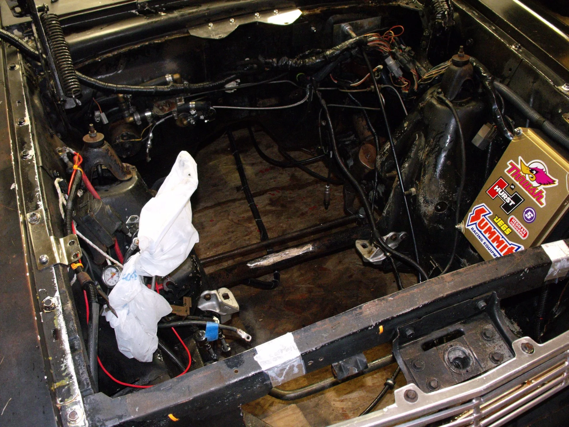

Dirty Pictures Here!

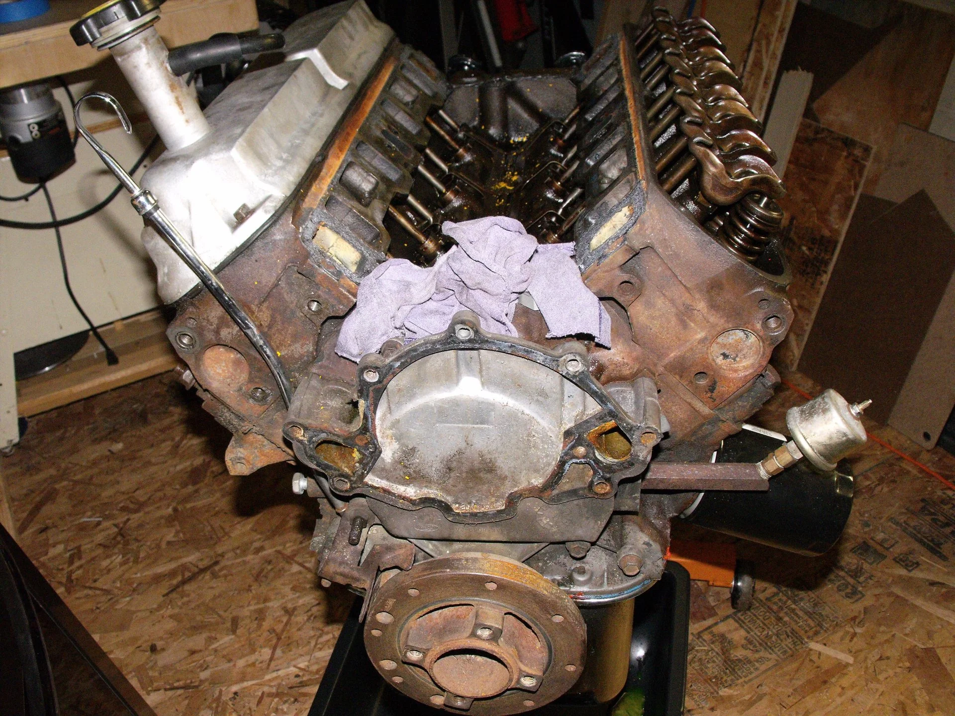

The rocker cover gaskets don't seem to have ever been changed! They are hard as a rock and VERY brittle. Not much sealing action going on there.
Rear main is probably hard as a rock too!

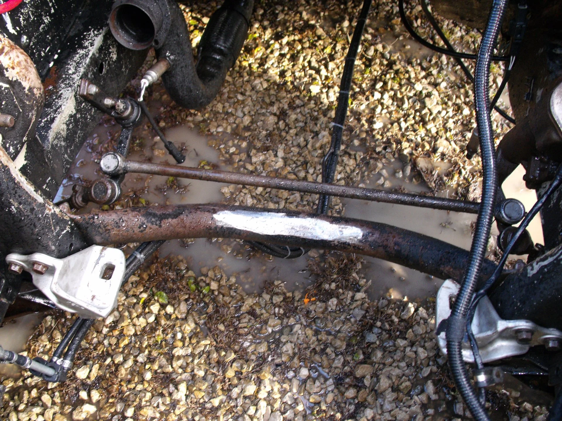

I have taken advantage of the warmer weather and decided to powerwash the engine bay. At this point I consider to be ahead of schedule! Now while engine work is being done I can get engine bay cleaned and painted.

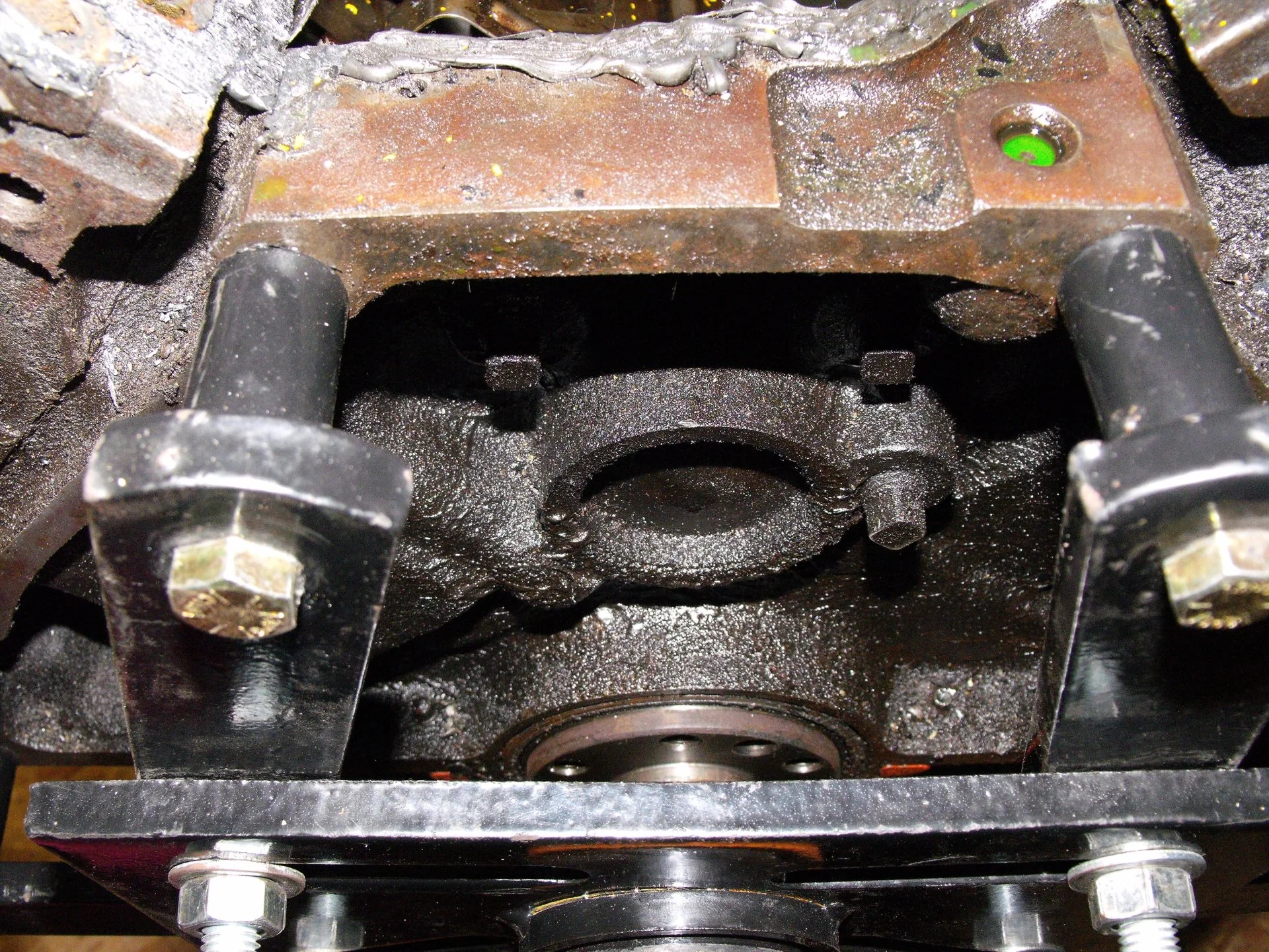

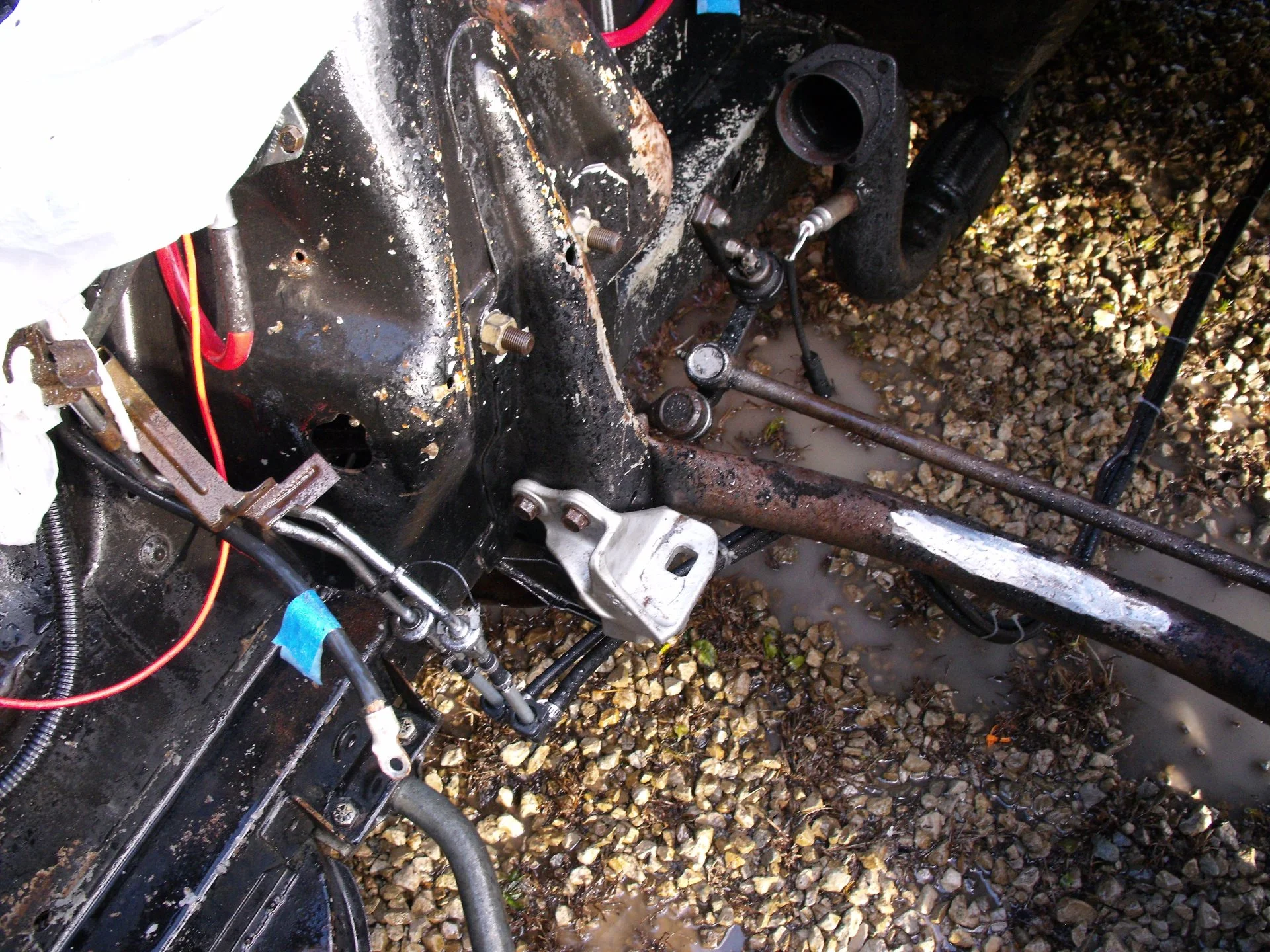

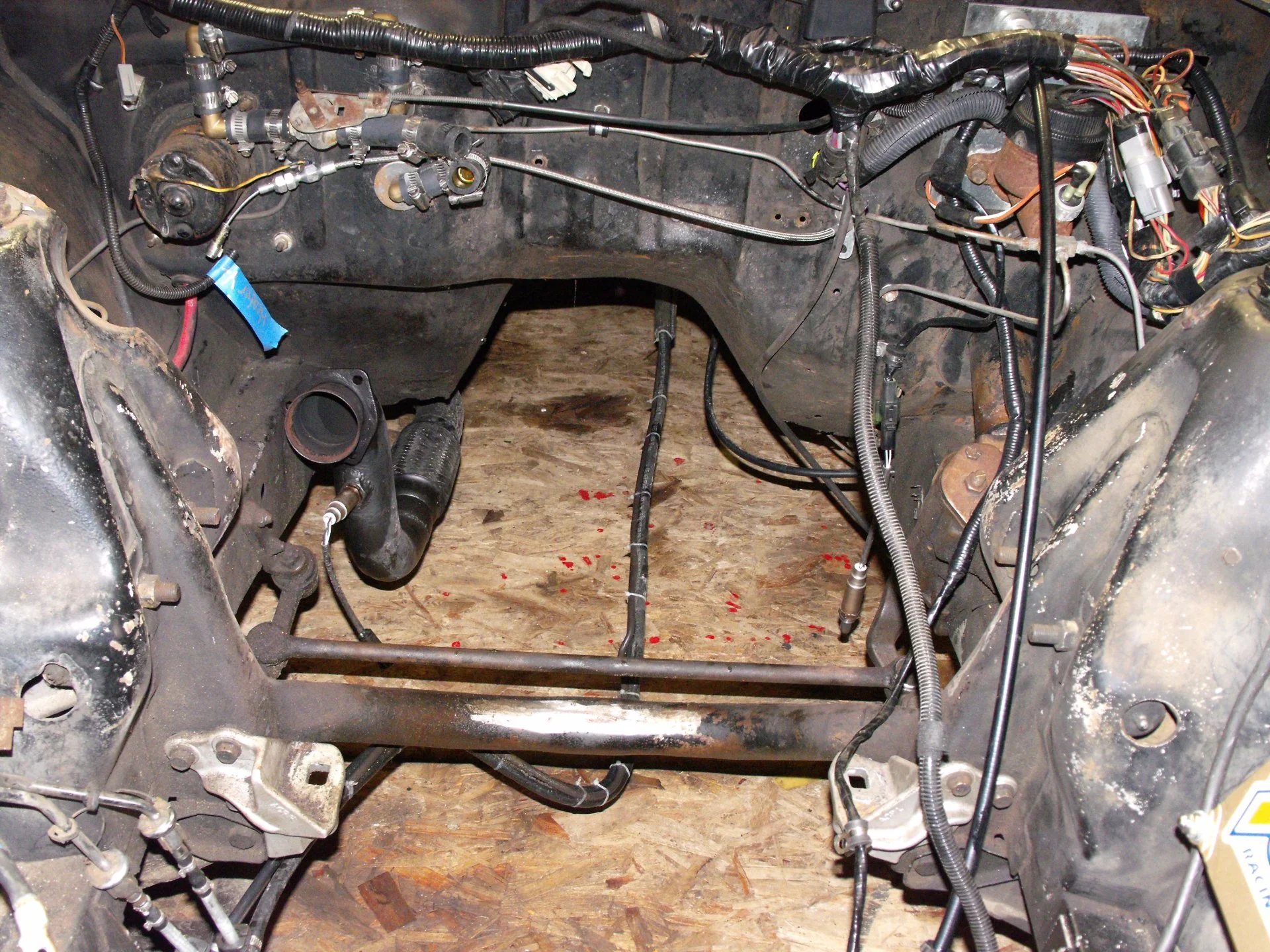

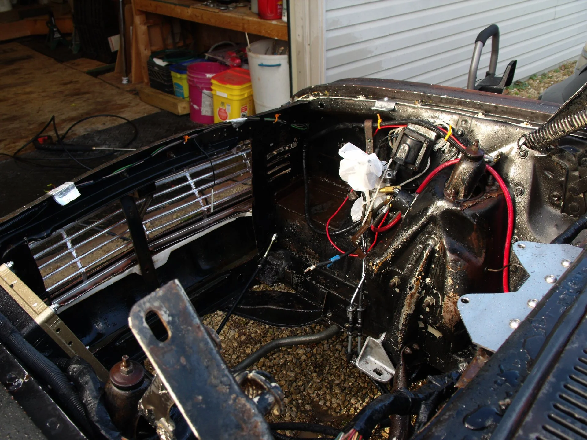

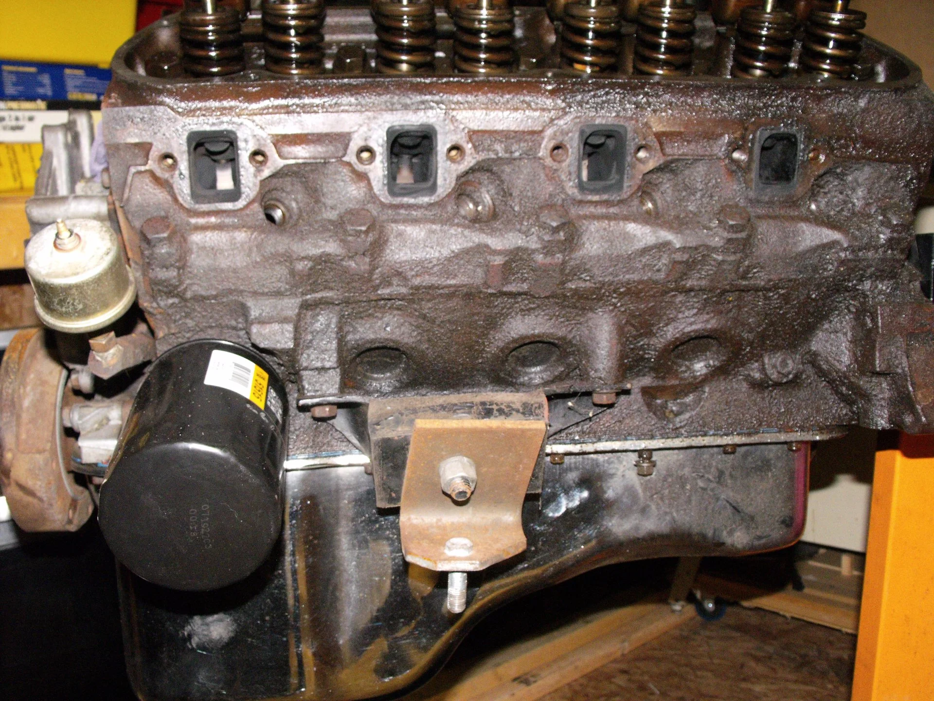

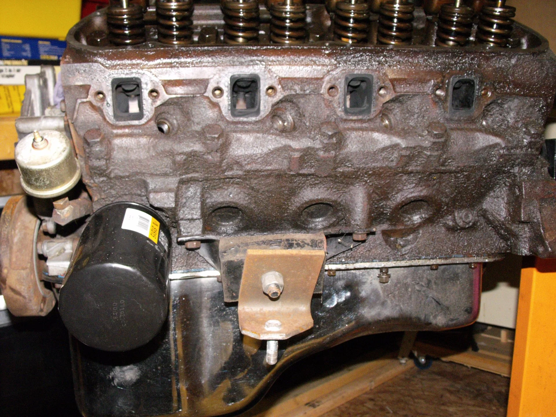

Anybody know anything about those mounts? Square hole? Is there supposed to be a square slug with a hole there? How it was is 2 grade 8 washers were slotted to slide in after installed. To provide room for the oil pan I'm guessing. Mostly due to the fancy relief job on the cross member I deduce this. When it was in the car I noticed the oil pan clearance issue. I was concerned the engine was sitting on the member and was able to slide a piece of paper between the two! Close tolerance here! Notice the lack of grime!

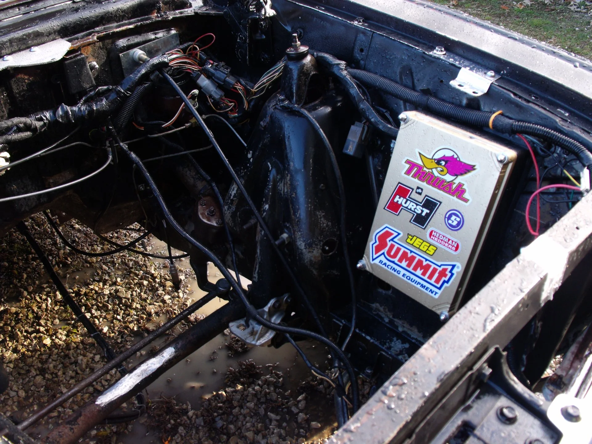

The Afterbath!
All washed and drying. Dried with a reef blower and towels. I do plan on attacking those wires. Would like to move the brains inside and wires. Debating whether to do it now or leave as is cuz I know it works, to minimize any issues later... Need to do a little grinding and welding before I paint. I hope to get to that before the weather takes a turn which WILL be soon. Then the rest are inside jobs. For that area that is. I do hope to have the floor cut and ready to weld for when Indian summer gets here (knock on simulated wood). I don't like to weld inside. I was in a house fire at 25, I have this thing about stuff burning after that. Or more so after the grafts and whatnot. So to sleep at night I only do that stuff outside.

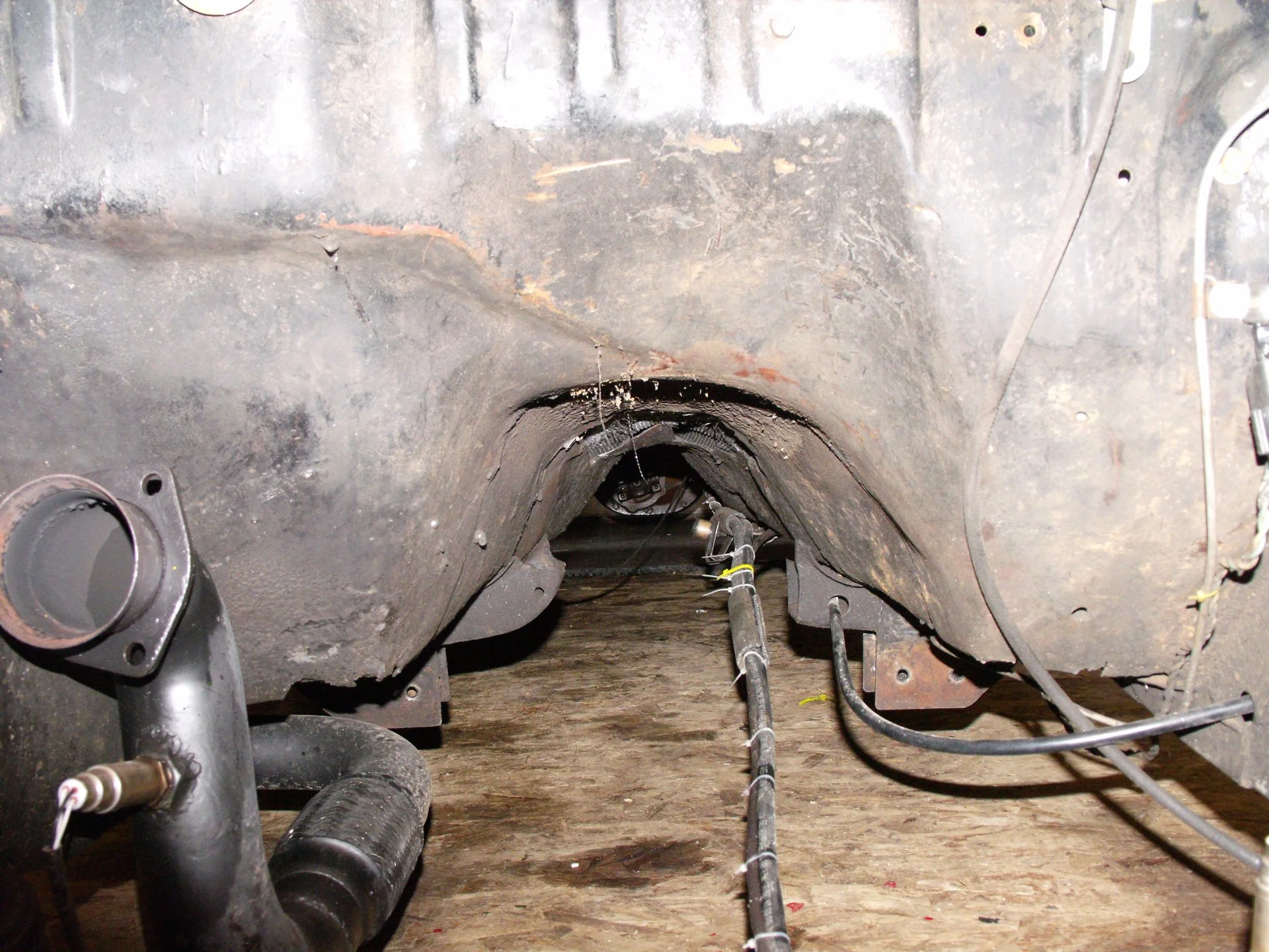

Next - Did you notice...the blob?
If I remember right there were three bolt on mount stands for that unit body dog house, SB V8, BB V8 and a I6. The BB V8 stand was 67 up (I think). There may have been a different motor mount (engine to stand) for the convertible V8, too long ago to remember for sure.
@horse sence may chime in for clarification.
Reactions: slipkid269
I have found the mounts. There ACP Cast Iron. Going around $150.00!.I have found them singular and in kit with the engine mount too. They ALL have the square hole and no slug or whatever that makes it round and fit the bolt better. So I don't think its an issue.
Classic Industries - Amazon - I went to ACP Website but I think I broke it....
