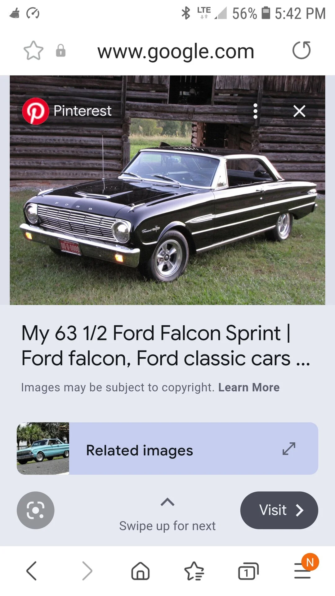

I'm gonna put out there that I think many many people on the internet of falcons are lazy about the difference of 63 and 63 1/2. The roofline is different. The 63 1/2 has an open window design where the window frame is part of the glass going up and down. Theres a better name for it escapes me. My window has no signs of chrome trim around that area nor does it go down. But they do work! They were hidden under leopard spotted panels that covered them up. Also they don't look stripped....I do like those style windows, but I do love my ugly little car.
As far as I know the 63 1/2 thing on the Falcons is myth. They simply used the round 62 roof on the 63 non futuras until they ran out mid year then switched to the square roof. All futuras and Sprints got the squarish Futura roof from the beginning of the 63 model year. Different plants ran out at different times. The hardtops got different windows and associated parts. I'm not sure if the glass was different between the std and the Futura.
