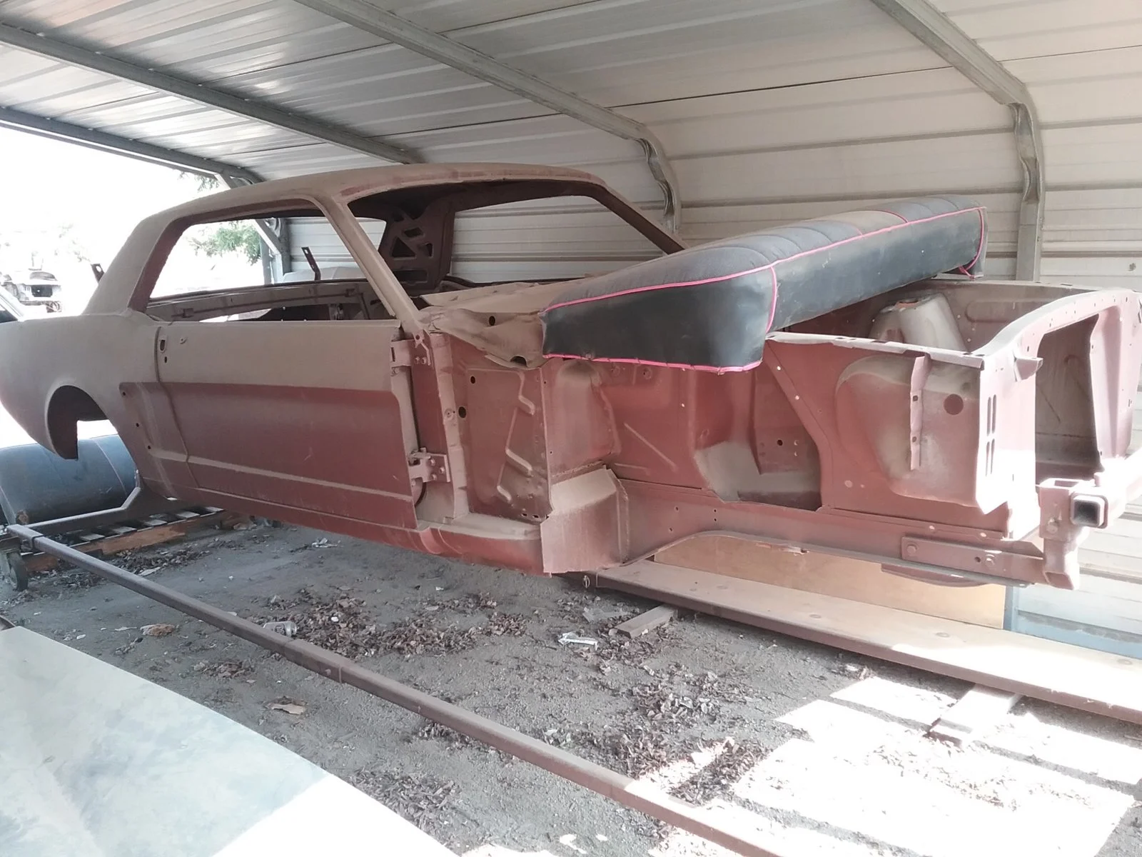

This is my own personal 65 T code coupe ,it has been setting on the rotisserie for about 5 years now ,time for a fast back conversion . This one will take me a while because i have to finish up some work first.

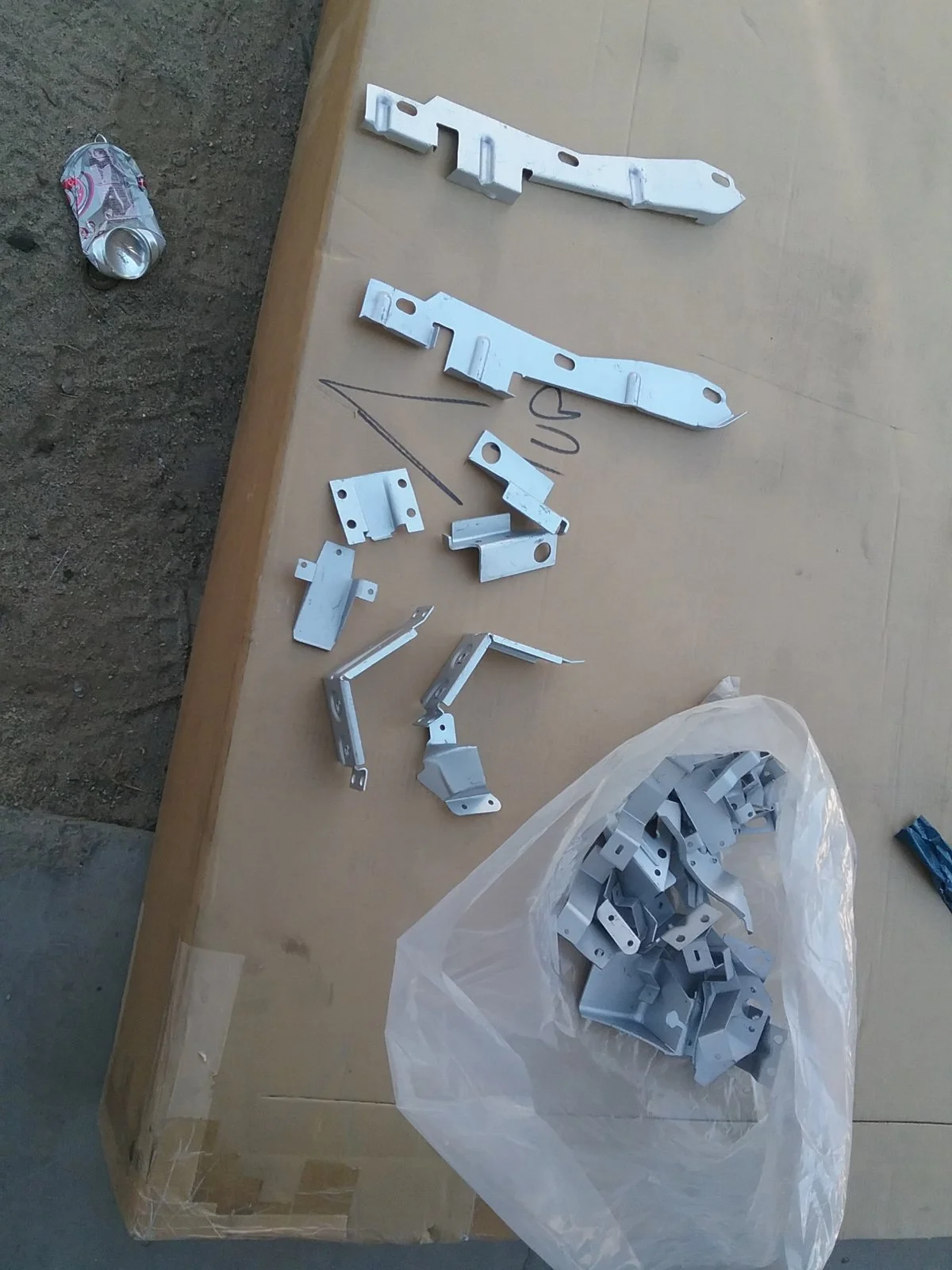

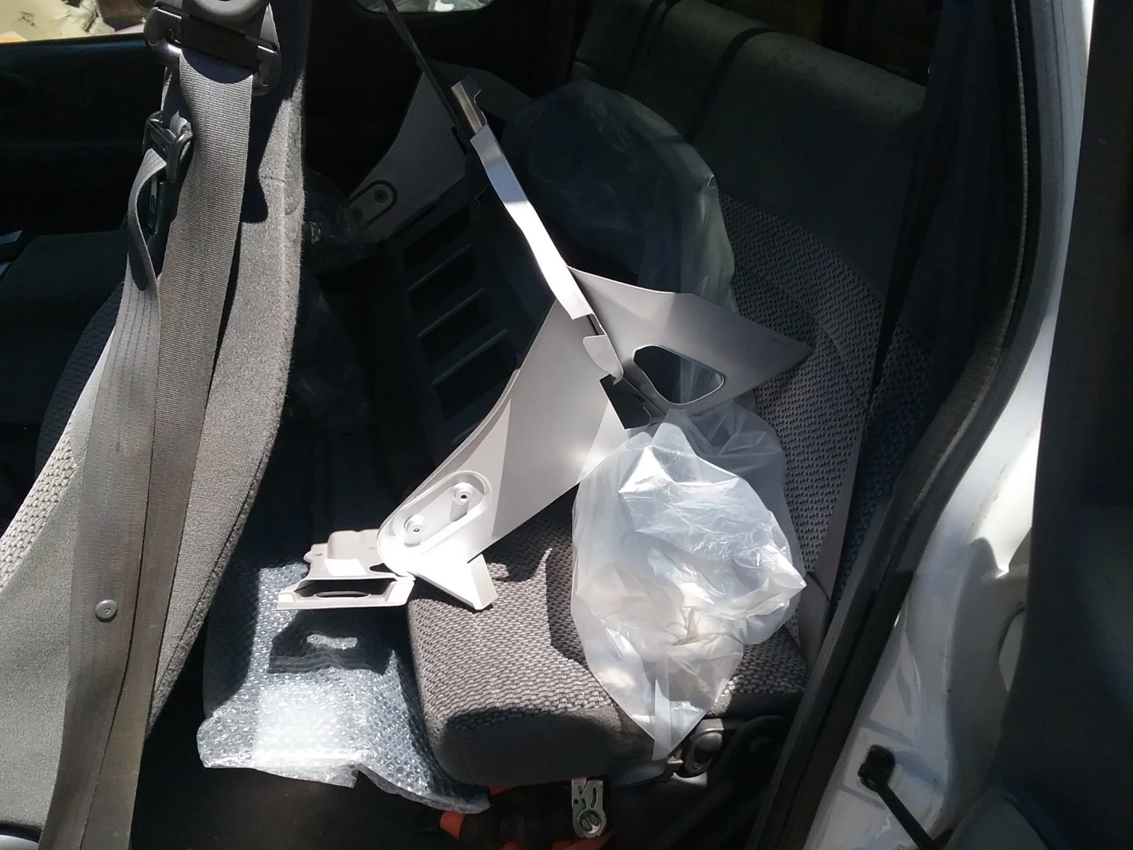

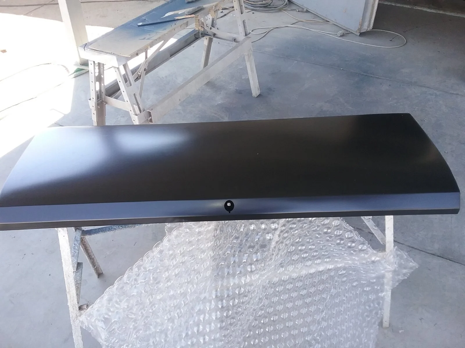

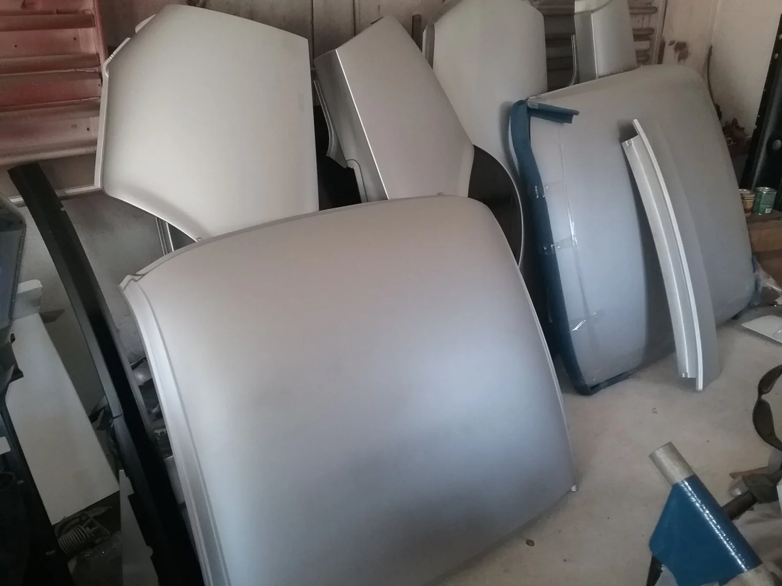

I ordered the sheet metal today and it should be here sometime next week . Sheet metal went up ,going to be around $4500 this time ,but there is more parts available than before so that added to it some . First thing will be to get it down off the rotisserie ,then start cutting it apart

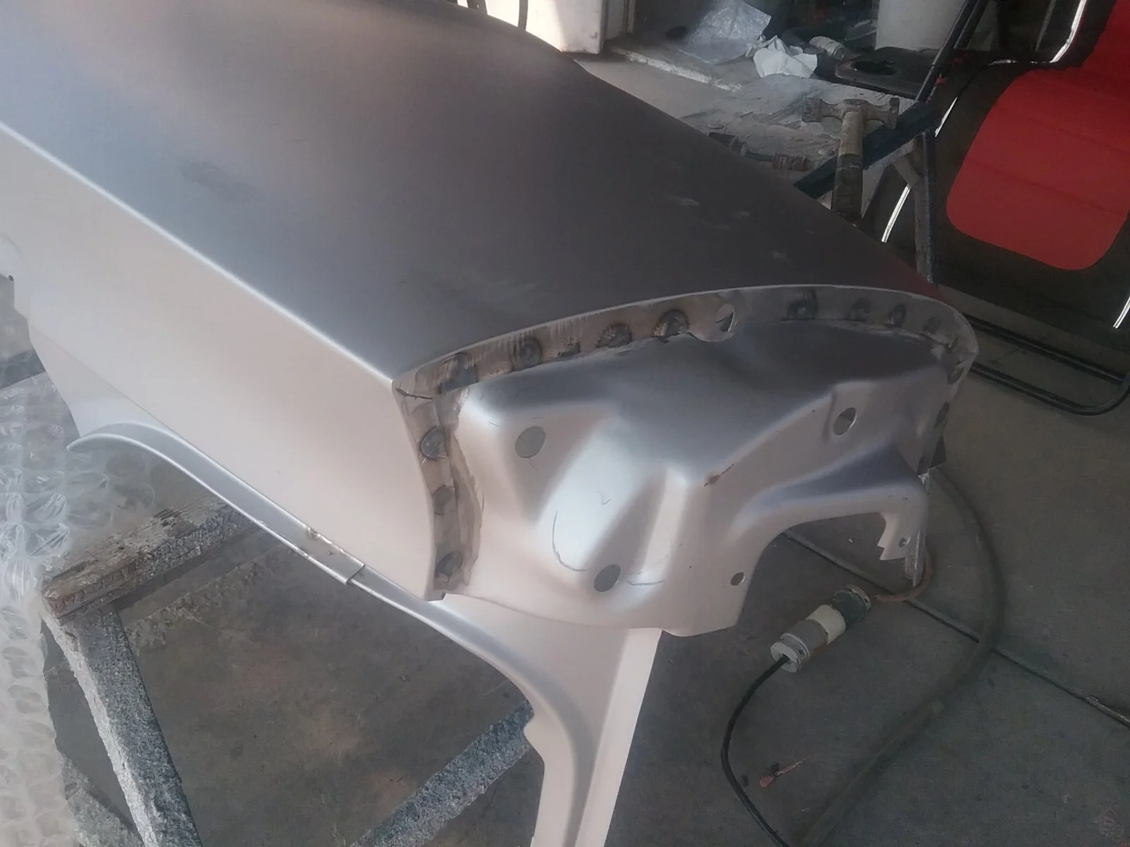

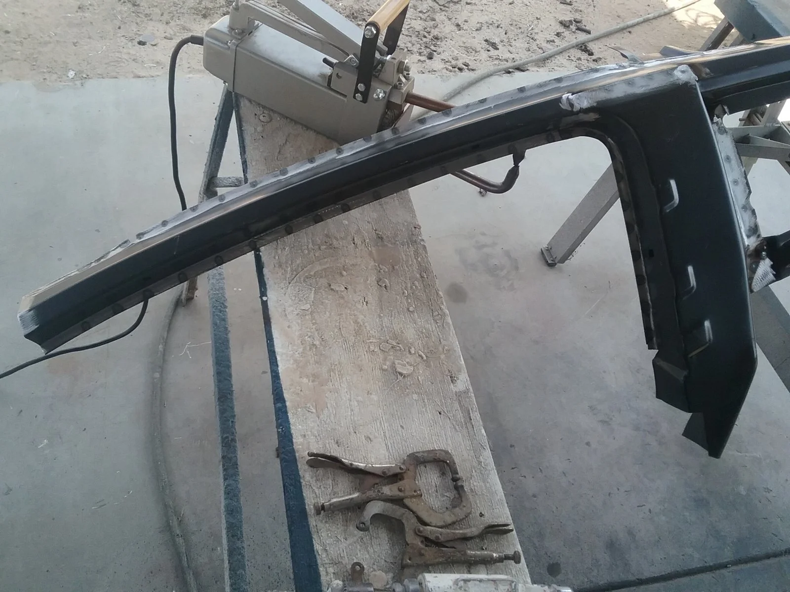

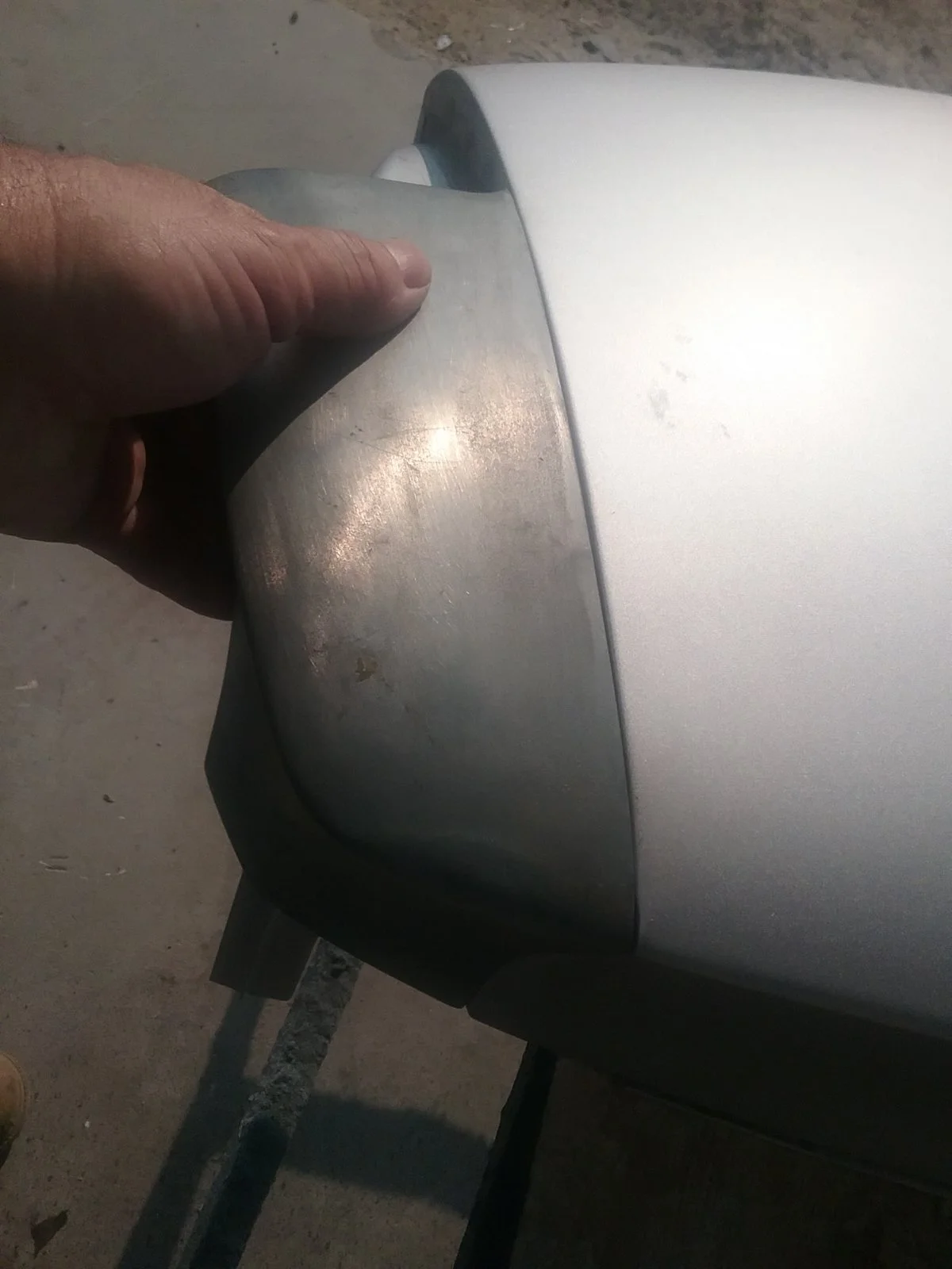

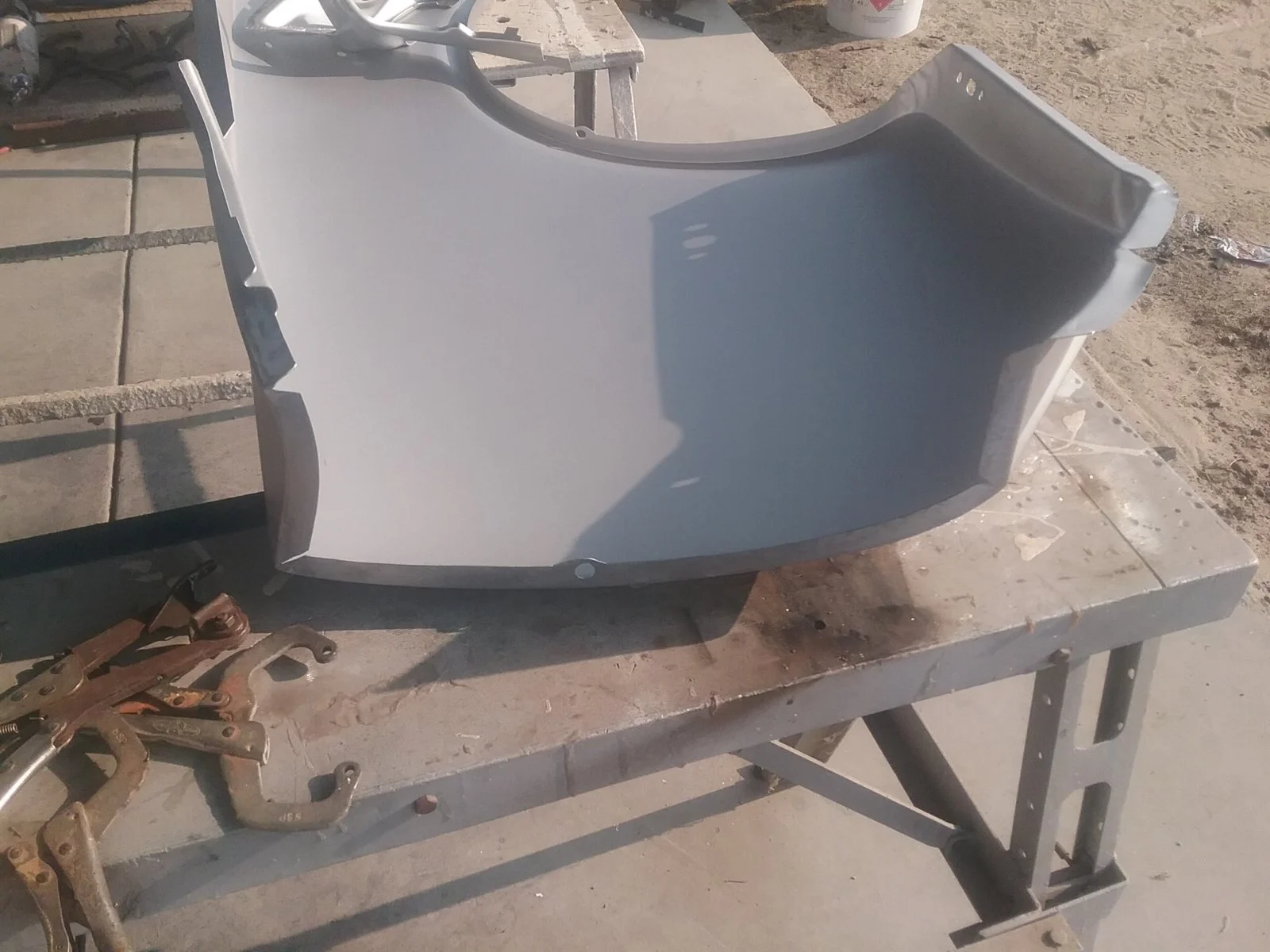

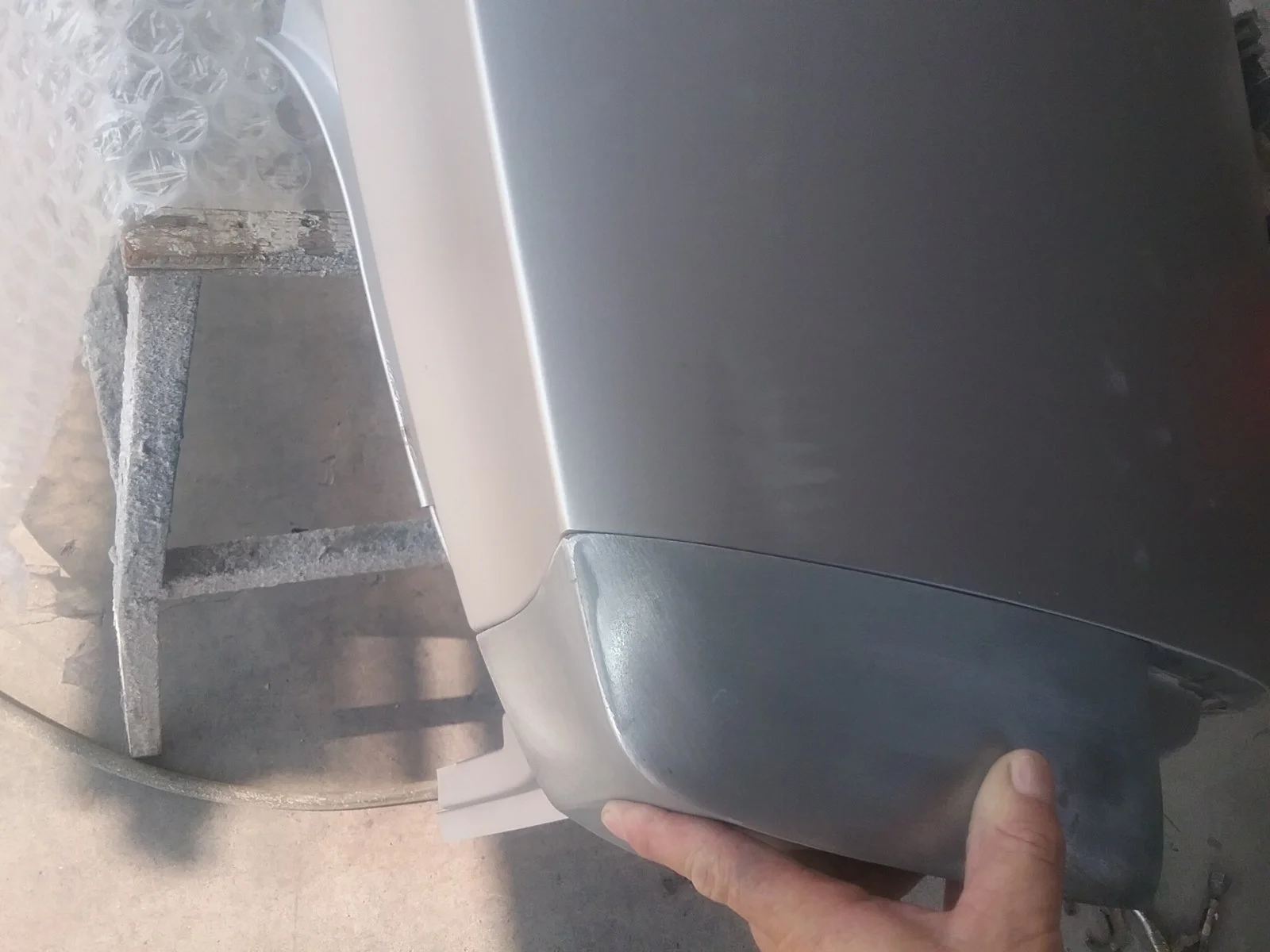

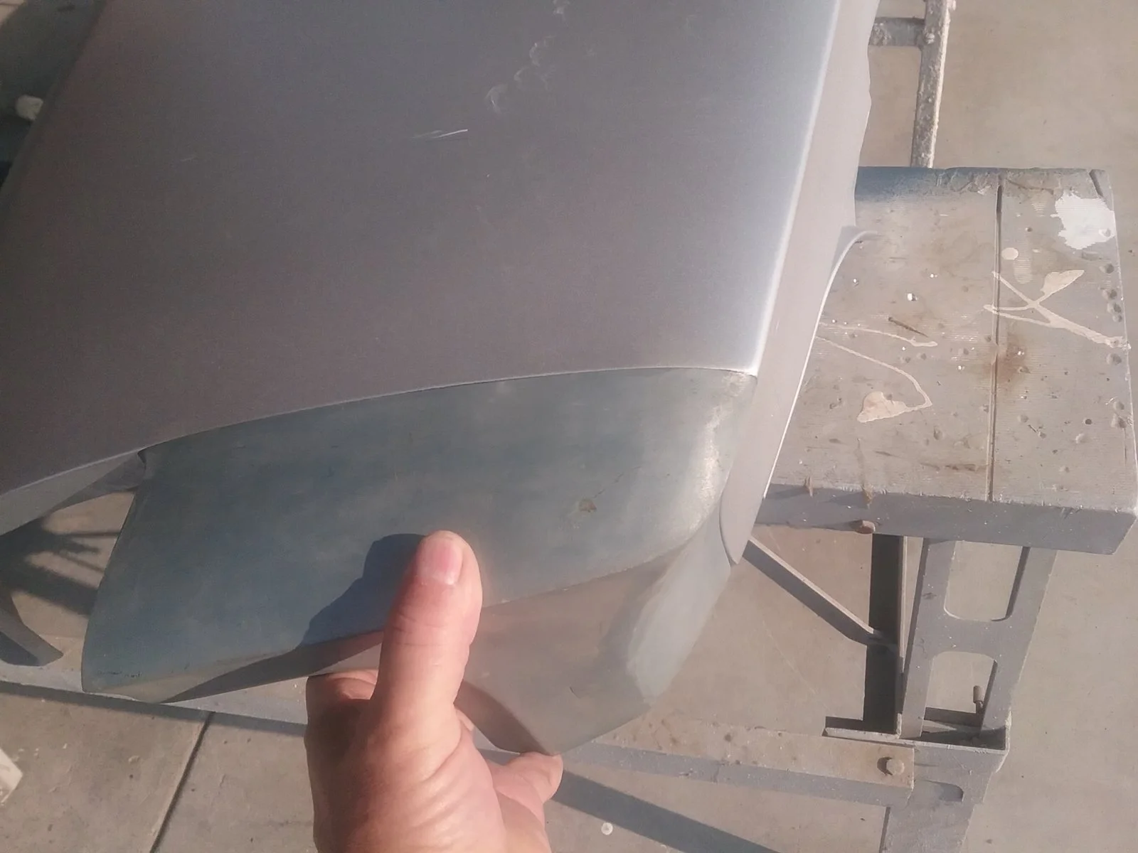

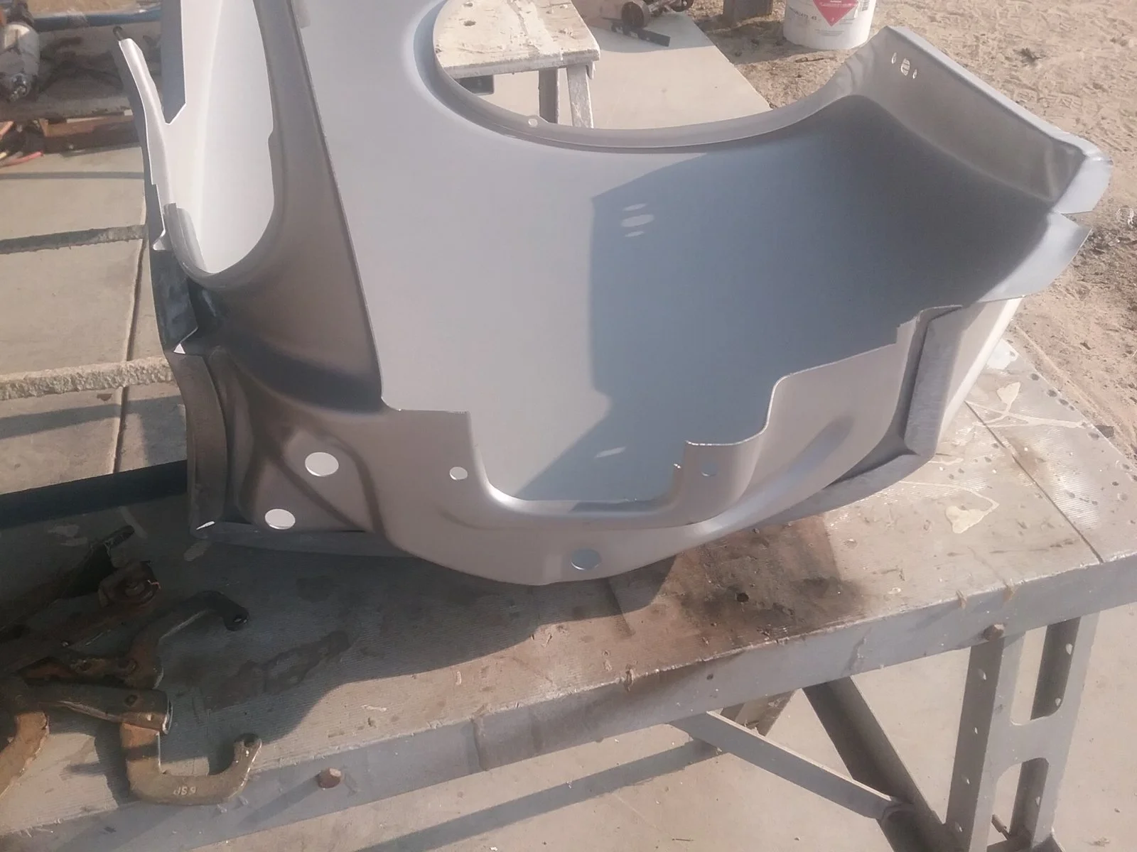

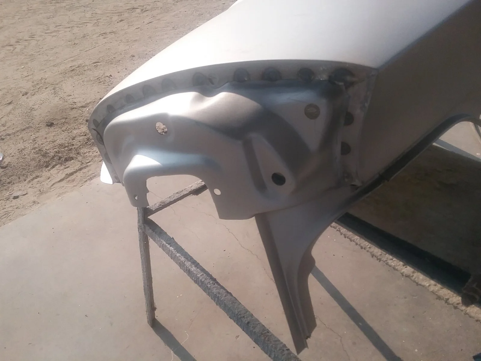

I had a little free time this morning so i decided to fit the ends into the quarters ,they were close but i want them perfect so i checked the fit with an end cap

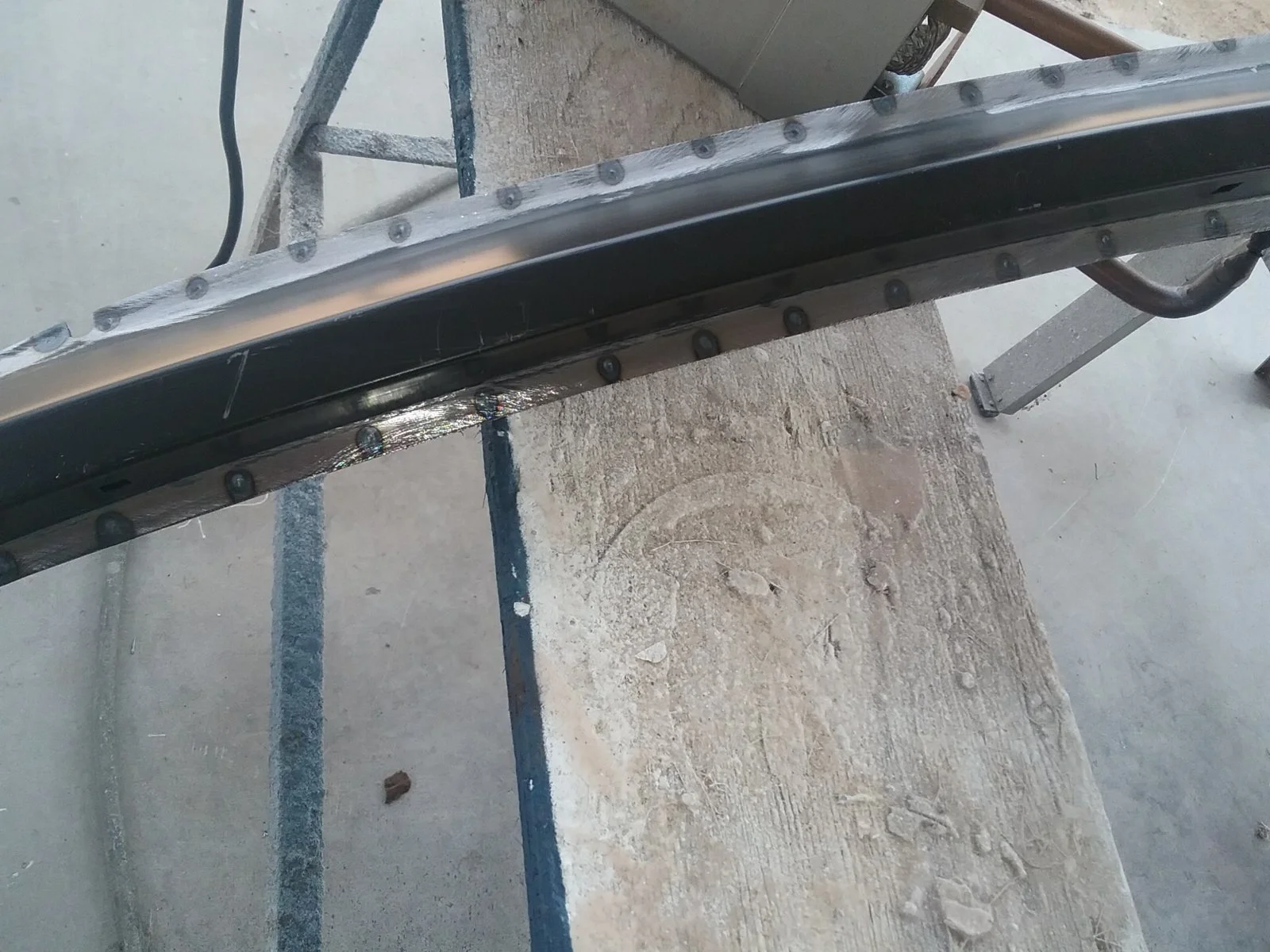

i clamped the end in place ,checked one more time with my end cap and spotwelded it in
I checked the end cap one more time ,driver side is good to go
Reactions: 2Blue2
Is a spot welder the preferred method for attach those to the quarter? This is one part of my coupe that needs serious attention. Wouldn't be surprised if I end up having to replace both quarters.
