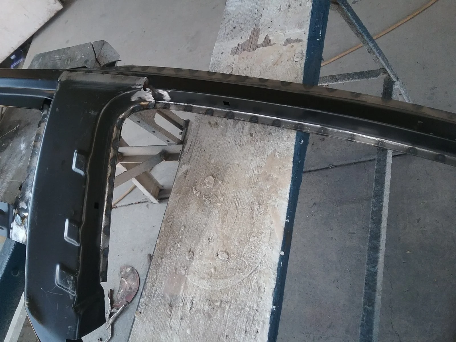

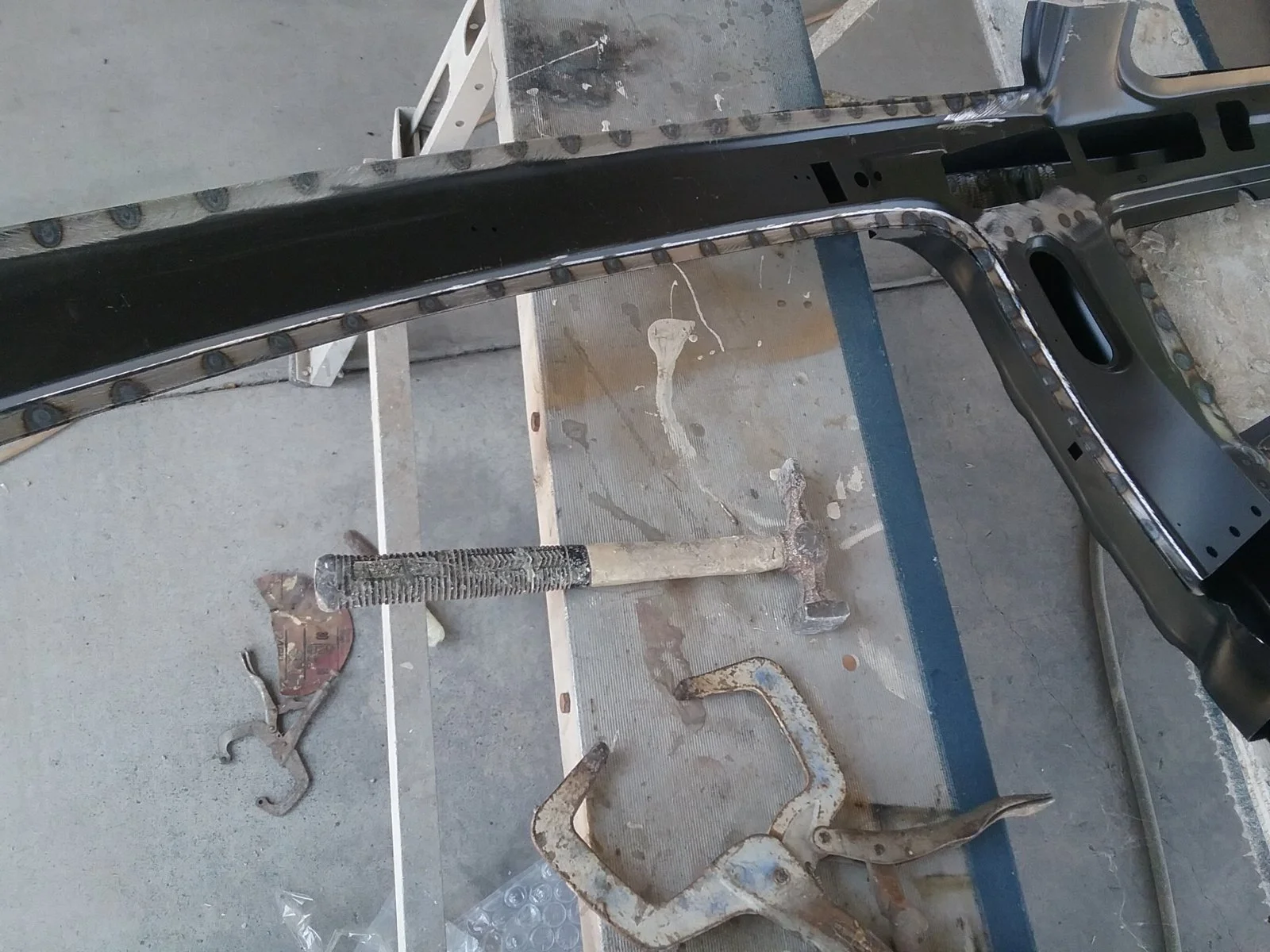

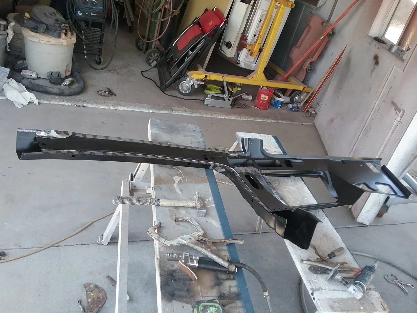

The passenger side door frame made it in today ,i already have it spot welded together I am going to have a lot of pieces left over ,if anyone needs them pm me and i will make you a deal ,they will be for 67 -68 although the inner wheel tubs will work on the 5-6 s. There is rockers ,the complete front door and window posts ,the complete rear door post for 67 -8 fast backs and several pieces for the 67 -68 door area ,including the outer metal kick panels,and inner and outer wheel tubs for 67 -8 .

Your spot welder seems to work well. Do you have to dip the tongs in flux paste to keep them from sticking?

No ,they are copper. ,they do burn away though

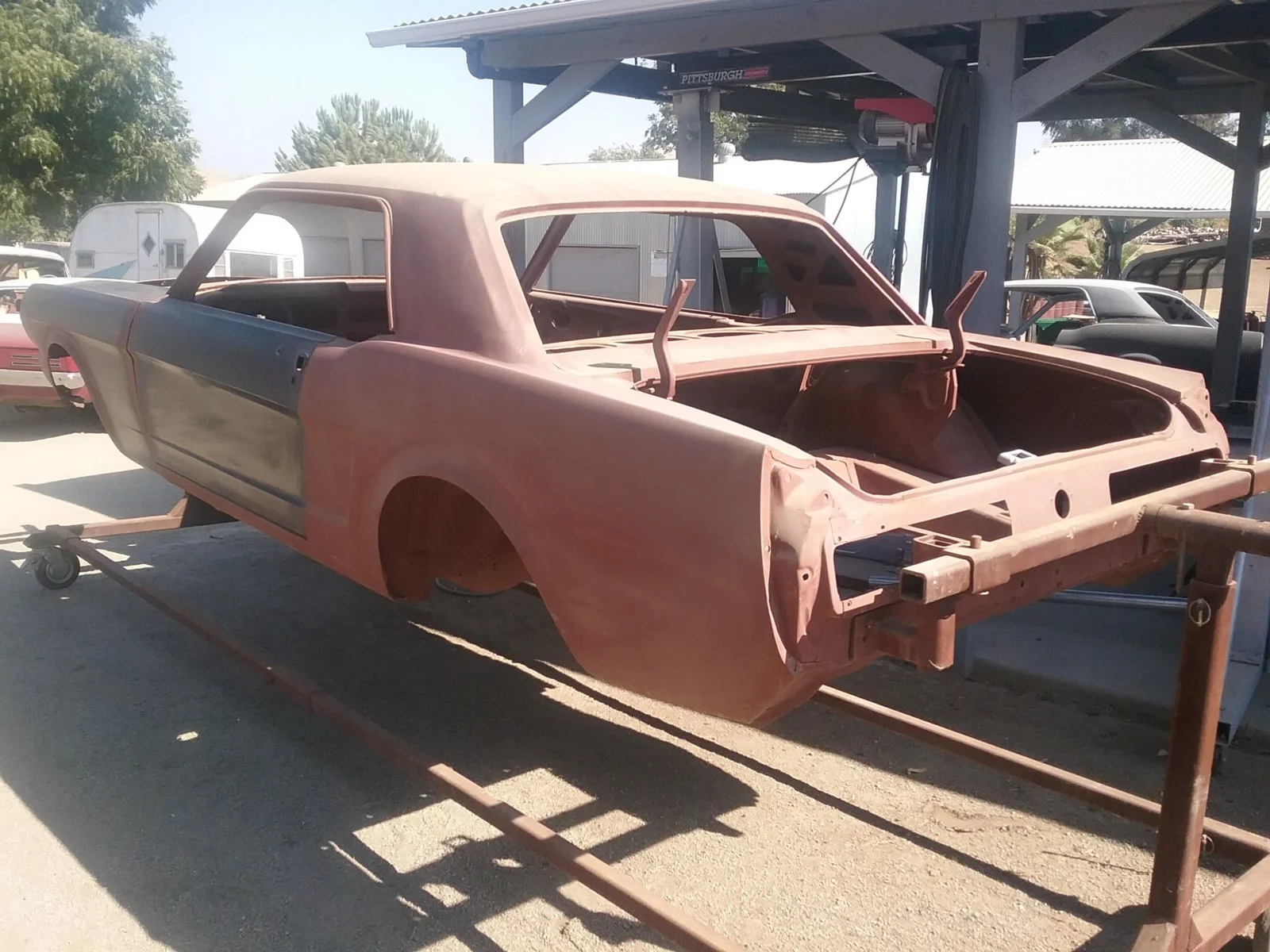

I fired up the fork lift and pulled it out of the car port ,i just have to get it off of the rotisserie but i have to shuffle a few cars around to get to my lift

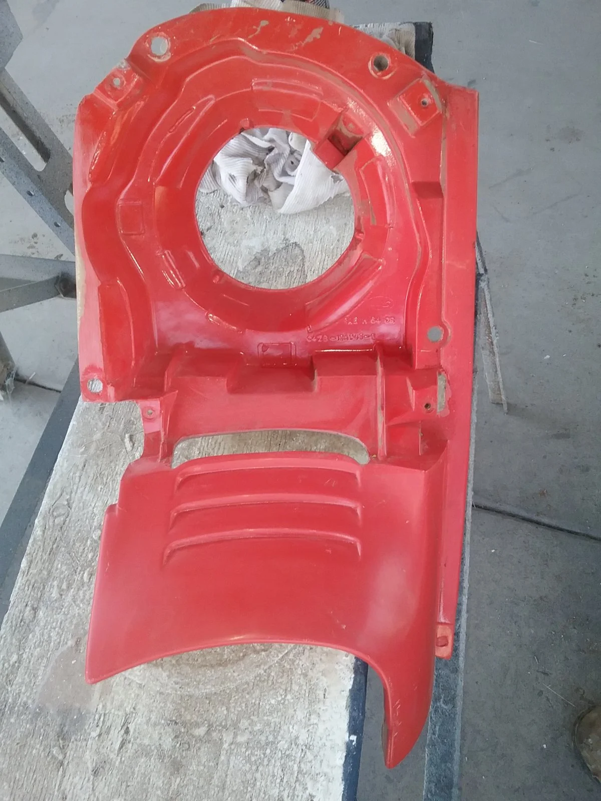

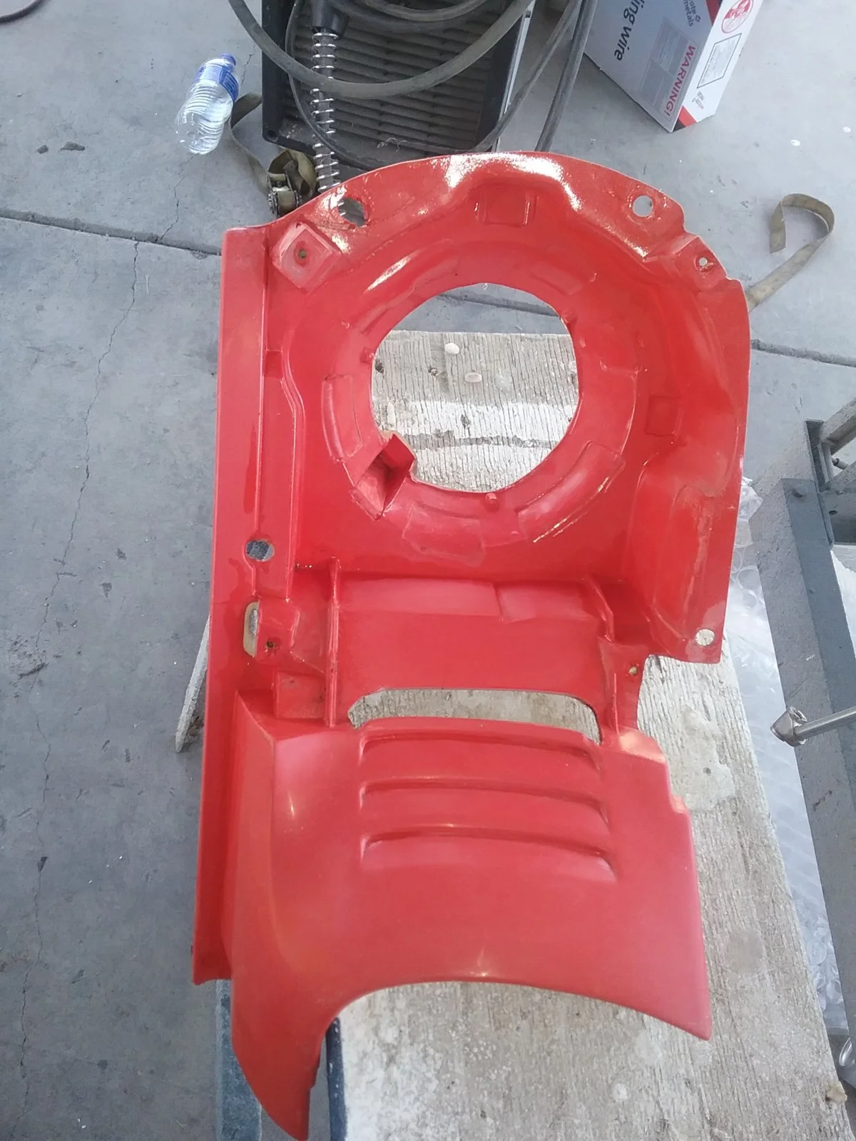

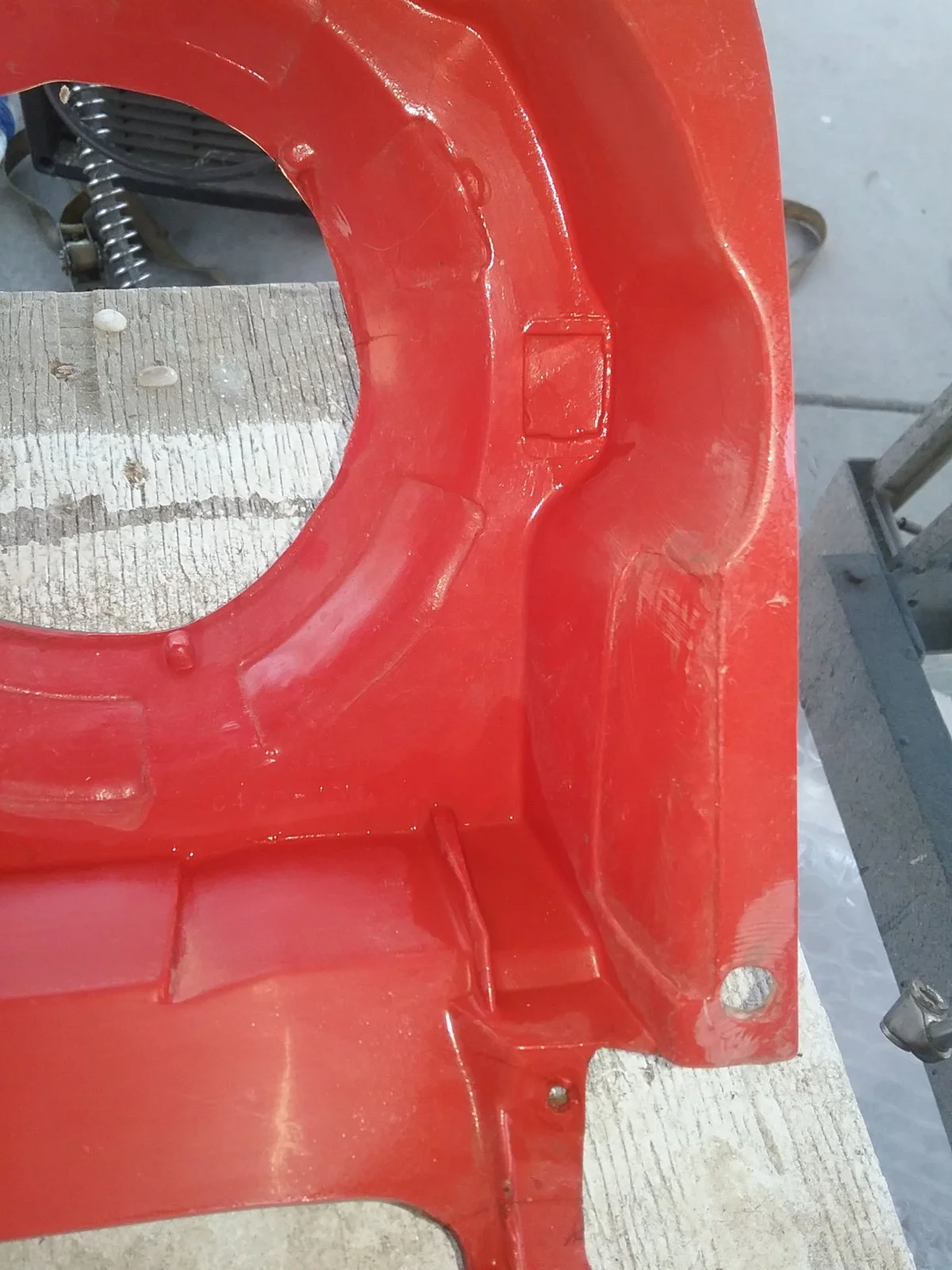

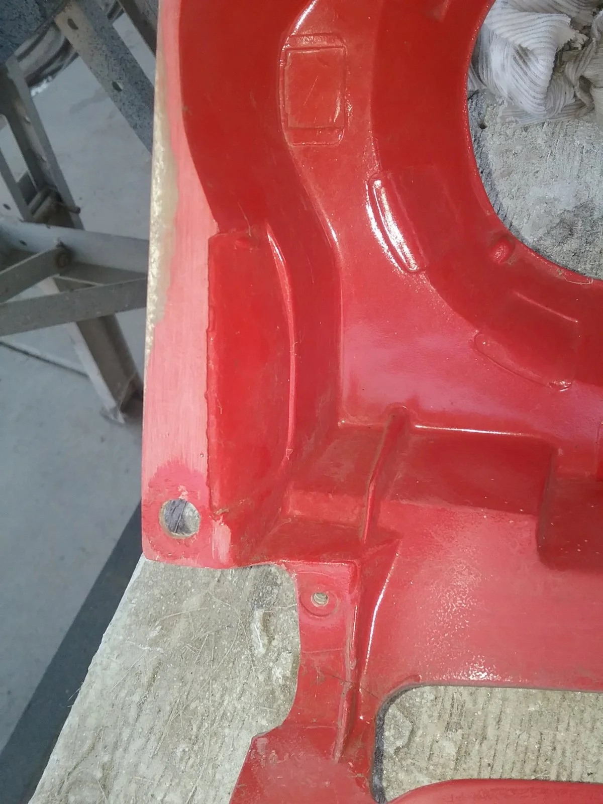

Just a little somthing i found while i was digging through my parts stash. They are fiberglass ,i made them many moons ago for a racer and forgot i had them . They weigh a fraction of the pot metal headlight buckets and that little tab at the top that always breaks on the originals ,aint going to on these . They are stronger than the pot metal buckets so i will use them on this conversion. I still have the molds some where around here ,i will have to find them, they were made from a very nice set of originals . I didnt even finish trimming them out all the way yet

Wow ! even the part number shows up.

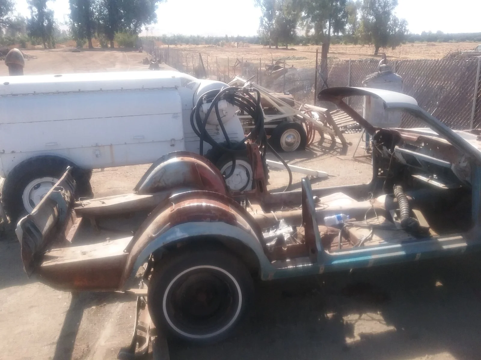

I have been trying my best to get back on this again but to much stuff in the way . Finished the roof on the firebird ,then they decide they want quarters ,of course the quarters should have been first ...that was not a lot of fun.
Have a couple of quarters on 67 fastback to go and just maybe i can get back on it

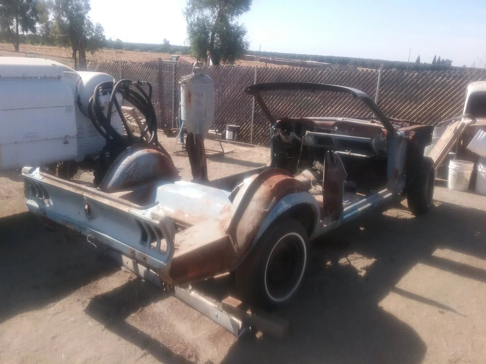

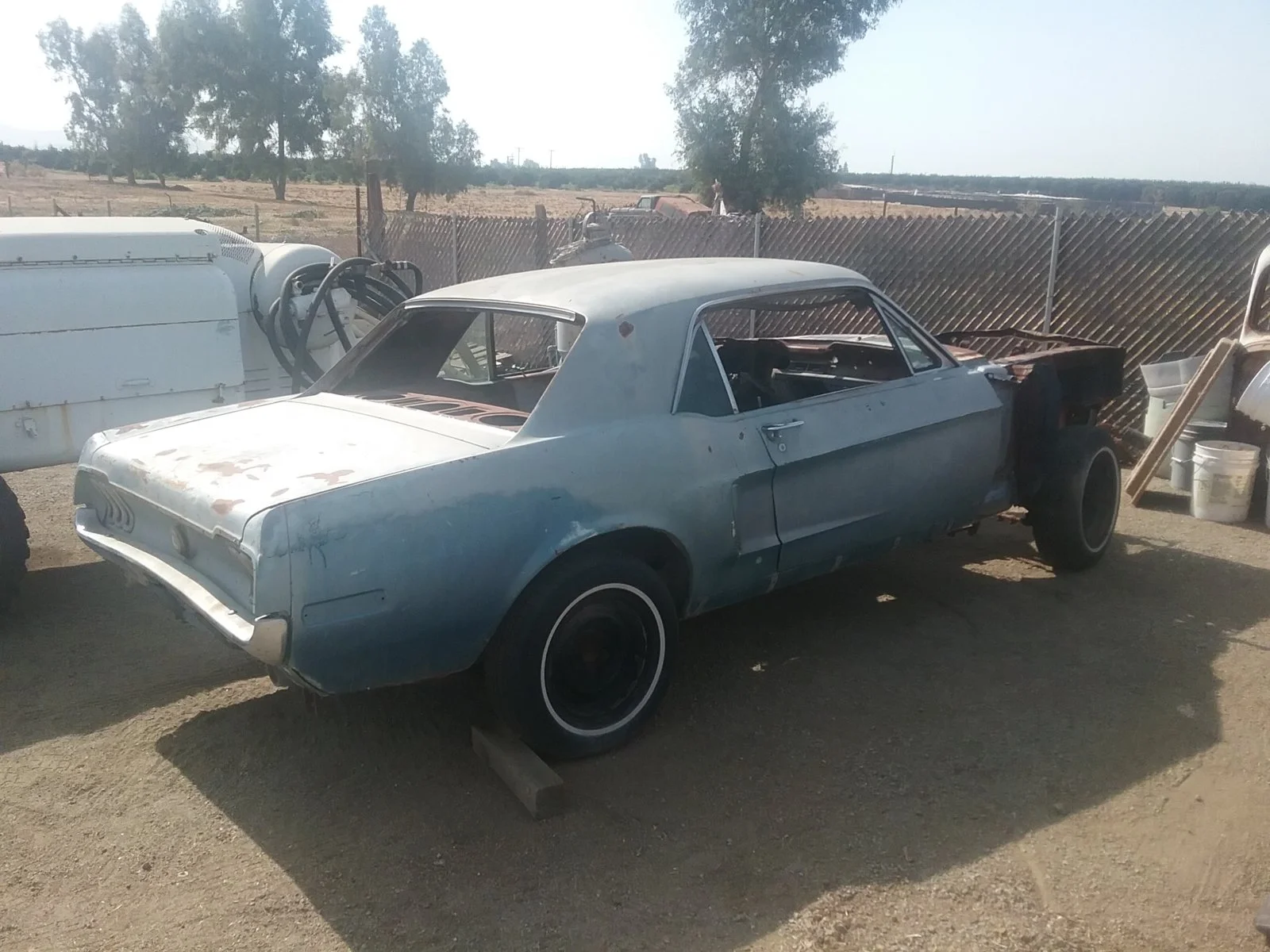

Well ,i have been to busy to work on it ,but i did pick up three more coupes,a 68 and two 67 s and a full inner dynacorn structure for a 67 -68 for $2000. So i see several more conversions in the future.still have to pick up the two 67s

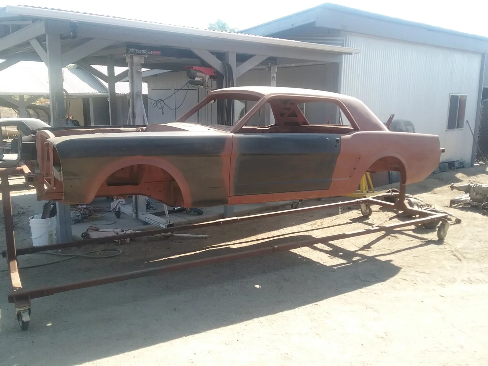

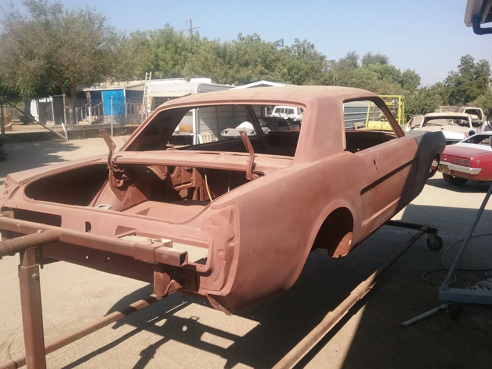

I decided to build this conversion at the same time as the 65 ,that i still have to get off the rotisserie .
I got out the Ryobi battery pack saws all and flipped its lid the under structure is very solid ,the door gap did not change with the roof offthe back seat and trunk divider panel is gone i will trim the rest of the old sheet metal later.

The 68 is pretty well cut apart ,still a bit of trimming to do and i probably will remove the tail panel ,this one has a big dent above the gas cap and i do have a new one already .the floor will come out next and everything inside will get sand blasted ans epoxy primed before the new sheet metal goes on .
