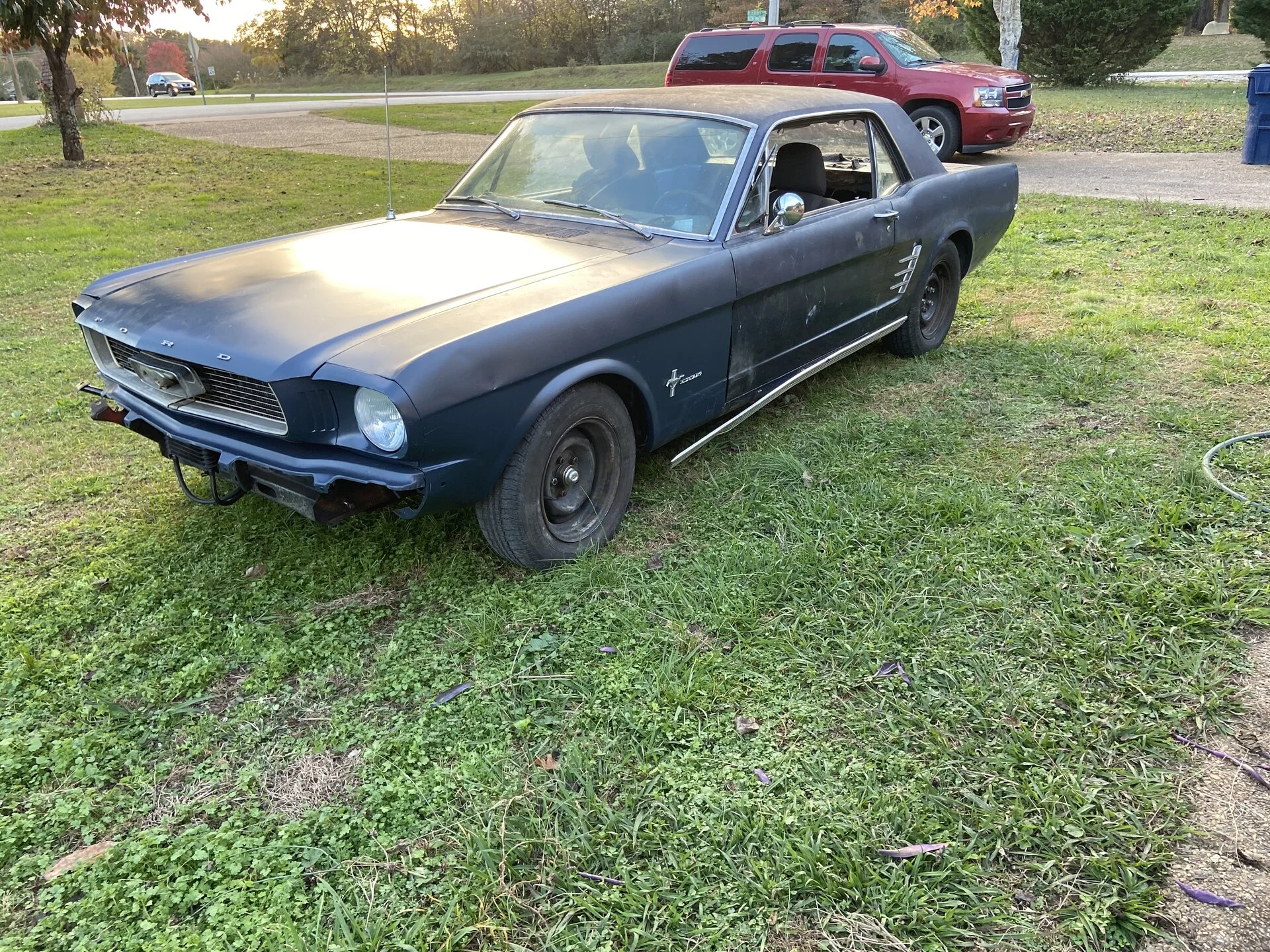

Got the front end on, except I was missing the bumper-to-fender braces and the LH bumper bracket was way out of whack (RH was fine, go figure since it was hit on the right). I ordered those so I didn't put the valence on yet. Just for posterity, if anyone reads this, here is the order I found that worked. hang fenders and get door gap correct. Tighten upper rear and bottom bolts but leave others loose. Put the grille and headlight buckets on, leaving the headlight buckets loose. Install the stone guard. Tighten the headlight buckets, fenders, and stone guard bolts. Then I will install the bumper and last the valence when I get the bumper brackets. Found that it is impossible to install the headlights to the buckets with lights in the holders-you can't get that spring. But if you put the holders in without headlights in them, it is very easy to get the springs in. I kinda held the valence up and it looks close. May have to loosen a few things to get it all to line up, we'll see.
