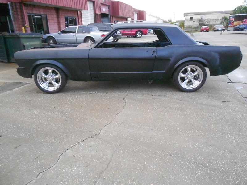

1966 Mustang Coupe Restomod

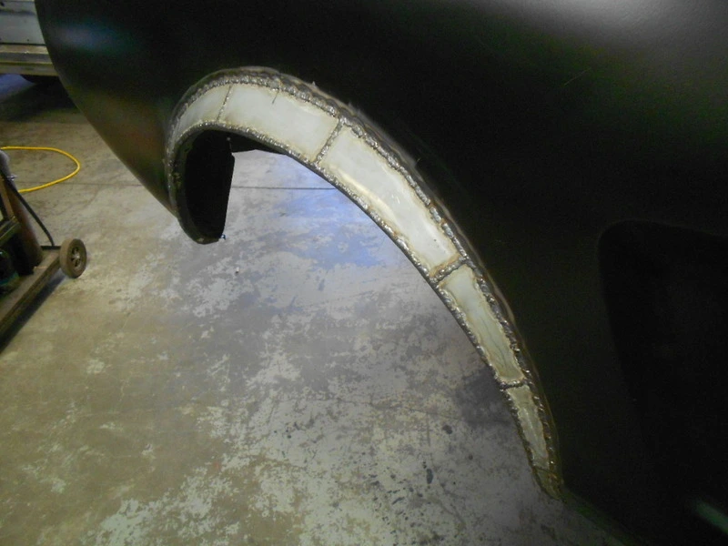

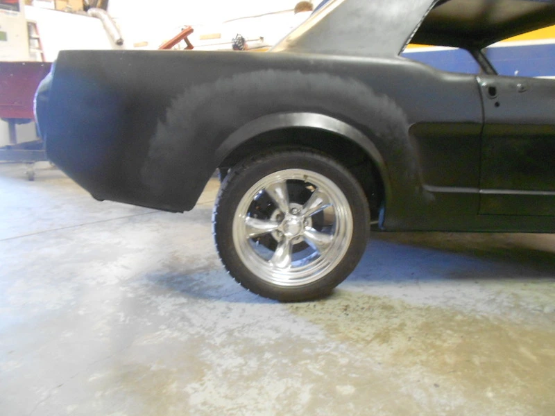

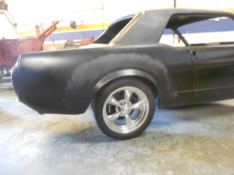

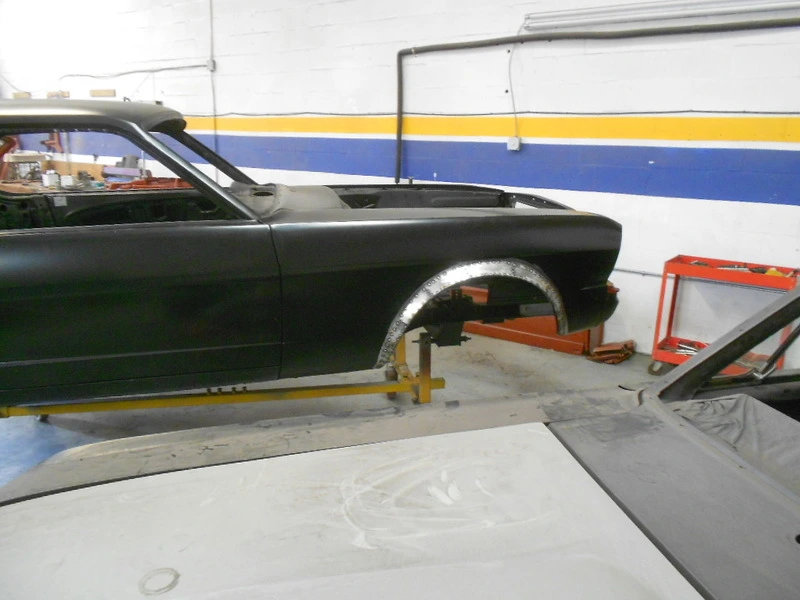

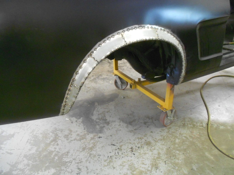

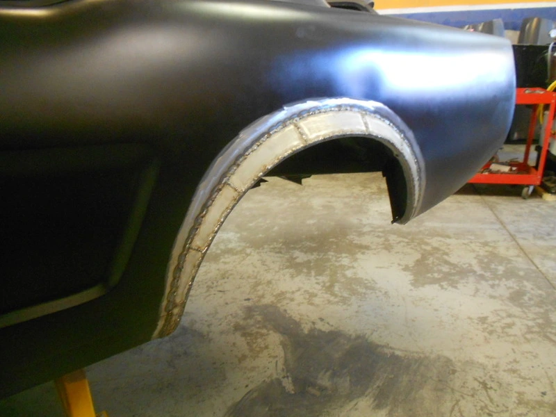

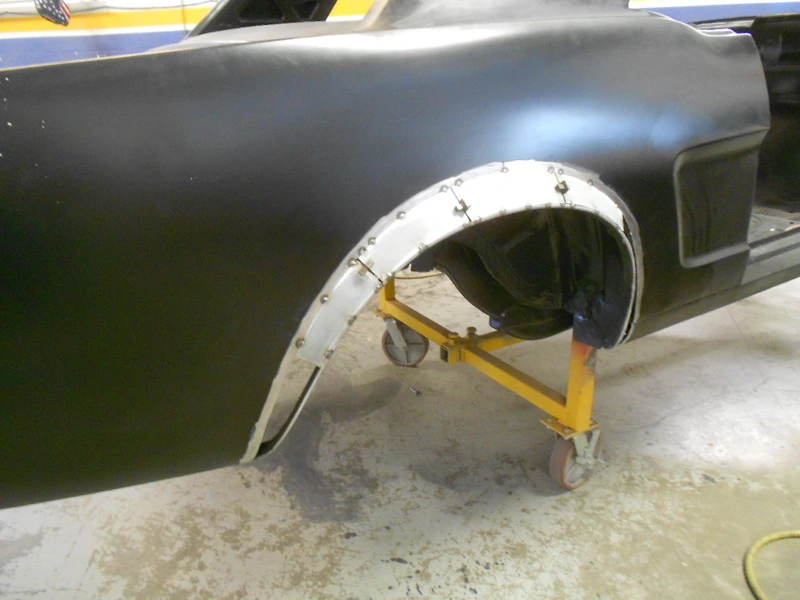

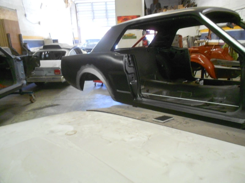

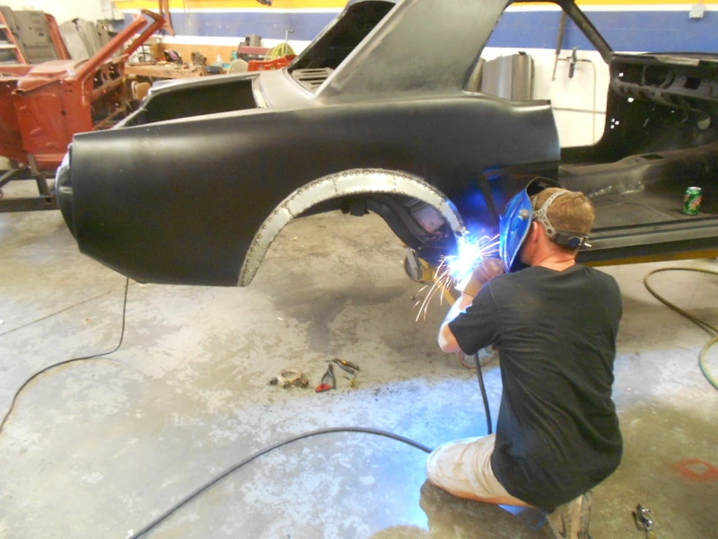

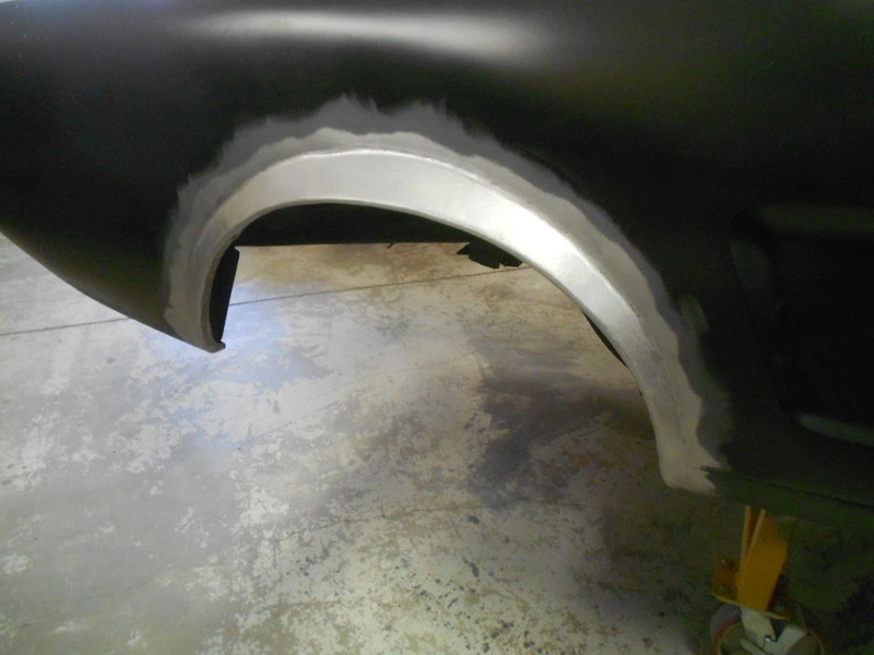

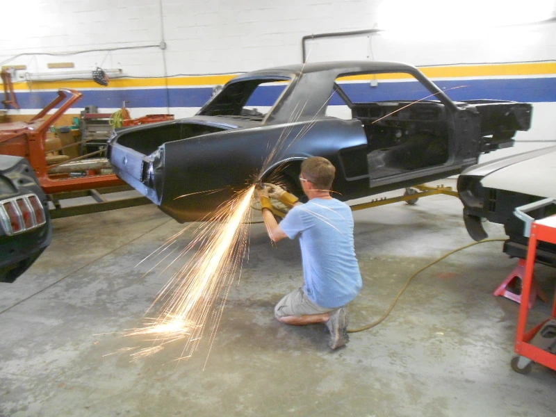

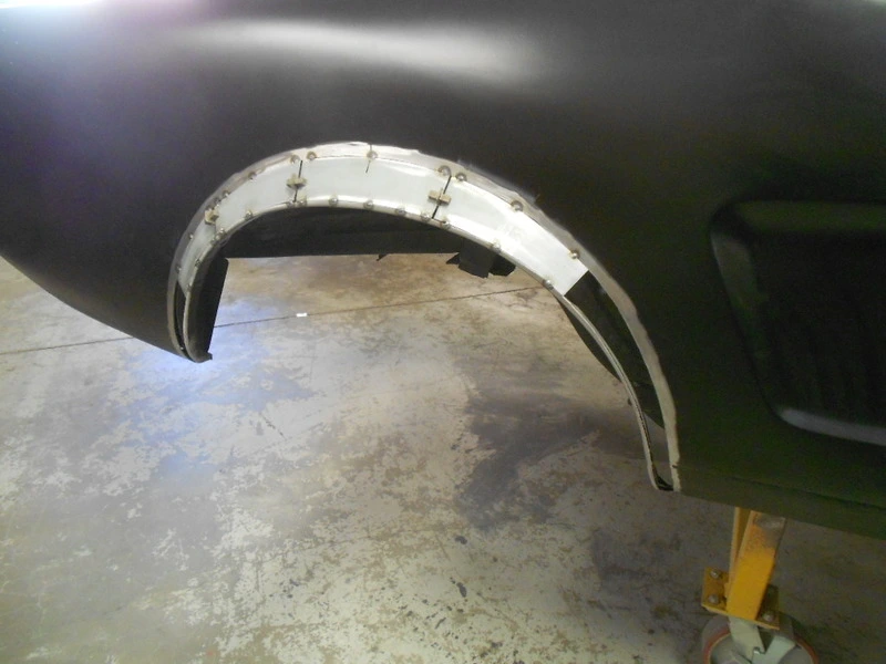

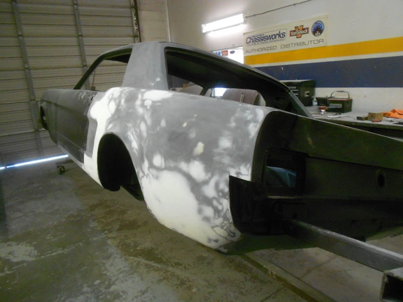

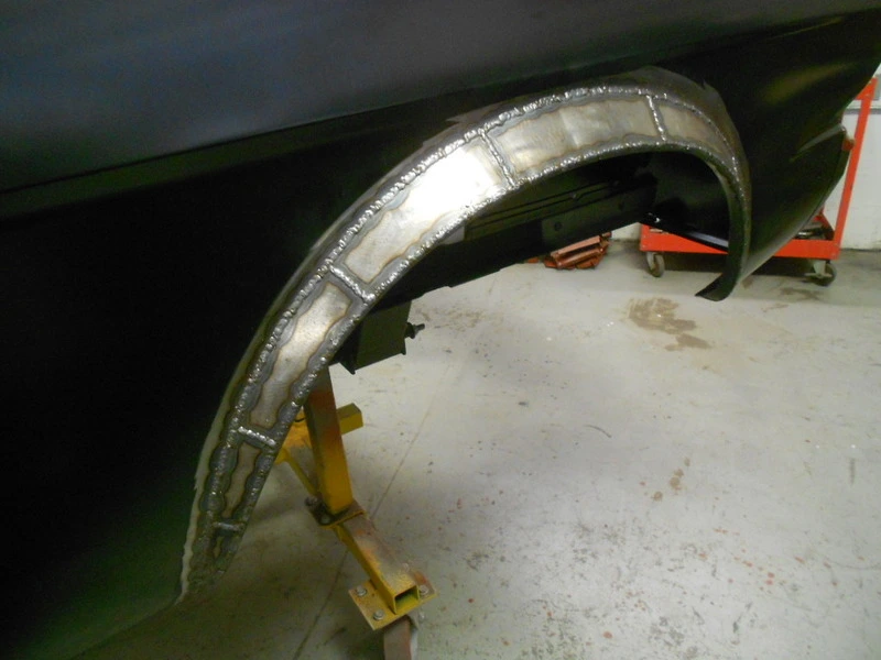

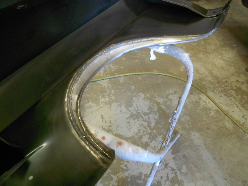

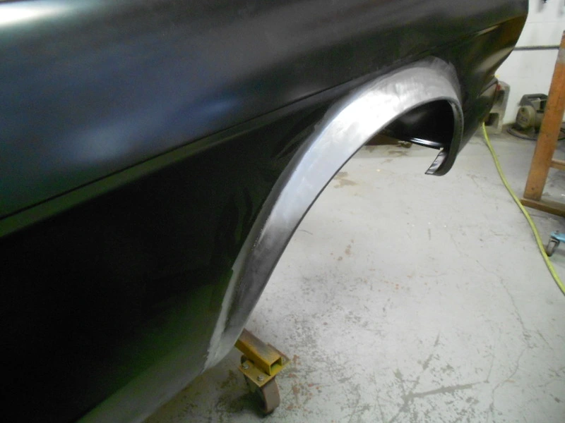

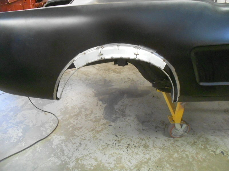

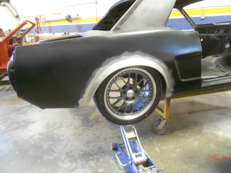

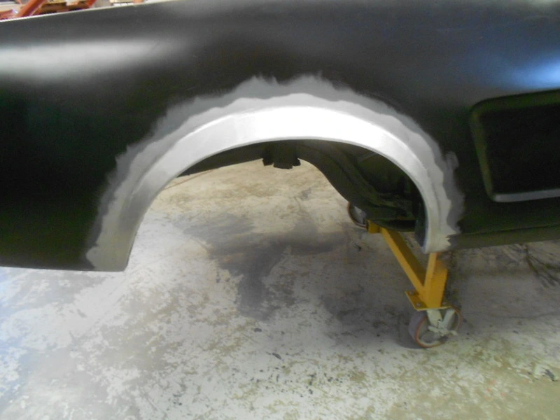

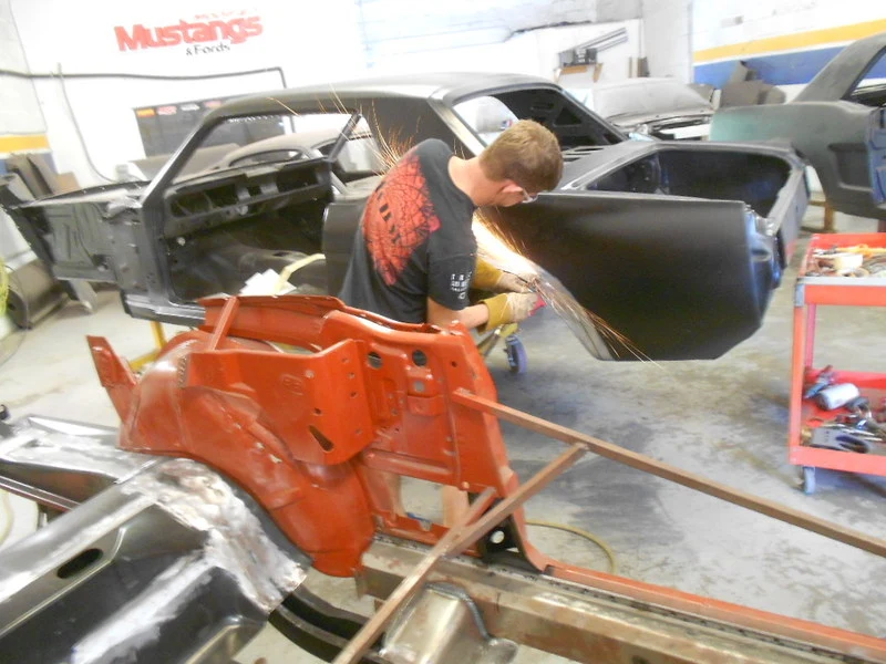

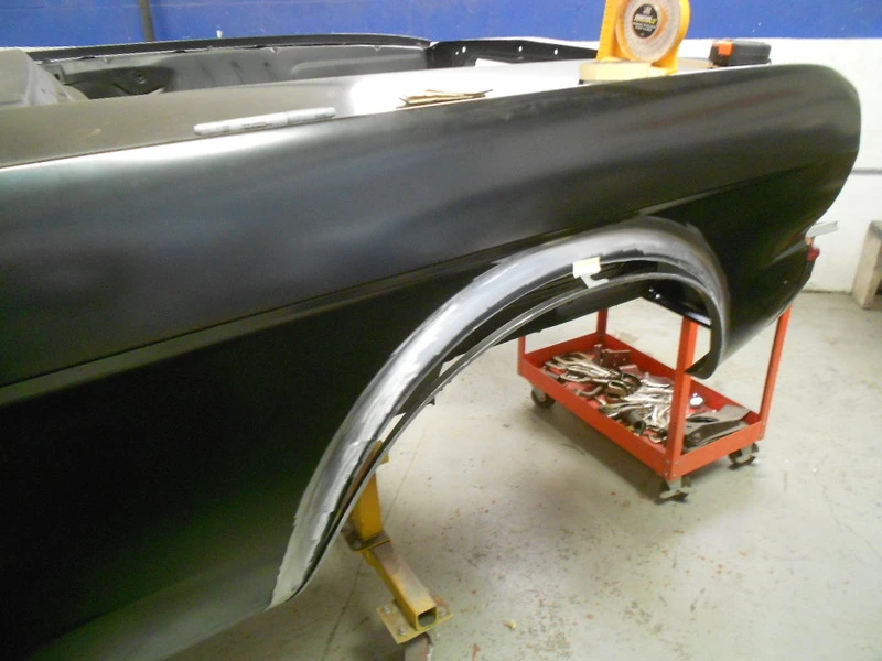

The flares are to small on the early Mustangs so Brian is going to make a little larger flare.
The first thing is to mark where he is going to make his cut and start cutting.

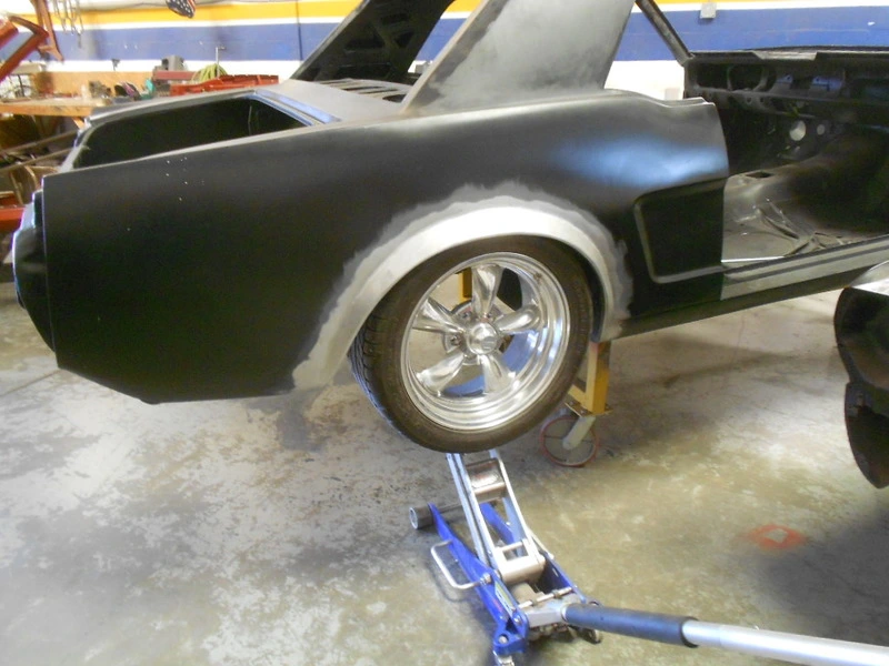

He left it attached at the bottom and brought it out 1 1/4" at the top.

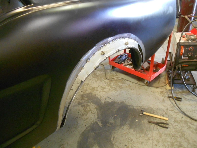

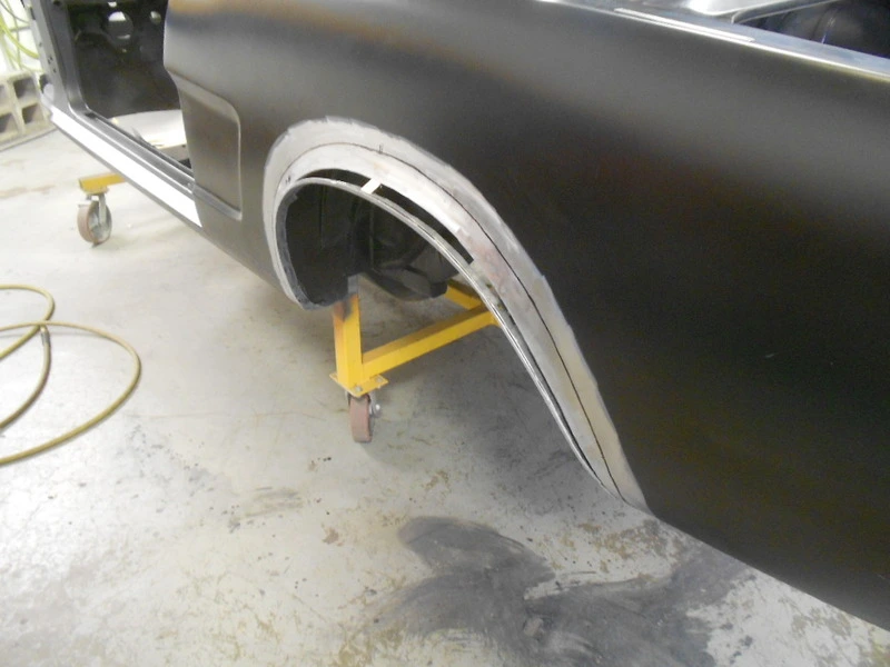

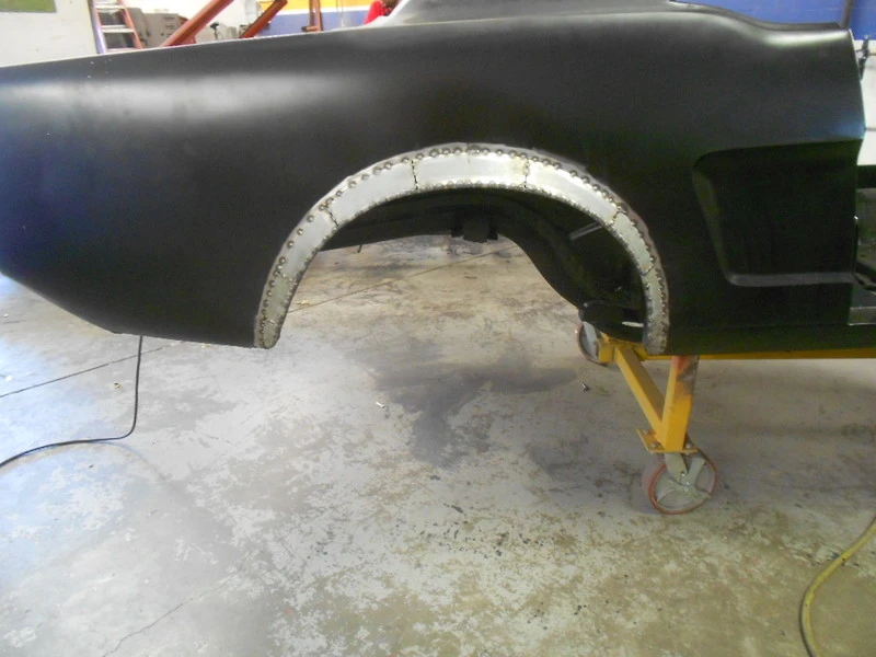

Next he made a pattern out of poster board and taped it on.

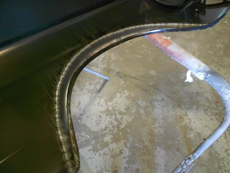

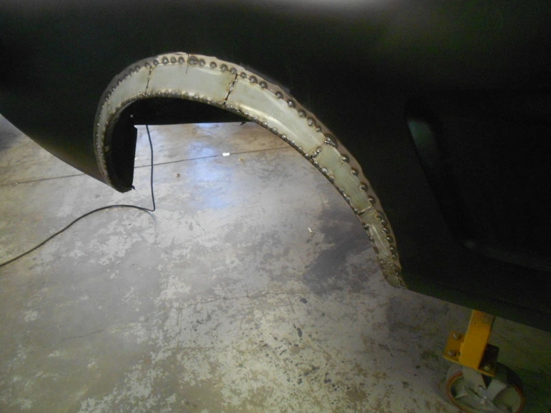

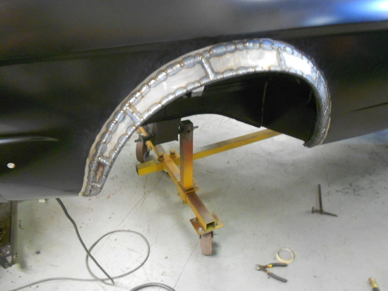

Next he transferred the pattern to metal and had to make it in sections to get the shape he wanted and started tacking in place
He will keep added sections until it is all filled in

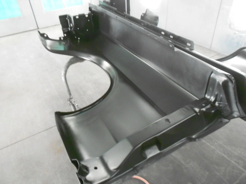

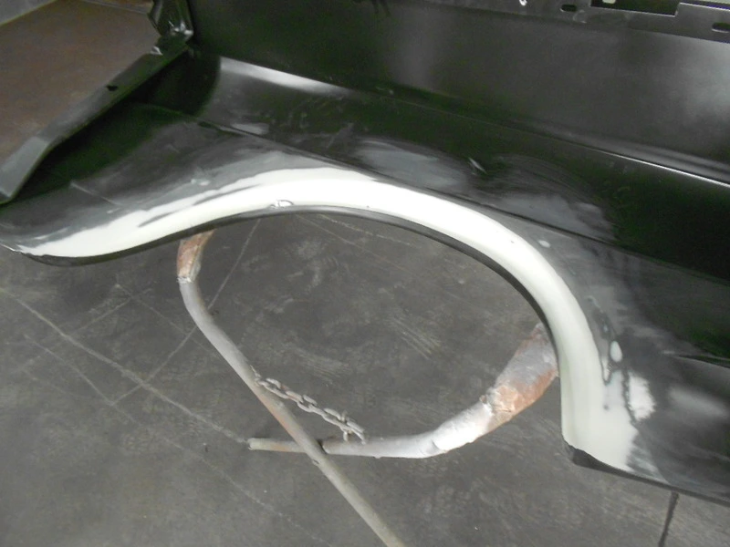

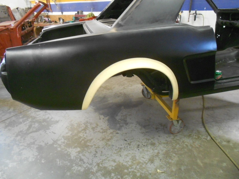

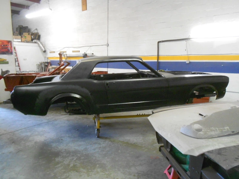

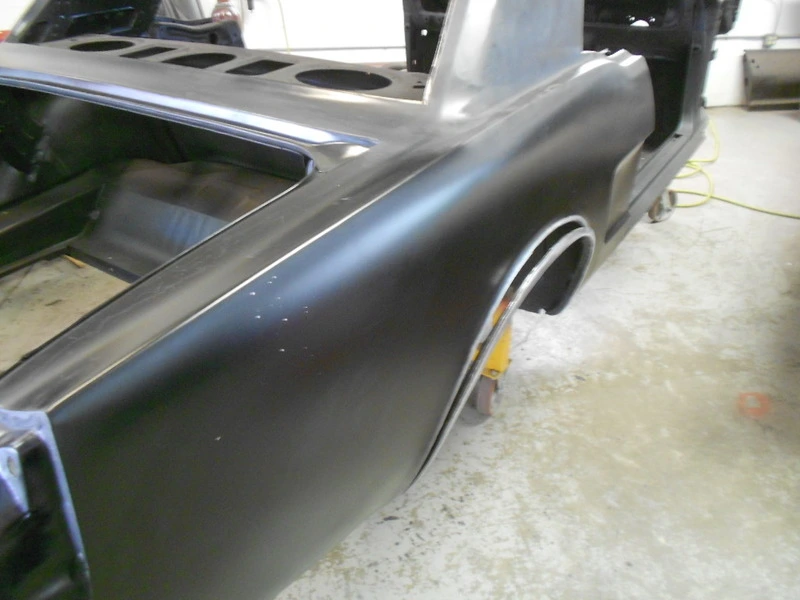

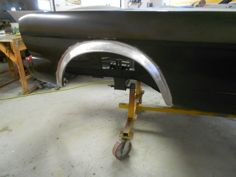

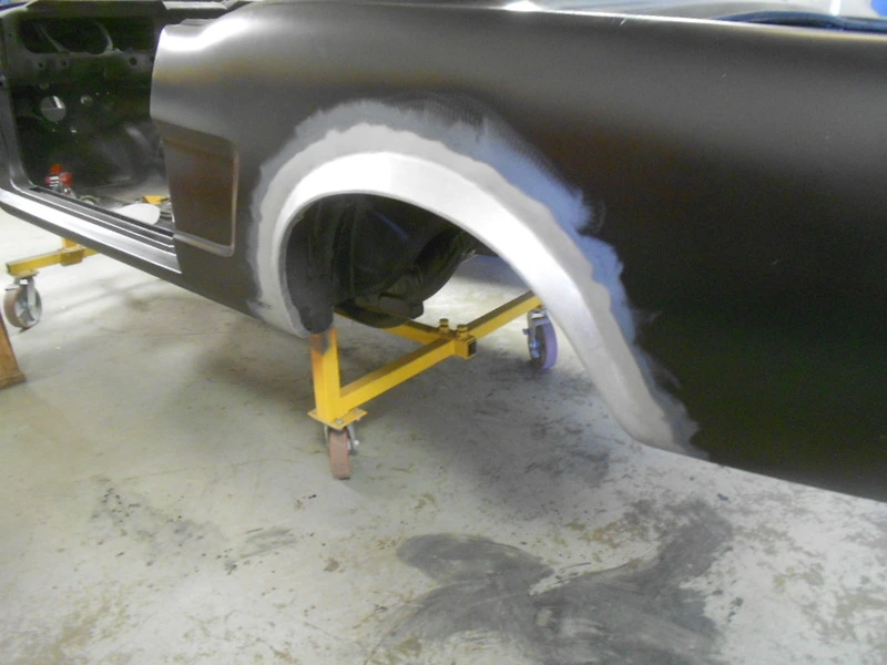

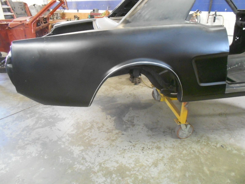

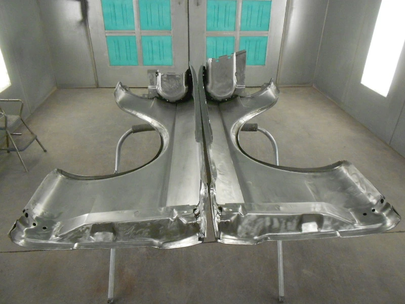

I did pretty much the same thing to a set of 65-6 front fenders not long ago .While it was fun to do ,i decided to make a mold from the two finished front fenders .I would still go steel on the rears though .I would like to make a template for the rears ,just to make it go faster .It would be nice to have some one do stamped rear steel fender flairs .

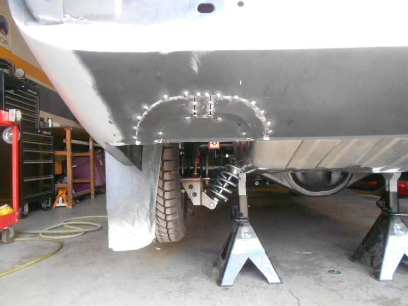

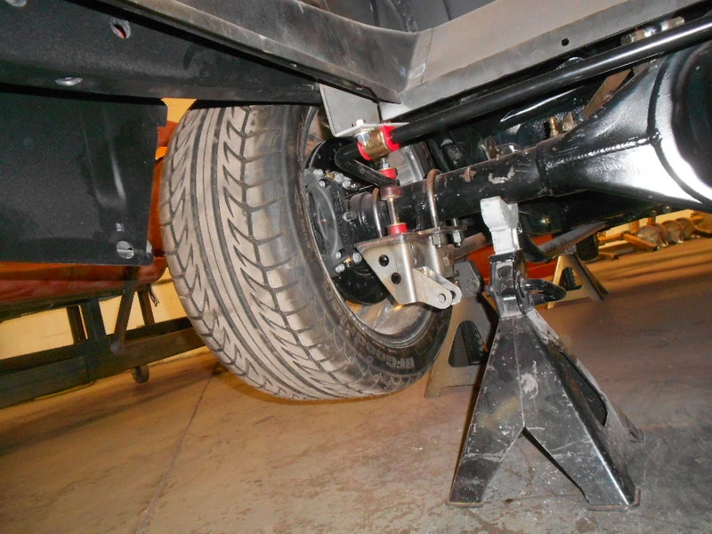

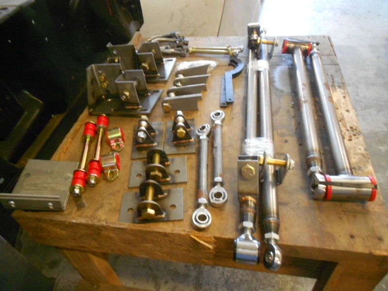

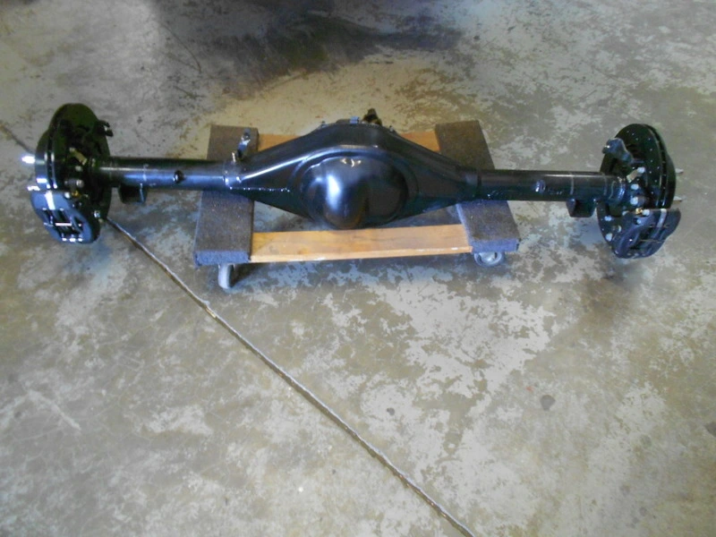

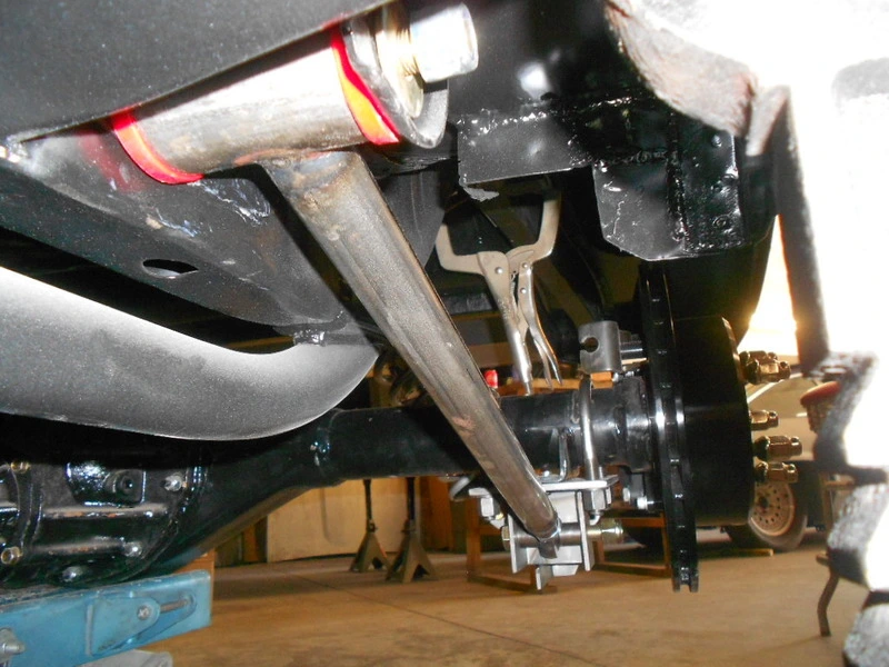

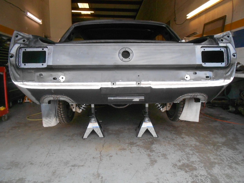

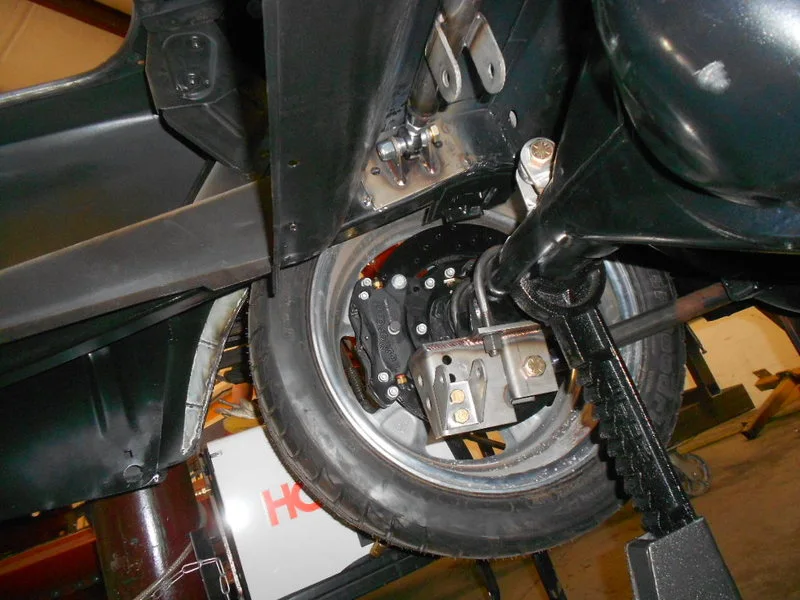

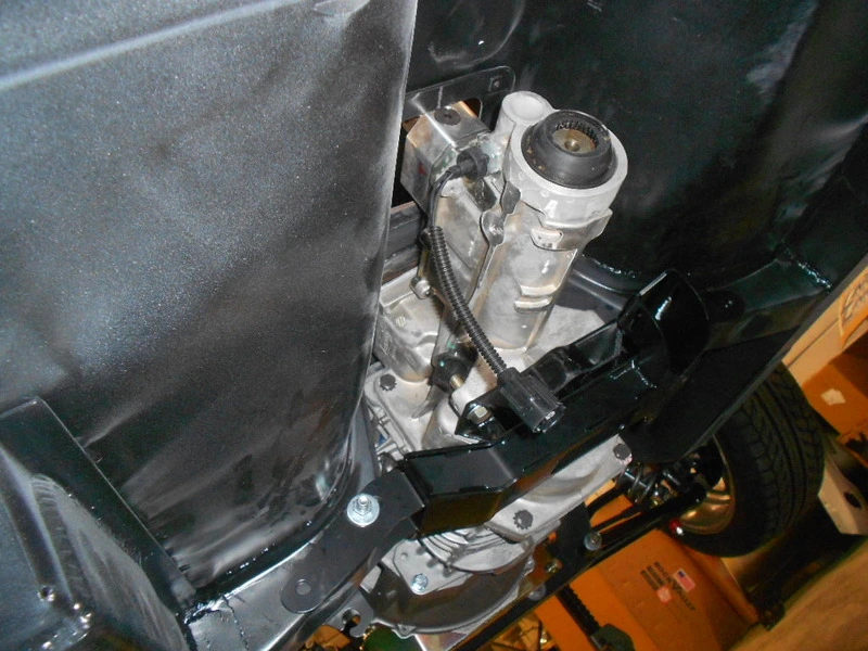

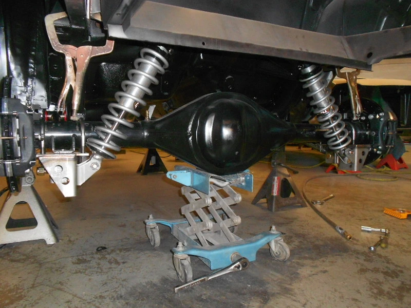

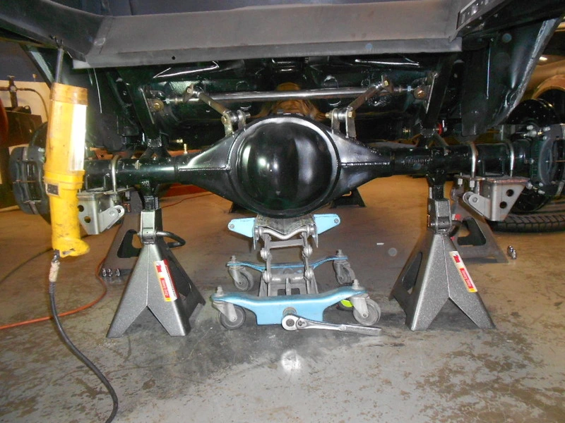

I have the second Rod & Custom rear suspension kit sold on my 1968 Coupe and it fit great. We can get the car real low if we want. The kit has been redesigned and it is a little harder to install and you cannot get it as low as my car.
The upper shock mount now has heim joints because I'm sure not all early Mustangs have the same distance between the frame rails. Tack welded in place
Upper control arm crossmember and rear end brackets tack welded in place

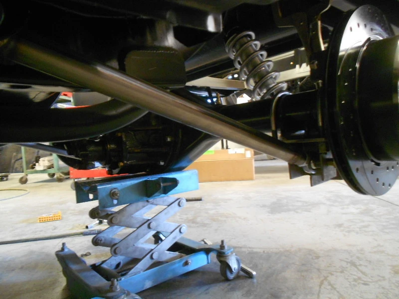

Installing the rear coilover shocks
Everything was installed according to the directions and this is the lowest it would go.

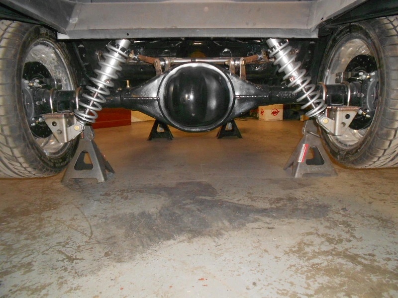

After talking to Rod & Custom they said to turn the lower shock mount over
This is the ride height now with no weight in the car
With weight in the car I think the ride height will be about right

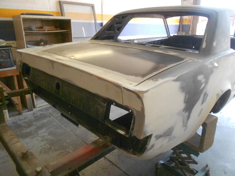

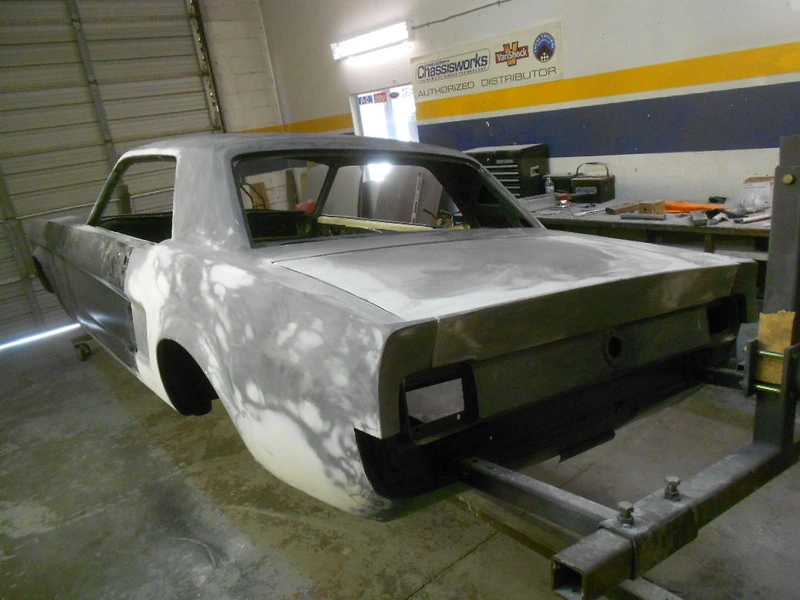

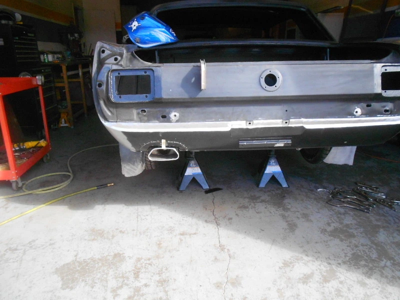

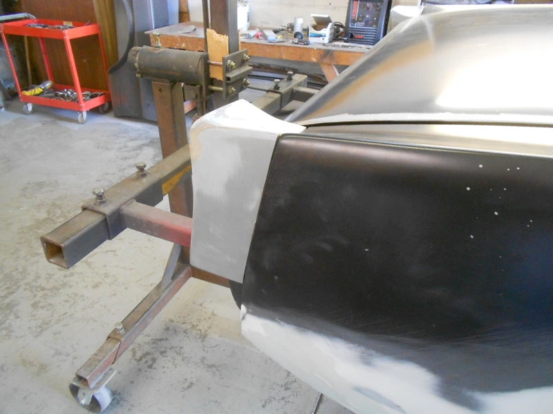

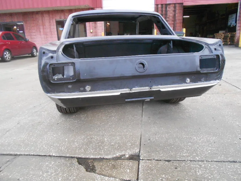

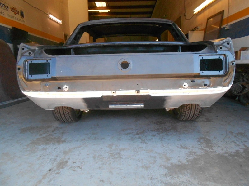

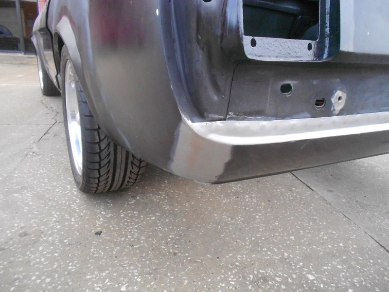

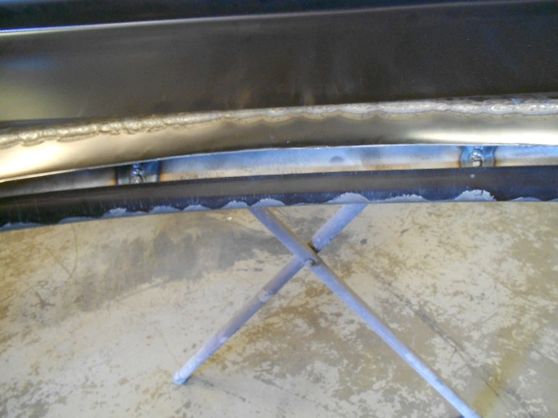

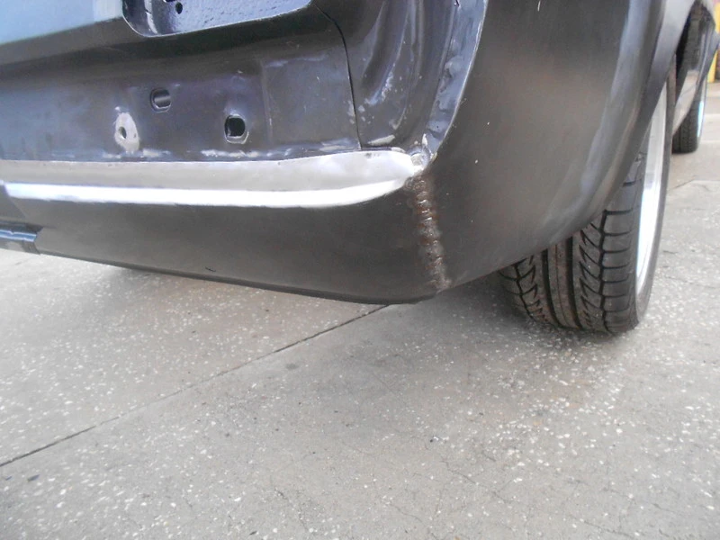

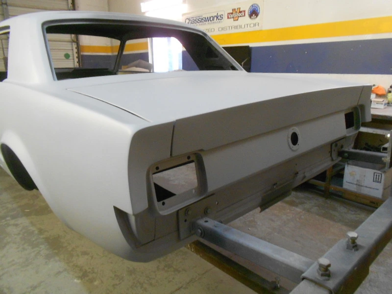

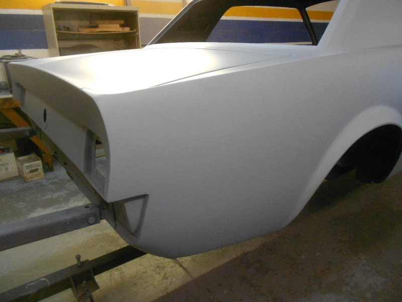

Welded the rear valance in place
Welds ground
We wanted to do something different for the exhaust. We cut the exhaust outlets from a 1967 valance but had to make it a little larger to fit our tail pipes
Welds ground

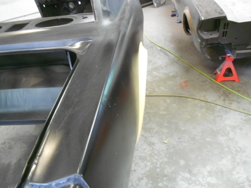

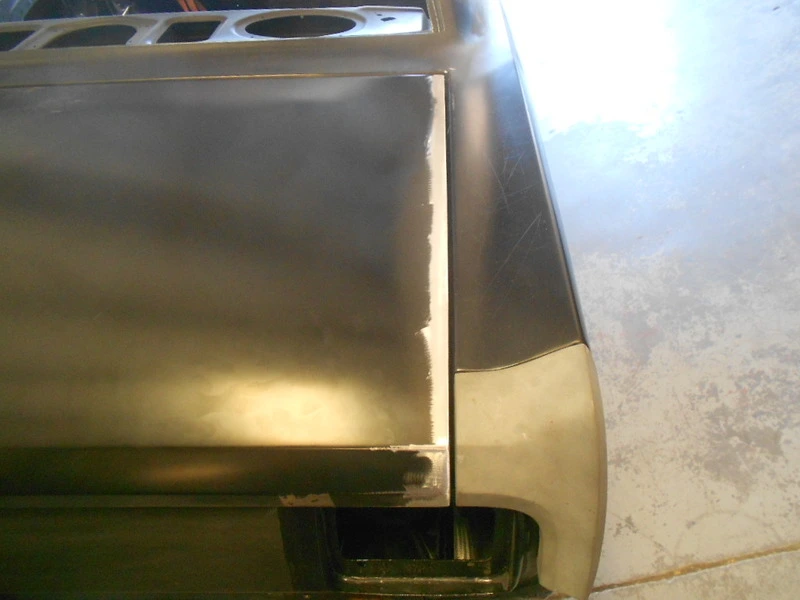

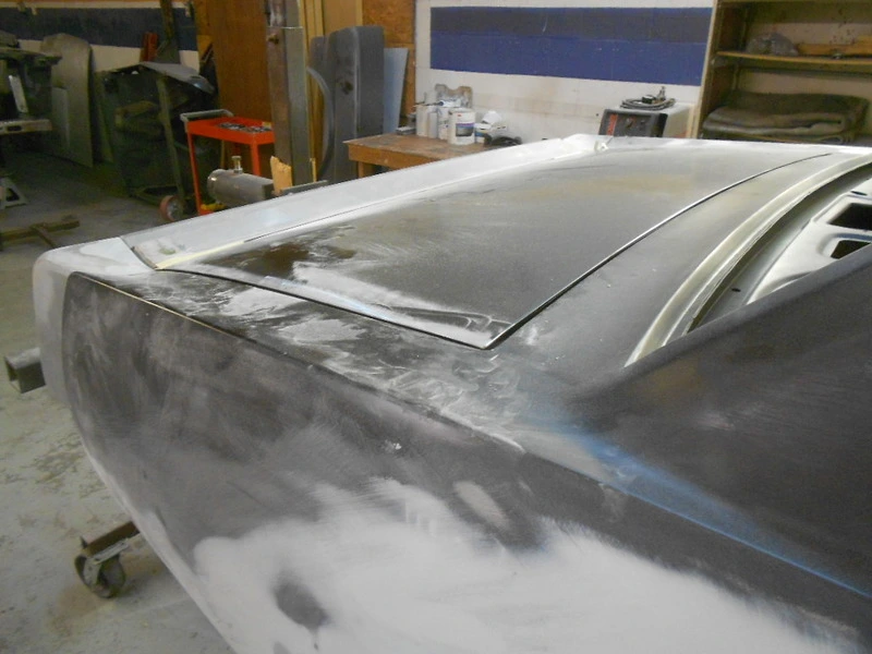

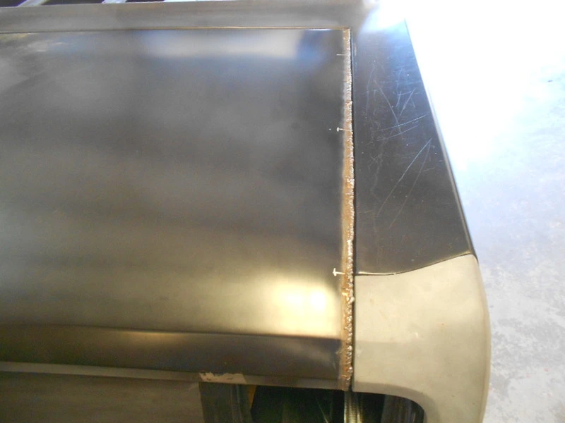

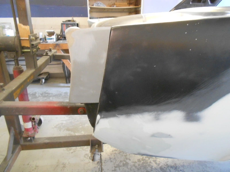

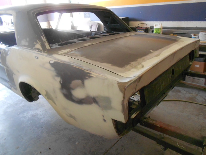

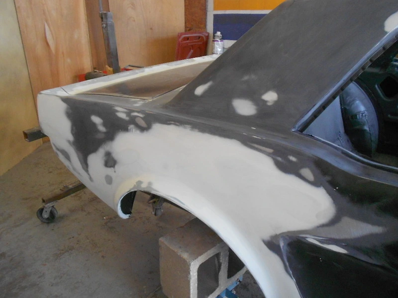

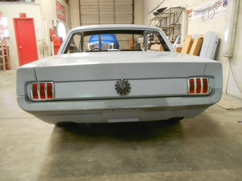

Fixing the trunk gap

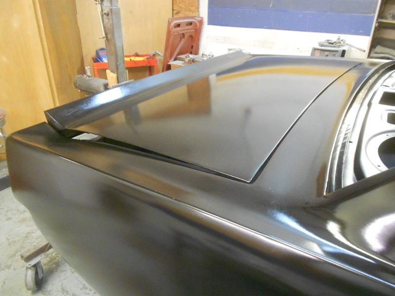

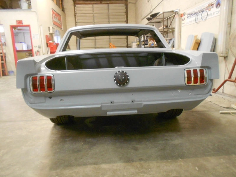

The owner wanted a spoiler but did not like how tall it was so we lowered the Mustangs to Fear spoiler and end caps about 1". It will be straight with the top of the quarter
Spoiler cut and test fitting

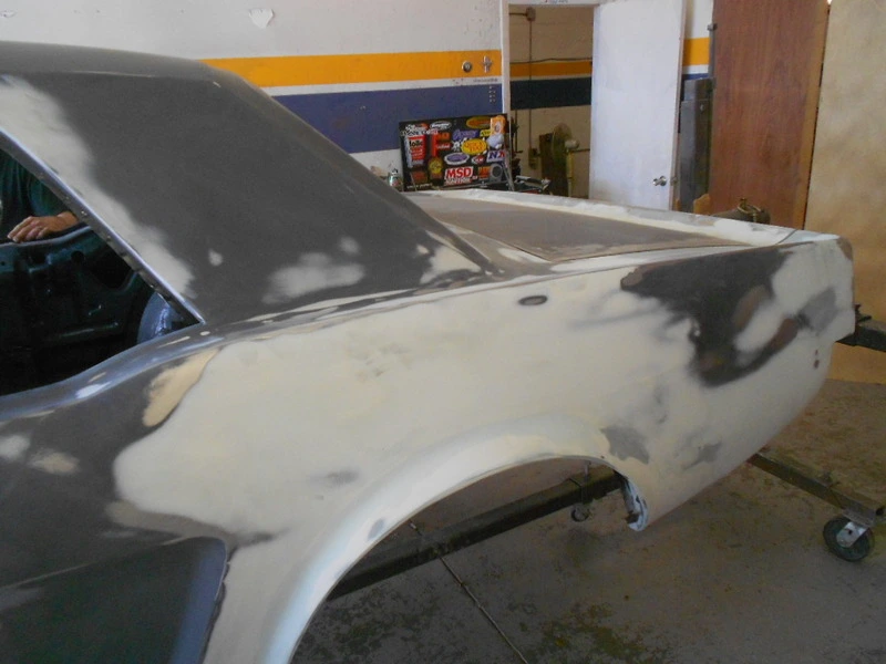

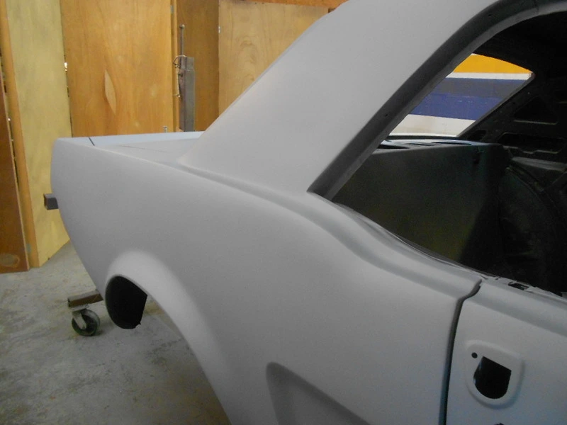

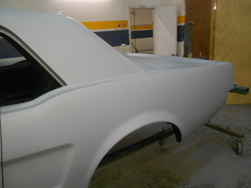

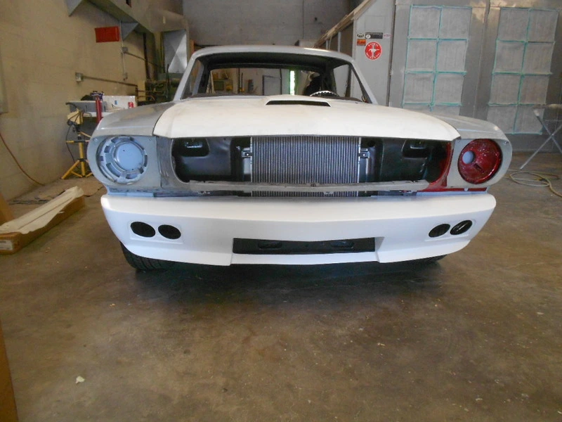

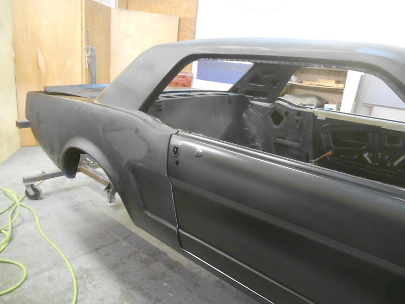

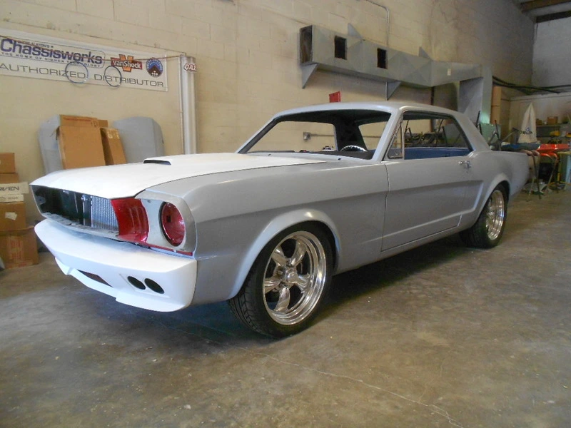

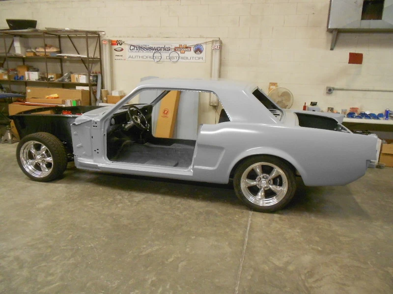

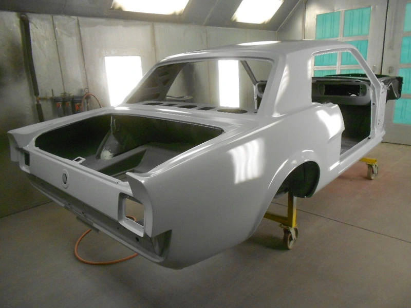

We took the body off the rotisserie and mounted it on a cart so I could finish the taillight panel and rear valance. I block sanded one more time

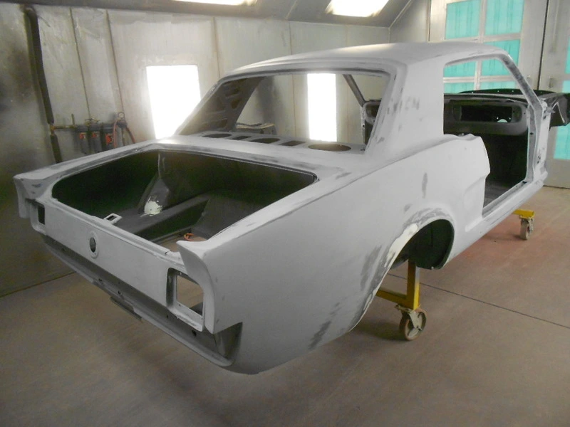

Epoxy primed

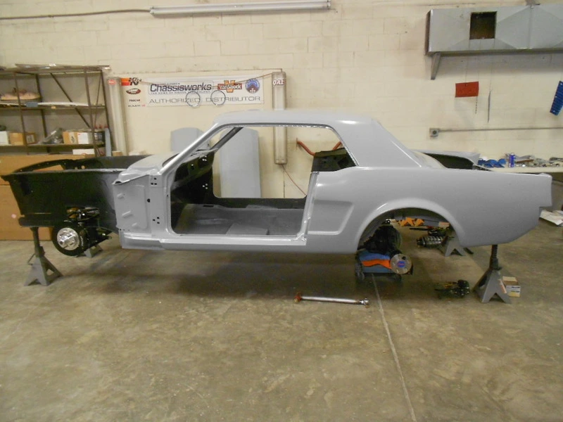

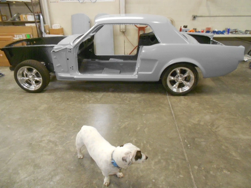

We want to test fit everything before paint. Starting installing the Rod & Custom suspension

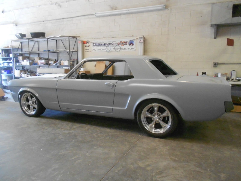

Back on the ground

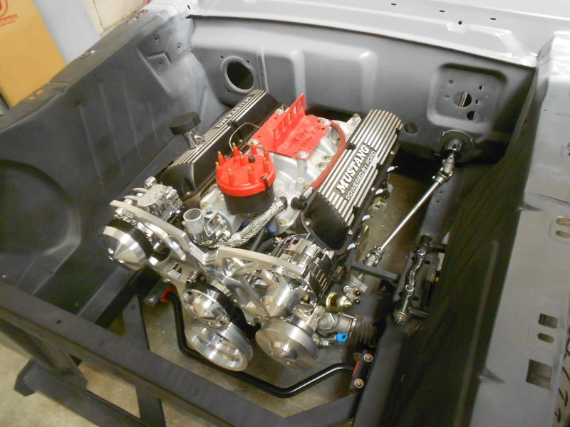

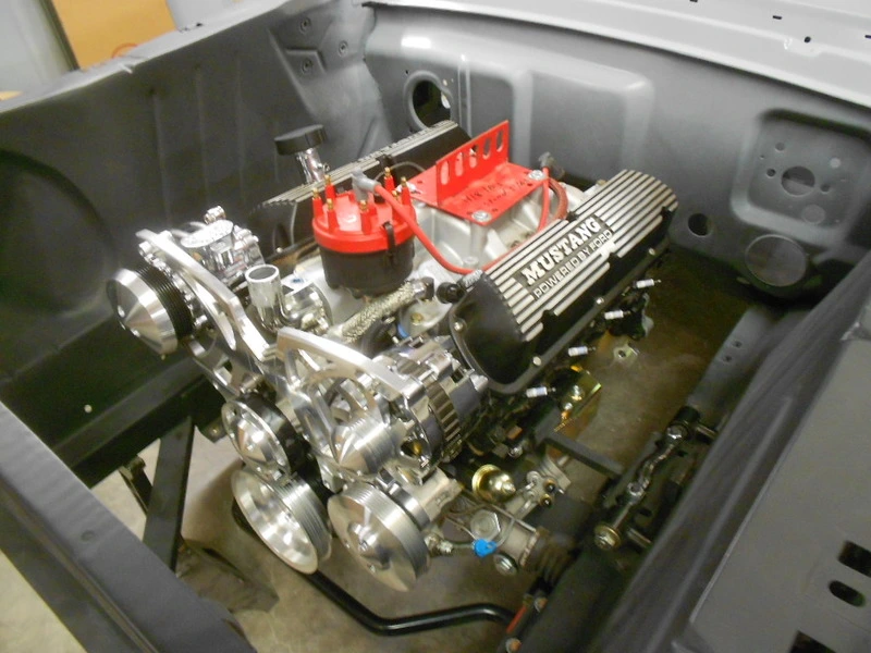

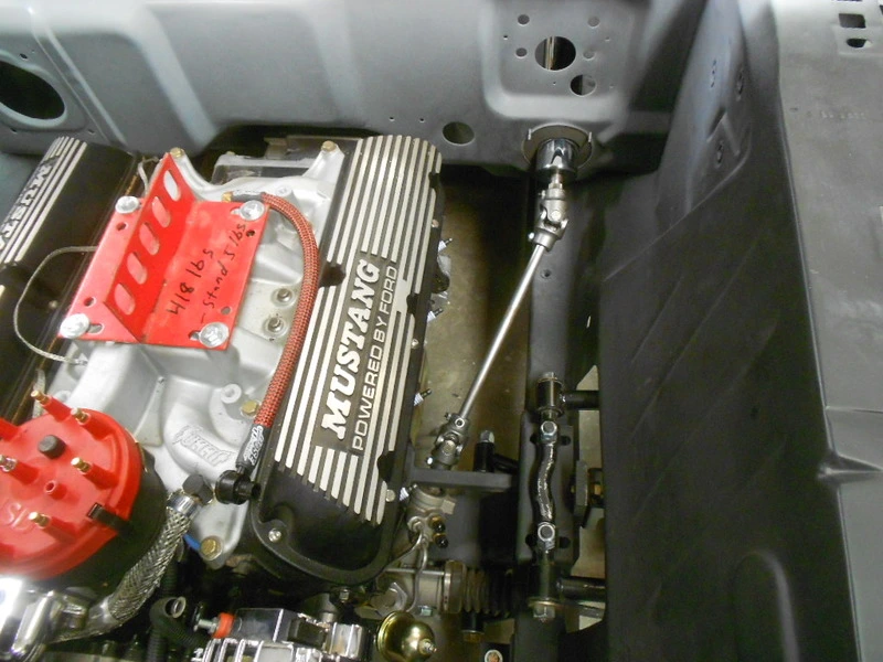

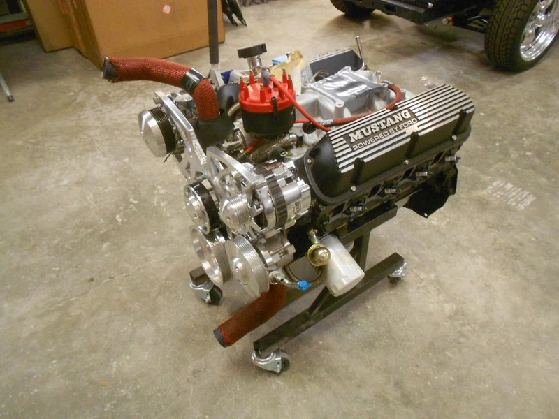

Getting ready to install the 347 engine and TKO transmission. Those hoses got to go.
Engine and trans installed

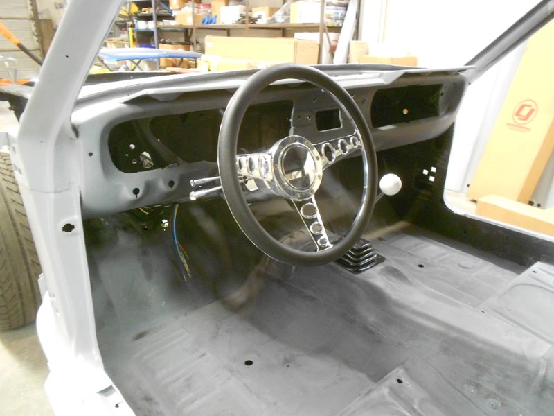

Ididit steering column with a Billet Specialties wheel
A few more photos
