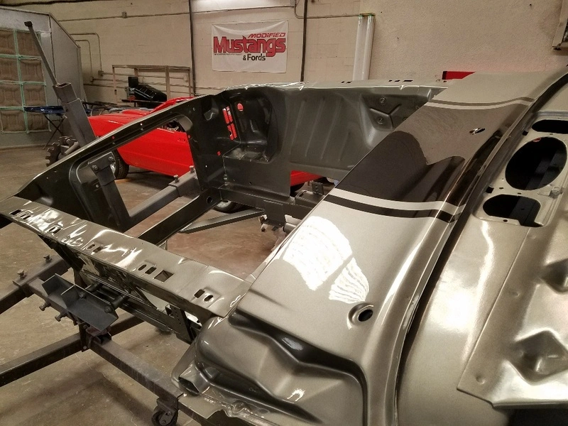

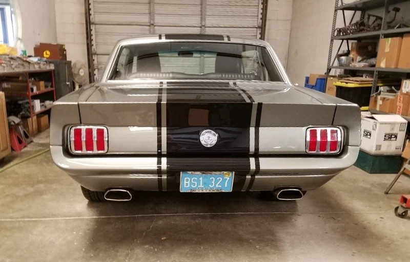

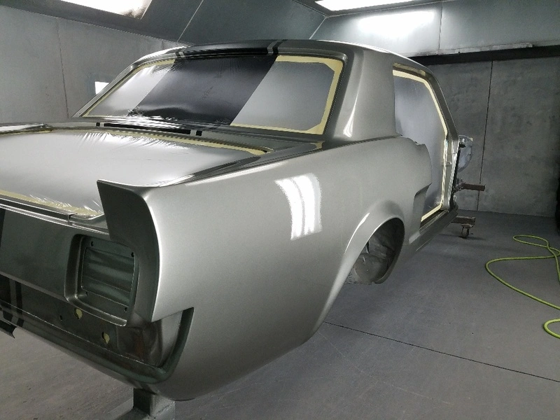

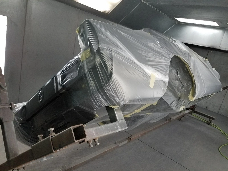

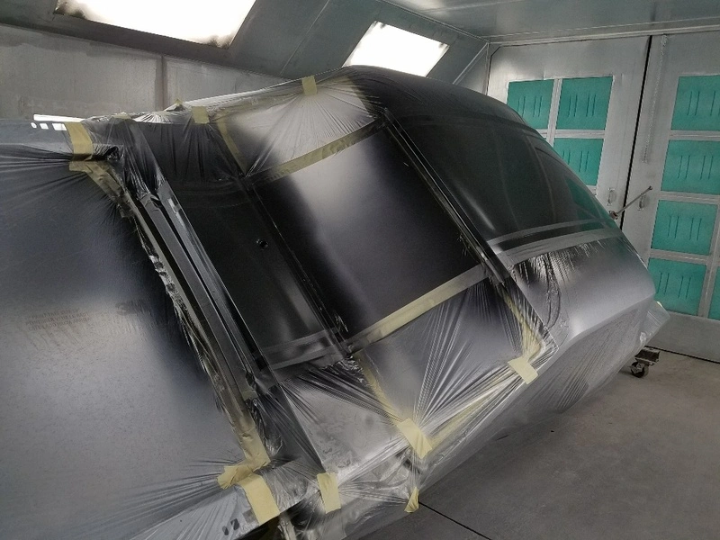

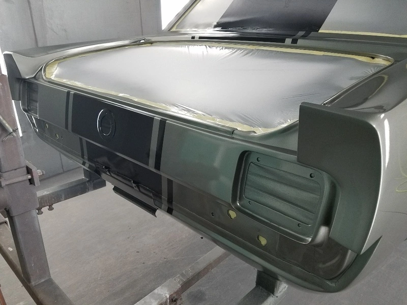

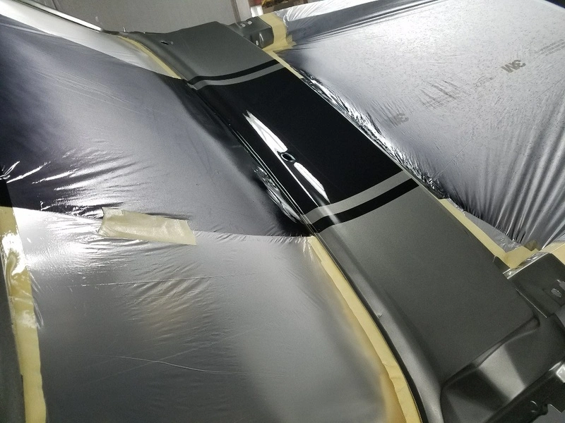

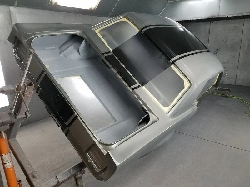

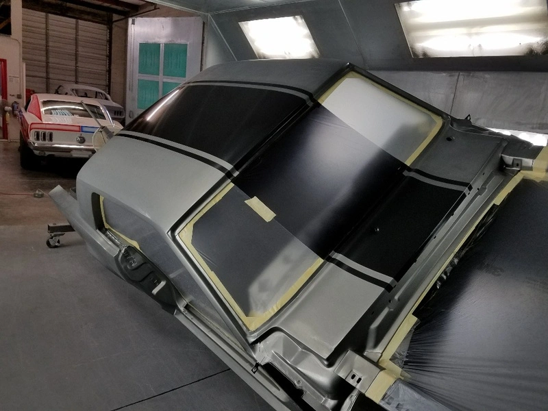

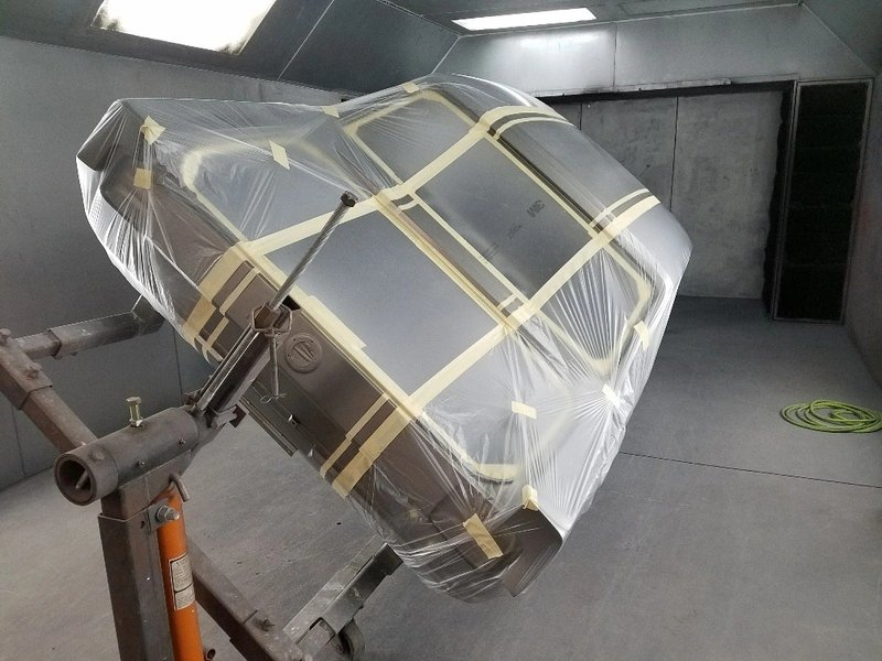

We finally sprayed the stripes on the body after Brian did a lot of taping
Three coats of metallic black
Ready for clear
Five coats of clear

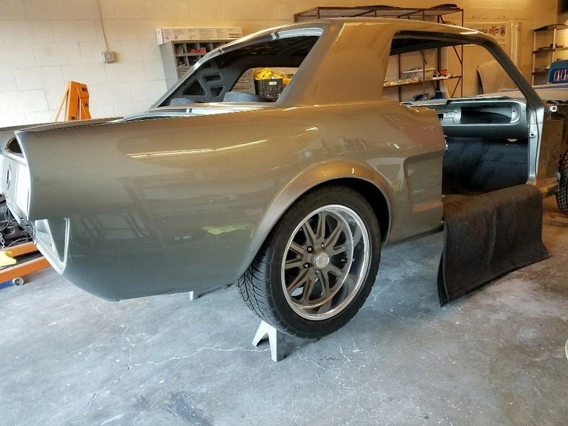

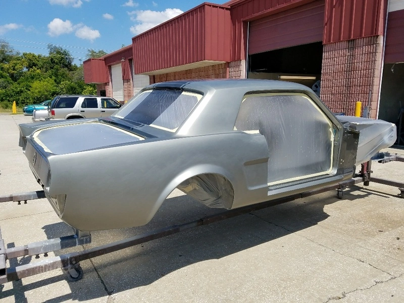

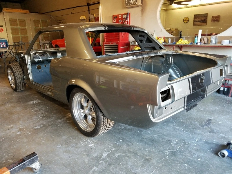

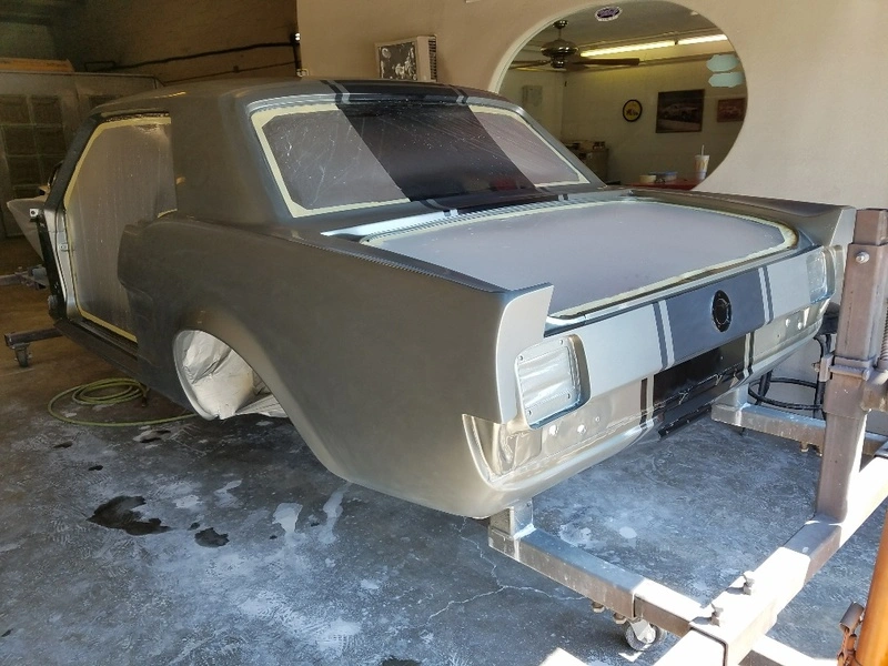

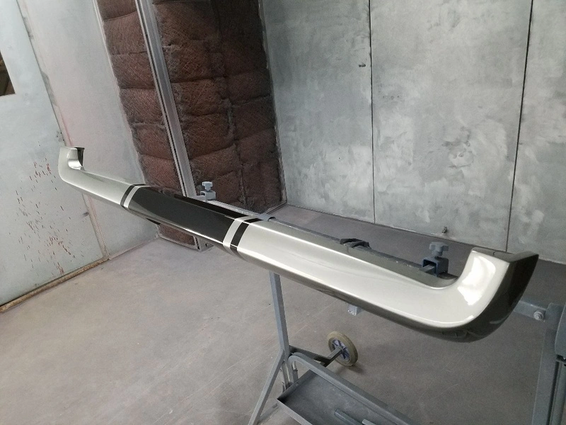

I painted the stripes on the rear bumper

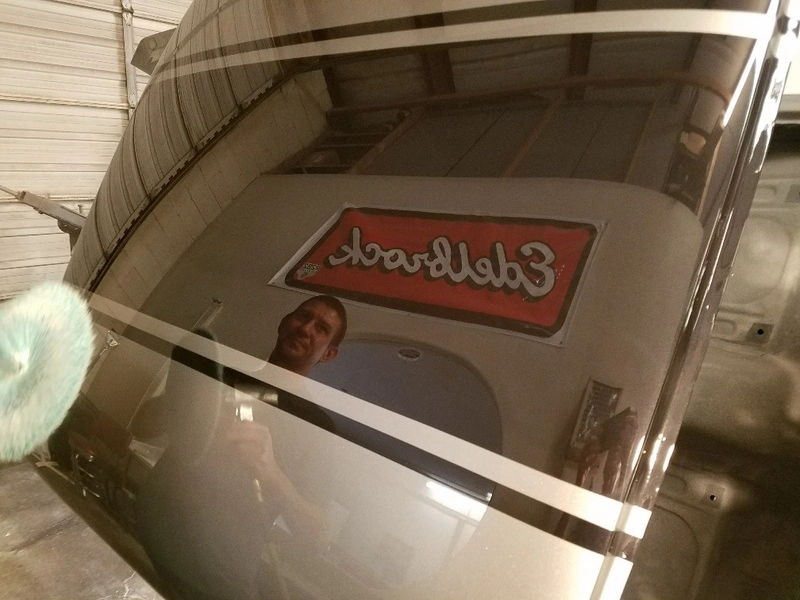

Brian wet sanded the body
We are going to put it out in the sun for a few days to get all the solvents out.

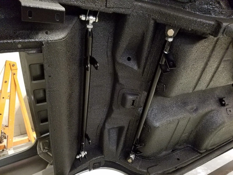

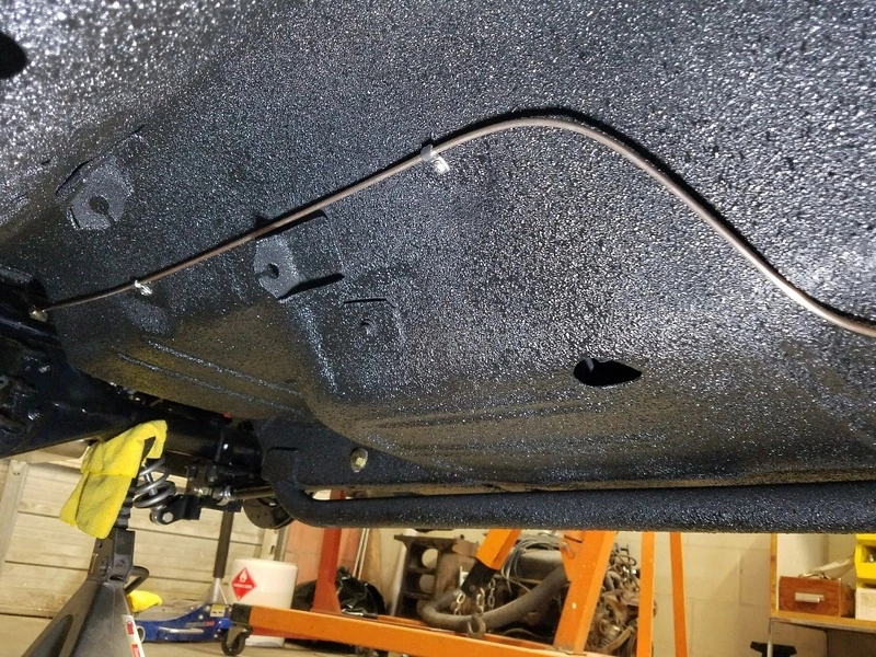

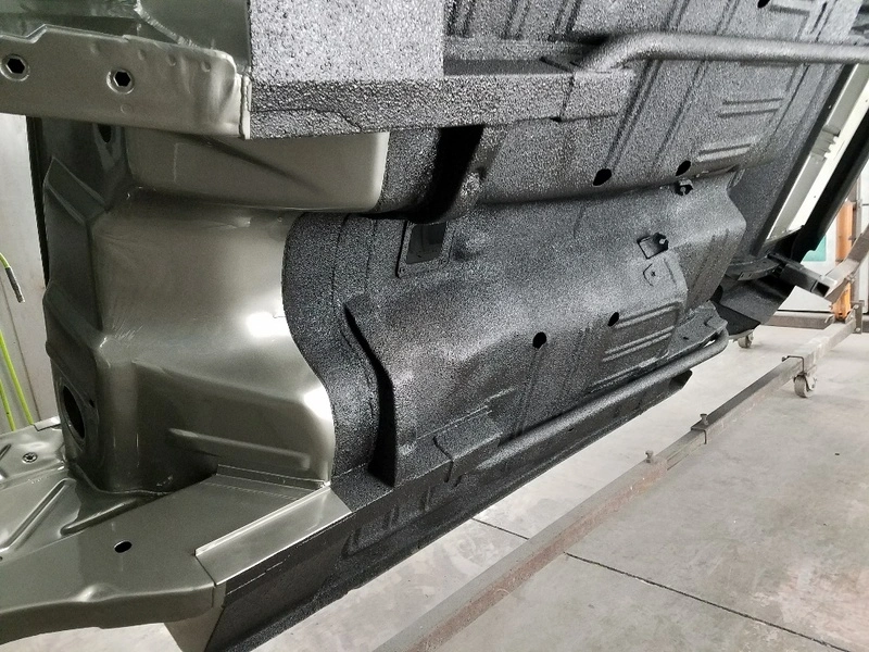

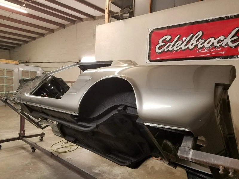

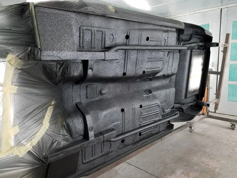

The undercarriage was sprayed with Lizard Skin and the next day I sprayed a couple coats of SPI black epoxy
Brian finished buffing

I like that under side ,i have done a couple with bed liner

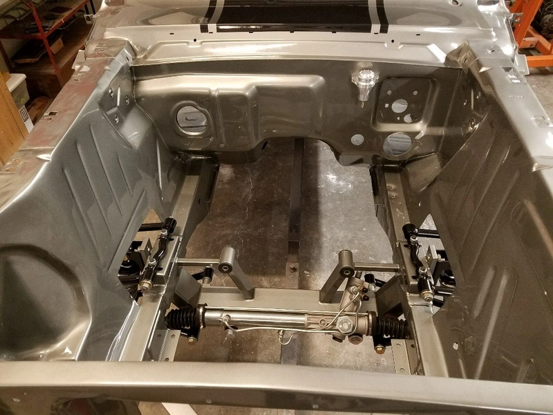

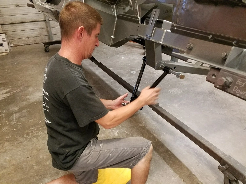

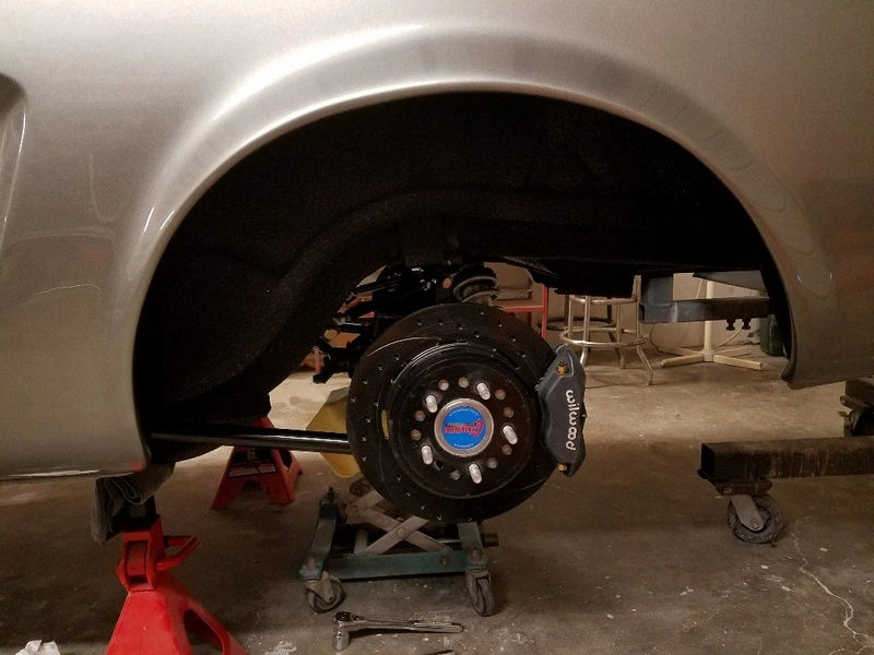

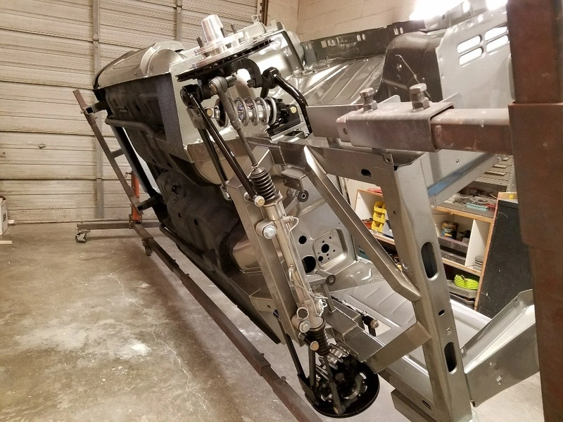

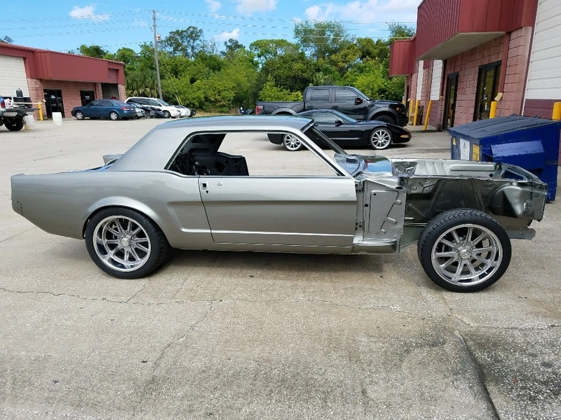

Brian installed the Rod & Custom front suspension
He also installed Rod & Custom rear suspension

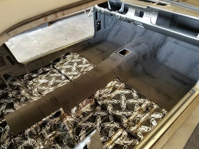

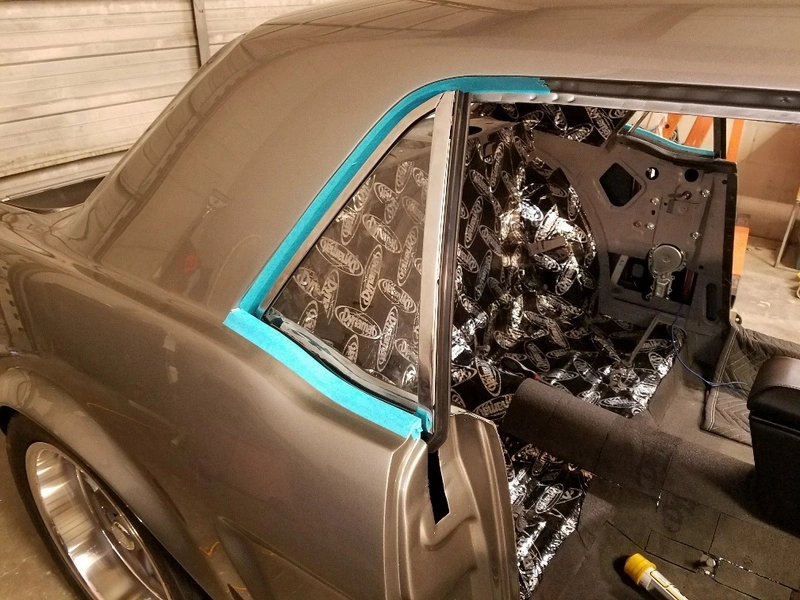

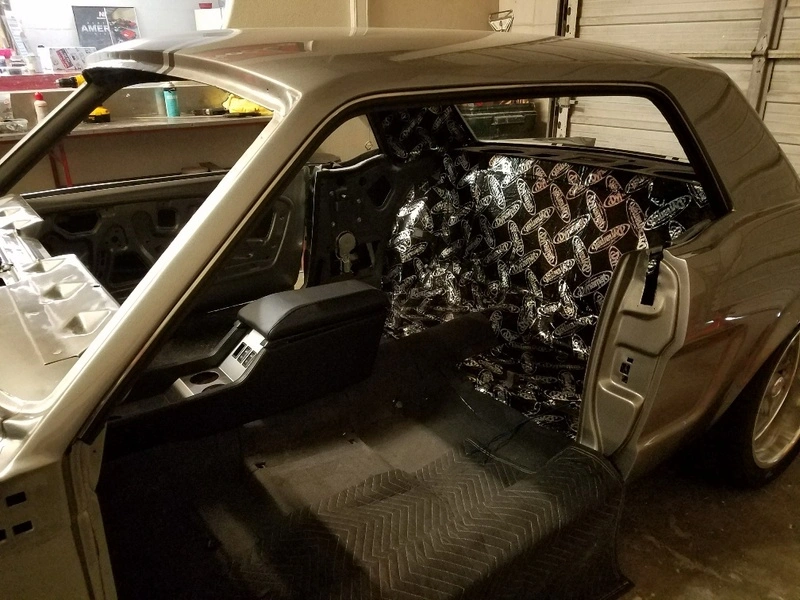

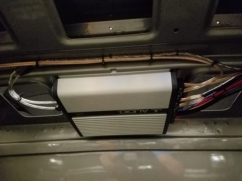

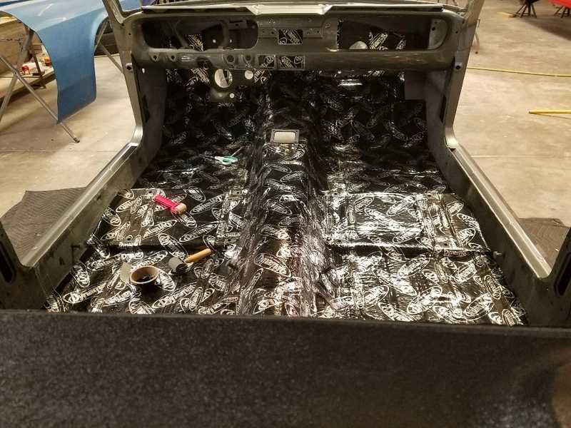

Dynamat

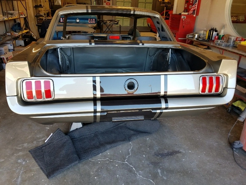

Changed the wheels
Power windows
Painted the bumper and lined up

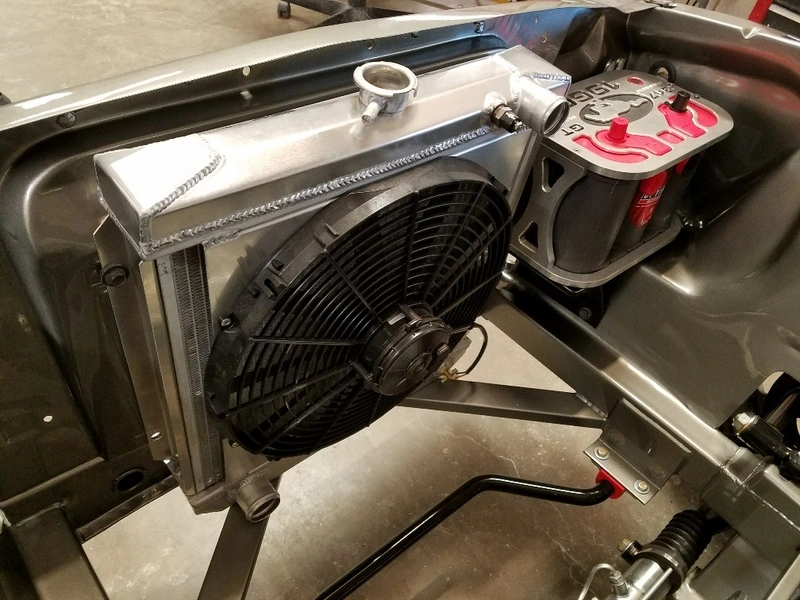

Test fitting the battery and radiator
Test fitting the Mustang to Fear console
Amp mounted under the package tray

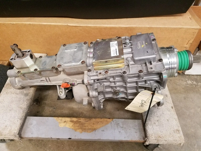

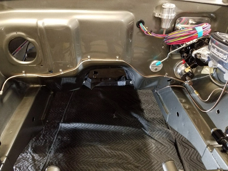

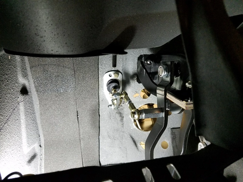

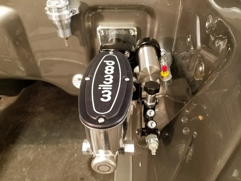

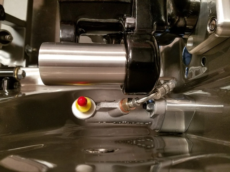

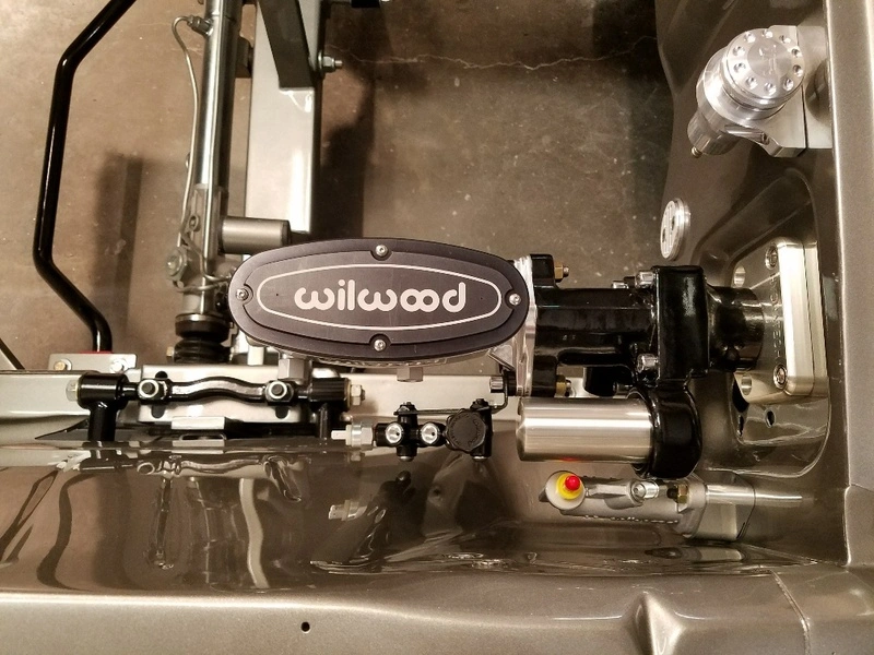

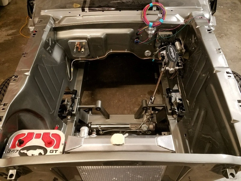

We could not find a power brake booster that would clear the hydraulic clutch master cylinder so we went with the Hydratech Braking System.
We still could not get the hydraulic clutch master cylinder to clear but found one from Modern Drive line that clears. Talked to Hydratech and they said have never had a problem but there was no way it would clear on our car. Looked at a couple of other 65 - 66 Mustangs in the shop and found that the aftermarket firewall on our project was not the same as the original one and that was our problem.
It's a tight fit but clears

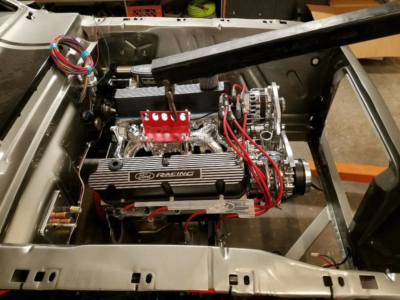

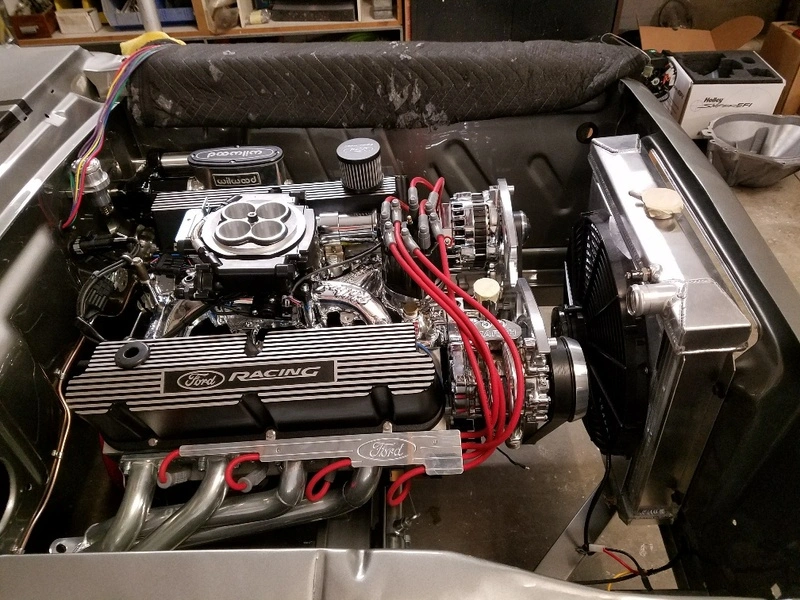

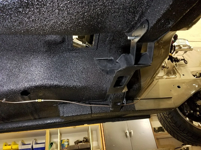

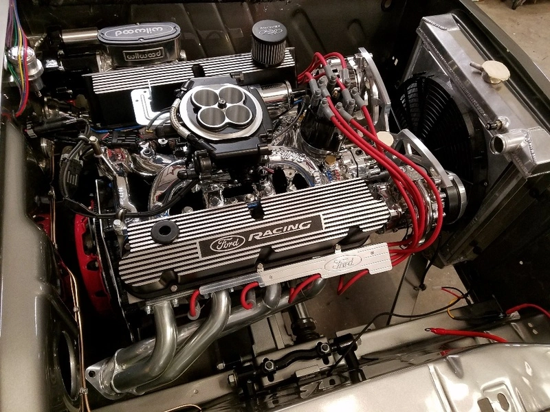

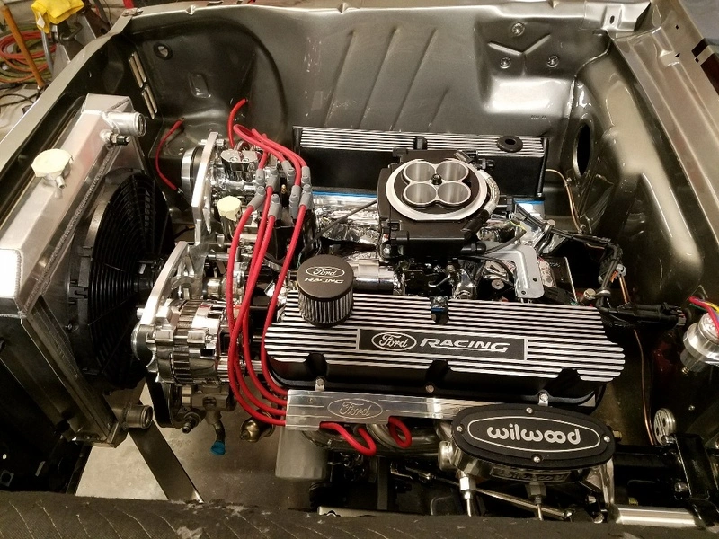

I fabricated the brake lines.

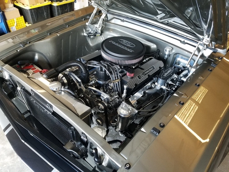

Almost ready to install the engine

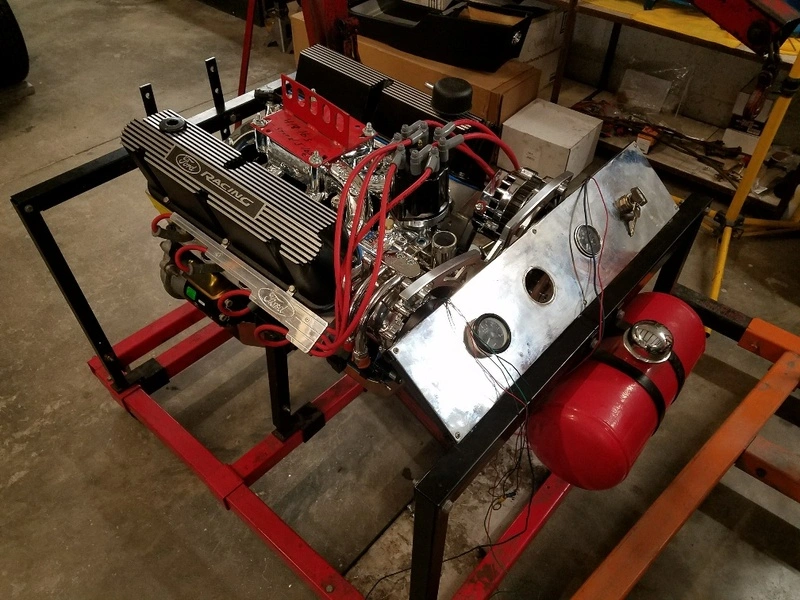

The 347 engine was started on a test stand with a carburetor to check for any leaks or problems

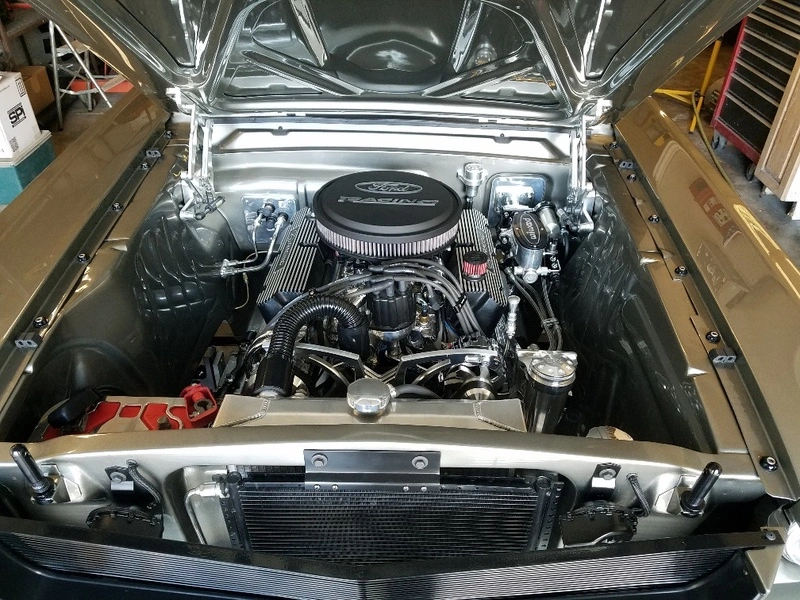

Installing the engine
We still have to install the transmission
Holley Sniper EFI and JBA headers. The plug wires will be changed to black Ford Racing

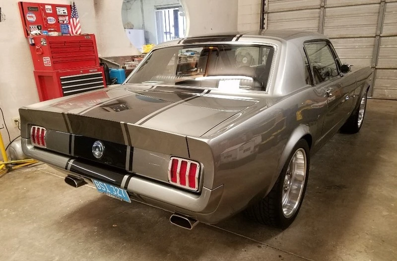

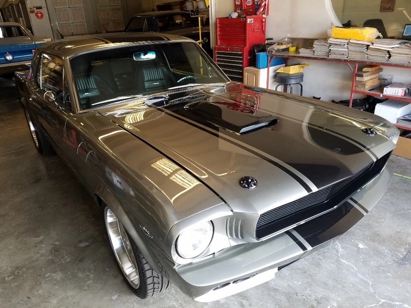

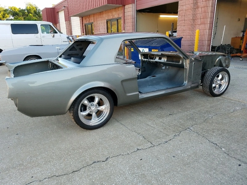

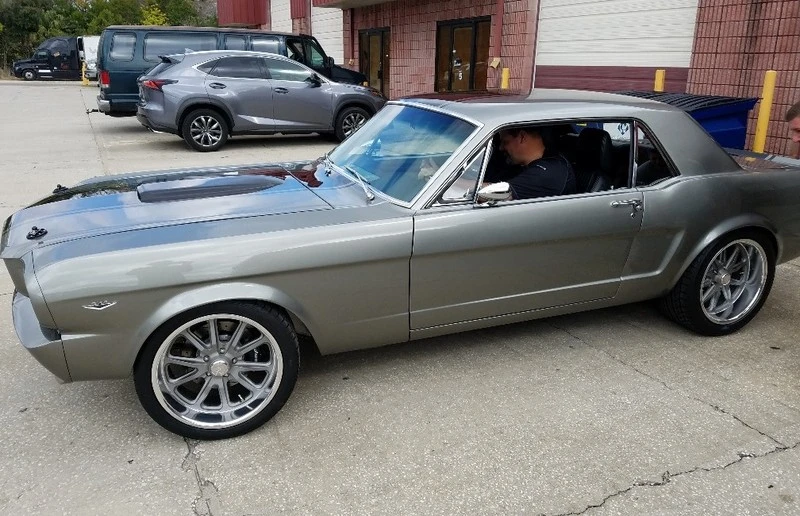

We finished this a few months ago and I forgot to update.
