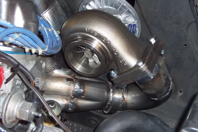

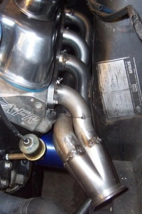

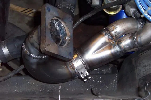

I got a little more done on the car. The drivers side header is finished and the turbo is in place. The passenger side header is partly welded and I hope to finish it in the next couple days and start the crossover. The plan for the crossover and downpipe is ambitious. I plan on running the crossover between the core support and the swaybar. When it gets to the other side it will curve up and toward the rear just a bit to clear the radiator outlet and then turn forward and up to join the drivers side. The DP will 90 right out of the turbo and go down in front of the cylinderhead and split into two 2.5" pipes. One pipe will turn straight back and the other will pass in front of the motor and then turn back on the other side of the motor. I still have a little trimming to do to get the compressor cover to fit. I am not sure it will all work, but that is the plan.

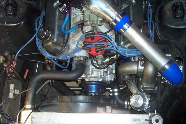

The car is on the road. The carb works surprisingly well. I have a programmable 6AL-2 on order which will help economy/driveability a ton. It is going to the track this weekend. Either the local 1/8 mile Friday or maybe Bowling Green Saturday. There is a big Mustang event in BG this Saturday. I doubt I'll make a full 1/4 mile pass until I get the tune nailed. I hope to go some low 7's in the 1/8. It feels strong enough, but I don't know how it will react to slicks. It does nice 45 mph rolling burnouts on the 245 gatorbacks though.
