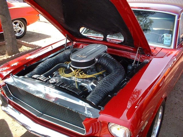

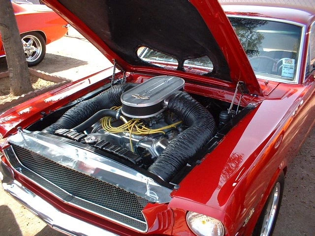

I can't help on the fitment end, but I can provide this for anyone wanting to see an SOHC 427 in a '65 fastback. :D I snapped this years ago at the Famoso nostalgia drags and car show in Bakersfield.
