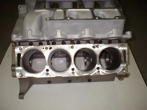

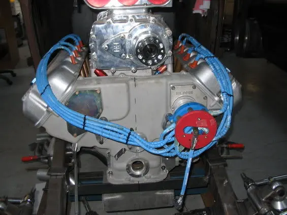

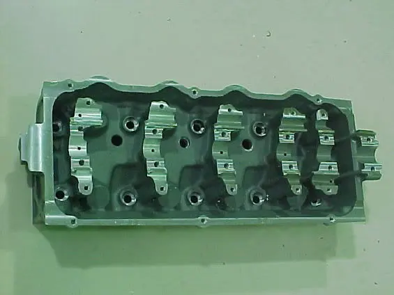

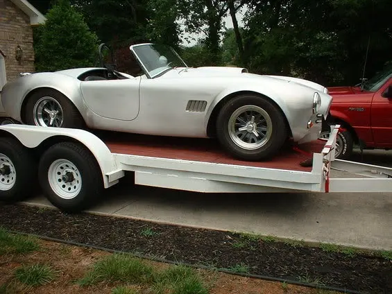

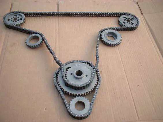

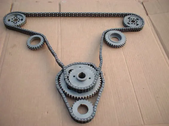

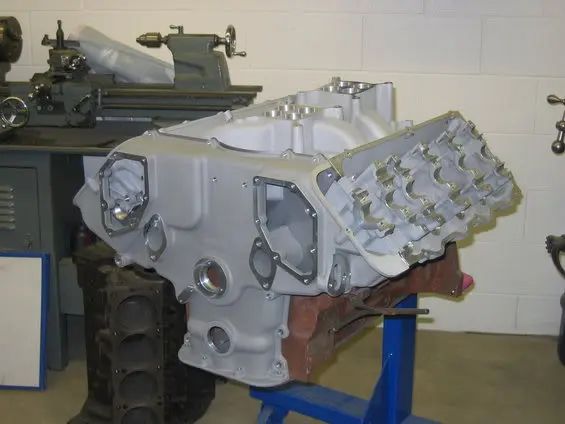

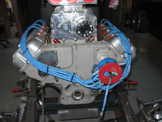

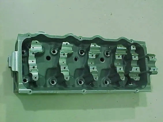

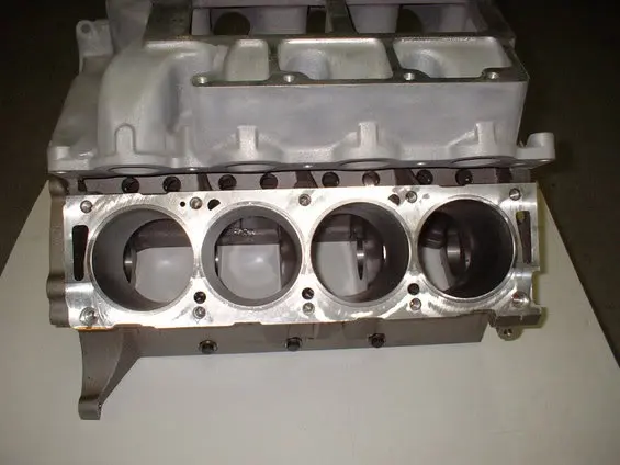

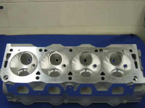

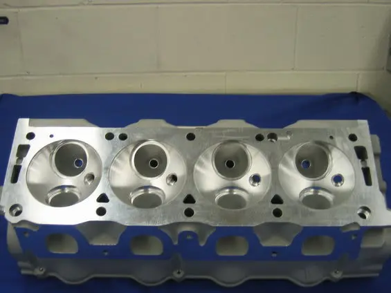

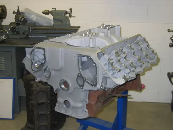

I have seen about enough parts to build about 3 "new" cammers. These parts are made in Australia. These are now available cause the guy I was talking about is building one to go in a aluminum cobra. Here's a few pictures....
mock up
