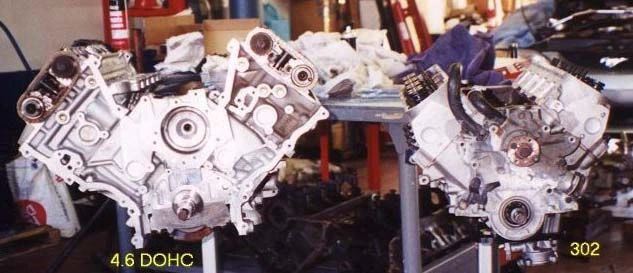

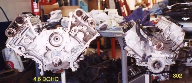

The modular motor (DOHC) is also very wide, if you know anyone that has swapped one of those in, you may be able to get some additional ideas.
I just love posting pictures. :D

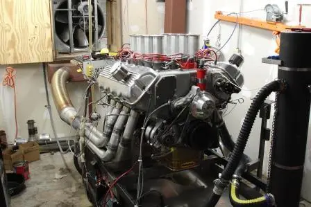

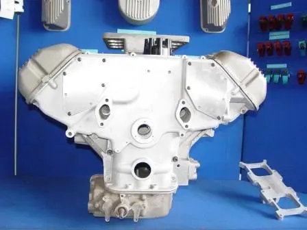

I have attached 2 pics. One is of an all aluminum Cammer 427. SHE IS WIDE! The other pic is of a cammer 427 on a dyno. Note the location and direction of the headers. anyone see any future issues for me here. I was told that this unique feature of teh SOHC will made fitting it easier, not harder! comments?
