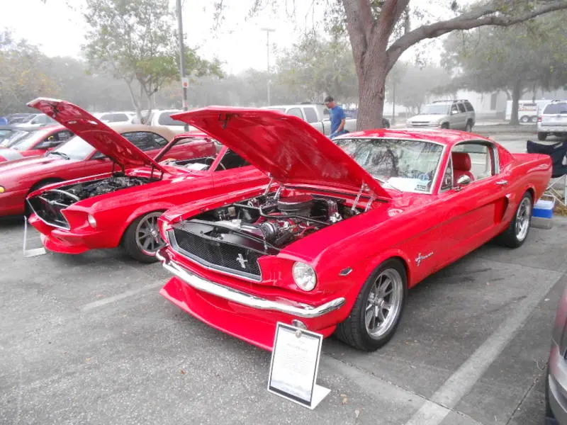

We went to a car show yesterday and parked beside the 1965 Fastback I painted SPI Viper red five years ago. The fastback still looks like it was just painted

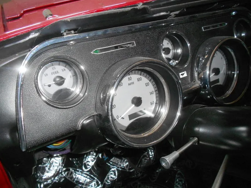

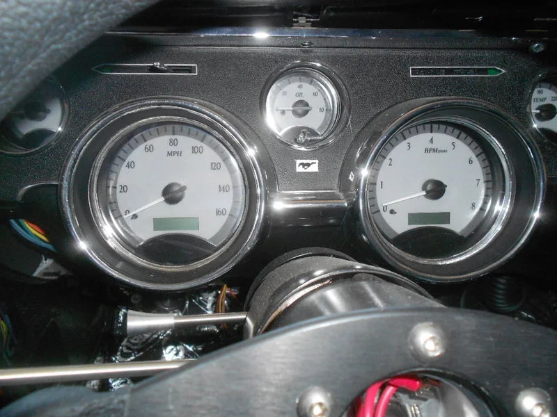

If you ever want to put in something "updated" for the dashes, check out a dakota digital dash. They're made over where I live and they're great quality. Couldn't tell if thats what you put in it or not, but i figured id give a shameless plug :)
saving up right now to put one in my '68:
they're a pretty sweet little unit. Fits right into the stock bezel.

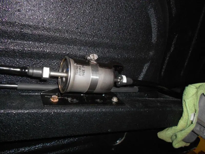

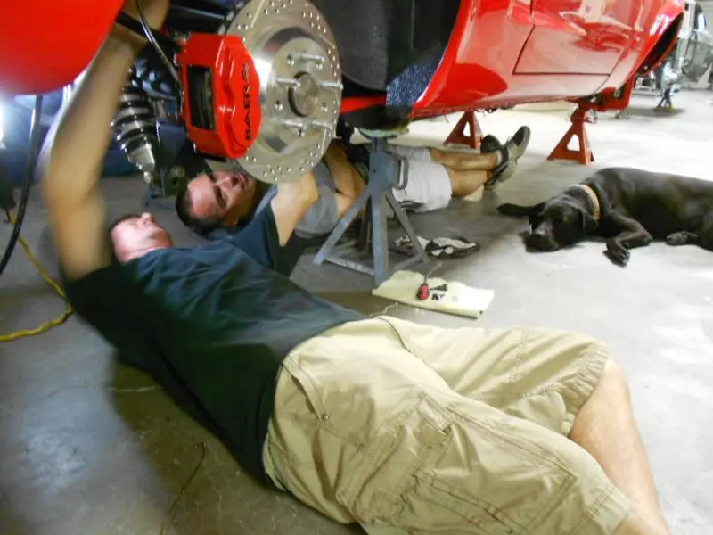

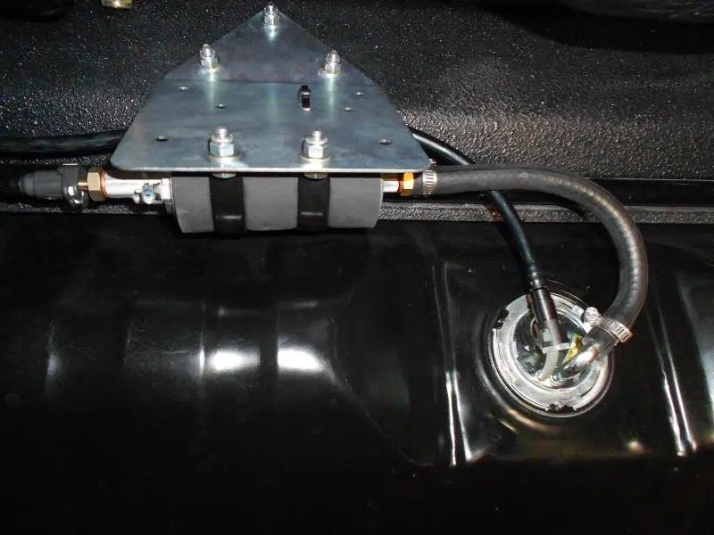

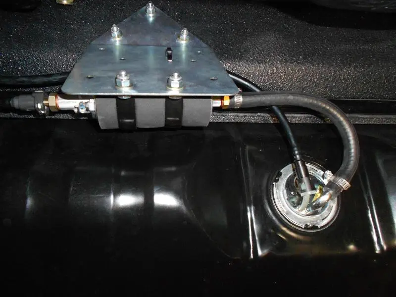

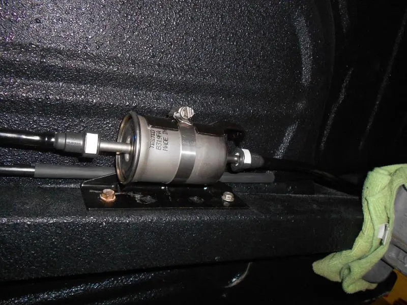

My son Brian, Steve Baur (former Modified Mustangs & Fords editor) and Buddy installing a Ron Morris EFI fuel pump and lines for a story that was featured in the magazine.

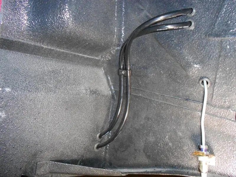

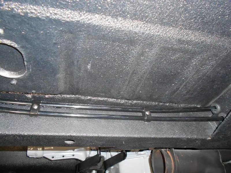

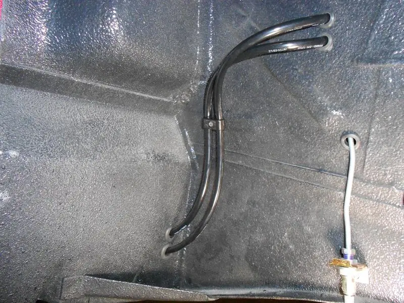

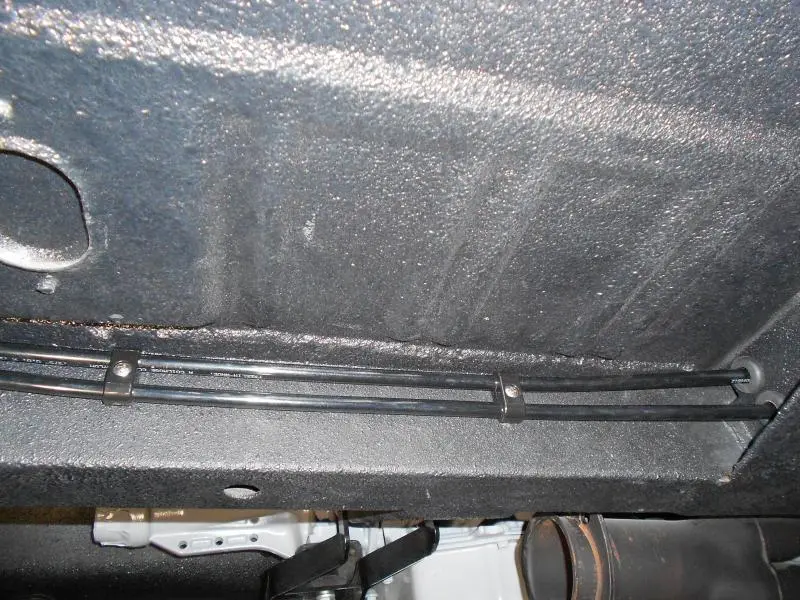

The fuel lines and filter are attached to the subframe connector
They go through the torque box and into the engine compartment

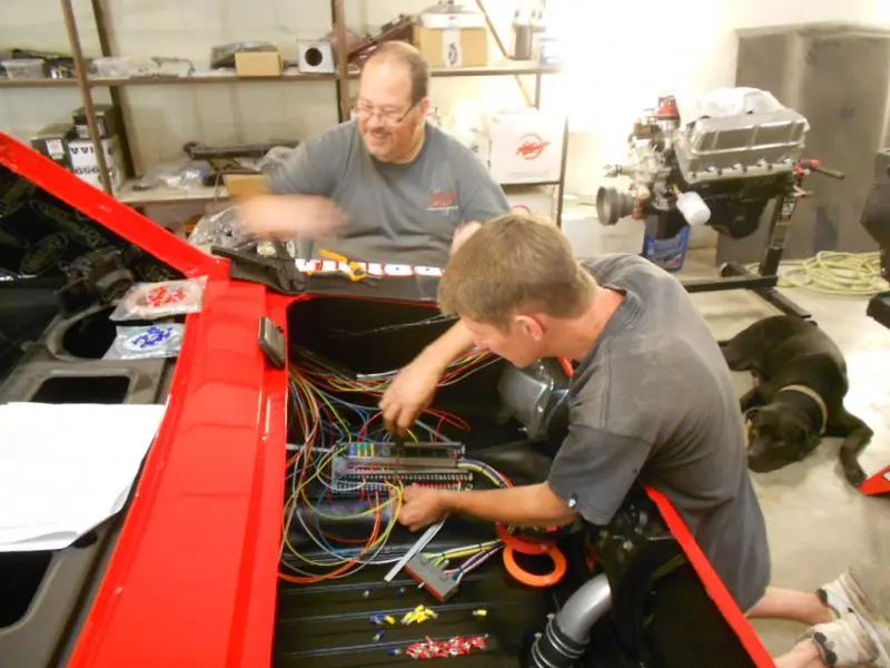

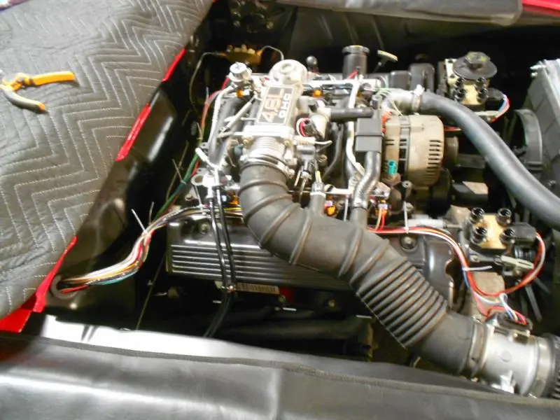

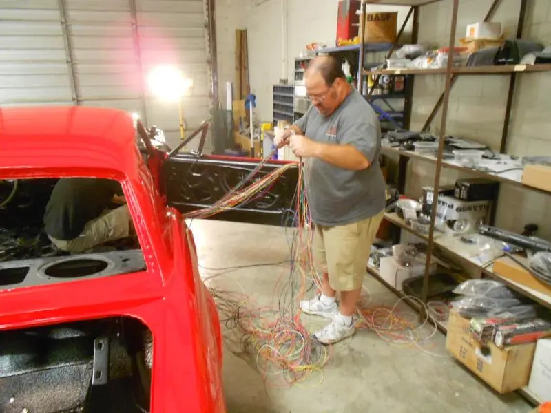

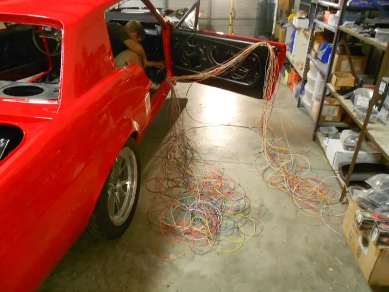

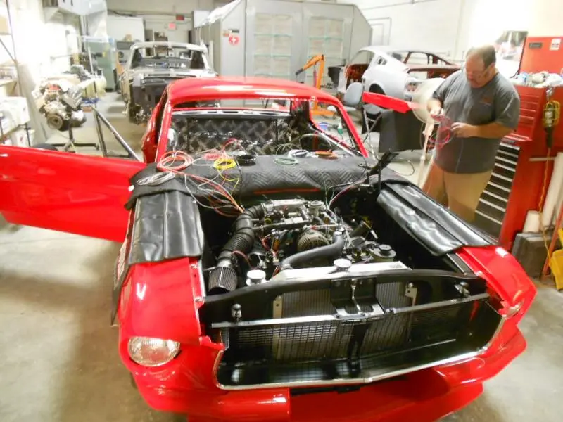

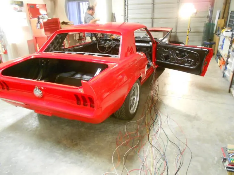

I forgot to show this but awhile back Mark Houlahan came by the shop to help us install the Ron Francis wiring harness for the SOHC Mod motor.
We are not finished under the hood
Brian was helping Mark
Takes a lot of wires to run a modern engine
Every wire is numbered so you can't make a mistake if you hook it up to the same number on the control panel that is plugged into the stock Ford computer.

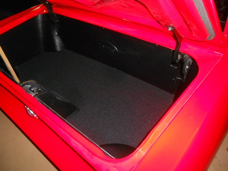

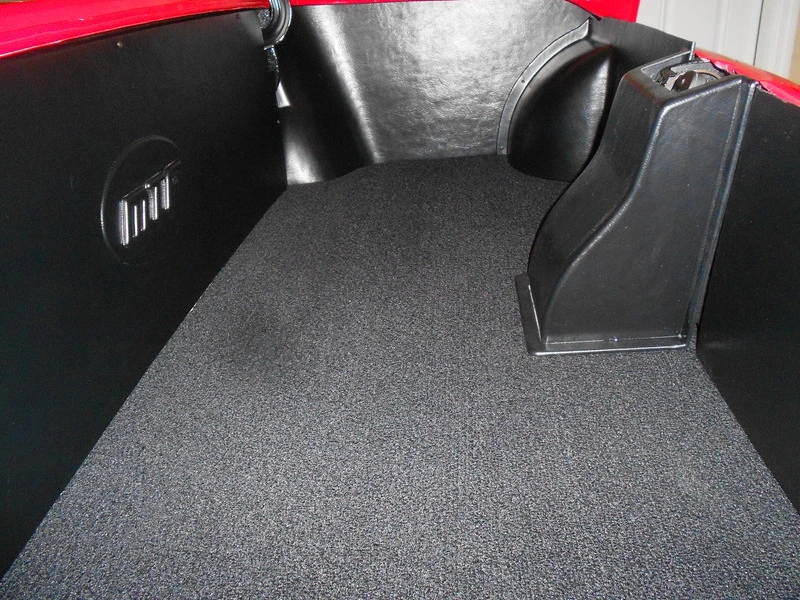

Brian and I were trying to figure out what we were going to do to cover up all the wires in the trunk and we found out about Mustang to Fear's trunk kit for the coupe. At the time we inquired they only had one made for the Eleanor style taillights. Rich said he was going to make one for the stock taillights and we also received the first gas filler neck cover.
We still have to make a bracket to mount the computer and control panel behind the the Mustang to Fear trunk panel kit.
You can read all about the install How to Finish Off Your 1967-1968 Mustang?s Trunk
