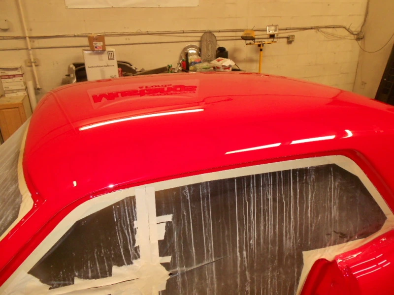

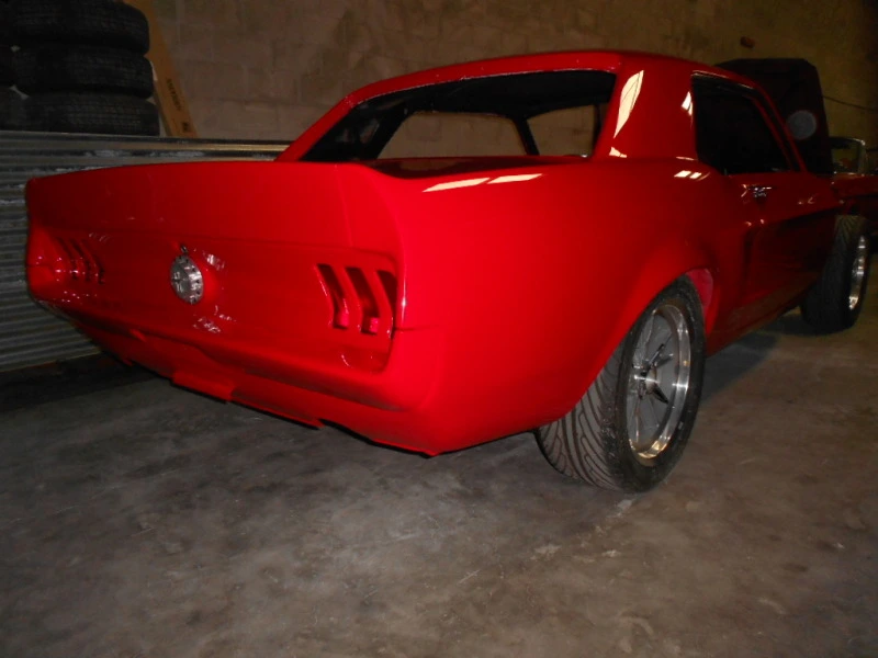

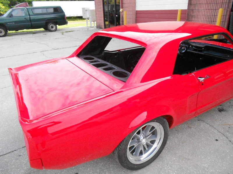

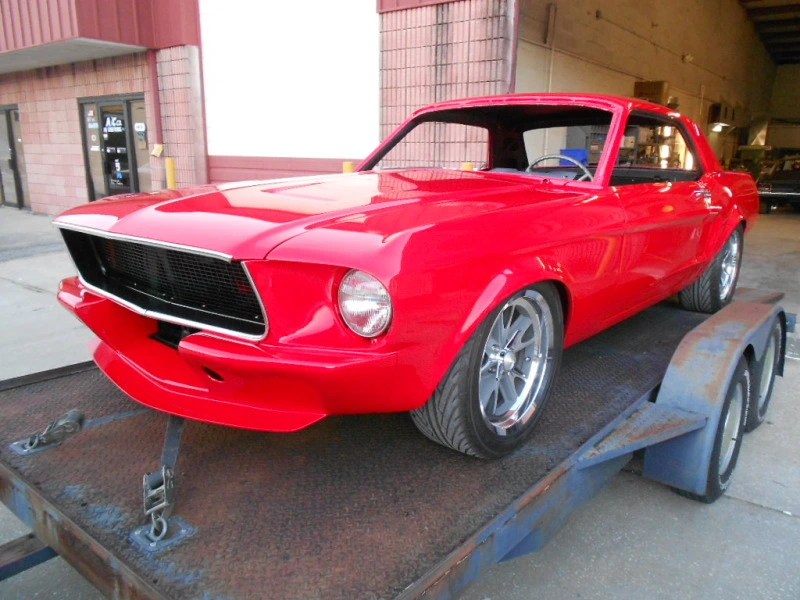

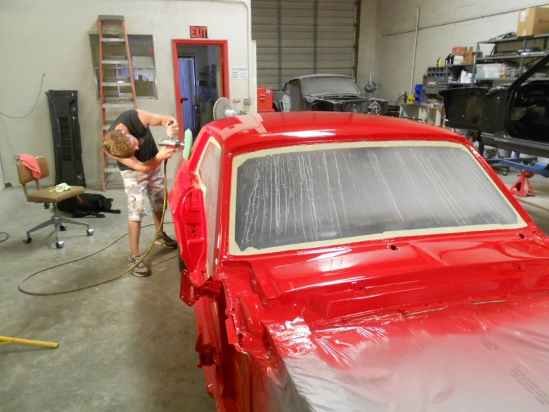

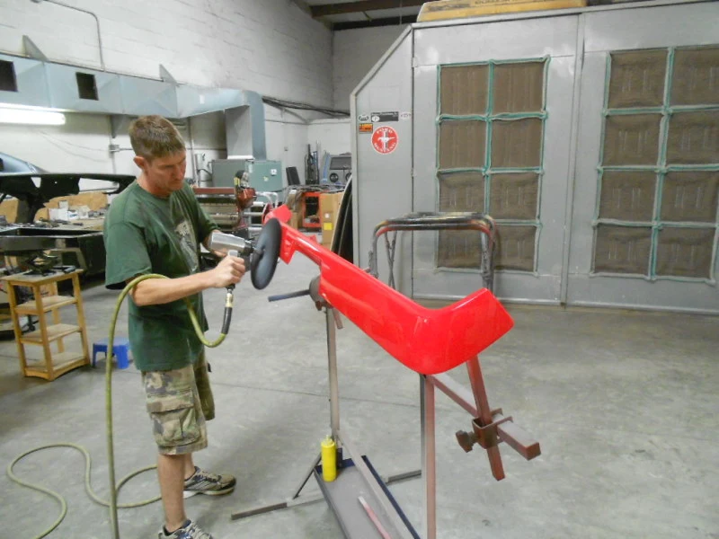

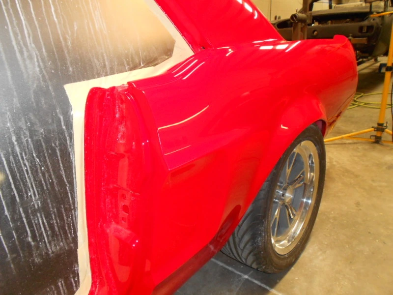

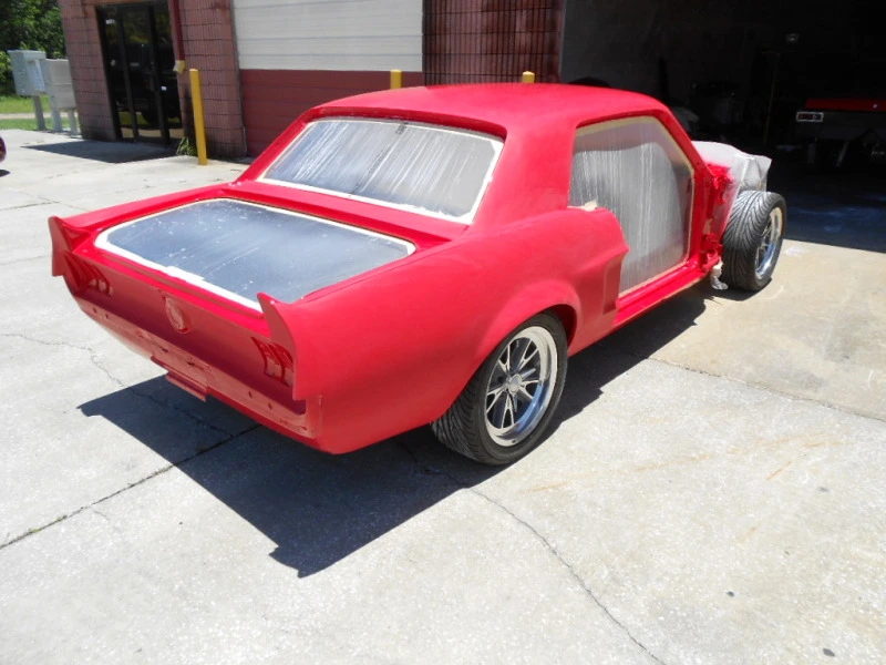

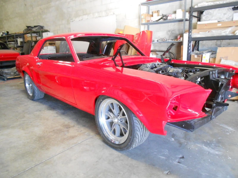

The body was wet sanded with 1000,1500,2000,2500.
One side is buffed still needs to be polished

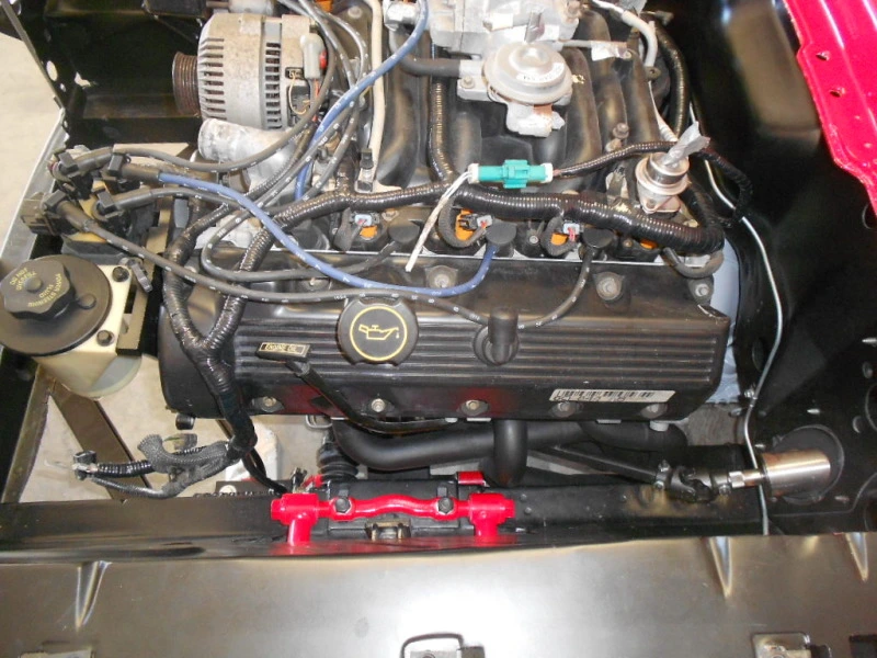

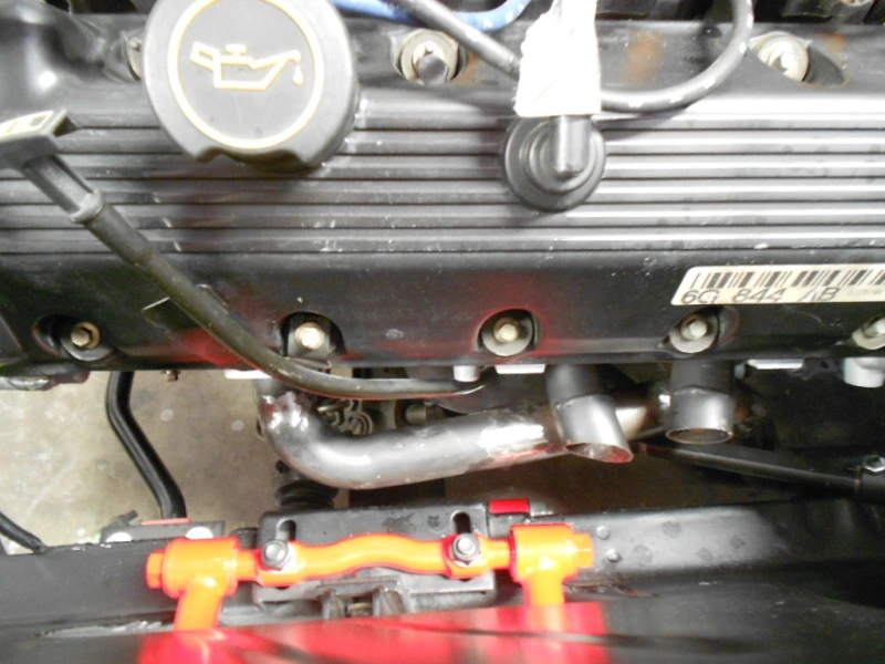

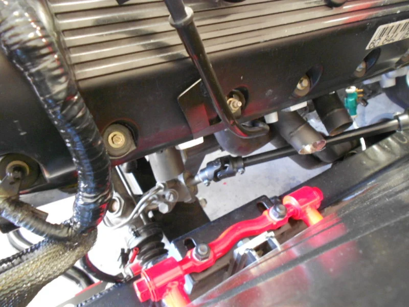

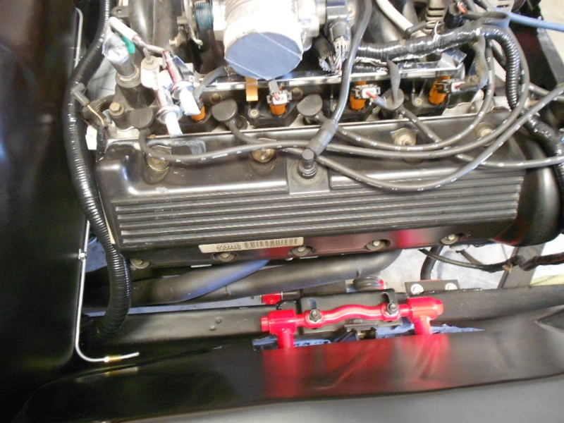

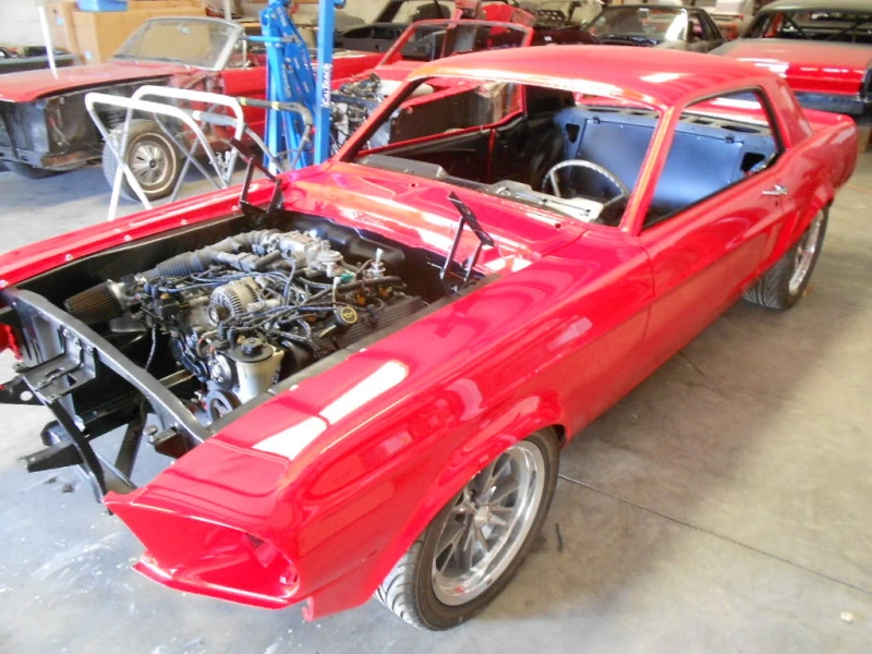

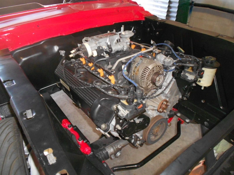

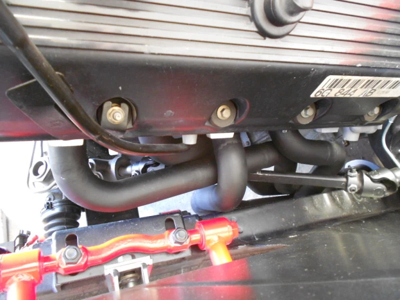

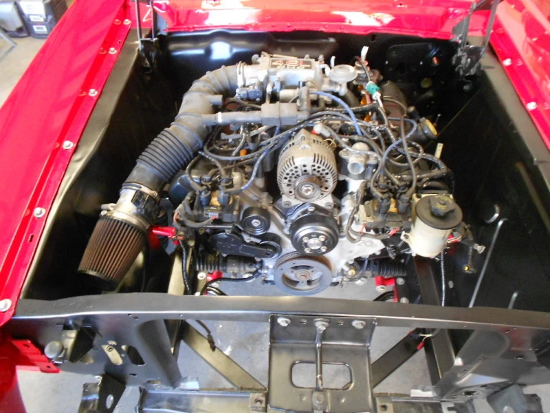

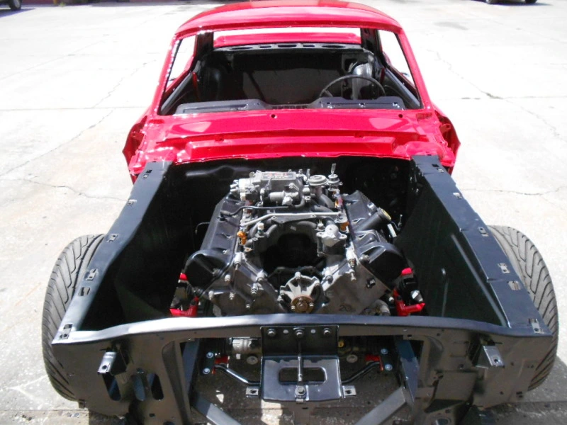

I love how you have a 4.6l in there....and still have room! Cutting out those shock towers adds a lot of room. I just cut mine out today for a 351c. I love this build! Will be watching.
BTW, what is your opinion on the R&C kits? I am installing one at the moment.
I'm very happy with Rod & Custom kits I think they are the easiest to install we have finished three and have one under construction.
