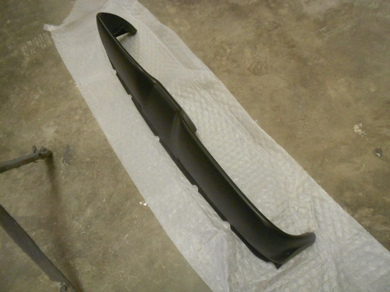

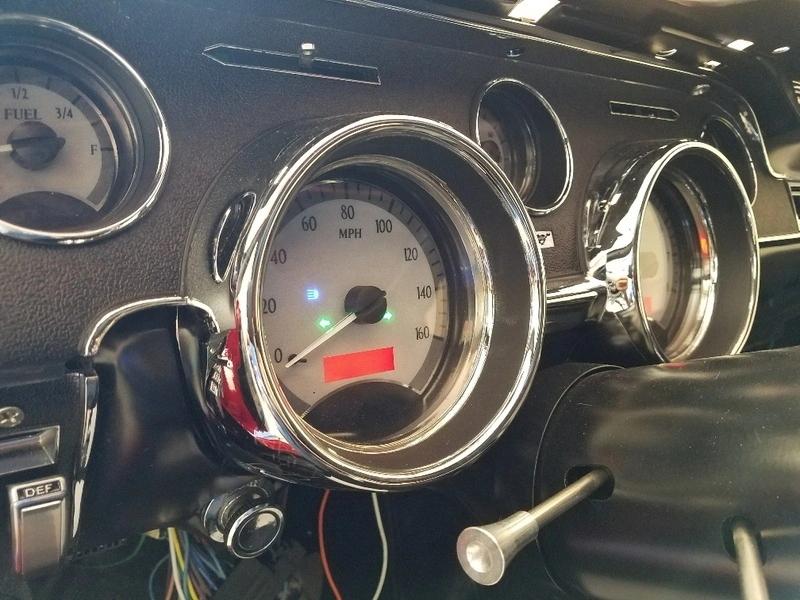

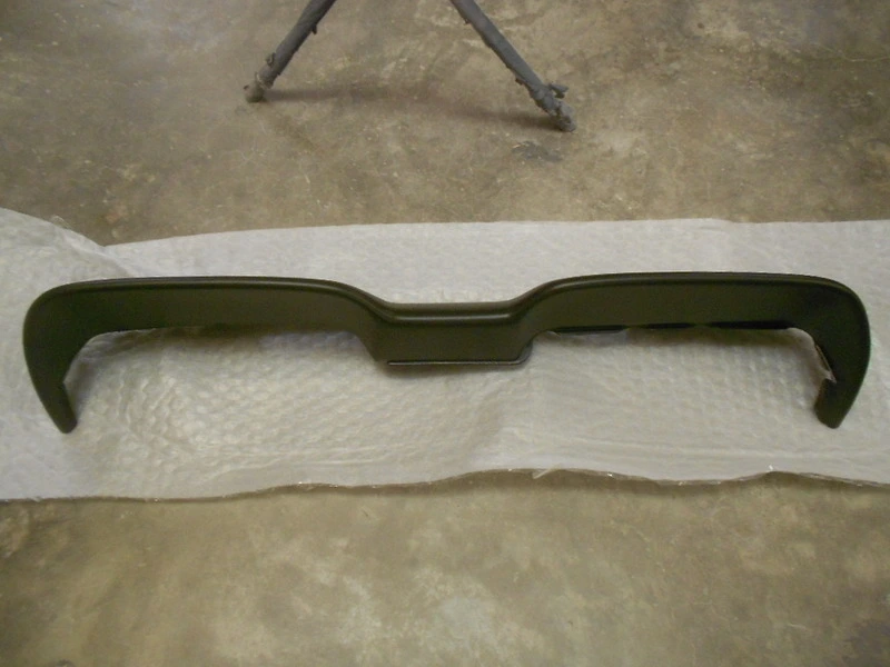

Mustang to Fear dash pad came in a long time ago and is a very well made dash pad. Now if I can only get the wiring straightened out under the dash I can install it.

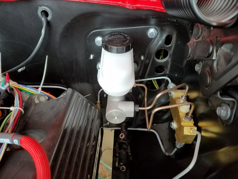

I ran out of room at the shop so I moved this to my house and started working on it again on the weekends.

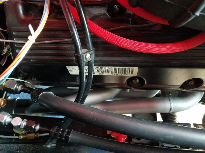

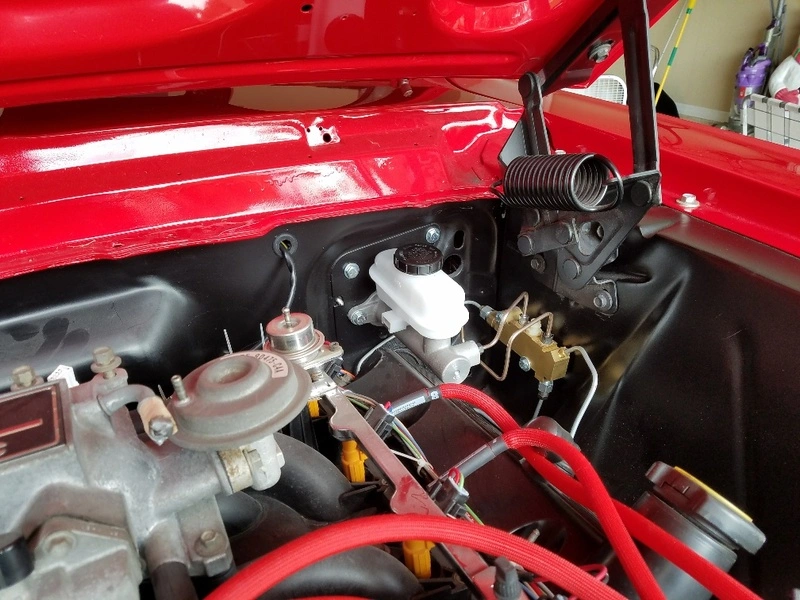

I had a hard time finding a master cylinder that would clear the cam cover and did a search on line and found this Bronco II master cylinder and it fits.

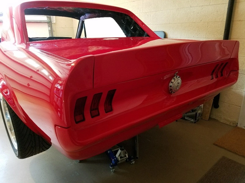

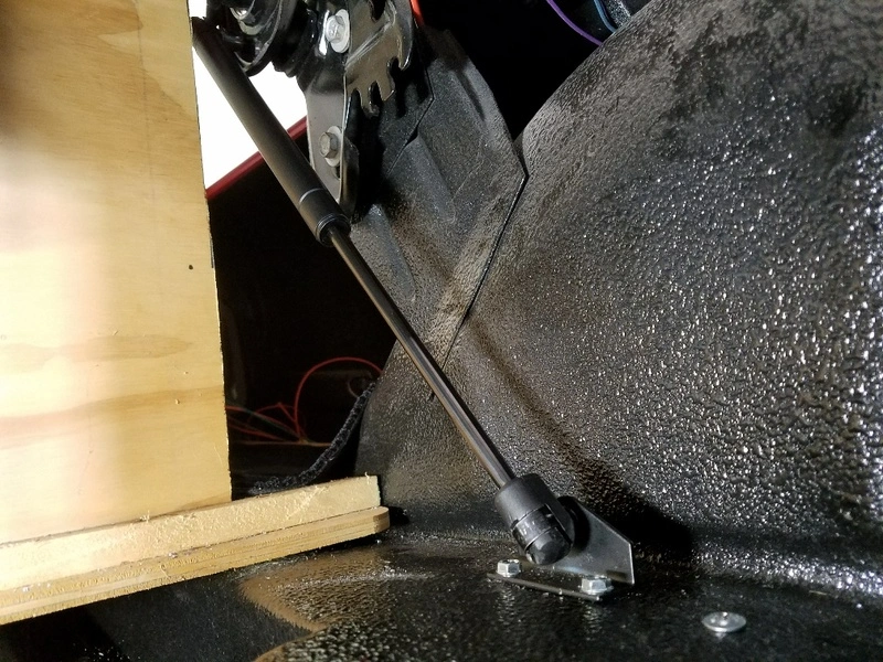

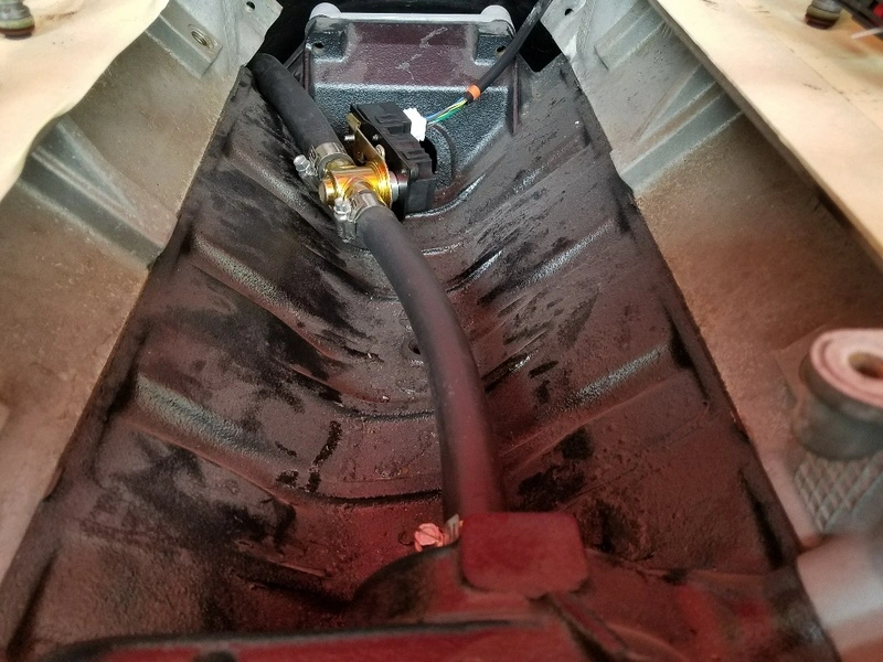

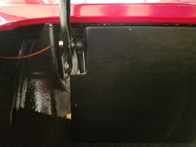

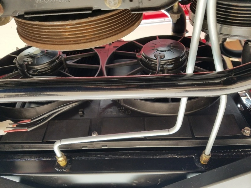

I have been using a board to hold up the deck lid after searching I found these struts from Mustangs Unlimited

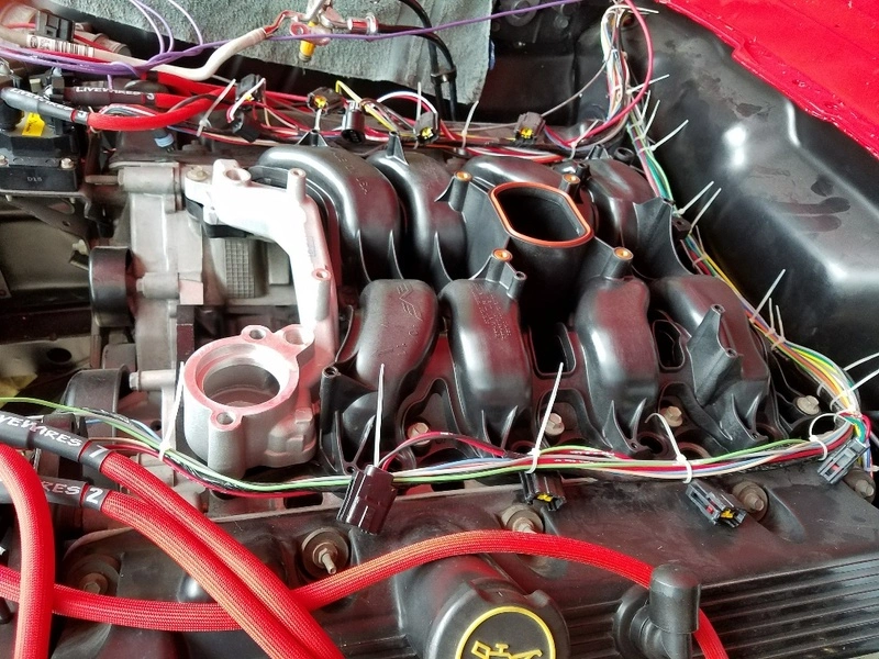

My intake was cracked while I was replacing it I found a good place for the AC valve
New intake

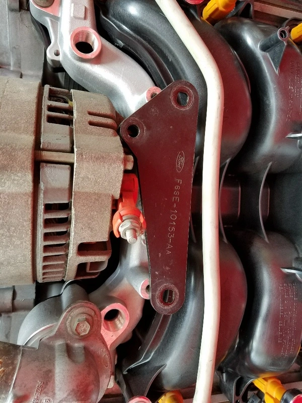

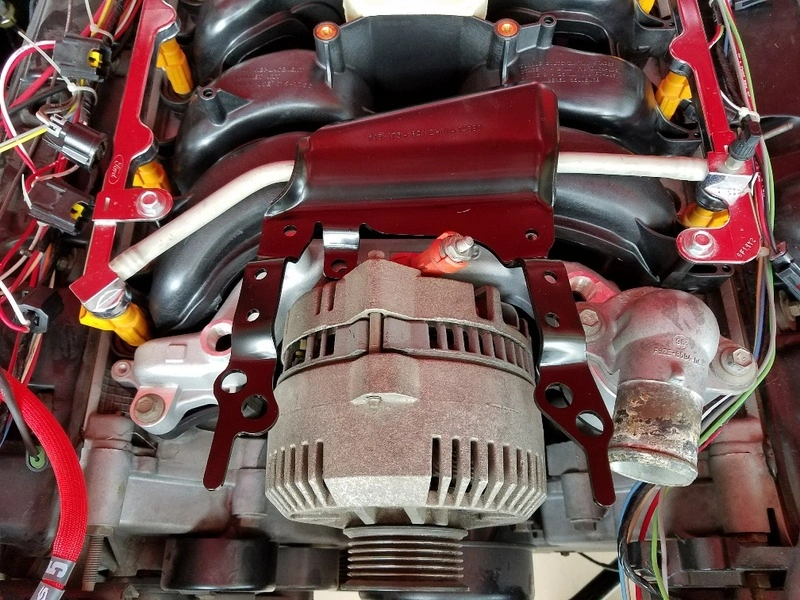

Next problem I had was none of the brackets for the alternator would work so we had to cut and modify the first one to fit. Sorry no photo

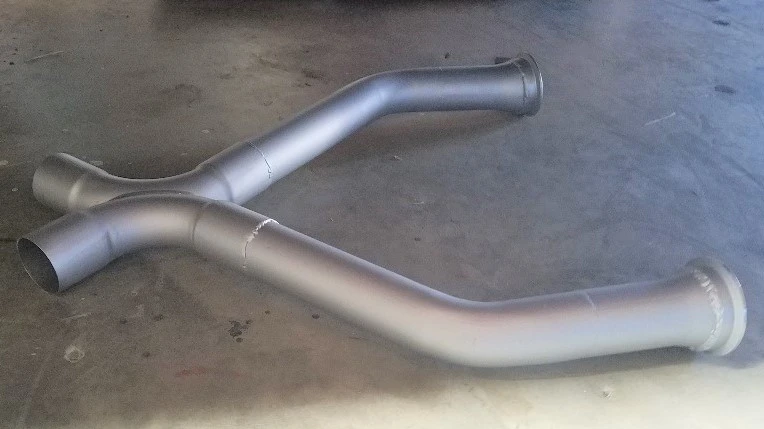

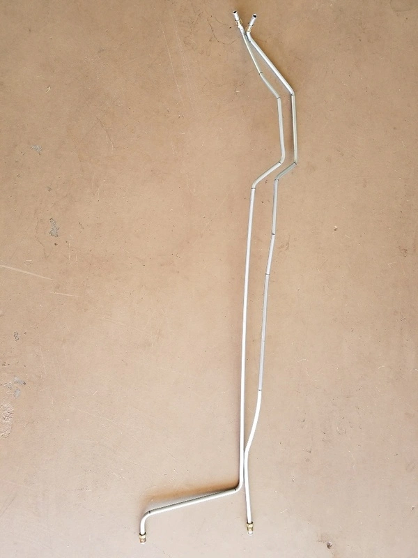

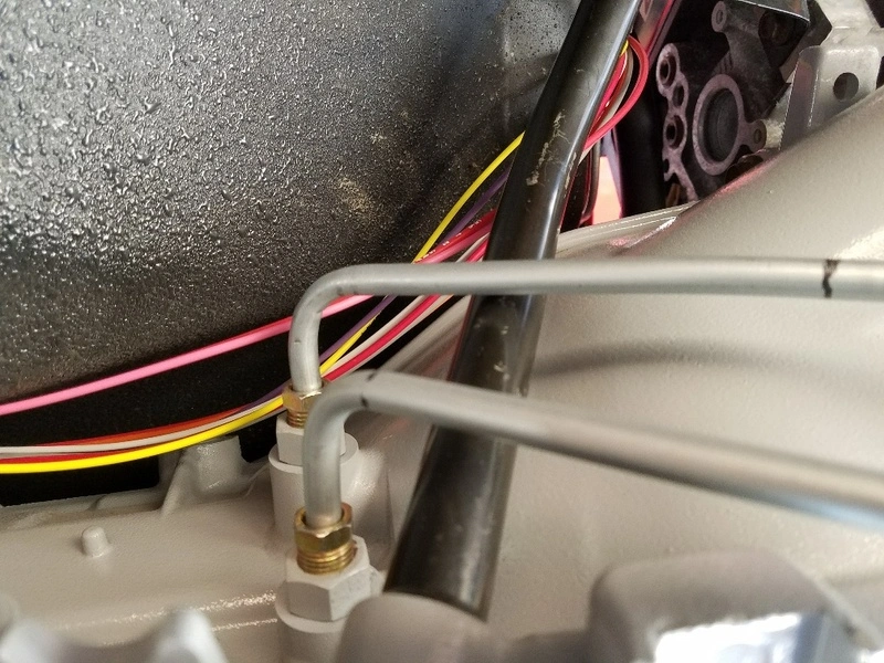

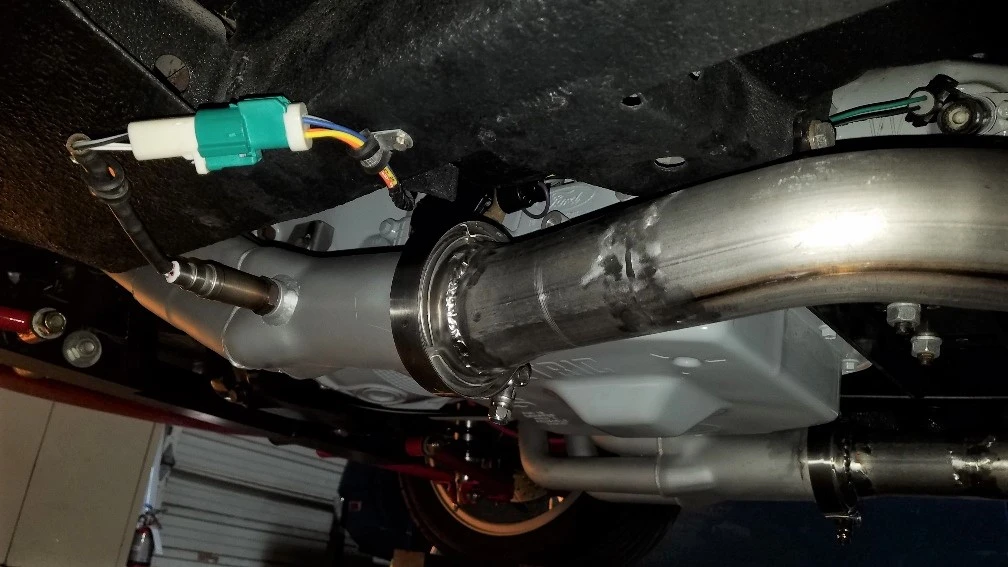

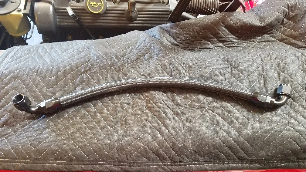

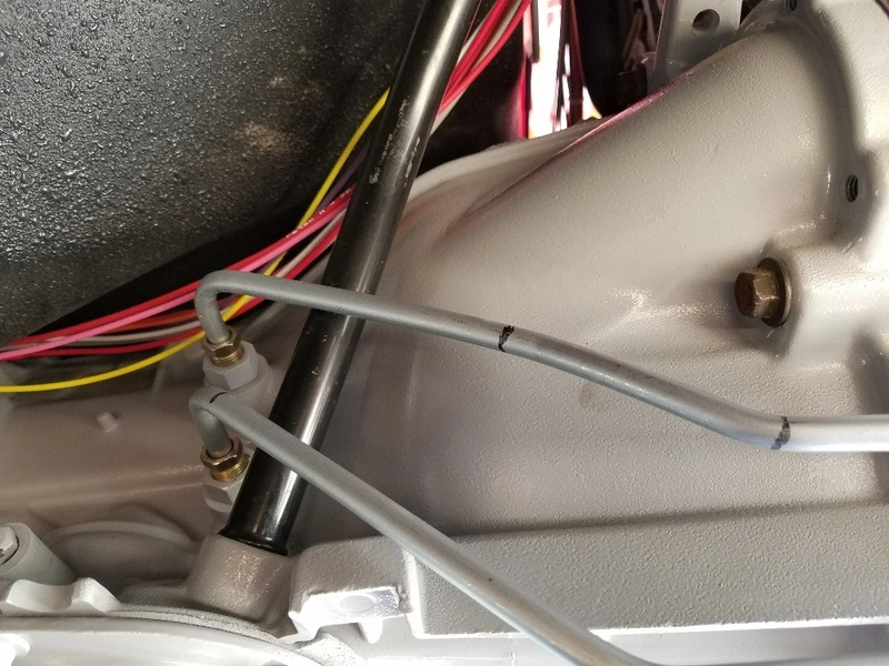

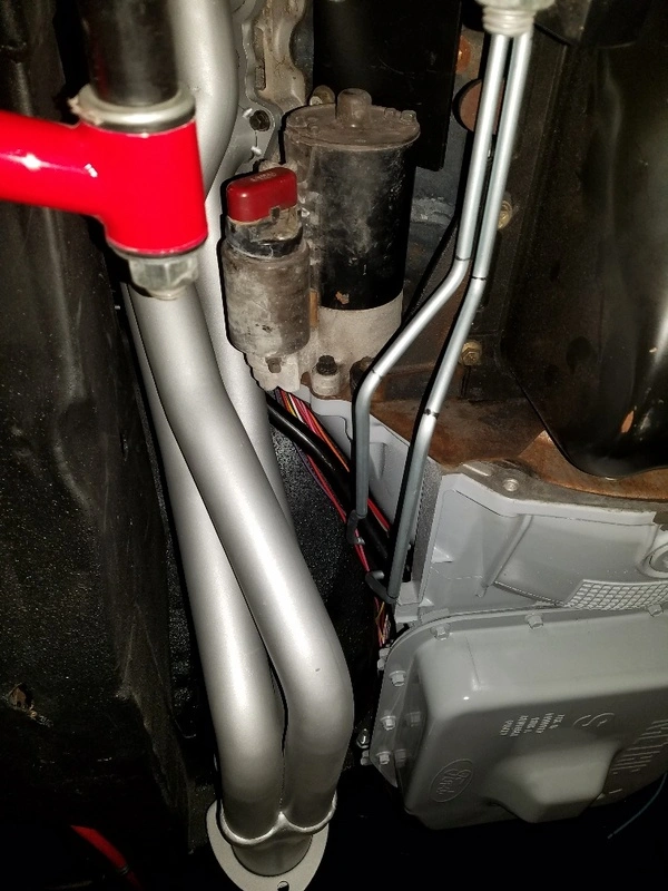

I bought stainless steel transmission cooler lines for the AOD but they didn't fit so I made my own

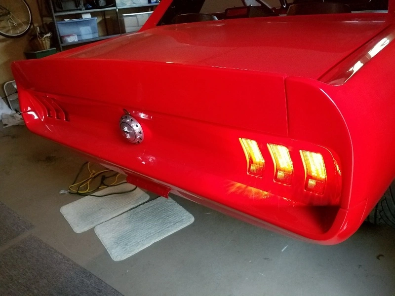

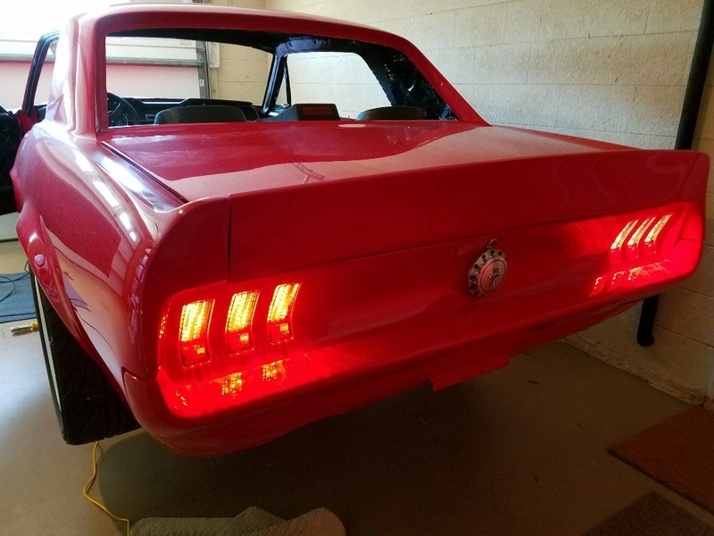

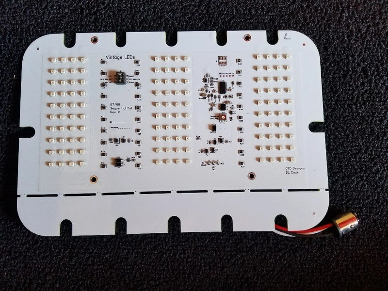

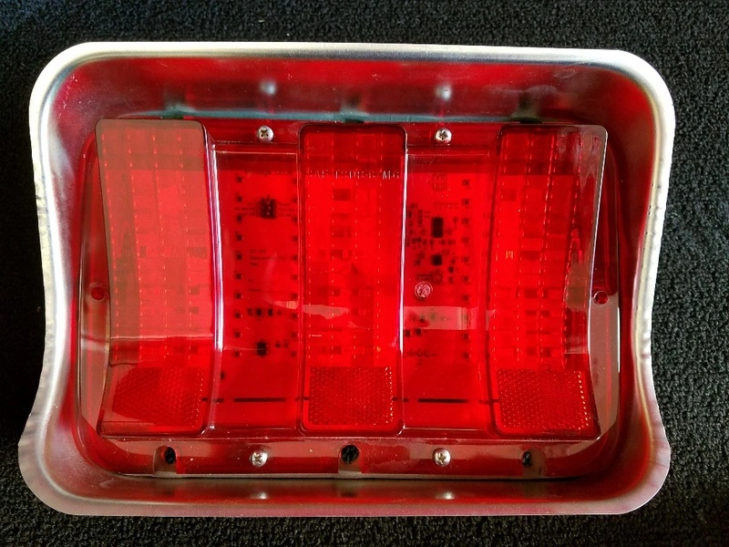

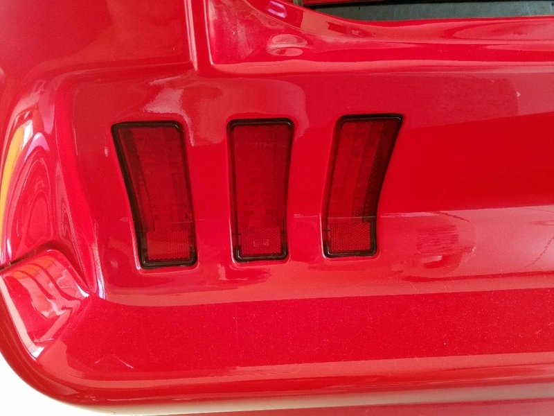

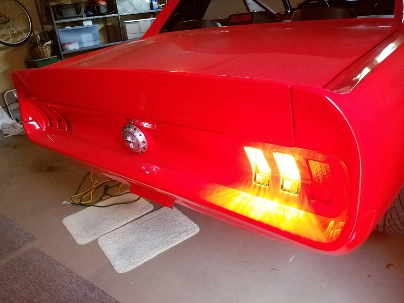

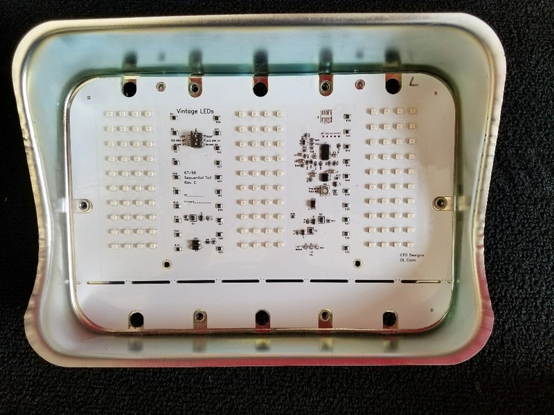

I ordered a set of Vintage LEDs taillights

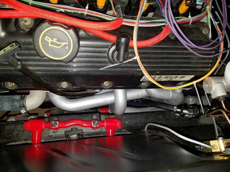

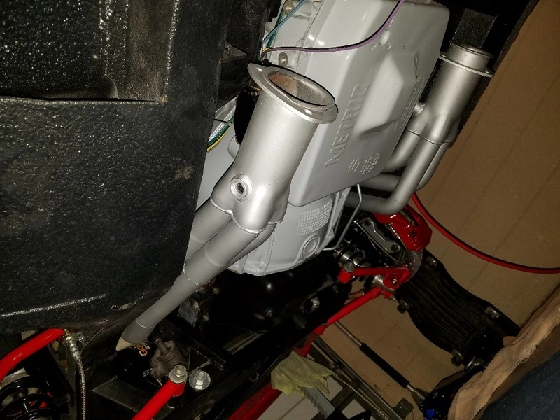

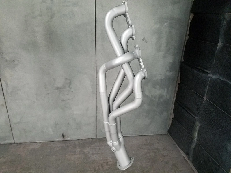

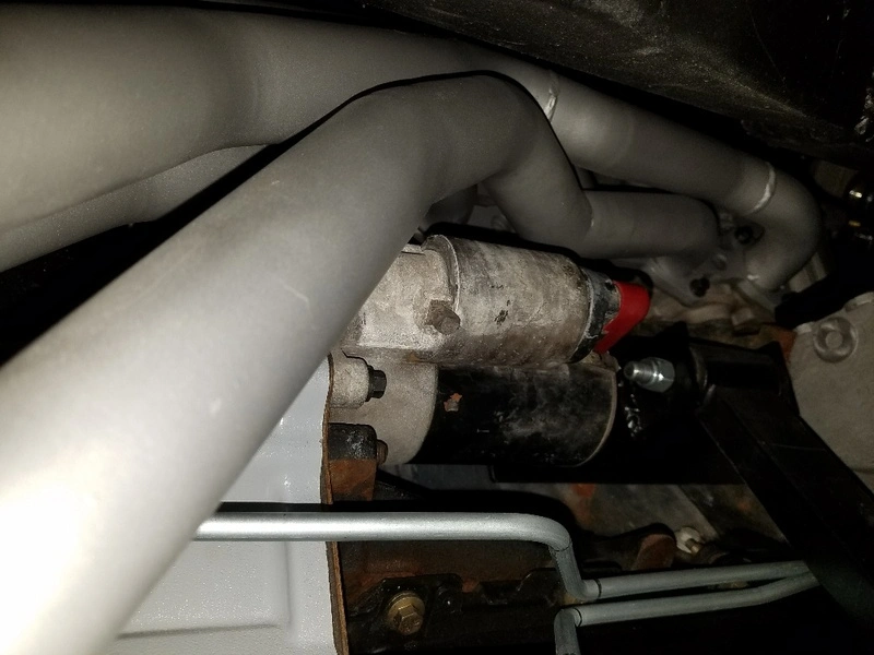

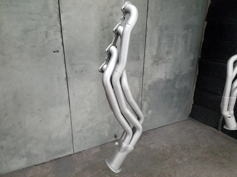

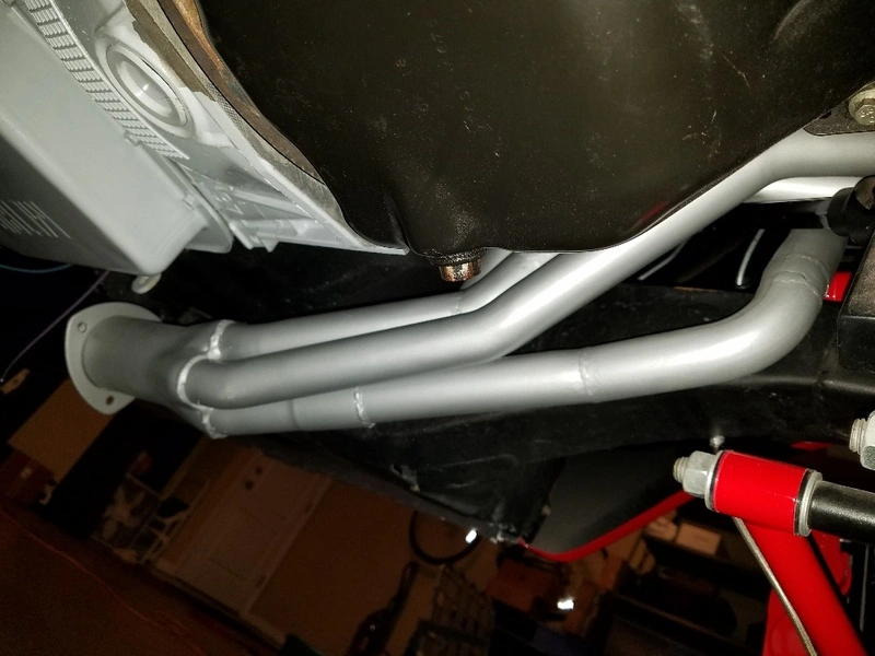

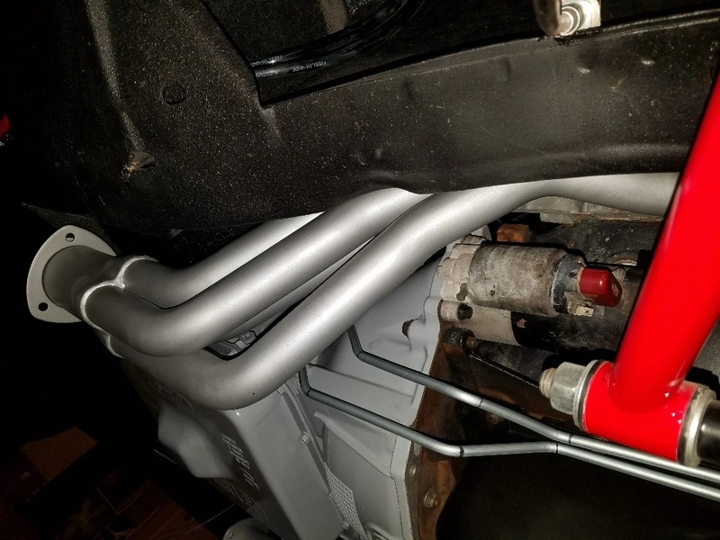

I painted the headers. It's tight but they fit. I want to get it running and check for problems before I get them coated.

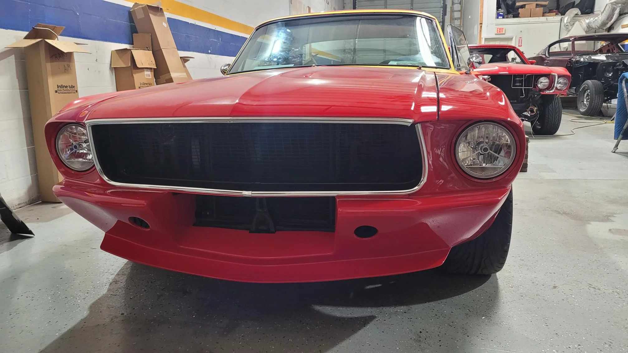

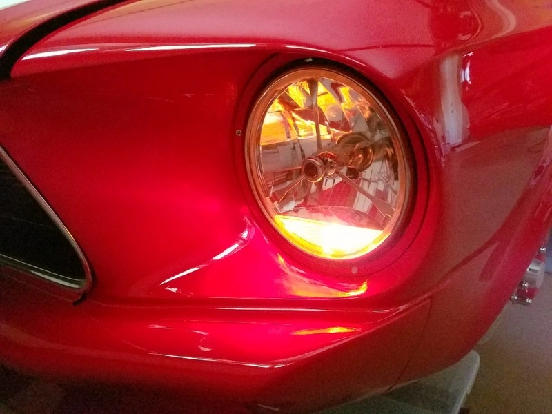

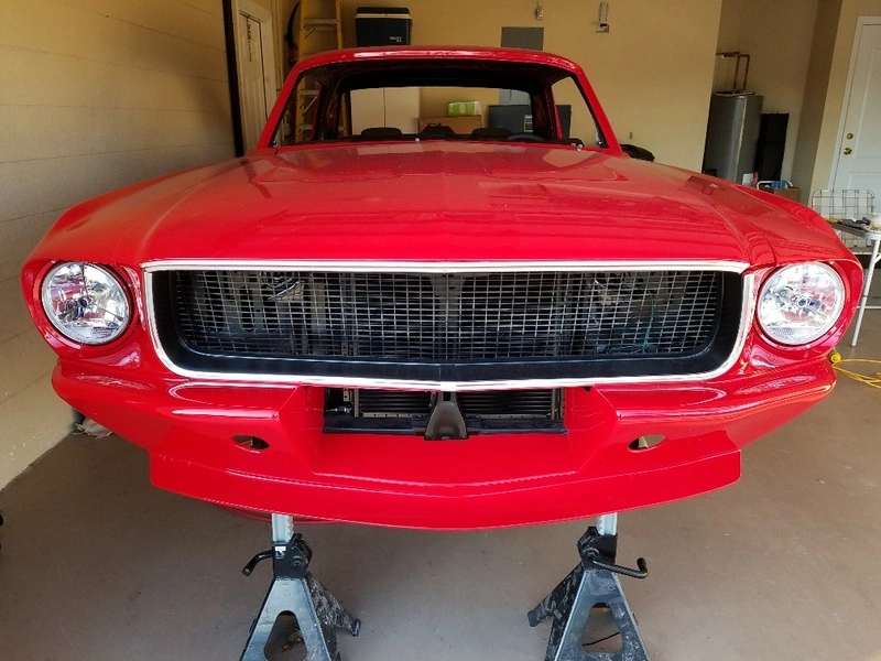

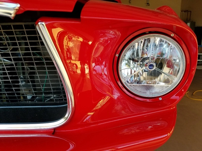

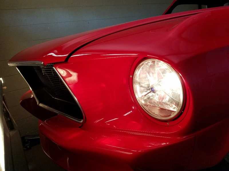

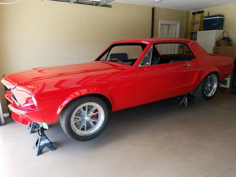

After a little modifying of the headlight buckets I got the headlights with built in turn signals to fit.

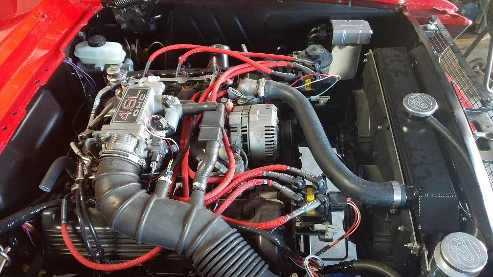

The engine I was going to use was in a shop that had a fire because of a faulty cruise control in a van. I already had the motor mounts welded in place for a mod motor. My Dad had a 1996 T-bird that had minor body damage but wasn't worth fixing so in memory of my Dad we used his engine and transmission.

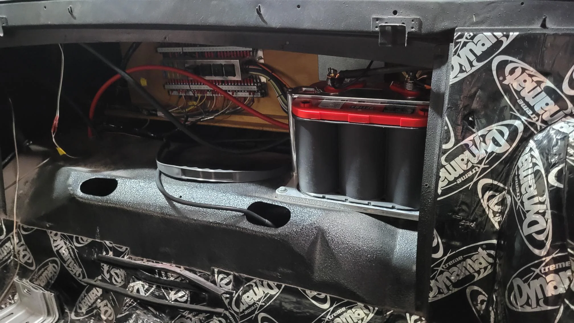

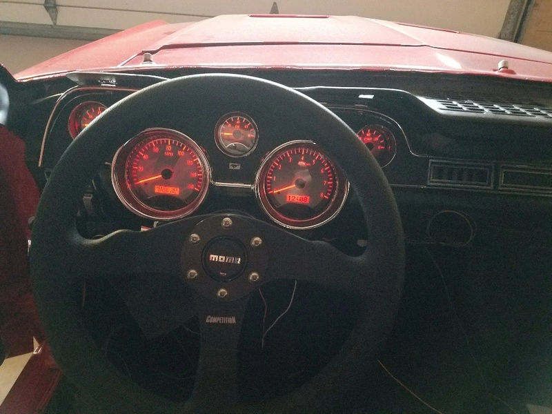

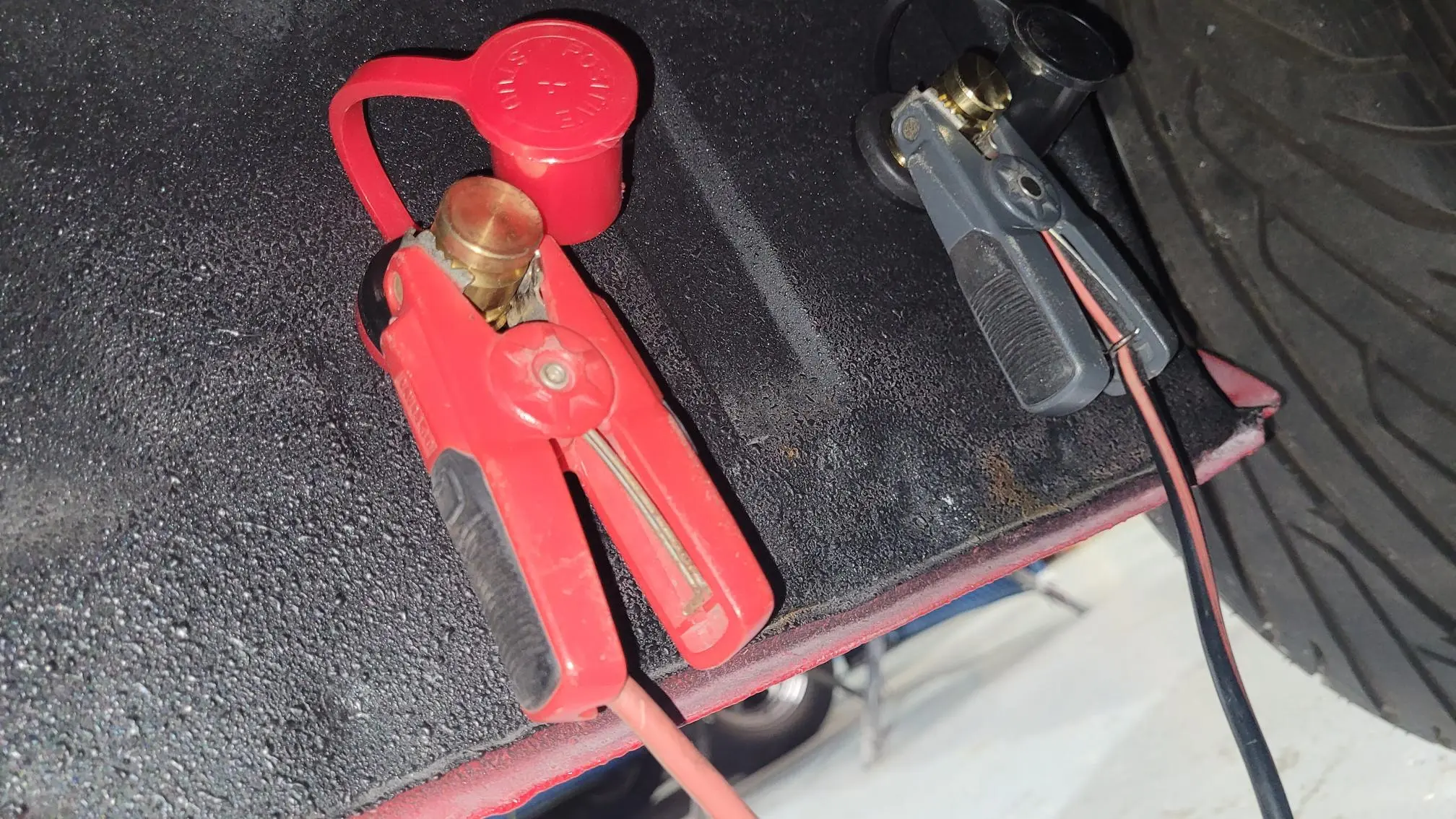

I hooked up the battery in the trunk (I still need to hook up the ground cable to the engine) to see what works. The Ron Francis trunk mounted battery kit has two ground gables one small short one that I have going to the body and a large long one that they want mounted to a bell housing bolt. So far the AC 3 blower speeds work, taillights, turn signals, and headlights.
I have a problem with the lights in the dash flashing when the key is off and the steering column harness is hooked up.

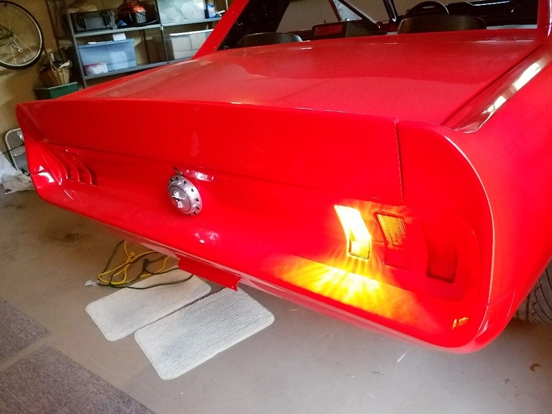

I installed the battery ground cable from the trunk mounted battery to the engine block and cured most of my electrical problems.

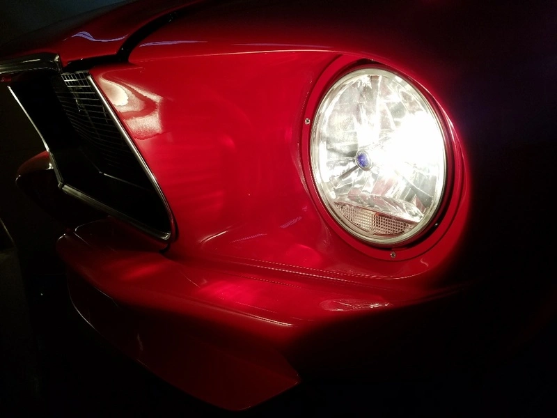

Vintage LED turn signals are working
Headlights and turn signals are working

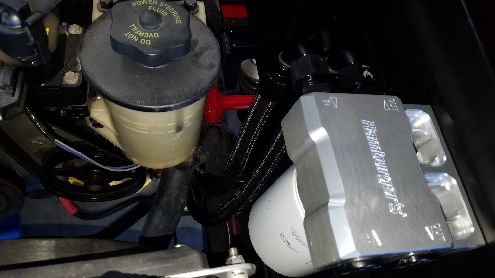

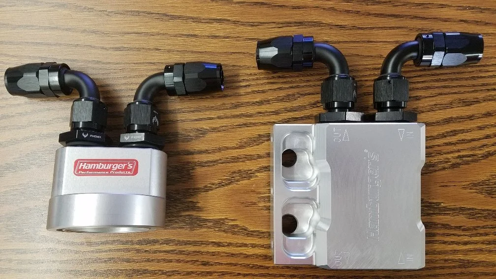

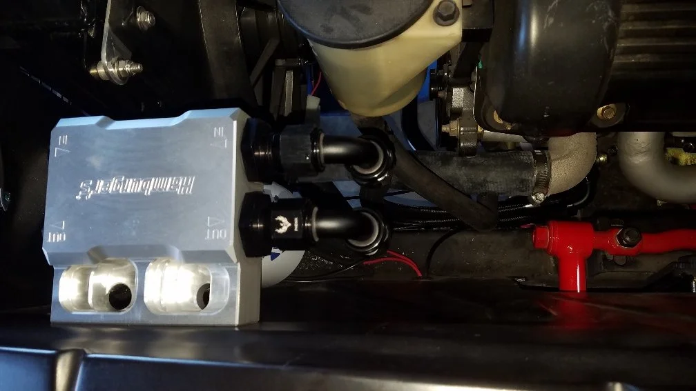

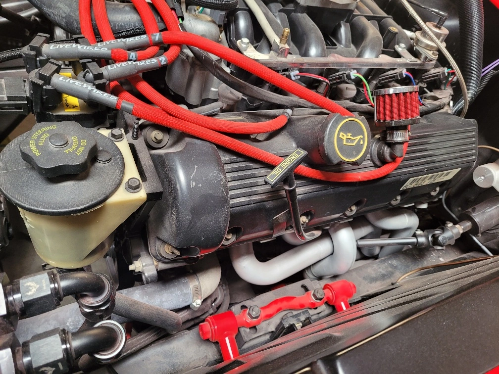

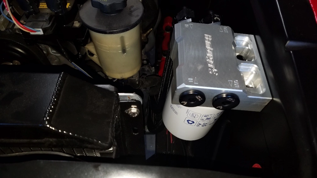

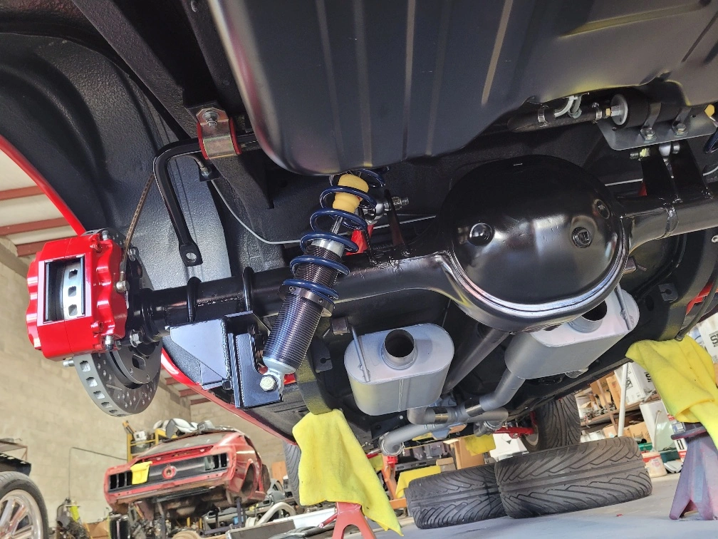

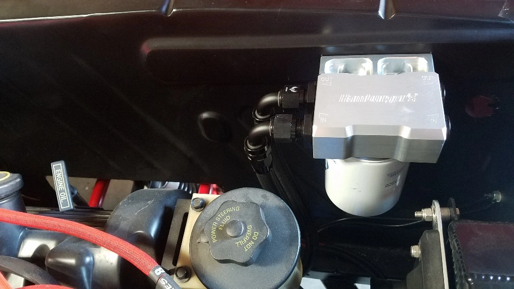

I ordered a remote oil filter kit and when it came in it had large 12 straight o ring fittings with a barbed end the wouldn't clear the frame rail after a long search I found what I needed at Phenix Industries and ordered an adapter that reduced the hose to 10AN with 90 fittings. I was impressed with their products and decided to be a dealer. Nick made the new oil line and mounted the filter on the fender apron.

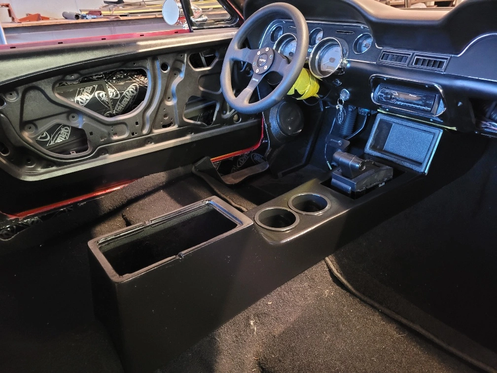

I need to get you caught up another one of my personal projects.
Reactions: 89ripper and LILCBRA
68keyblr
20+ Year Stangneter
Mar 17, 2003
946
20
49
Arizona
Sep 3, 2024
#215
  • Sep 3, 2024
  • #215
Whoa been a few years Looking good, love the console

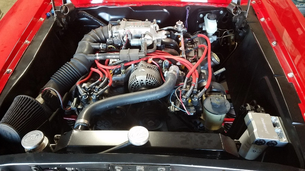

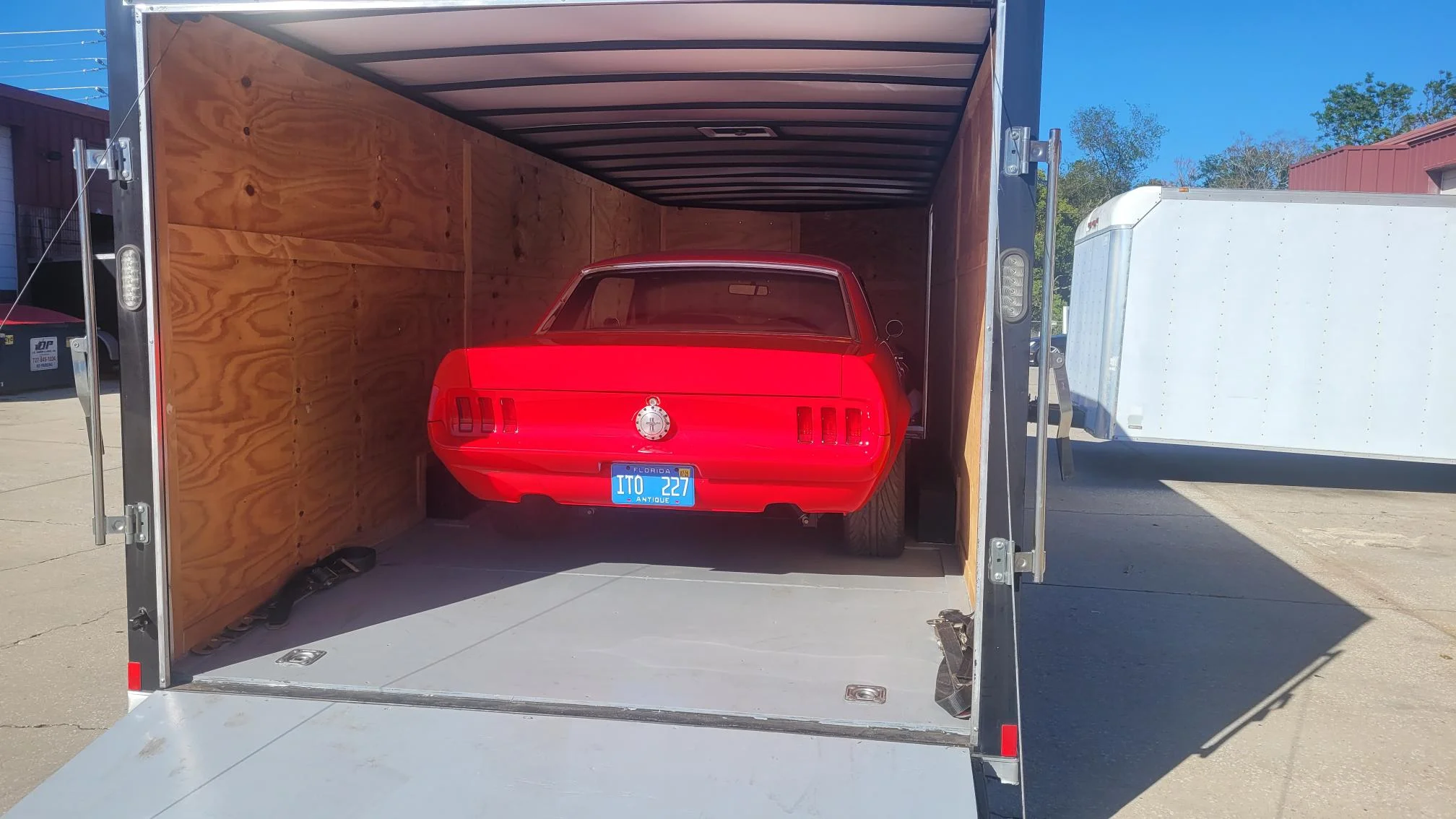

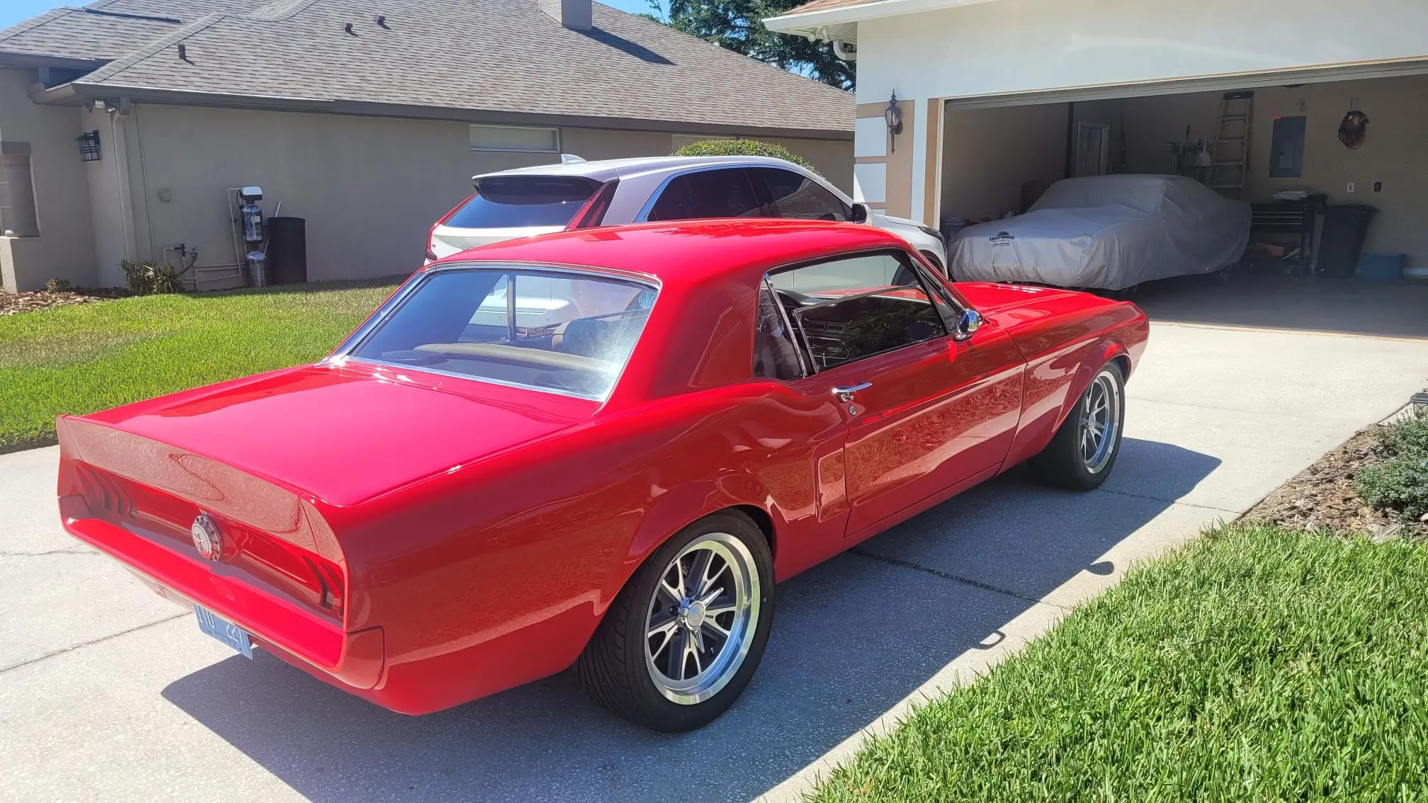

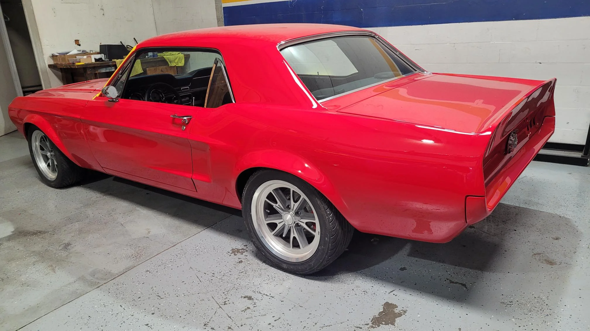

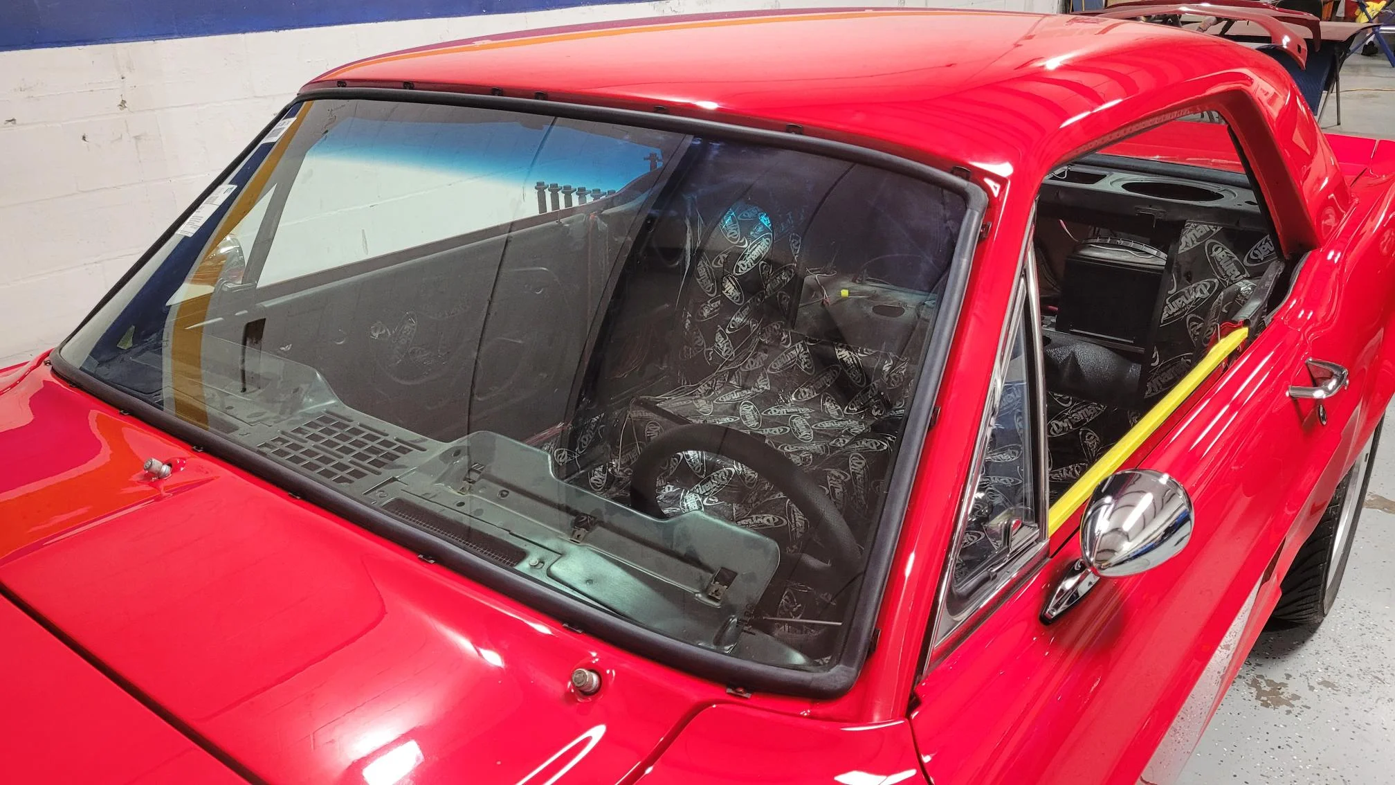

It's almost ready to drive. I backed it out of the shop (the AOD worked) and loaded it in the trailer and went to the Mod Nationals in Bradenton last year. I won three awards at the show, including best engine. I got it back to the shop and got a few bugs worked out so I could drive it for the first time. I drove it close to the shop a few times and got brave and made it 23 miles to my house. The only problem I had was the AC compressor won't come on and the inline fuel pump is loud when hot. I have driven it about 175 miles. I ordered a new gas tank with an in tank pump.
