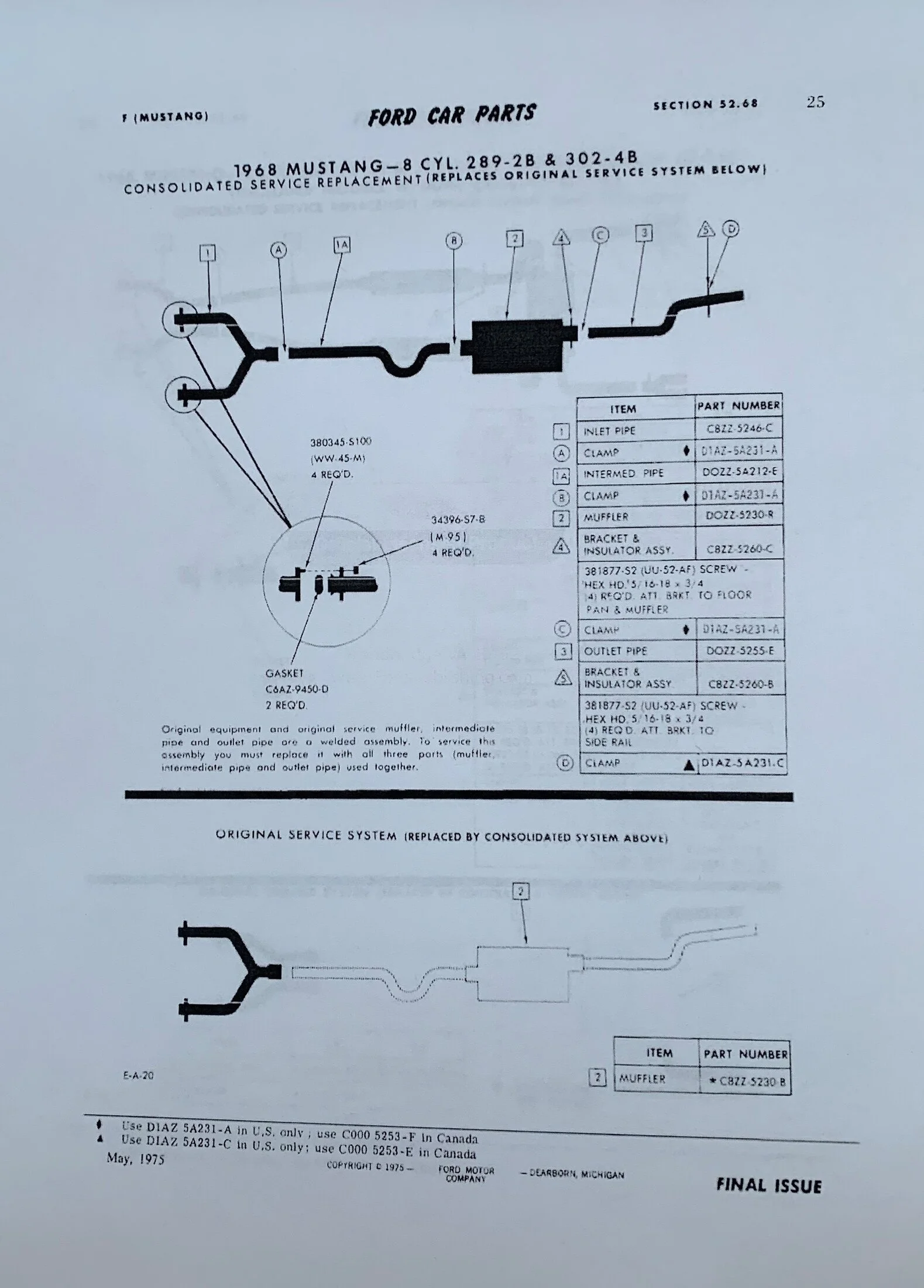

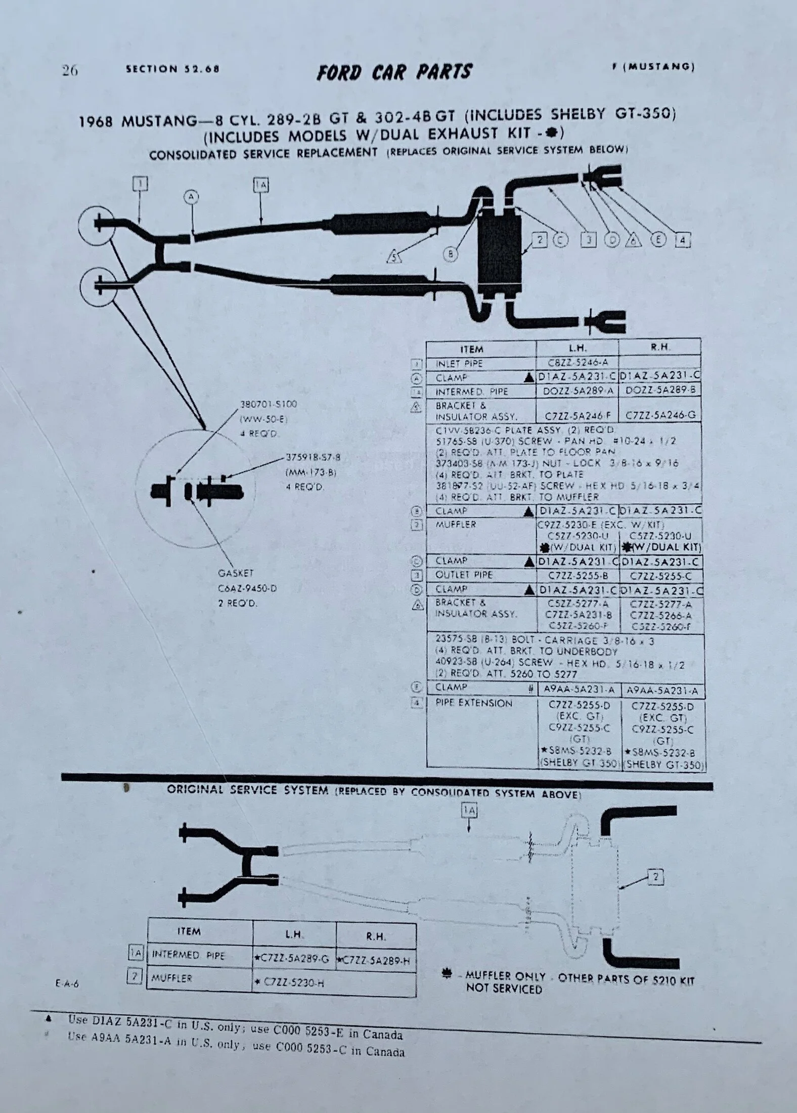

Hello.
New member, original owner.
Never being happy with just driving the car after many updates, I am now contemplating converting the single exhaust to dual exhaust after 55 years.
Questions:
1- The car has a single exhaust with the muffler hanger attached to the passenger rear floor pan. Does this mean that the floor pans are factory reinforced? The muffler is NOT transverse mounted.
2- What hanger would I use for the new driver’s side muffler?
3- Any other tips/wisdom?
Thank you for indulging a topic that has probably been discussed before.
Best,
Russ
To get you started, here is how Ford did it for both the single and dual systems:
