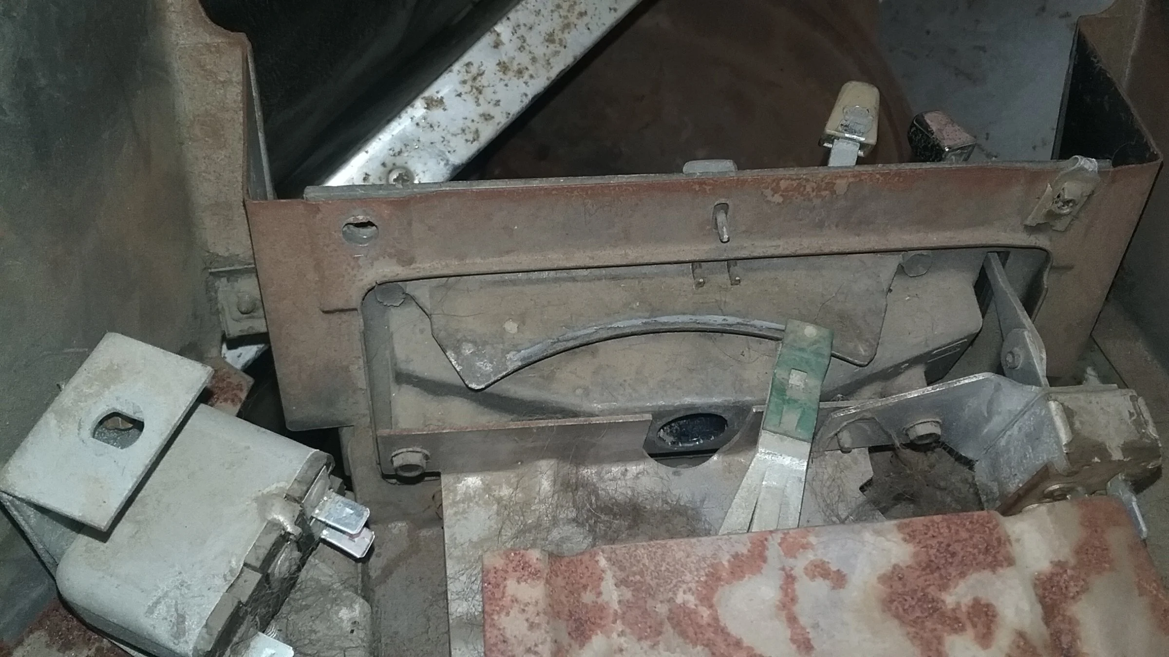

May be a little hard to see in this pic but the bulb and socket pushes into the back of the heater controlls ,yours may have fallen out and just a little light shines through ,or the bulb or lense of the control may be dirty.
Pull the radio knobs and i cant remember for sure but there may be two nuts on the two radio controls the face plate has two screws and it just pushes into place ,it pulls off .i think you will have to pull the radio out to get to the heater controll bulb.once you get the face plate off there are a couple of screws you will have to remove to get the radio out of the way but they are easy to see
