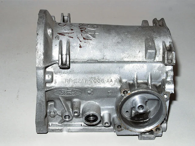

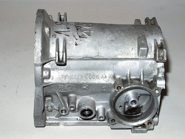

I have another problem with my neutral safety switch. I have a 302 ith a c4 cruzomatic transmission. I had to swap out the shifter linkage because the tranny came out of a column shift thunderbird. Anyway, I couldnt get the nutral safety switch to start in park or neutral. So I took it off and manually adjusted it by hand. I finally found the point on the swich which appeared to be neutral and the car started. When I reinstalled the swich, It would not line up with the mounting holes on the transmission. Am I missing a step?
Here is a pic of a switch and a c4 main housing. The switch should slide over the selector shaft and two screws fasten it to the two threaded bosses on each side. Make sure your trans is in Park and rotate the plastic bushing inside all the way counterclockwise. Then line up the two keys onto the selector shaft. If it doesn't line up, it's possible you have incompatible parts. I thought all C4s were similar
It looks like it could be rotated 180 and fastened on as long as there is nothing to interfere.:shrug:
