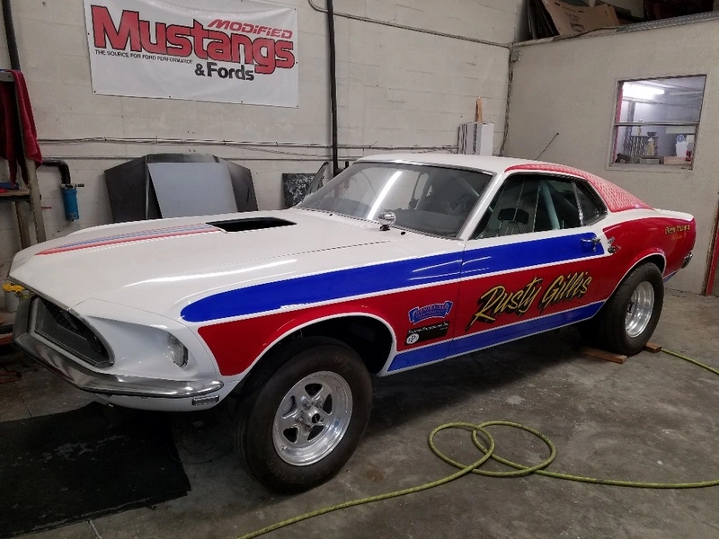

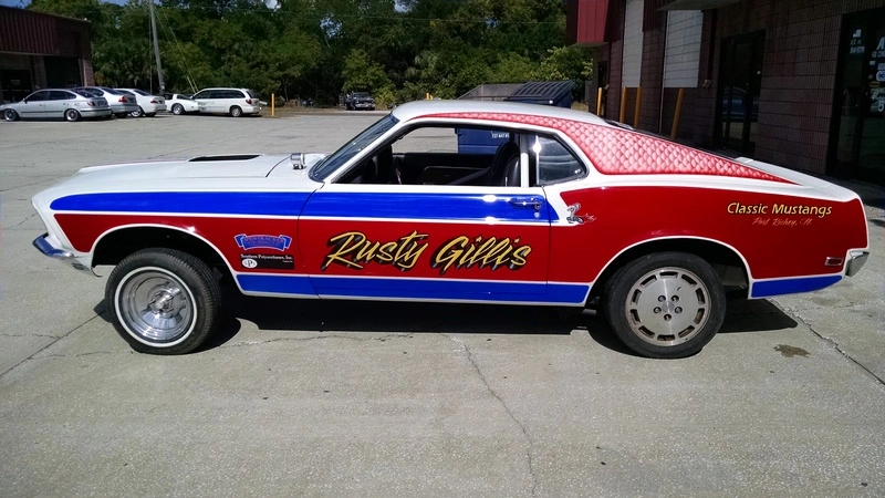

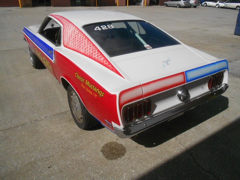

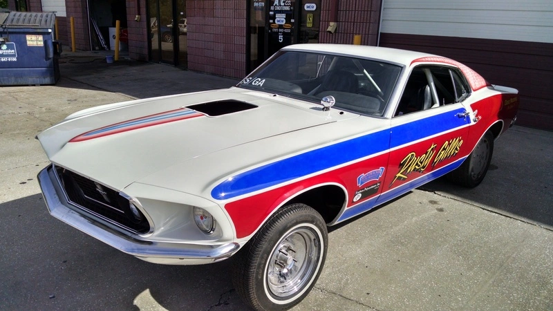

Mustang is back at the shop. Need to do a lot of work getting it ready to race in A/SA or B/SA. The 428 CJ will be on the dyno later this week. I painted this in 2005 using SPI clear and it has never been waxed. It has been in an enclosed trailer for 6 years in the Florida heat. I wasn't sure what to expect when we unloaded it. After washing it the paint still looks great.

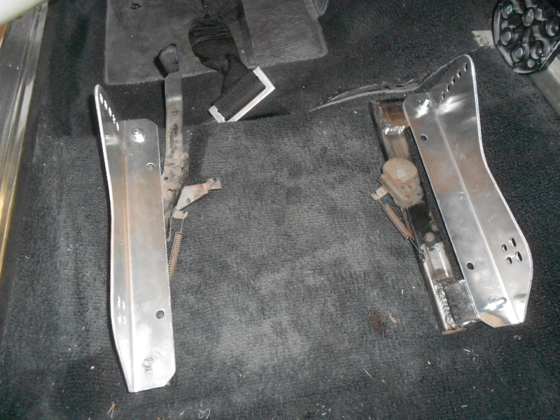

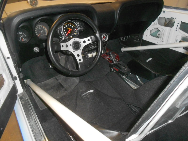

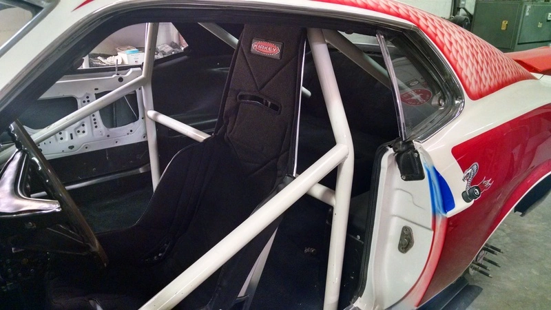

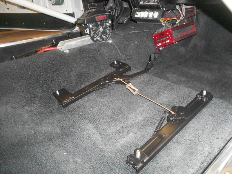

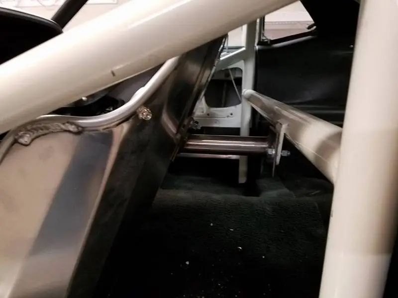

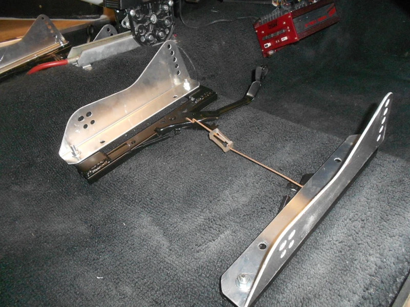

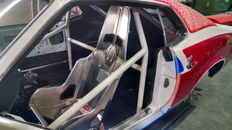

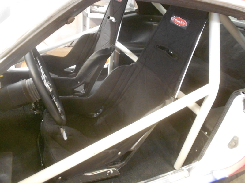

Fitting Kirkey seats is not just a bolt in. The problem is the roll bar design won't let me have the seat back tilted enough so I will need to use a different steering wheel with less dish. We are mounting the Kirkey brackets to the stock seat tracks that will need to be modified.

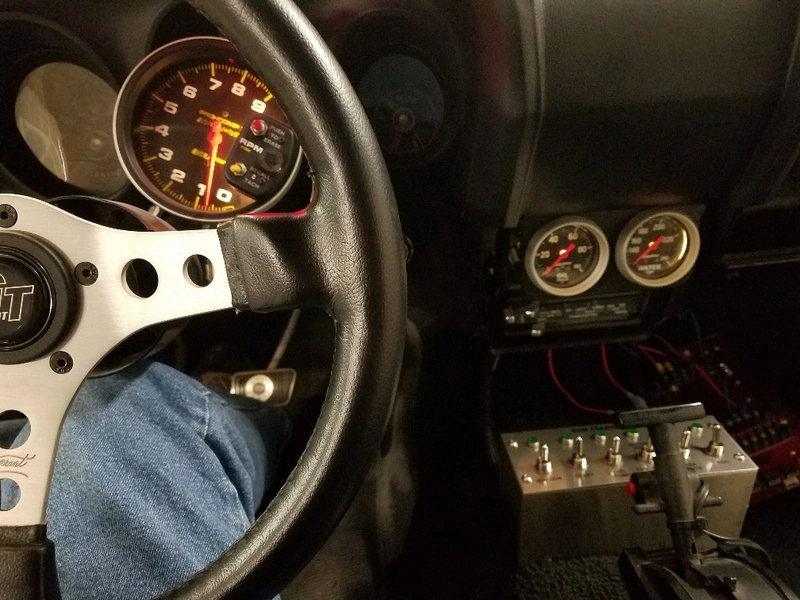

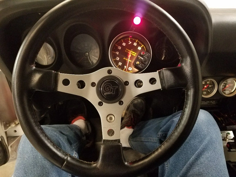

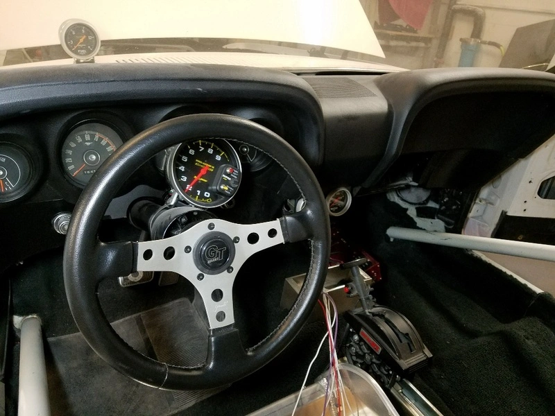

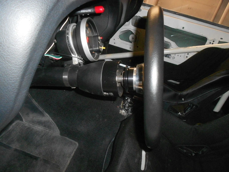

The steering column had to be cut about 3/8" for clearance for my fingers to be able to install and release the wheel. The first time I tried it once it snapped in place it almost cut my fingers. The original steering wheel nut that now holds the inner spline on had to be ground down because it did not allow the quick release adapter to go down far enough to snap into place. I bought a 3 bolt release because I already had a 3 bolt to 5/6 bolt steering wheel adapter. They make a 5 hole release but I have a 5 and 6 bolt wheel and wasn't sure which one I would be using. If I had to do it again I would buy the 5 hole and not have the additional 1/2" adapter.

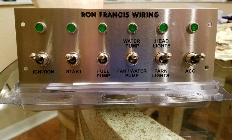

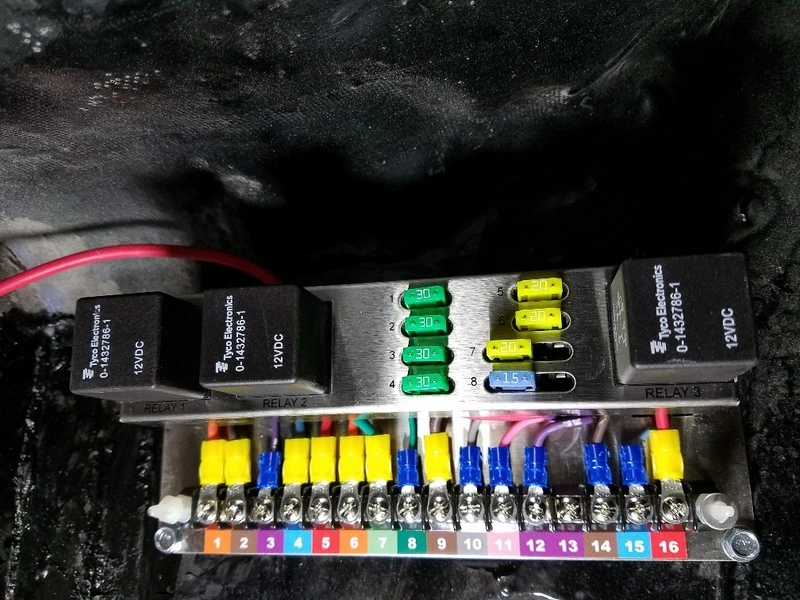

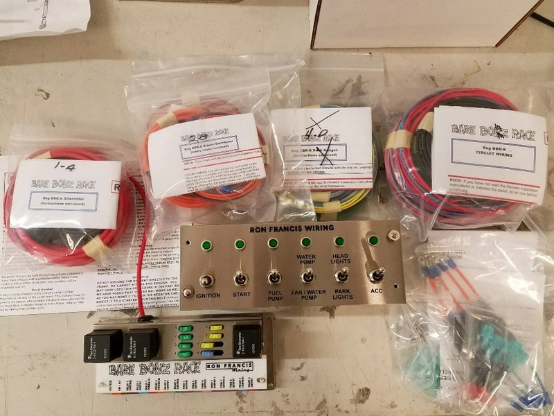

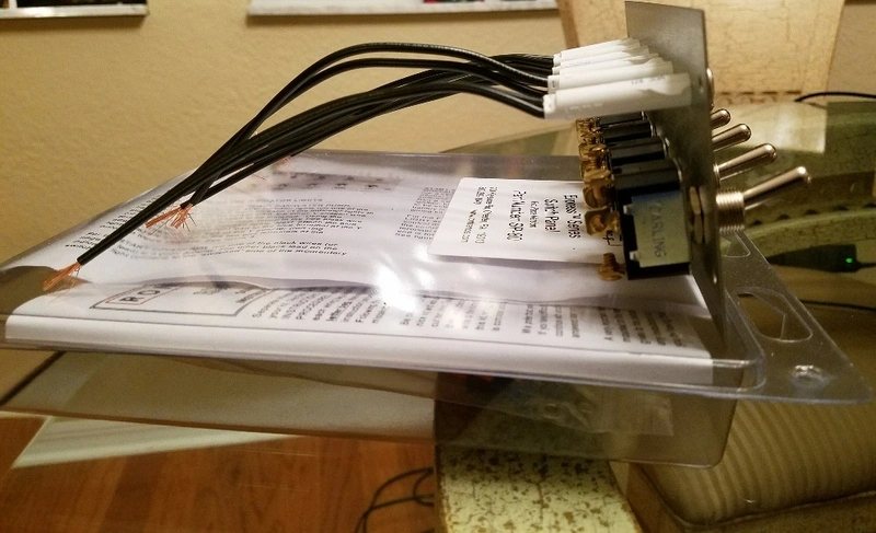

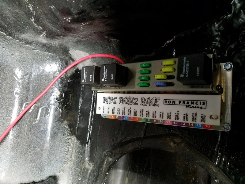

The wiring was done over 20 years ago and it's time to upgrade. I bought a Ron Francis race car harness and switch panel. I assembled the switch panel tonight after supper on the kitchen table.

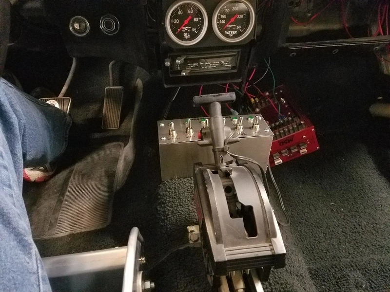

I have been working on my 1969 Cobra Jet Mustang between customer cars in my spare time getting ready for the 50th Anniversary of the Cobra Jet.

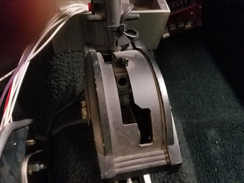

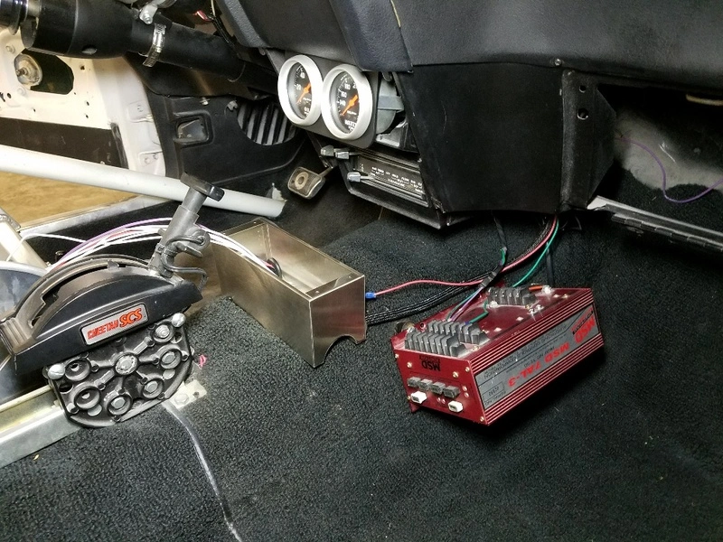

I have had a few questions about my shifter. It is a reverse pattern shifter from Turbo Action for the C4. I don't have the decal on it showing the shift pattern.
I have the wiring finished and everything works

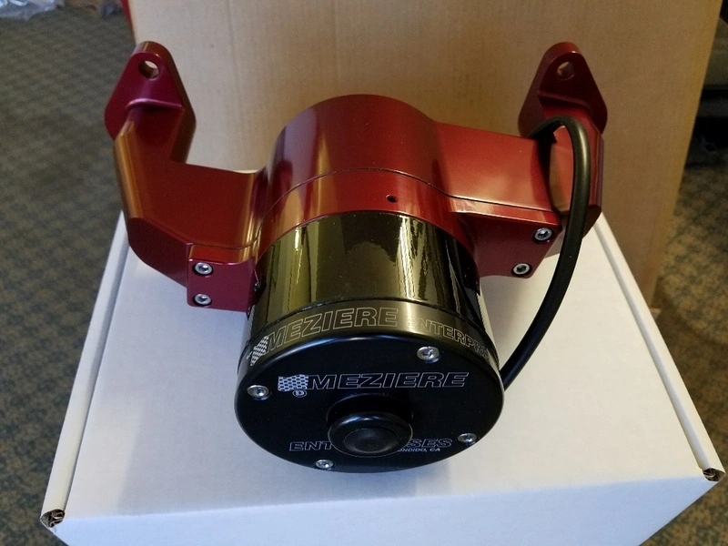

I still have to wire the alternator and my new water pump when the engine is installed.
