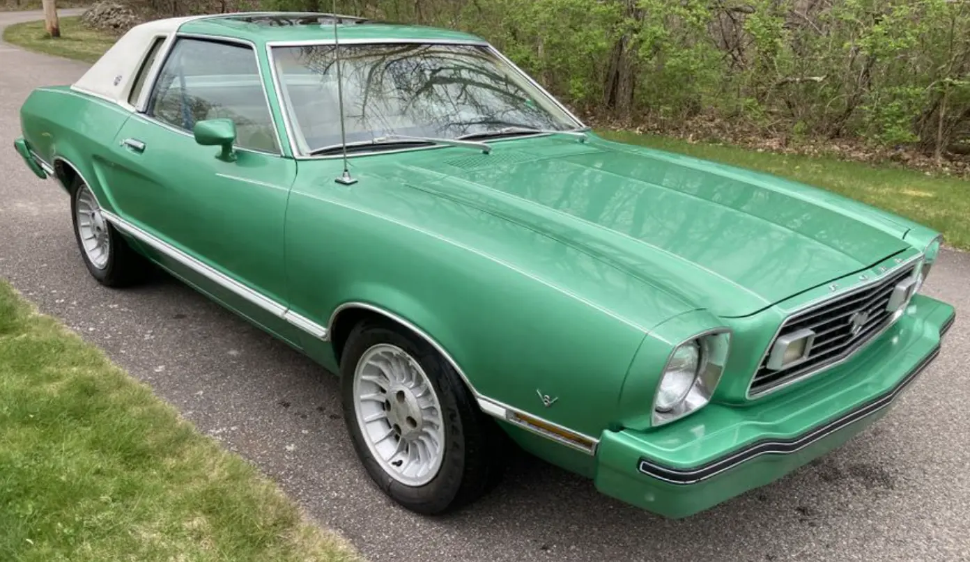

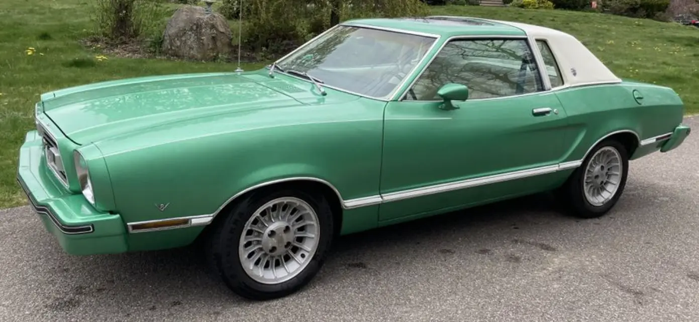

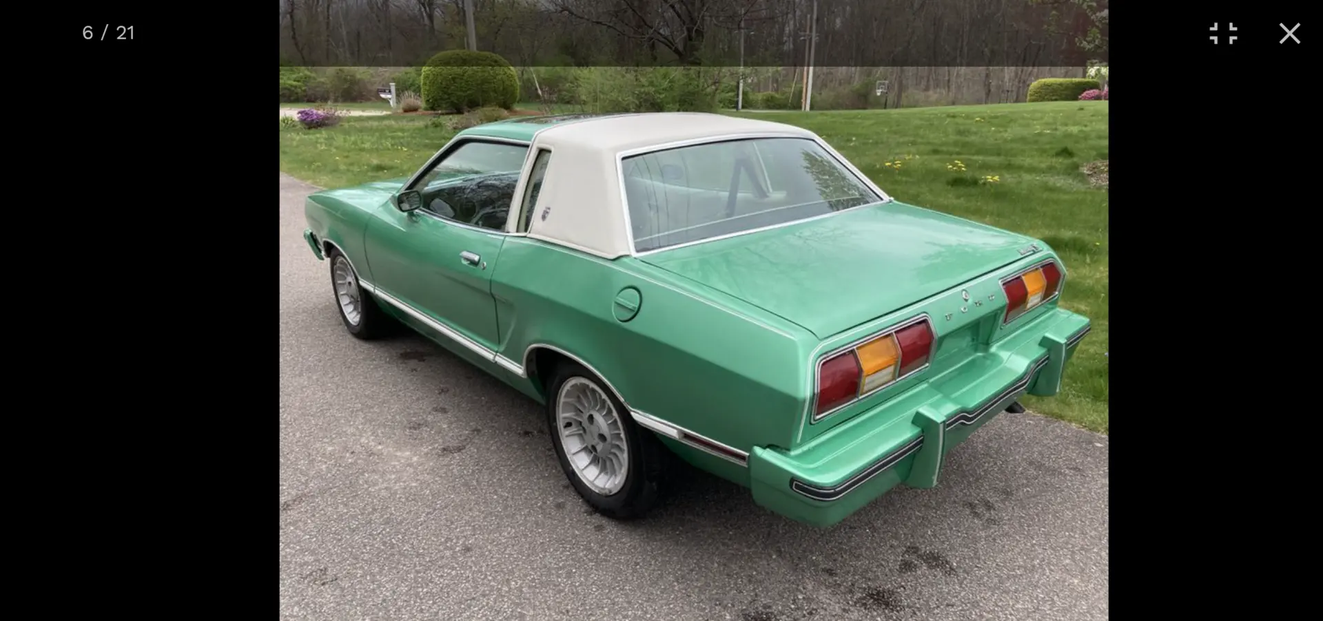

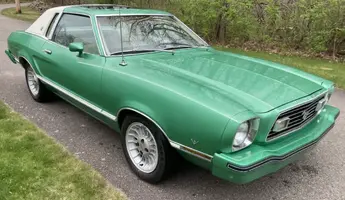

Hello all! I have recently acquired a '77 Ghia w/ 302w.
Aloha and welcome aboard.
Happy for new blood around here. We are pleased to ask for a picture your Ghia.
I'm still using the old wires, which are motorcraft with "1977" printed on them.
We want to see these too, just for fun. I bet no one at Ford thought them wires would go 45 yrs.

Love the color.
I have those same wheels on the coupe i am slowly getting back together. Do you have spacers on them?
Haven't taken them off yet to see, but after I swap the 2150 (297cfm) for a Holley 500cfm, if that steadies out my fuel delivery quirks, I plan to split the exhaust with new polished manifolds and straight pipes (its got a cat and one pipe, I must be bleeding HP). Then, I intend to finish her off with a fresh set of chrome 4-point rims to match oem. Someone added those foxbody rims before me. I'll post those rims on Maine Craigslist after (or keep them as a excuse to slowly build a fox body from the rims up!)
