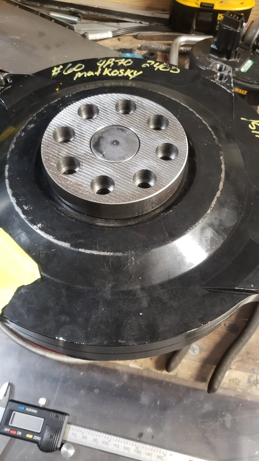

The bolt holes needed opening up..I didn't have the bolts, so the machinist used a 3/8" bolt for a Guinea pig.
No worky.
NBD,..I have a straight cut carbide burr, and a router. Put the thing in the vise, and made a few passes inside each of the bolt holes.
Fixt.
The next hurdle is the how to adapt the converter to to the flex plate. I thought I was gonna be able to bolt a bracket thing to at least one of the bolt holes,.....but no.
That means I gotta weld on the converter.
A process wrought with potentail peril. The heat from welding could cause case distortion. ( I guess there are clutches somewhere close to the feet of the converter). The potential distortion could cause clutch failure.

.... why cant you line the flexplate and the converter up and then drill and tap what you need?
Or can you lay the flexplate on the converter and take a picture so we can all see what you see...
Which flexplate? The 2 jz flexplate is the same dianeter as the converter. The converter's mount pads ( feet) hang out past the ring gear on the flexplate.

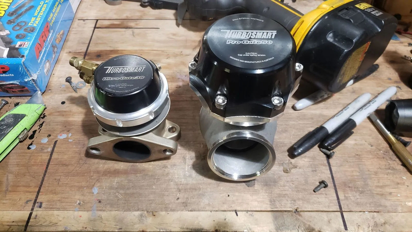

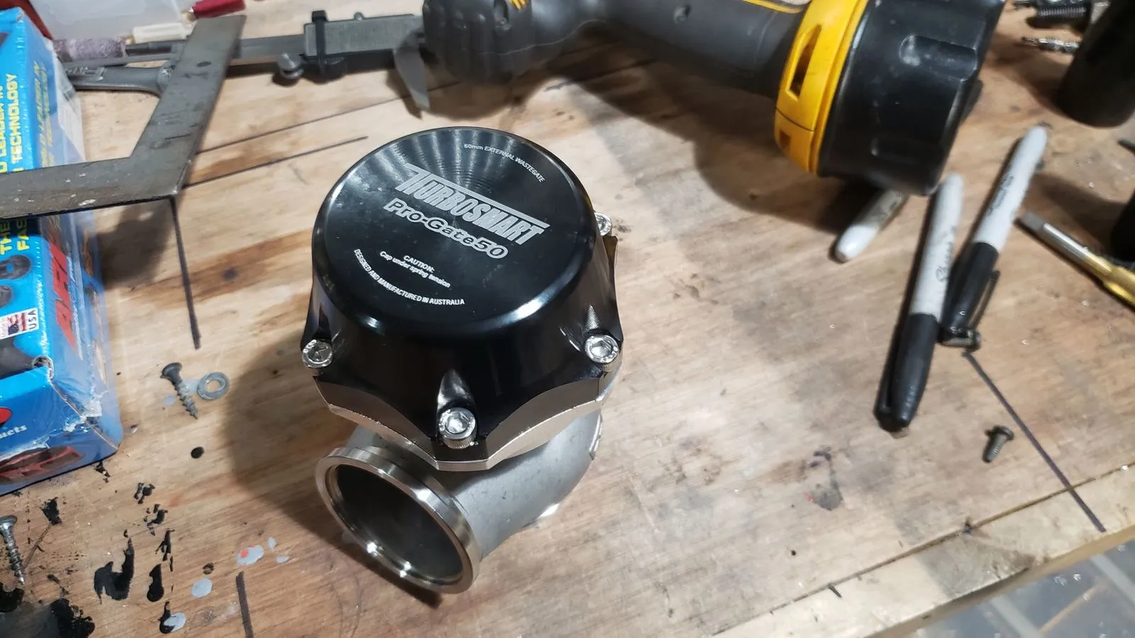

Of positive note is the mystery of the Chinee cloned Wastegate. It appears to be an actual TurboSmart piece. ( at least that's what it says on top)
A really, really big actual TurboSmart piece. Pictured next to my old 38 mm that was on the monster, it makes you wonder if this engine needs that much of a Wastegate, ( because that's what size the flange was on the exhaust manifold) if you weren't choking the potential of the old monster's engine, and if not......
I'm in for a hell of a ride.

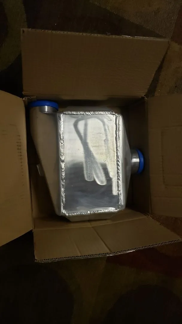

Exactly the same as the one that was in Monster gen 1, I'll put it in the exact same spot that the old one was. This time around I'm gonna see if I can make the radiators fit somewhere up in the front instead of putting them all the way back in the trunk, but they may end up there just the same..even though they are small,...they're still too big to fit up front. But I'm gonna try anyway.
