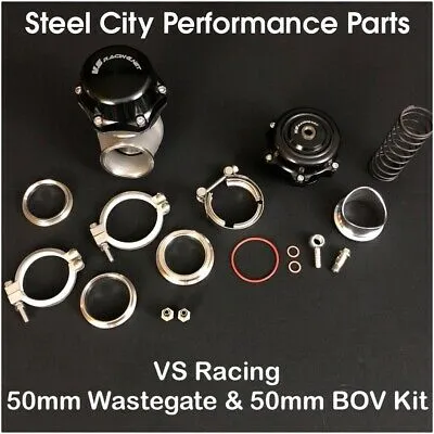

Looks a little familiar?
Then,...you look at the listing from the piece that you bought even closer, and this is what's in the item description:
Item specifics
Condition:NewManufacturer Part Number:1040
Type:External WastegateBrand:SherryBerg
Warranty:1 YearFitment Type:Direct Replacement
Placement on Vehicle:Front
So,.I fire off another note to dude, telling him that the part I receive better be an actual TurboSmart piece or he'll get a claim filed against him with ebays' return policy that guarantees the part in the picture to be the part I receive ( if I ever get it)
It looks like the Chinese are using a "@" symbol in the " Turbosm@rt logo instead of the actual "a" to get past copyright infringement.
And when you google "Sherryberg 1040":.............
You get the king of rip offs... conveniently obscuring the turbosmart logo to avoid getting sued maybe?
I'm thinking ol dude has got an actual TurboSmart piece for the pics, and one of these clones is gonna arrive in the box...we'll see one day....if it ever gets here.
