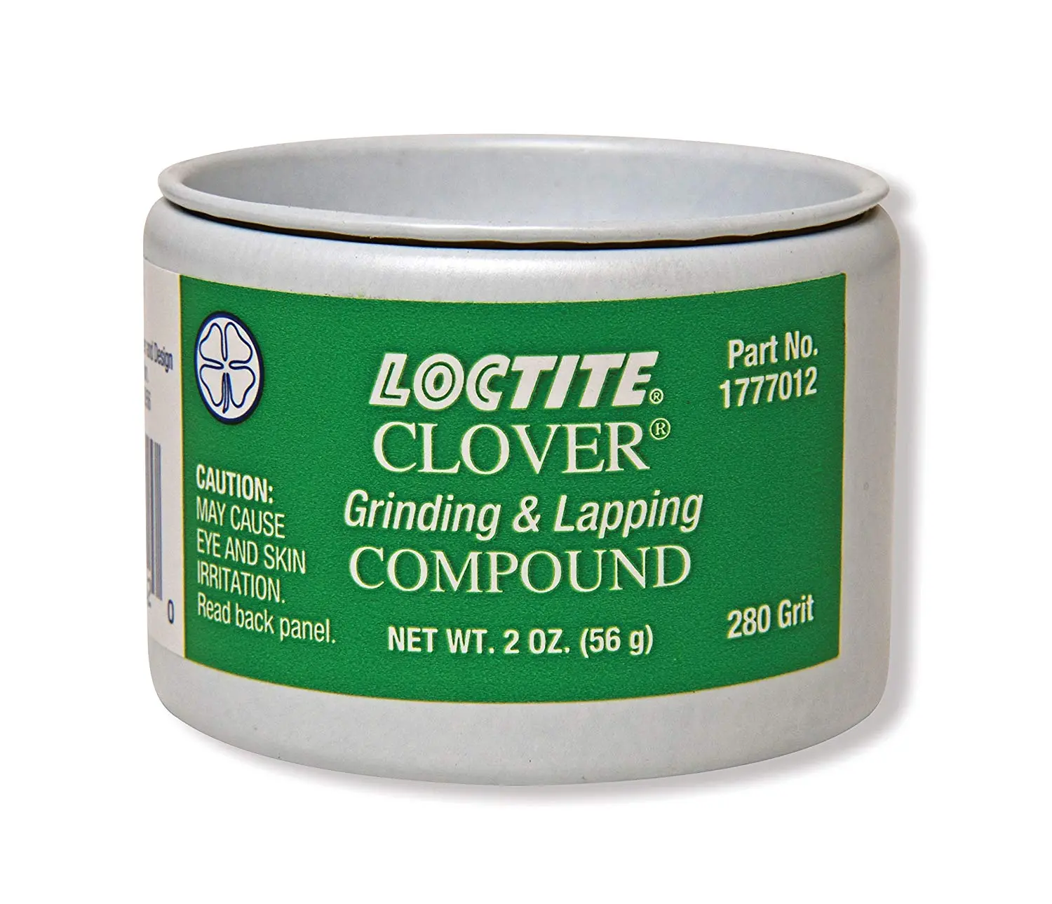

But,..I had no bent valves...something was wrong though..I had air pouring out the intake port with the cam removed.
I am a graduate of the school of WTF.
Get one of these..
And some of this:
Remove springs, lap valves. Flip head over, put spark plugs in, pour rubbing alcohol, solvent, or even water, and see if it holds liquid for a few hours.
You can also see if you have a good seat on the valve and seat and if not figure out why.
Oh and that :poo: probably causes Cancer in Kalifornia. Everything I buy these days, says it causes Cancer in Kalifornia.
