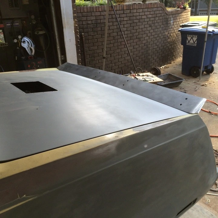

How long did you work on this Noobz?
And to think, I was gonna back further away, and take a full panorama shot of both sides.
I was thinking of you when I reconsidered, and only snapped the pass side pic, else wise you'd just wear your poor little fingers out, and tax your keen, knife edge wit to the point of exhaustion coming up with smart assed back to the future quips.
Consider yourself lucky.

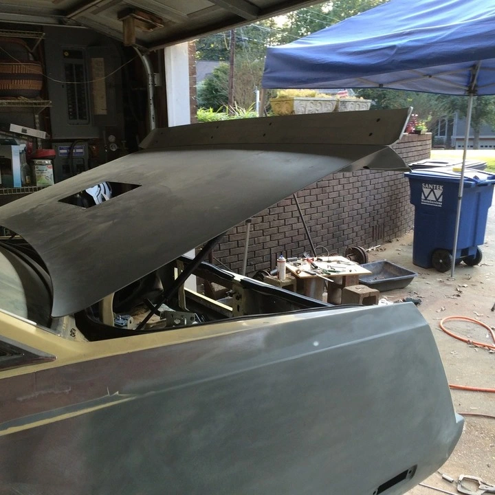

Update # 1999 has me looking for lift supports to to lift, and hold the trunk in the open position. Many has been the time when I have knocked into the stick that is holding up a 40 pound trunk and ended up getting smacked either on the shoulder, or back w/ that guillotine ( huh, spelled it right the first time, couldn't believe that it didn't flag me, so I spell checked it and sure enough,......guillotine)
Anyway, it was just another little "chip" that I had to pound out of the boulder before I can consider moving forward on the body work, as I knew that I had welding to do to fabricate the support mounts.
Determining how long wasn't so hard, getting the lift force figured out was. I weighed the trunk this morning, and it weighs a tick under 40 lbs. After compiling all of the other measurements, I decided that I needed two struts, 19" extended, and at least 14" compressed w/ a lift force of..............hmmm
( I start thinking)
If the trunk weighs 40 lbs, do I need two 20 pounders, or do I need two 40 pounders? I decided I'd call and ask.
I called Lift Support Depot. The nice lady informed me that she was not an engineer, and that they could only recommend a starting point because of that. I told her I understood, and asked for her recommendation. She said the recommended lifting force for a strut that could be mounted at the mid point of the trunk would need to be capable of lifting 1.5 to 2 times the rated weight of the trunk. Each strut.
That meant that I was looking for a strut that was rated at 60-80 pounds of lift force.
While that seemed excessive to me, I took her advice, and went to my local mom-and-pop auto parts store, and found two that would work (25.00 ea.)
I already had 4 10 mm ball studs from some earlier project, so my all-in total for the project was 50 bucks.
I did have to make the lower mount brackets, and I made those out of 1/8th plate, cut at a wonky angle, and folded at 90 degrees. Originally, I riveted them to the lower trunk rail, but after putting the system in use, decided they flexed too much, so I welded those pigs in there, and made some little out riggery dudes to help support the base mounting point.
I only rosette welded them in, I wasn't too keen about having rivets through the drip rail of the trunk.
They work.
They do push the alignment out of shape, just like the redline hood struts do, but I was able to compensate for that by readjusting the trunk. NBD at this time, cause it's all coming back apart at paint time anyway.
Next I'll work on the remote trunk release for the trunk, because I welded the trunk lock hole shut.
So, now that I can do this for the trunk, ill be doing it for the hood as opposed to spending 100.00 for 50 bucks worth of stuff.

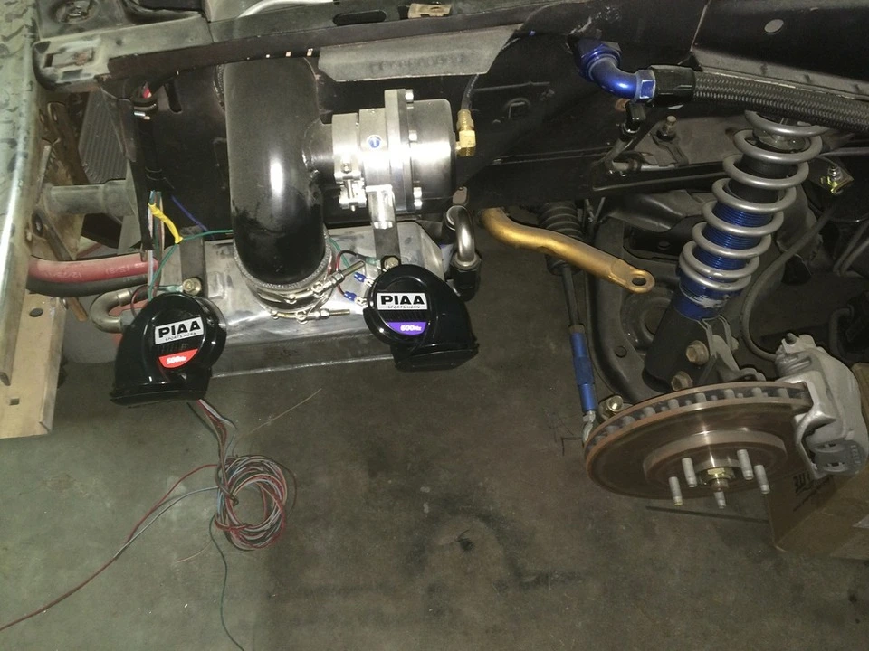

The Horns came in today.
I really wasnt into doing much, so mounting those things fit the bill.
I cheesed on mounting them, I cheesed on wiring them. I simply bolted them to the I/C mount pads, and used some crimp connectors.
I've kept the pic as narrow as possible to keep Noobz working on what he gets paid to do, as opposed to what he doesn't.
Anyway, I get them installed, and because I want to be sure they sound like I hope they sound (european), I hook up the battery.
I press the horn button, (in my car I press in on the T/S lever) and this is what it sounds like:
I get nothing.
Evidently, I neglected to ground the horn circuit w/ one of the remaining wires that are now just taped up, and stuffed under the dash. so the actual "button" that makes the horn work doesn't work like it's supposed to. ( Kinda like Noobz cuttin' and pastin' at work, instead of doin' what they pay him to do)
But I still want to hear the horn.
So I get a 24" piece of scrap 12 ga wire, and tag one end of the wire to a known hot lead. The other end gets tagged to the lug that the horns are hooked to.
FIAMMMMMMMM!!!
The cat has a grand mall seizure right where it was laying.
After I cleaned up the mess where the cat was laying, I disconnected the battery, perfectly happy w/ the way they sound.
Now all I gotta do is find out which one of those loose wires actually complete the horn circuit.

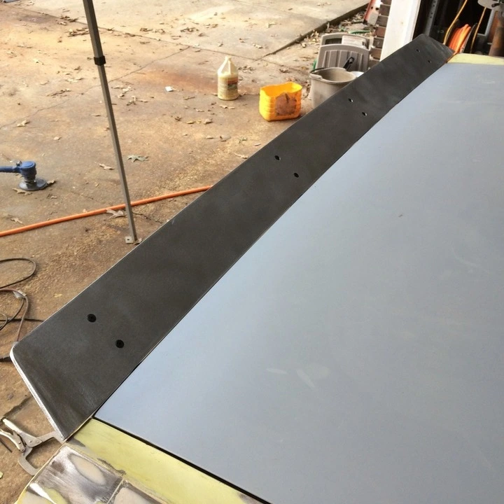

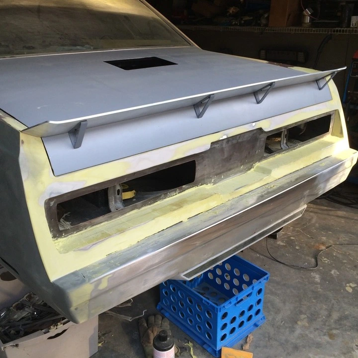

For a hand shaped 1/4" thick piece of aluminum bar stock, I am feeling pretty good about the fit. While it might not look like it, that spoiler isn't just some 5" wide piece of straight aluminum bar stock. The trunk crowns up, and back. I had to cut this thing along a line w/ a hand held band saw (front and back) to match that crown, and the mounts are staggered so they follow the curve at the top. Then when all of the cuts were done, spend about two hours w/ a long sanding block smoothing out the wavy assed cut line.
. The thing is bolted on w/ 2 10-32 counter sunk bolts on each one of those 1/8" thick x 3/4 wide triangles. I'm ok w/those mounts too, I plan to mess w/ them a bit and maybe fill the corners in w/ some filler in the radius's, but other than that, the thing is very stout, despite the fact that it doesn't weigh jack.
I guess that I must've got lucky and got the struts perfect. at mid point, the trunk neither lifts, or drops. go a little more either way, and it does what it's supposed to, but on the lift support mount issue, that is one thing that I got right the first time.
The aluminum finish on the G tail is my next decision. The car will be orange. I think I'll paint that thing body color, along w/ the mounts so that they disappear somewhat. I did see a late model Challenger a week ago, and the duck tail on that orange car was black though,.......... I have decided that the tail light recess will go satin black, the bumper and the exhaust shroud will be body color as well. (Only the exhaust grate will be black).
Who thinks a Black G tail on orange mounts?
