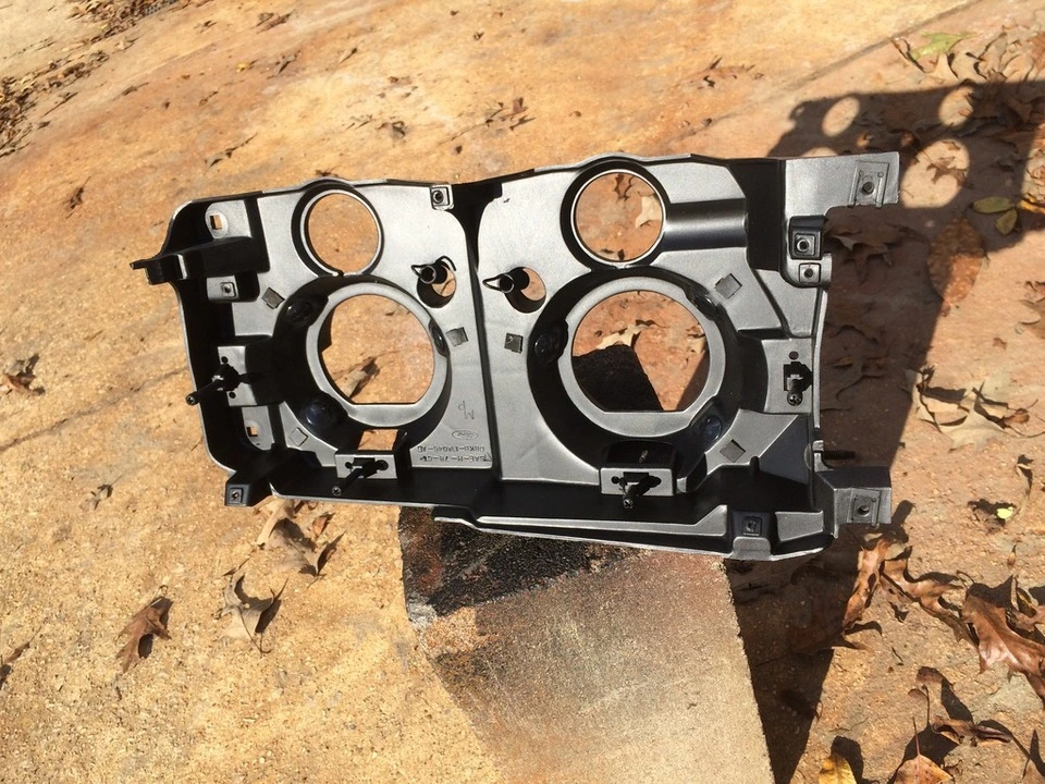

Nextly, the headlight assy's had probably never had an occasion to be removed since they were installed at the factory. Not only was there dirt and grime as a tell tale as proof of that, there was also that orange kinda junk that happens when somebody lives on a dirt road, and something never sees the business end of a soapy rag. Add to that that the car had been previously repainted, was poorly masked, and the resulting yellow overspray was all over the things as well.
Lastly, there is other broken junk. One mounting point for the outer trim ring is gone, and the three little cushions that each headlight bucket rides on have broken.

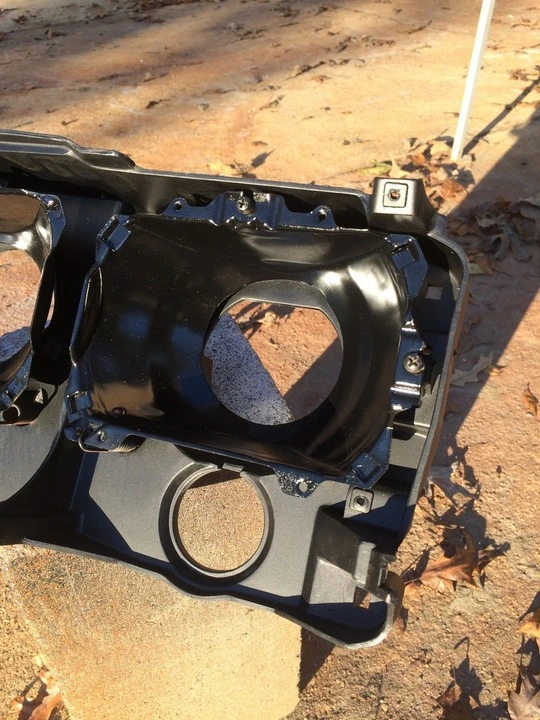

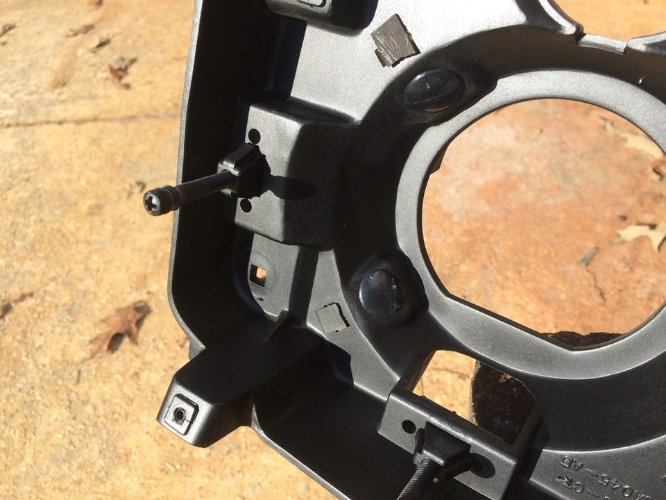

One housing cleaned, stripped of the old yeller paint, and resprayed. Notice the broke assed tab in the upper left corner. If you look to the center of the headlight area, you can see whats left of the factory supplied hard plastic bucket cusions.
And here's what I did to fix them.
When I was looking for something to use as a substitute for the factory cushions, the problem was how to hold them in place. Originally, I was planning on on countersinking a screw into some small chinky-doo piece of plastic. Then I saw these things hangin' on the hook at AZ. I figured what the hell. Easy to mount, easy to replace, and adjustable if they turn out to be too shallow. I bought a box of 15 for the 12 pieces that needed fixin'
The next thing you have to do is enlarge the hole in the back of each bucket fro the grommet that is on the tail of the new headlight. That was straightforward enough. A red, right turning pair of tin snips, and a die grinder w/ a flap wheel to smooth the burrs made short work of that.
However, If you decide to do this, you'll find out that cutting the buckets isn't all you gotta cut.
Again, if you have the right tools (in this case a die grinder w/ an aluminum cutting burr) clearancing that plastic that is hanging in the way takes less than a minute. Just know that you're gonna have to do it.

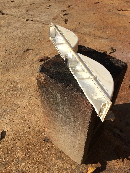

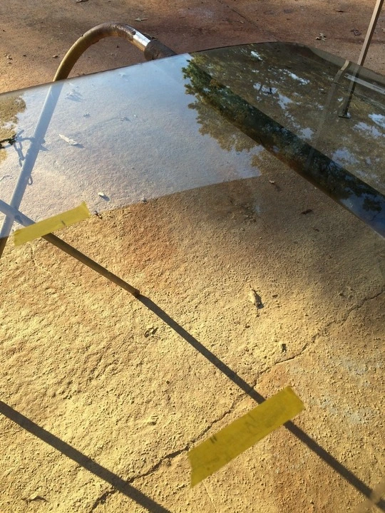

By mid day, I had to wait on paint to dry. I had already cleaned up the TS housings, and was trying to decide what to do about replacing the lens. Even though it isn't that thick, the old lens stands off the housing 1/2". Made sense to me to simply have a piece of lexan cut to fit the housing that was 1/2" thick. Granted, a little thick, but at this point, I'm not gonna try and glue acrylic together for the sake of keeping it similar to the factory lens.
I called the local plastics dude, asked if he could cut me a couple of small pieces while I waited, he said that he could, so I went on down.
And almost had a stroke when he charged me 33.00 for those two small pieces. I managed not to just the same.

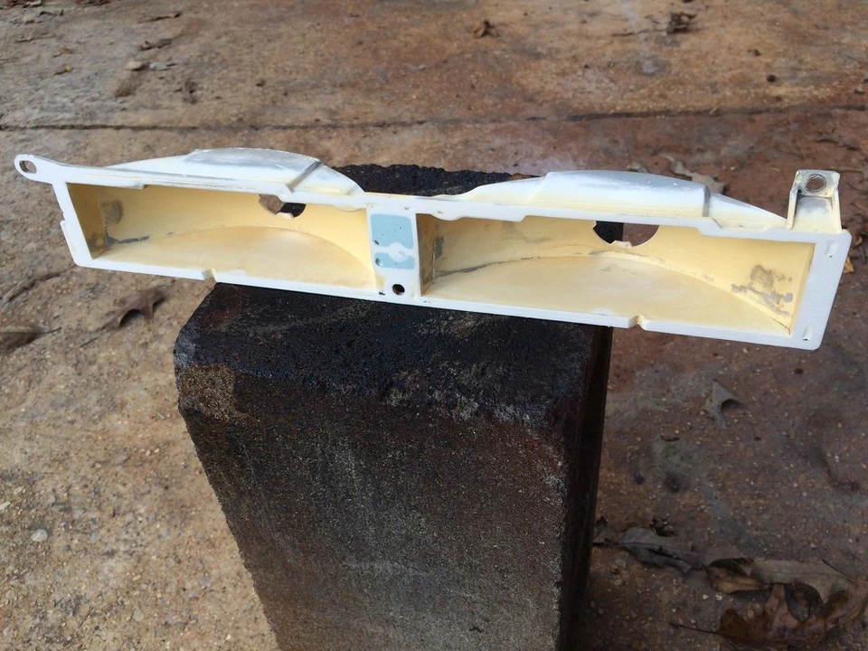

When I got back, everything was still too tacky to handle, so, I went about modifying the TS housings to allow me to fit that thick assed piece of lexan on top.

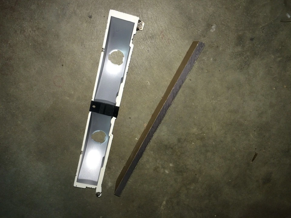

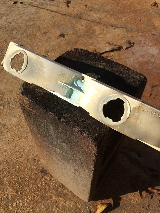

See the problem is that there are two stand offs at each end, and one big diivider thingy in the middle, Now grinding off the end pieces was no problem, but if I just did that to the center, I'd break through so I had to fill it before I could grind it.
Filled from behind w/ standard body filler.
Then I ground on the thing. When I got it close I stopped and moved over to Mikes's bench sander.
80 grit long board paper, stuck to the garage floor.
after about a minute of that, you get this.
Painted, and shiny, w/ my still wrapped coke bottle lens on edge for effect.

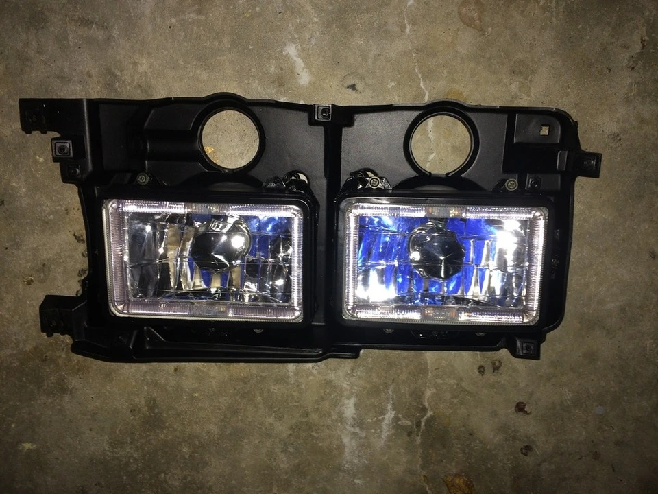

By now it's late, but I'm able to finally put the headlights in the buckets, and screw the trim rings on.
This is about as good as a set of fairmont lights are gonna get. You can see the blue reflection from the H4 bulbs behind the reflector. Not important today, but those blue bulbs will eventually hit the thrash can, in favor of a standard white light.

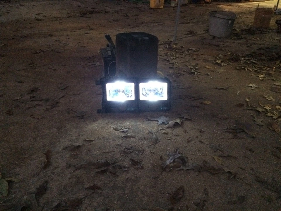

Now it's dark. I wire nut the wires together, and form a pigtail that'll allow me to wire up the angel eyes, and see what the're gonna look like. The pic in the Summit catalog showed light completely surrounding the perimeter.
I got something a little different...
Again,.......the camera doesn't really tell the truth. Ther are 2 leds on op, and two on bottom. I guess the light is supposed to "beam" through the perimeter tube thingy ala fiber optics, but it don't exactly work that way.
Im ok with it, It's different.
And anybody who knows me, knows that that is what I'm all about.
