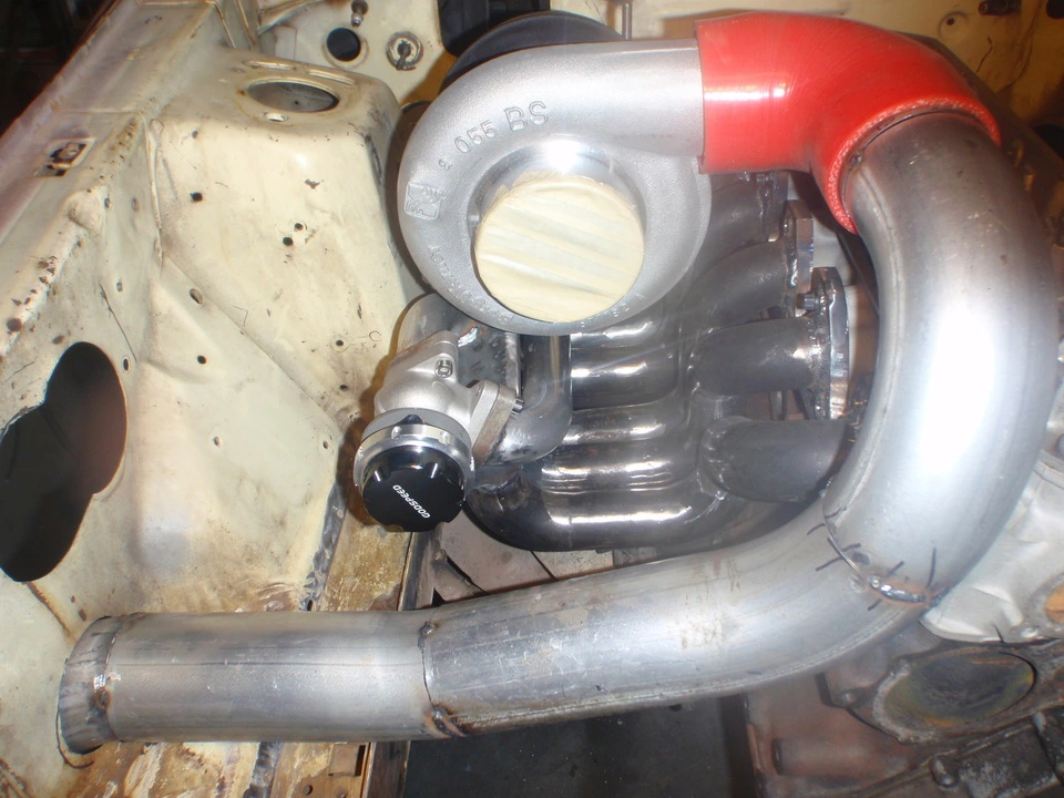

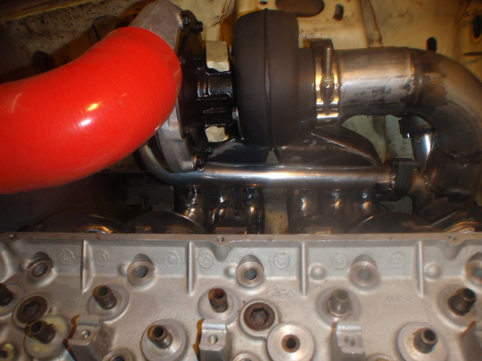

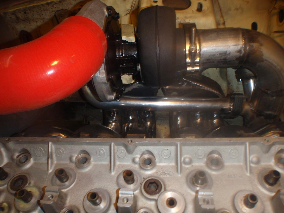

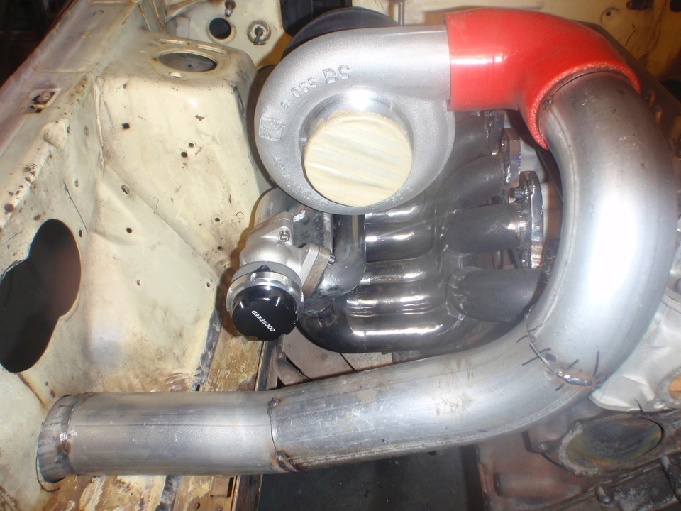

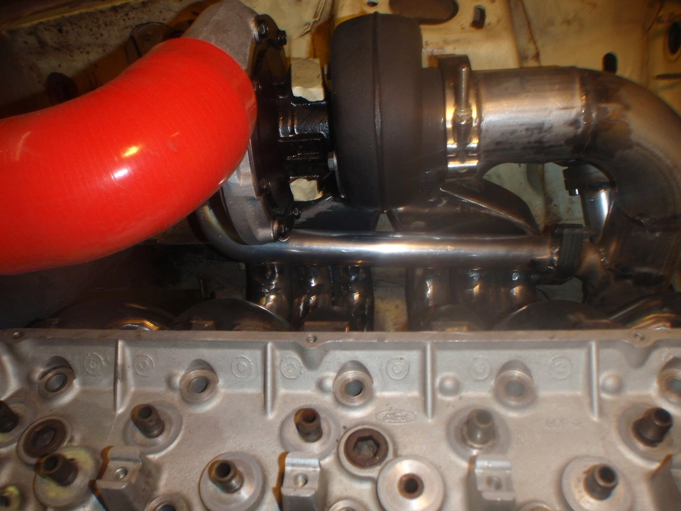

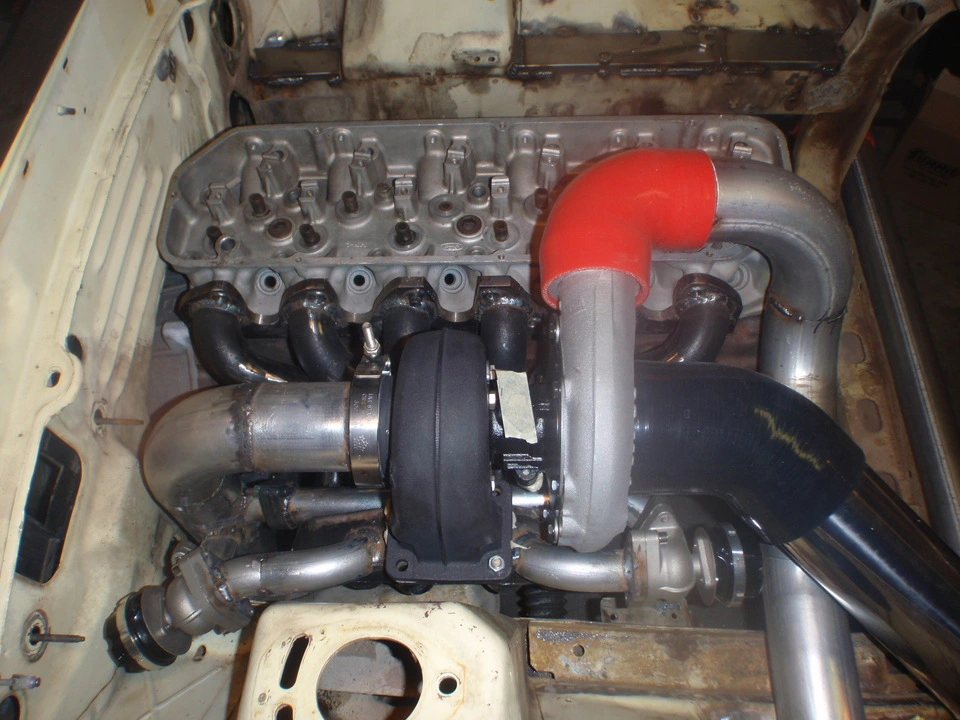

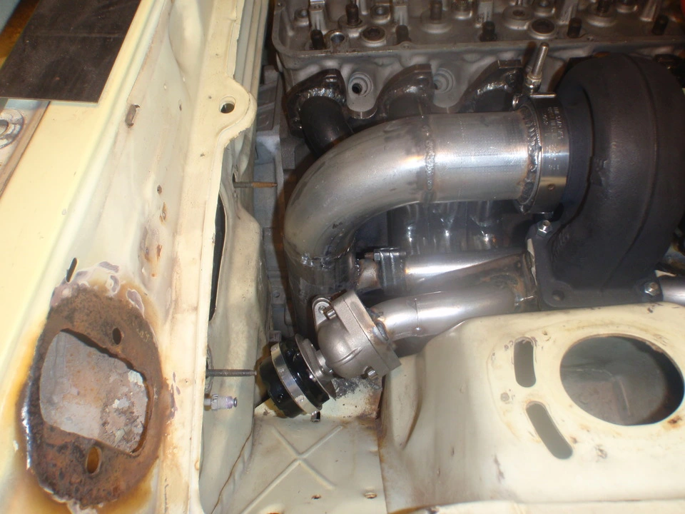

Spent the last the few days putting the final fit on the turbo system. I got the entire system built including the hotside, and the coldside. It still needs a bunch of detail work, (finish welding, grinding, and smoothing)
As I said i would, I bought Chinese waste gates. They cost 70.00 ea. When they got here, I took them apart because I heard that they typically were full of excess debris from the machining process, with jaggedy pieces of metal just begging to snag the diaphragm.
I'm here to tell you......they were right.
Every hole that was drilled and tapped had burrs, the hole that was cut for the valve had significant flash that needed to be ground away. Now that that is done,...I left them "gutted" so I could weld w/o worrying about melting the diaphragm. I also heard that the springs were inaccurate,...and I had to check the actual rated pressure to be sure it was accurate. ( especially since I have two of them) I haven't done that yet, but this car is far from running, I'll cross that bridge when I get to it.
The rear waste gate placement pretty well means that the A/C system will definitely either have to be relocated, or eliminated. I planned on relocating the A/C lines before I even bought the turbo,..so it's just one more bump I gotta deal with.
I decided to re route the coldside under the intake,..as there was no room for the front waste gate in my original plan. By clocking the turbo in this orientation, I gives me room for the waste gate, but will most assuredly force me to cut a hole in the hood, and there may be valve cover interference issues. But again, I'm building the valve cover, so I'll try to take that into consideration when that day comes. Clearly, I got two more holes to close up during the engine bay smoothing stage.
I wanted to get this part behind me so I could start on the engine bay I got one more 3" hole to cut for the piping that comes out of the inter cooler going to the throttlebody, and my hole cutting days are done.

I love custom turbo piping. Gives me a chubby every time. I'm glad to see you went with dual wastegates. You have two very distinct collectors at the turbo flange, but you'll have excellent boost control with the way you have that setup. Good call on dumping the gates into the downpipe. I just hope those cheap ass gates last for you.
As do I. The decision to buy them came after the feedback i got from bailing on the Chinee turbo. ( seemed there were those out there that weren't having all kinds of problems with that stuff)
The three potential problems with the ebay gates are debris cutting the diaphragm, the valve sticking open/closed, or inaacurate boost or boost creep. I got # 1 fixed, I'll lube the valve w/ anti-sieze for #2, and the other is related to spring pressures. ( I may just buy a set of 5lb springs from Turbo Smart, and hope that they'll fit these T-smart clones to try and fix #3).
I have my regrets with the choice to use steam pipe. That monster hanging on the side of the engine probably weighs 35-40 lbs. I just hope I can get it looking good enough to coat it silver/titanium. The way it is now,..it's slotted for flat black.
At least I know I'll never have to worry about having to rebuild the bit ch again into the next decade tough.:nonono:
