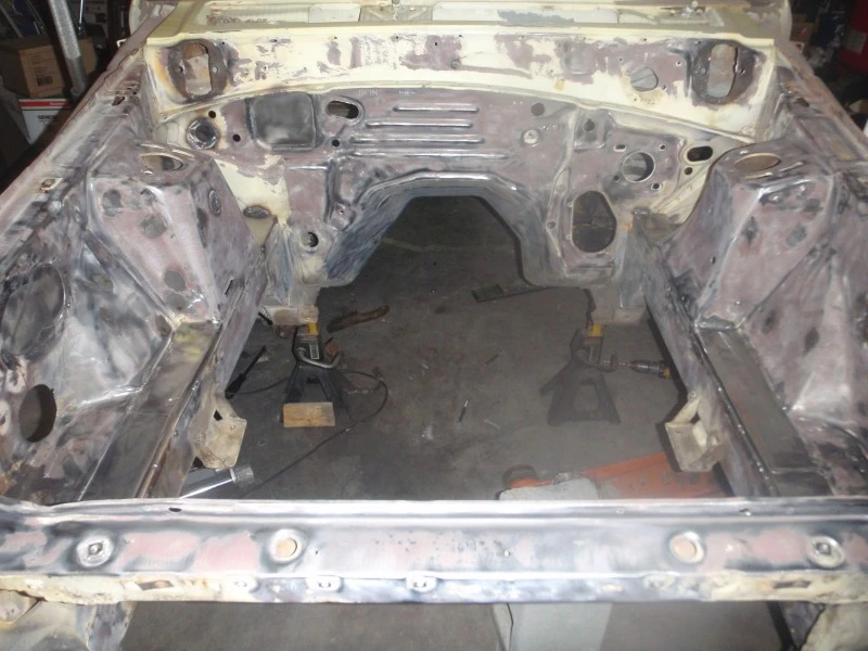

Well another Saturday, another nose and set of eyes full of black metallic dust.
:banana:
Seems Saturday is my day of freedom to attempt to get enough done to even talk about Saturday night. While it don't look like much, I think I can say that I did make progress.

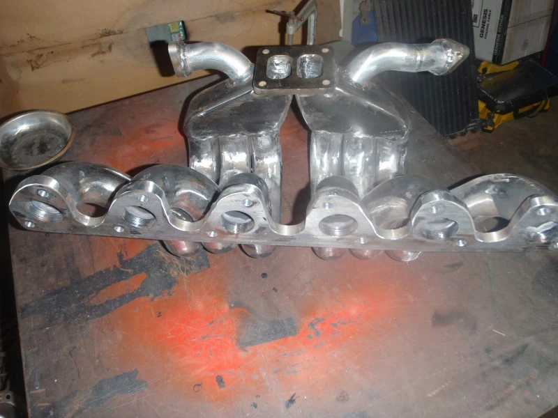

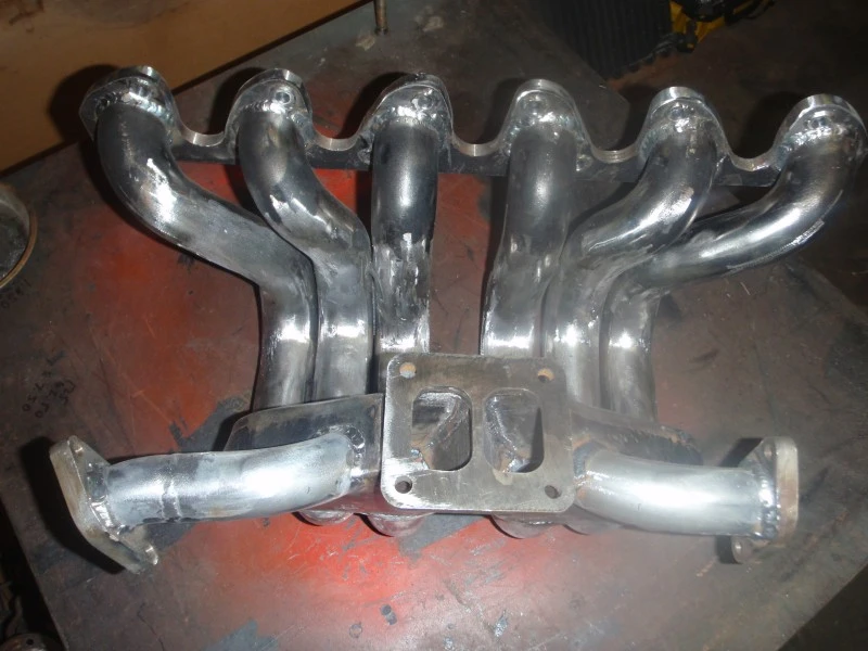

I finished the Exhaust header. I'm gonna take it to my friend that will blast it for me, and I'm gonna try the new 2000 degree VHT cast iron paint. It has to be heat cured to be fully capable of withstanding the temps a turbo will subject it to. Fortunately, I got another friend w/ a big assed oven that I'll be able to use to do just that.
On one hand I think it looks goofy as hell, on the other, I think it'll look pretty decent when it gets blasted, and gets a coat of paint on it. What do you guys think?

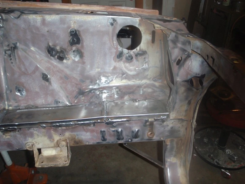

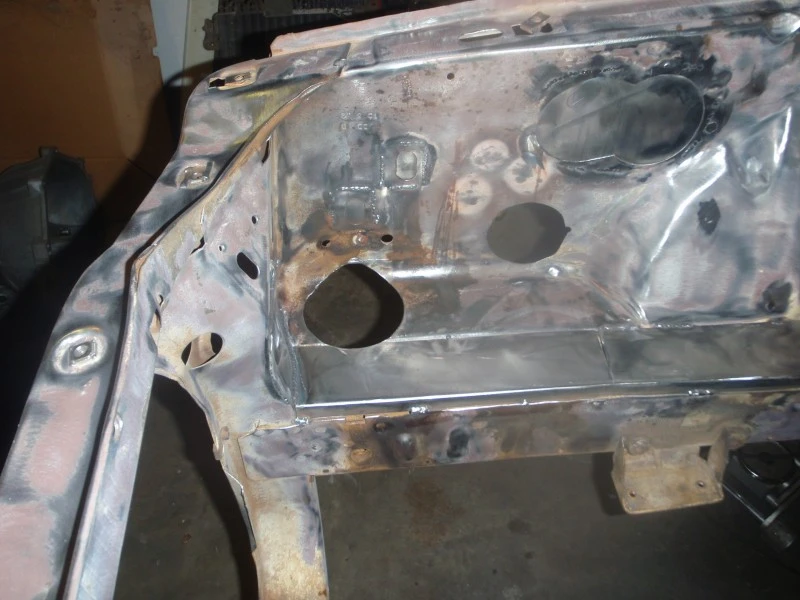

The big hole is round, it just looks egg shaped in the pic. The air intake will stick through that hole, the cold side exits through the little one.
I still got some final grinding to finish the holes to perfect round.
And it'll come back in through this hole, after the a2w I/C.
I do have a question though...Do you guys weld the plates that sit on top of the frame rail completely, or just stitch it every couple of inches?

I welded the boxed-in frame rails completely. Just pulsed the welder across the whole seam. That let me grind it down nice and use a minimal amount of filler to get it smooth.

Thanks for the advice, I've never went this far w/ a engine bay, so I just didn't know.
