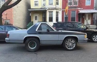

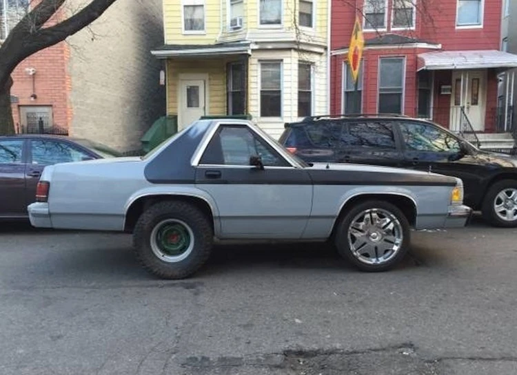

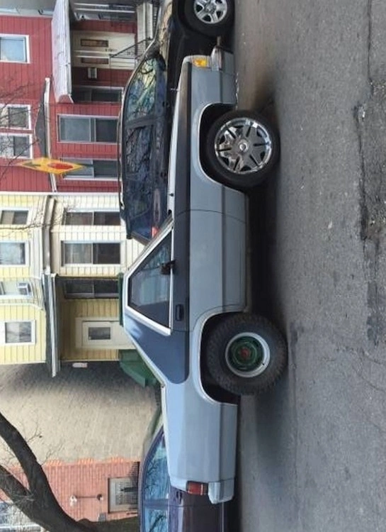

THAT is not a fairmont. It wasn't one even before it got smashed between two garbage trucks. Looks like it started life as a old crown Vic to me.

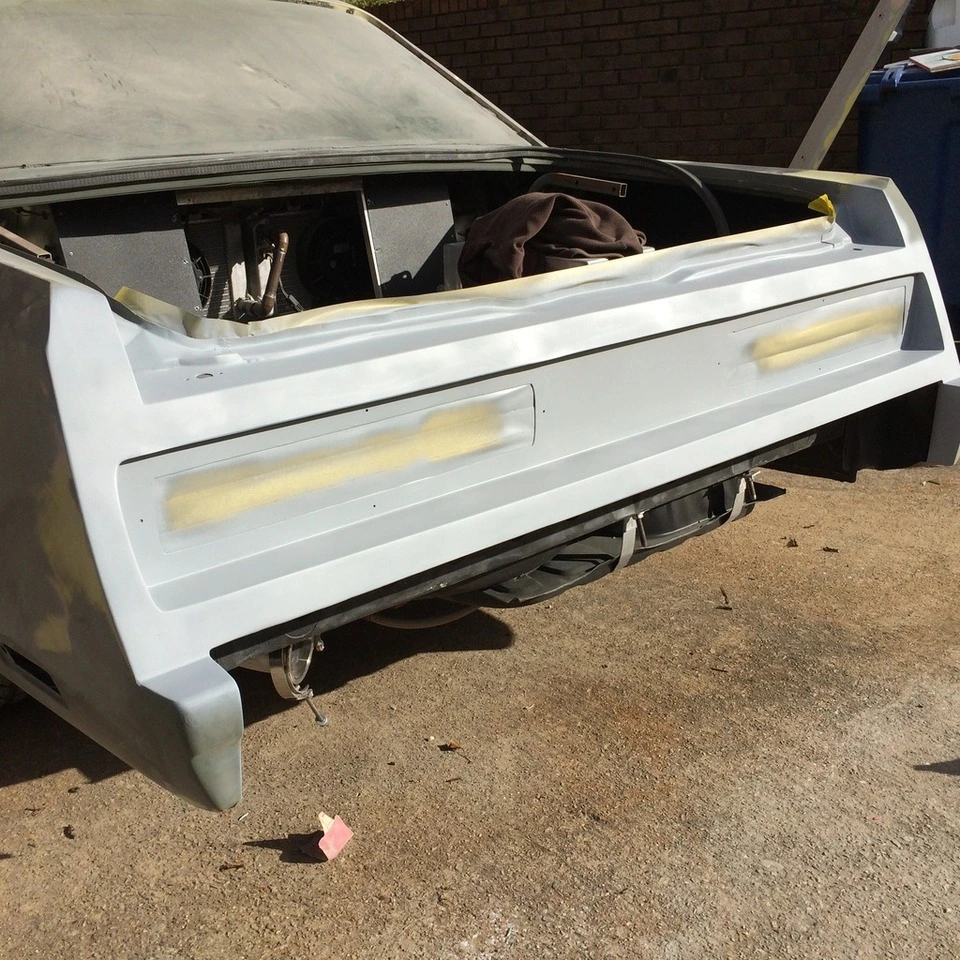

The garage had reached epic filth proportions. I had to back the car out, and blow the place out.The hood has been a giant pain in the butt, mainly because there is a dent in the center rib. I couldn't fix/fill that dent before welding the scoops on for obvious reasons, and now that they're on they just have been dealing me fits. Still not done, but I wanted to get a look at the front end from farther away than 2 feet.

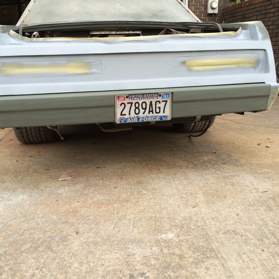

I'm really happy I decided to move the plate to the bumper. I like the rectangular opening much better than the old version. I just knew that I'd hear it from the Chevy boys that the tail light recess resembled a bowtie. I saw that myself. Not anymore. It's not perfect by any stretch, it's "very good". There are little jinky doos that you'd have to focus on to notice, but once the ribbed center is in the middle, the recess is painted satin black (against a Competition Orange body) and sequential led 68 Shelby tail lights are in place, I don't think anybody will fixate on the imperfections.

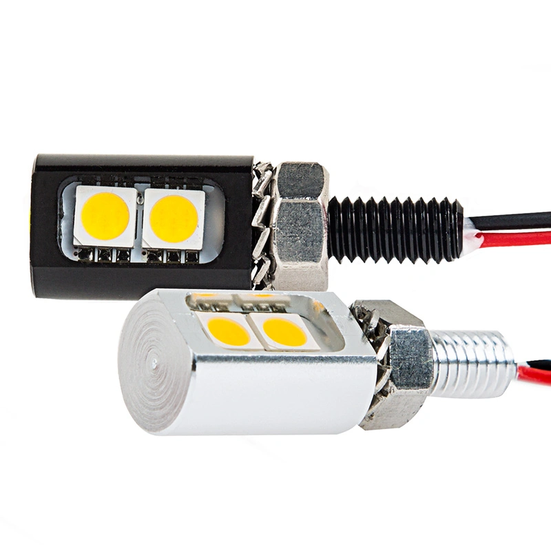

The bumper wasn't bad to cut and recess a plate so that the license plate could live there. I found these little led lights that serve as license plate lights that also act to hold the plate on so I think the "how to light the plate" dilemma is solved.
Now that that is solved,.....The plate will keep the cops happy.
