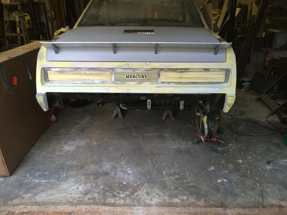

So,...we're done with the actual mundane stuff. You don't need to see bondo on the G Nostrils, and you wont like the grille in it's raw state, so we'll move onto you getting to look into my head.
This:

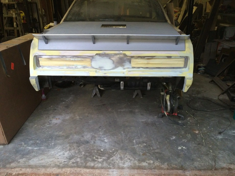

I don't like this design very much.
Despite the fact that it is actually at a much farther stage of completion than this pic conveys, I'm using it as a template for the before, and after shots to illustrate my idea. The part that I don't like is the whoopty that had to be made to accommodate the license plate in the center. It looks like a Chevrolet Bowtie pattern, and it has always bugged me. I really would like it better if that center section was straight across. The obvious problem with that is the plate wont fit.
So,......why not move the plate to the bumper?
The plate measures like 6.5" The bumper top to bottom is 6.5" If I move the plate, I'm gonna recess it into the bumper, If I recess it into the bumper, there'll be nothing left of the top and bottom. If there wasn't a G hole directly under the center of the rear bumper, I could just drop the bottom of the bumper to allow for that,....but.....
See the dillema?
But here's what part of the idea looks like on paper.. well,.......computer monitor.
The center gets a piece of 1/8" aluminum plate with fins similar to what I did with the original valve cover. Letters that'll either say CYCLONE, or MERCURY will make up the center, and I think this looks waaaaaaaayyyy better than the homage to a chevy bowtie that is there now.
But the plate.......
The plate has a 1/4" stamped border along the top and bottom that serve no purpose other than to maybe make it less flimsy? If I cut that border I can make that plate fit inside a recess in the bumper. People put damn license plate frames that completely cover this perimeter so I cant imagine I'd get dinked by the Man for modifying my plate. Once it's in that shadow box, maybe it'll be less noticeable?
It's past Idea stage,....the whoopties are filled in with plate now,...and they are just as raw as the grille, so again,....not gonna show you the actual.

I like the new version. How about a motorized hide a plate you could mount to the side of your rear bumper?

Naaww,.....the plate would have to be displayed all the time the car is on the road, so I really don't see hiding it for a show as a solution. I have been trying to balance out whether or not to side mount the thing though, but I still have B/U lights to consider too.

I think you should completely fill in the space in between the tails. Let the tail light "boxes" be the only recessed portions of the rear. But thats just me, your alter Iowa ego.
Wait, I cant remember where your fuel cell filler door is? Stock location? Without searching back, something tells me you welded and smoothed the original gas door... Why not put that fuel filler in between the tails like on the Mustang/Cougar your tail lights came from?
The door is still the plan. relocating a filler neck isn't an option. There is a honkin trunk latch mechanism there. Besides, the last time I did that on the red car it took for freakin ever to fill the tank.

image.webp Make the center part the back up lights. They could light up through the slits and Mercury/cyclone lettering :D
Dammit Raggedy.
Maybe if the car was done. Maybe if there wasn't 50 bagillion other piddly assed little things to do, I'd consider it. But for now.

No, it's definitely a good idea, and it would kill two birds ( I'd fill the center with the detail piece that also serves as the backup light), but the plate would have to be laser cut. No idea how much something that costs.
