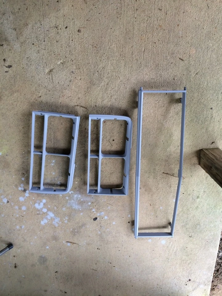

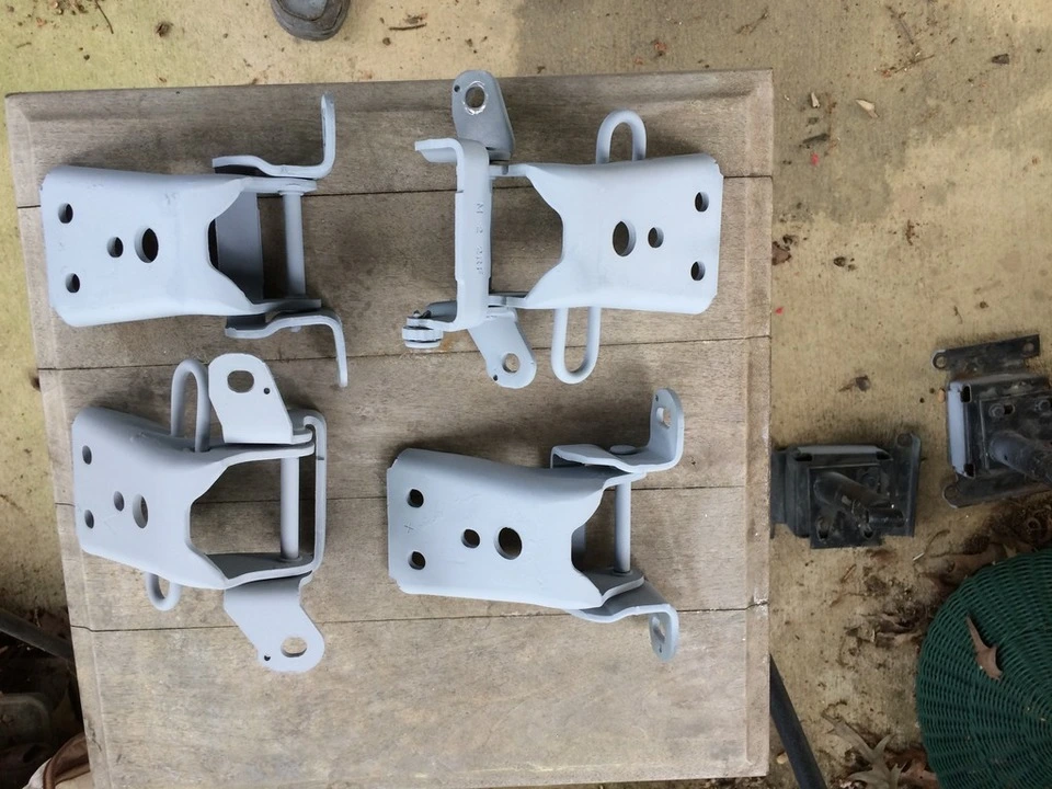

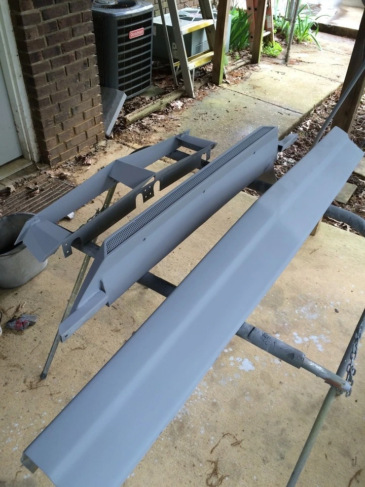

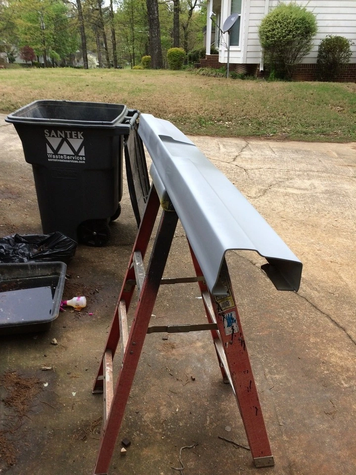

Ok,....Awhile since I've updated things here. On the other forum I frequent, I said that my goal today (my day off) was to get several things ready for paint.. (I know! I'm actually talking about the same paint that will go on the car!!) Instead of painting the car, and then chasing after the small parts that might not get the attention they need in an effort to get it all done,..I'm doing things the other way around. So, The items on the plan that needed prepping today were both bumpers, the front oil cooler shroud, the rear exhaust tip, the hinges, and the grille and headlight bezels. All of these pieces will be the same color as the body.
These things are pretty much ready to go. The only thing that showed its ass was the rear bumper. After it got in primer, a line showed up that looked like a wonky body filler fillet. Only problem was there was no body filler on top of the bumper. The only thing I can figure is that it must be some kind of collateral damage when I made the rear tail light panel and was shaping/sanding the bottom edge.
So,...I had to fill that line. That meant a couple of steps backwards.
It's primed back in this pic, but the top of the rear bumper is just a mess. All of that grinding, sanding and shaping has made the bumper really wonky on top. I have more work to do to get it decent.

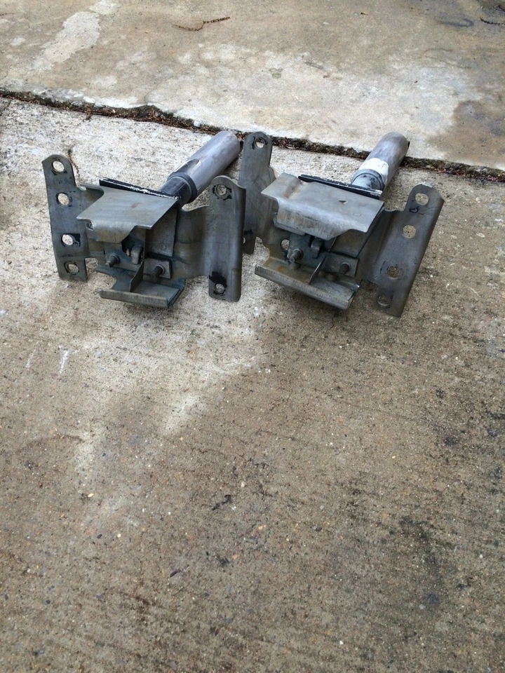

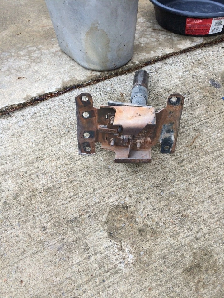

Finally,...Proving a point that muriatic acid is the go-to for removing rust quickly, I dipped my front bumper brackets.
They started out typically skanky.
These things were not especially rusty, but my muriatic acid has been used one time too many I think. Instead of taking 5 minutes, this time it took some elbow grease, and ten minutes.
But nonetheless,...I succeeded.

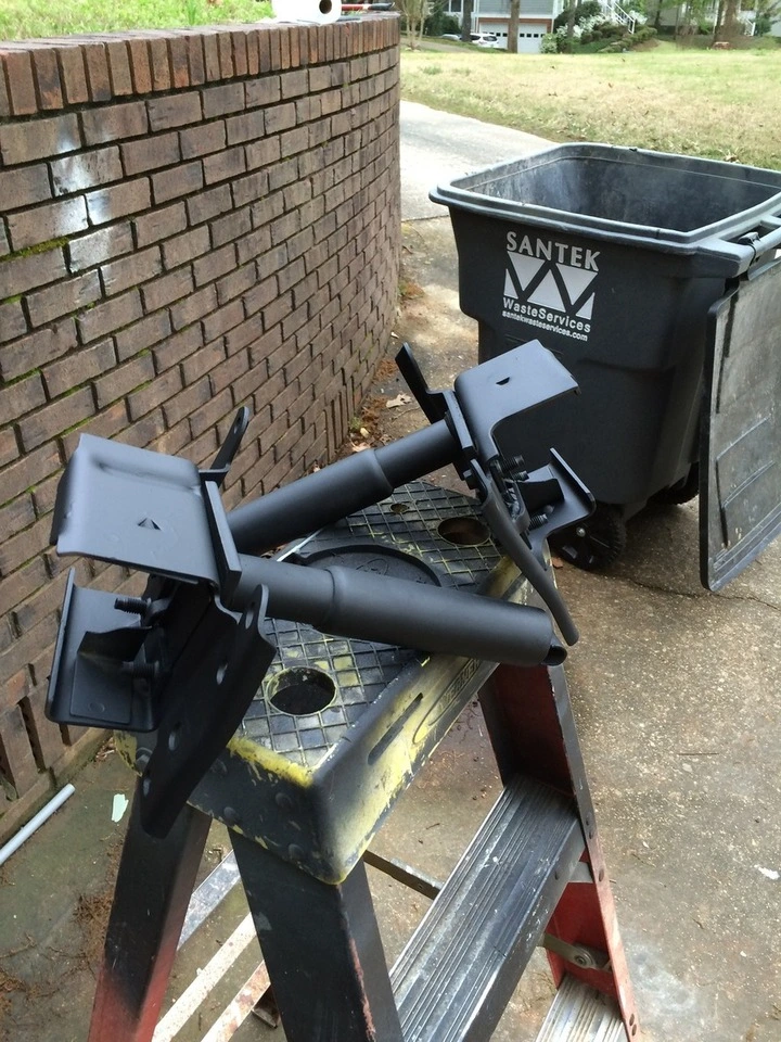

The one byproduct of using this stuff is that it strips the metal bare, but it has to be neutralized with water. As to be expected, running water on absolutely raw metal leaves a very small window before the rust you stripped off starts coming back (like,...... minutes) By the time that pic was taken after the parts were dry and the things were already turning orange.
I sprayed them with that junk that stops the progression, and renders the rust dead.

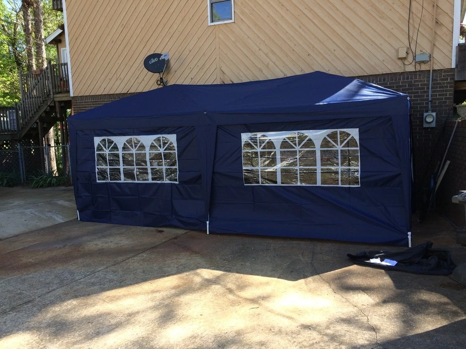

I got an el cheapo 10 x 20 EZ up for Christmas from said wife, and it's been sitting in it's bag until the Alabama sun justifies putting it up. It's only gonna get to 75 degrees today, and that still isn't really justification for putting the thing up, but given the fact that I need some covered space outside of the garage to try and keep the dirt/pollen/bugs off of my newly painted junk, there is no better reason to put the thing up.
Since I haven't actually seen the thing erected, I only got a picture. I think the thing also has a perimeter, zippered bug screen, but until it goes up,...I can't say for sure. But wouldn't that just be the sht?
I plan to go get some 2 x 4's to build the racks stands that will do more than hold the bumpers. I'll probably configure them so they'll hold doors and fenders when that time comes, so some planning is involved.

Ok, Mike's Polyester Paint Pavillion is up....
