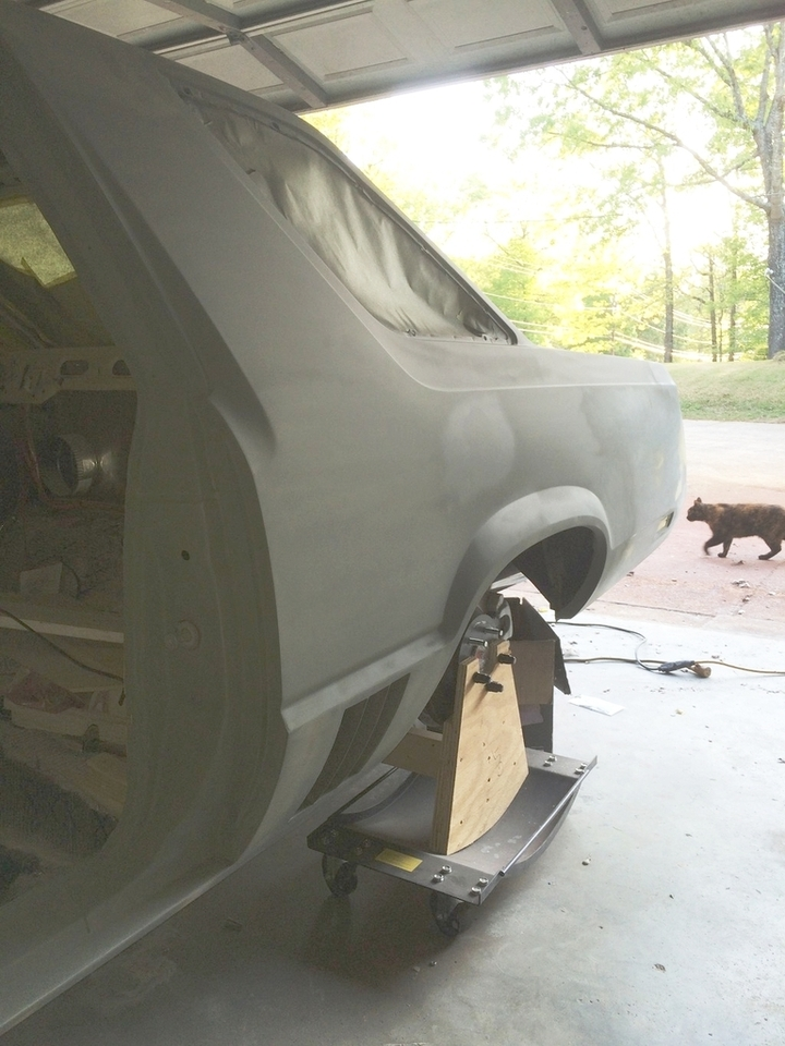

I get home at 2:30 today, and I'm back in the garage by 3:00.
I start in earnest, trying to get the remaining nit-picky little details put to bed so I can start masking the thing for primer.
It's was the masking that I under estimated. That process took too long today. That, and I ran out of tape. I got the trunk, rear tail light openings, the rear window, and the quarter windows done before the tape ran out.
Since the driver side quarter was bare metal, I rattle canned it in etching primer.
I think the quarters are straight. The rear most quarter extensions at the top are gonna be a challenge. You can see the line where they are welded on, and the body line gets all wonky. That piece is made from 5 pieces of steel that are all butt welded together. The fit is good almost every where but where it matter most. I'm hoping that as the primer starts to build that I can make the line, and wonkiness disappear.

Is that your cat?

I have found that the guide coat will tell all. I did all my bodywork put in the yard!:eek:
Had to cover the primer in something that would not let moisture through, gloss rattle can anything worked well. Just enough to cover the primer. The nice thing about the gloss is you can see every imperfection and wonky line.... give it a try.
