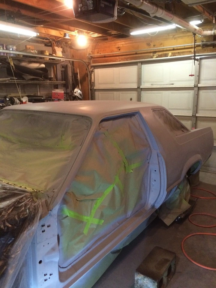

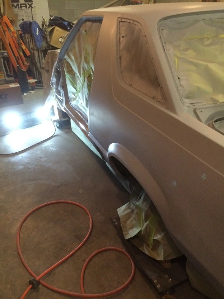

Over the last few weeks, I've been trying to get the body ready to prime. Over the last few days, I've been masking it so that could be done.
Today,....the Monster turned grey.

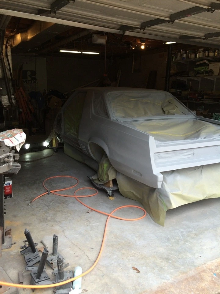

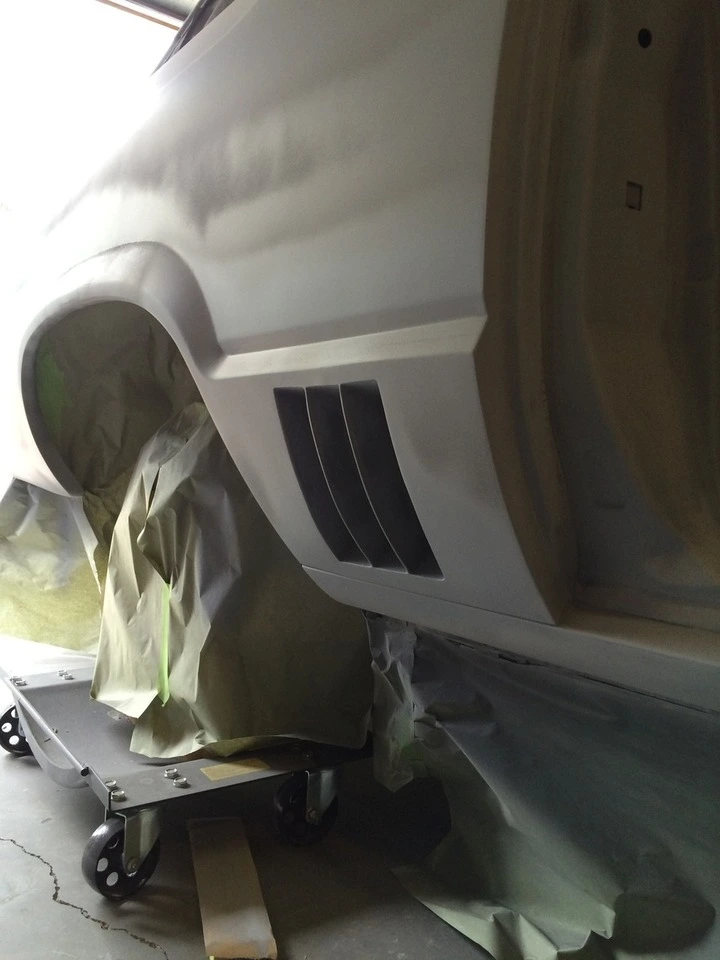

Things didn't start out too well,....even though I followed the mixing instructions, and use the right stuff, the primer didn't want to spray. I was literally spraying sand. It didn't take long for me to realize that it was needing some thinning, so I did that and stuff started happening like it's s'posed to.
I got down one heavy coat, and stopped. I wanted to sand the Sahara desert off the drivers quarter before going further, so I waited a coupe of hours, and blocked the whole car. When I started back at it the stuff flowed out famously.

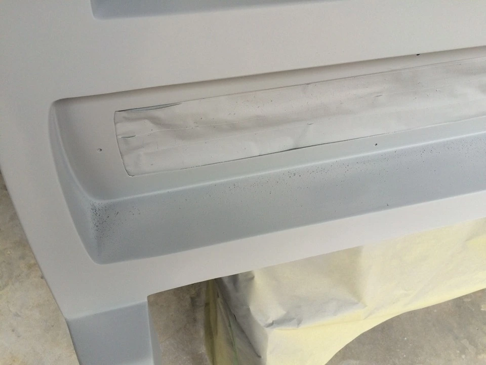

Now if I was a painter by trade, I would've known better than to work towards the middle of the quarter, and I wouldn't have the dry spray you see in the middle. But that stuff litterally wipes off with a scotch brite pad, so I'm not too concerned.
Compared to the red car, where I let a "friend" finish the body work and paint it, this car is hands down straighter than the mess that guy handed me when he brought the red car back to me.

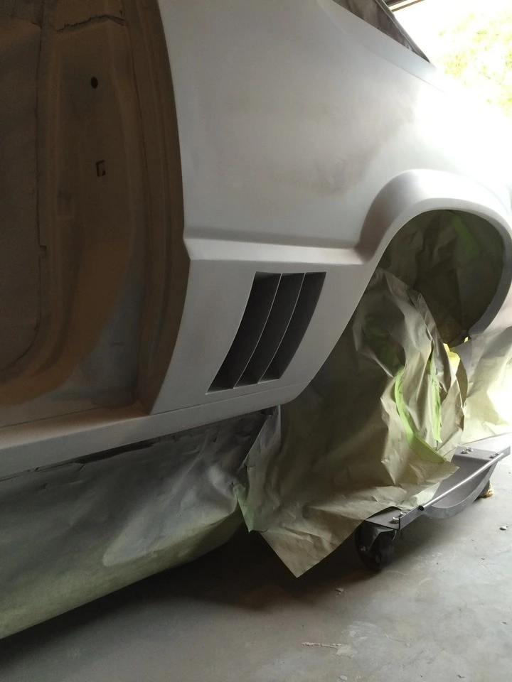

Excepting the Gila gills where you can see some slight wonkiness, the car is very straight. And when you consider that I hacked a gigandor hole in the quarter in front of tire, and welded the G gill in there, and welded the body line closed behind the tire, I'm pretty pleased with myself for getting it so nice, all things considered......

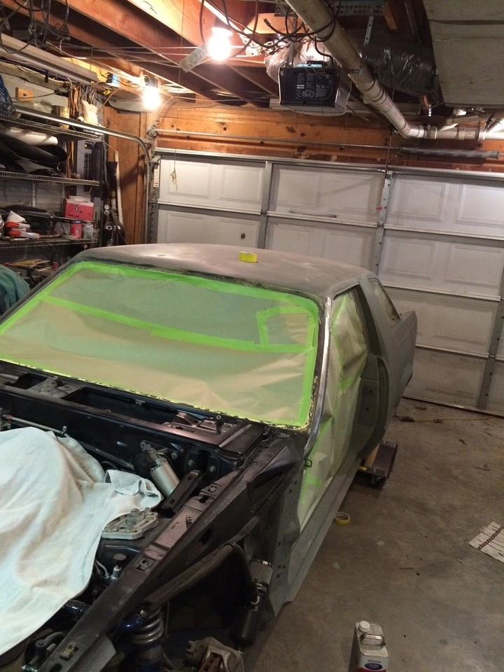

The one thing that did go wrong isn't the end of the world...
Sanding dust. In the primer. As I was coming around to the back, I must've missed some little pile, and when the gun started spraying,..that junk just went everywhere. At least it's just dust, and not dirt, and it's in the primer,.....so....things could've been worse.

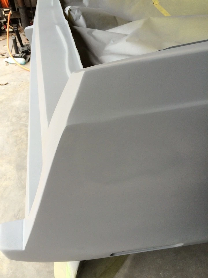

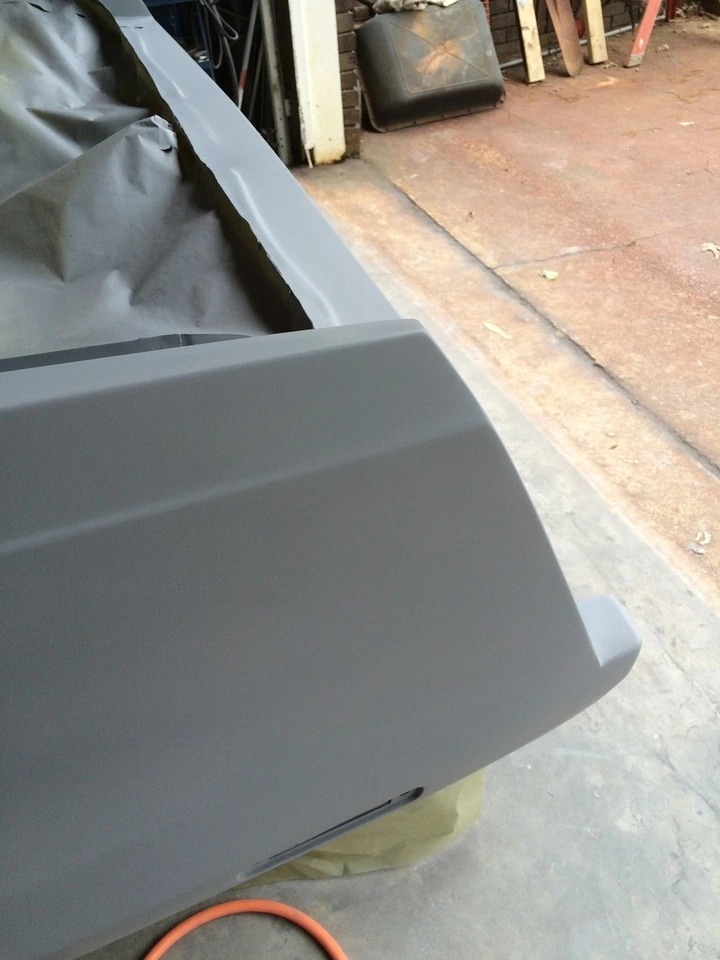

The two "issues" that remain that stand in the way of paint is the rear most quarter extensions,....They are just all kinds of wacko.
This one needs the body line to be brought up....
And this one kinda needs some definition, and brought down a little.
But that's it. I'm gonna add a little glazing putty to them and hopefully I can get them to fall in line. I'll block the body using a guide coat, and see if it's as straight as I think it is,..and the Monster is in line to be Orange maybe next week.
@a91what is right Mike. Use the glaze for filling in scratches and pinholes. Rage gold is a good bondo, you probably know this already. Use guide coat on your bondo as well as the primer, it'll take more than just a taped line to truly make that line. Positive side, you're within an hour of being done with bondo!:banana:
Good job on the primering though. Almost there!
