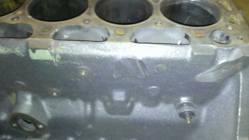

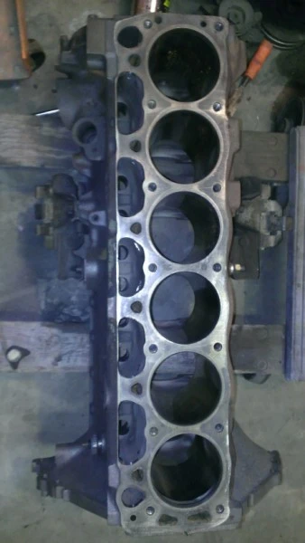

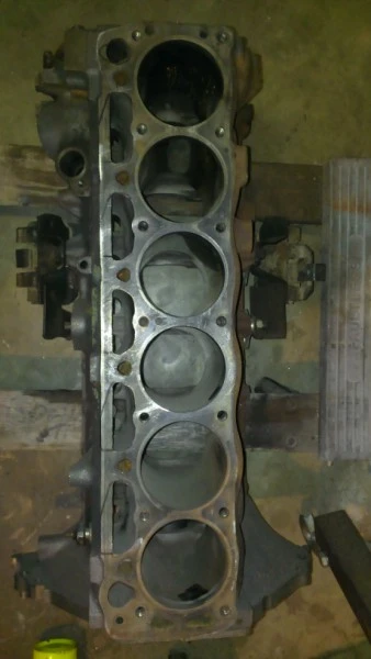

This is what the deck looks like on my ugly little banger before you have to hog the lifter galley. Since a crossflow head has canted valves, the pushrods need additional room to operate those valves,...so you gotta get out a jig saw, and a die grinder. You can see the Sharpie lines on the bottom two holes of the cutout I was supposed to make.
1 hour later I do this:

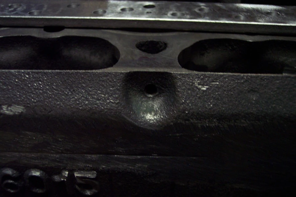

Even as big as they are now, they are still not big enough. The mod requires that I bolt a piece of 1/4"x1-1/4" flat bar along side, and fill the top gap w/ epoxy, and then grind even more to what will amount to actually grinding through the top side of the block into the epoxy. Since the only thing that happens on that side of the block is oil drain back, the plated epoxy solution will be fine.
This is where I stopped grinding. I actually used a 1/4" shank router instead of a die grinder (my poor man's Bridgeport) to get the opening smoothed out after I rough cut it w/ a jig saw. When the grindings' done, even the small remaining margin you see will be gone. The flat bar acts as a trap to hold the JB weld in the bevel. I'll be able to bolt the plate to the factory bosses you see that are obvious in the pic.
I'm not the only guy doing this, so I can't take credit for it. There are numerous guys in AUS running a roller in their engines. This guy is one of them. The link shows his engine, and has a sound clip down the page. While his cam is bigger than the one I will have, the sound of the engine is worth a million bucks:
http://www.xfalcon.com/forums/index.php?/topic/22916-xflow-story/

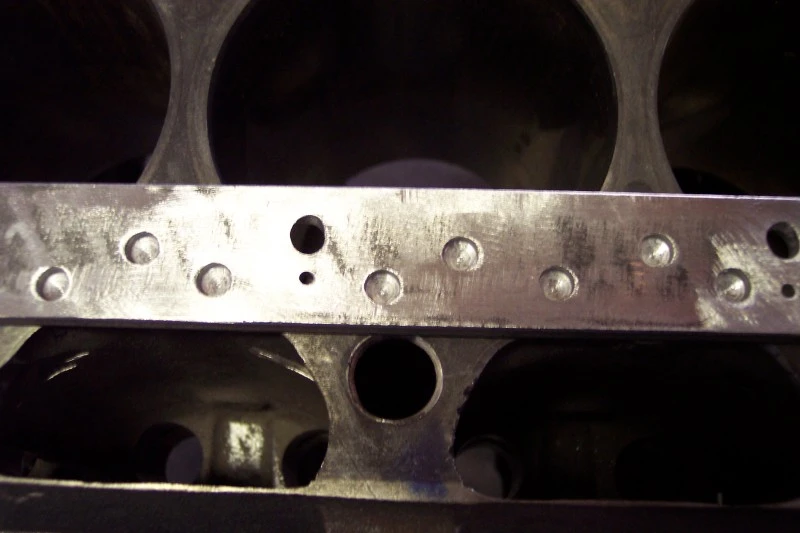

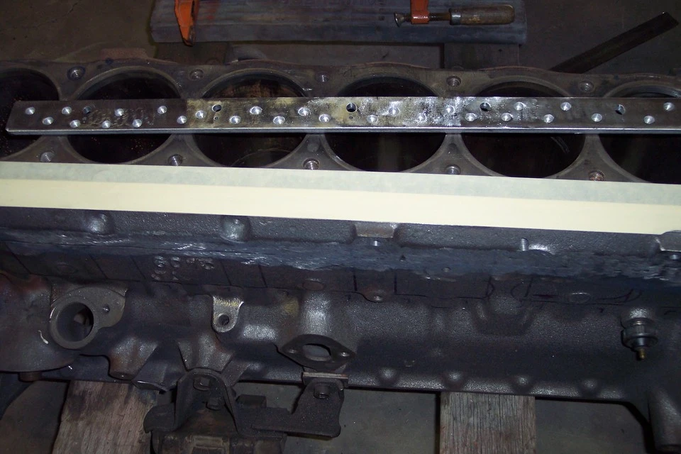

Today, ( actually a couple of days now,..) I've been prepping the block for the reinforcement plate that gets "glued" to the top side to reinforce the butchery that has to happen to accommodate the intake pushrods on my Xflow head swap.
There are things about the swap that bother me, particularly having to block off so many water passages to the head,..but that is another hurdle I'll jump later in this build. For now, getting the cam and it's respective lifters to fit become the priority. I've already started modifying the lifter galley to allow for this, but I'm at the limits of the block, so now from there, I have to add material to bolster the necessary hogging that has to happen to allow this crazy s hit to work.
For now,...I will deal w/ the bar stock that has to go along side:
Previous pioneers that have done this before fit a .250 thick, 1-1/4" bar between the two end standoffs on the block, I decided to make mine run the length of the block, starting at the front stand-off mounting surface for the front accessories. Since I plan to epoxy, and bolt my plate onto the block, I went a bit further and drilled all these additional holes to give the epoxy more to bite into.
This is where I plan to cut through to allow a set of linked lifters to pass through. the intake, and exhaust lifters are on both sides of this obstruction.
It has been detailed before that I plan to use a roller cam in this combo. Getting the roller lifter down into the galley, and re-linking the pair actually proved too much of a PITA for me, so I chose to cut slots for the linked lifters to get past the deck. I'm not at that stage yet though as I had to do the plate first before I could cut anything else. But I did drill and tap the six holes in the side of the block for the bolts to go through into the water risers where I will eventually cut a slot out of:
This picture is blurry, but it is supposed to show the surface finish of the block side of the match up. I used a grinding stone to further aggravate the surface so my glue will hold better. The bar that goes against the block is obviously the piece that is sitting on the deck.

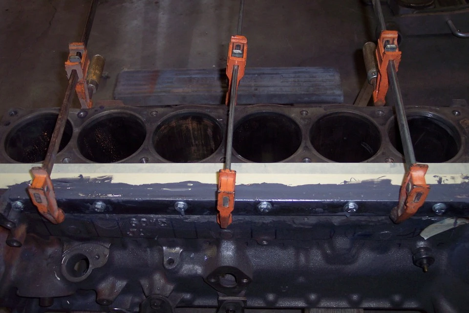

I bought the large size JB weld you can get at AutoZone, and It's good that I did. The process uses about 2/3rds of those large tubes to butter the back of the bar, and then fill the remaining gap. It was at about this point in the process that I had to deal w/ how I was gonna glue the plate using bolts that would have to be removed later, but be immersed in epoxy at the same time.
Hopefully, this'll be the solution to the problem. That, my friends is automotive paste wax. ( Meguires paste wax w/ "carnuba" to be exact View attachment 120200 ). I liberally coated these six dudes w/ that wax, hoping that when I go down there and try to turn those bolts counter-clockwise they come back out. If they don't,....I'm screwed. View attachment 120201
Because that junk is on there.

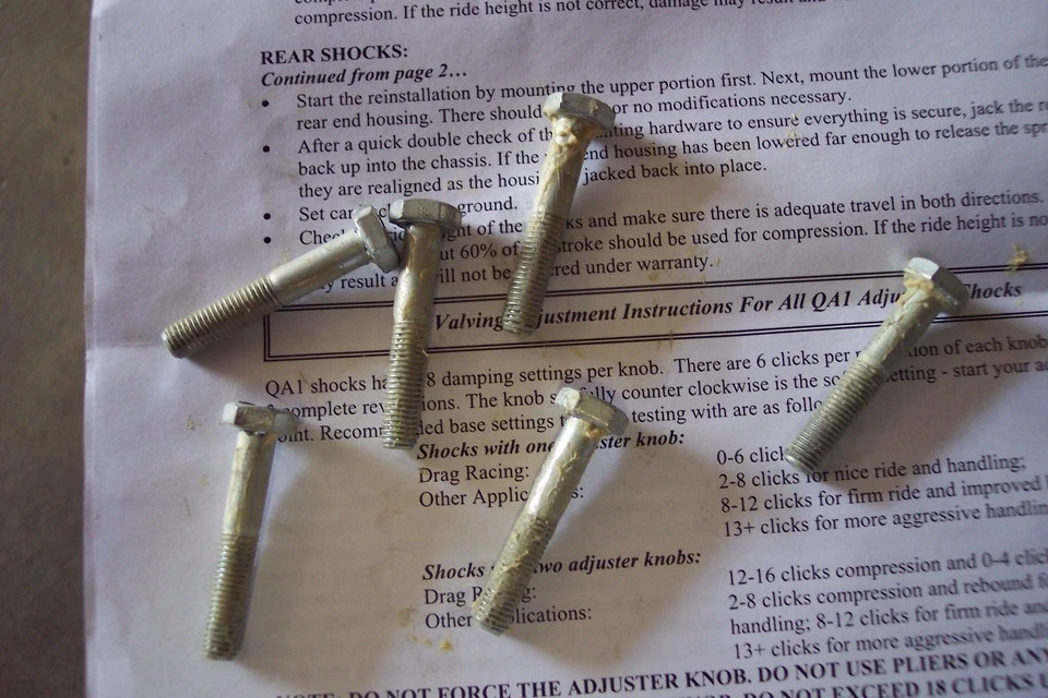

After gooping the plate, and carefully bolting it in place, I tightened the bolts, and added these three clamps to be sure the plate is tight on the bottom as well. Then I took a heat gun to warm the stuff up (it's 50 degrees here today) and tapped all down the side of the block to aid in the leveling process of the epoxy. Almost immediately after my heat/tap regimen began,..air bubbles started to make their way to the top, so I heartily mandate doing the same, ( yeah,..... like any of you guys are gonna butcher an I-6 anytime soon:rolleyes:) because clearly,..the thing would've had quite a few trapped bubbles had I not. It doesn't self level very well compared to the more expensive epoxies I've used in the past either,...but I think I'll be ok.
I'll give it till tommorrow before I go down there and attempt to back those bolts back out. If any of you hear any screaming about 6-7AM tommorrow,......you know it didn't go very well.;)

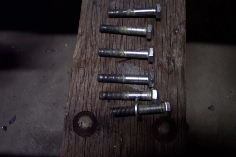

Just as a follow up.
Six bolts, covered in paste wax go in to a project where at least three of them have their main sections completely surrounded in JB weld and allowed to set up hard around them.
I was worried at least those three would be permanent additions to my monster.
Not anymore.
Not only did they come out, but they came out so easy I backed them out w/ my fingers after breaking them loose w/ the wrench.
Lesson for today then. If you DONT want JB weld to stick to something,...
