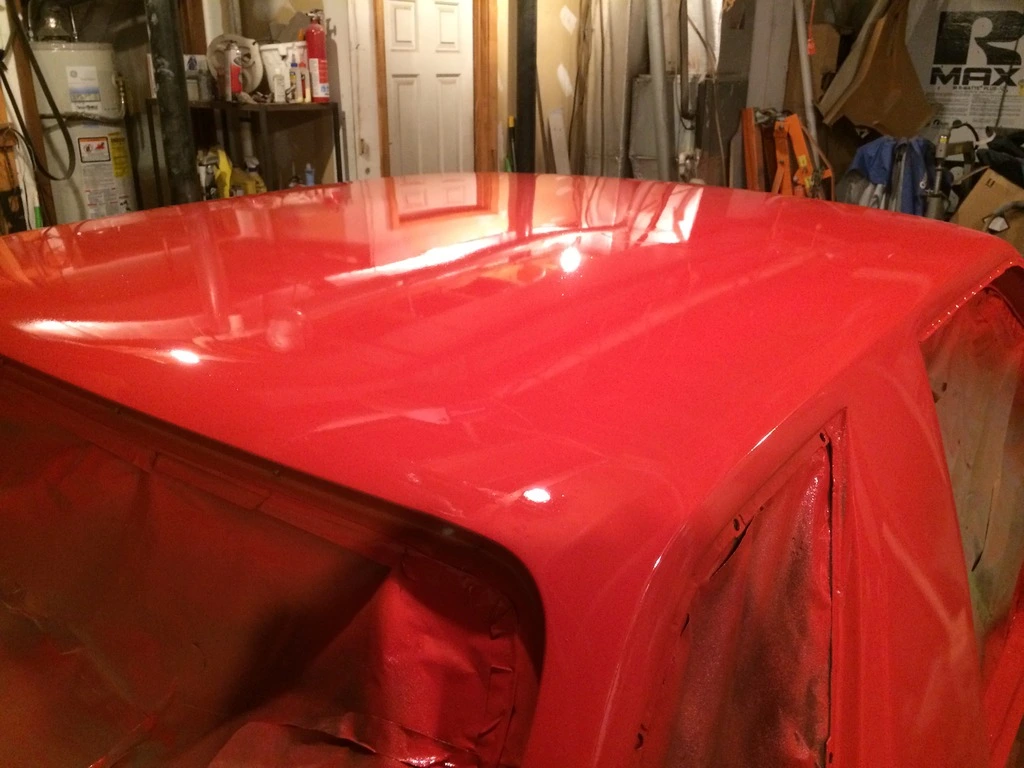

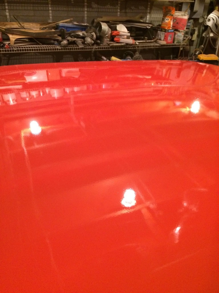

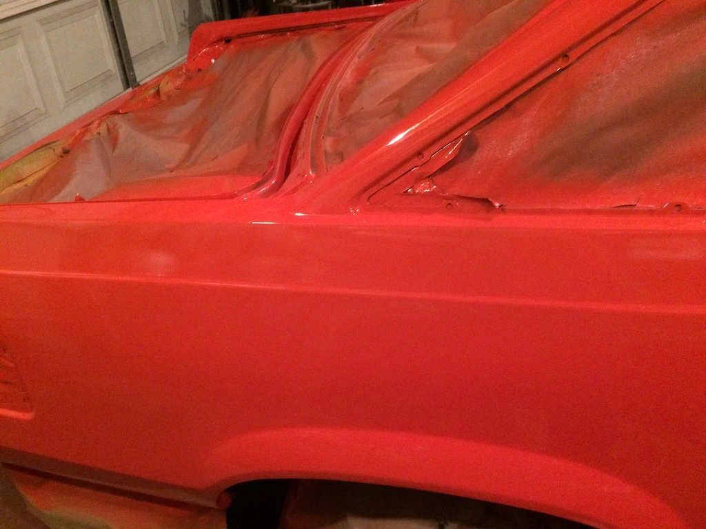

I'm soo glad you guys have went right ahead, and continued w/o me.
I just got home. Straight down to the garage, and now,...I'm thinking,...could the orange peel that looked so prevalent yesterday, have shrunk overnight as the paint dried?
I just cant get a decent picture w/ this stupid ass phone. The purple blotches don't actually exist. The purpose of the shots are to give you an idea of the texture. It is significantly smaller than it was yesterday,....To me, It's manageable.
But the reality is that there are many panels that'll have a completely different batch sprayed on them, If I somehow manage to colorsand, and buff this btch out.
I'm thinkin' that that isn't gonna be ideal......having a different gallon sprayed on the other pieces...color mismatch out the ass.

You're welcome!
Man, that's great, Mike! I was worried about my son's car, but the following day it laid fown, and I was pretty pleased overall.
You know- @Davedacarpainter may correct me, but a different batch of paint doesn't automatically mean a color mis match.. I know it's a chance, but not a given... Dave??

Light can be a tricky thing Mike. Look at it in the sunlight. Who knows, maybe it shrunk back for a positive change?
Good color though, btw.
Shoot a fender with the new color before you sweat the color too much. The variant you can have is that whomever is mixing the paint is off from whomever mixed the last batch. Maybe it will be fine.

In reality, what do I have to lose but some time and effort? If I work that quarter w/ 1000/1500/2000/2500-3000 before I hit it w/ a buffer what'll I be out?.......an hour?
If I can make that quarter look good, the rest of the car will fall into place like dominos.

PNR? What do you have to lose Mike. Maybe it will all work out. If you can rub the car out then hoorah!
I would skip the 1k grit though, it will remove too much. Plus those scratches are a pain to remove and you need to be cognizant of the thickness of your paint.
If you can rub it out, I would still change the mix ratio to at least 8-1-2 for the other parts. Way less rubbing.
