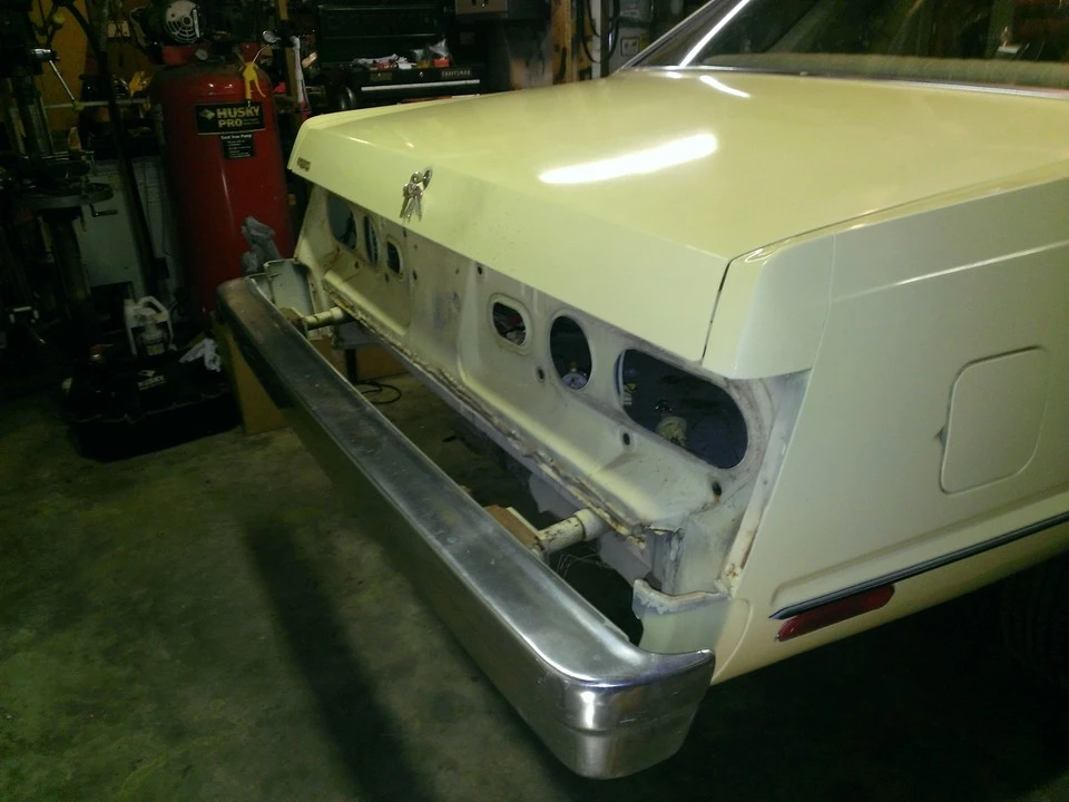

View attachment 125129 I got home and removed the old tail light base. The bumper hangs so far back there it's ridiculous. Like w/ all of my previous 'Monts, I will modify the brackets and shorten that stand off by about 6". It will tuck the bumper nicely against the body. This is what you start with:
I'll drill a hole in the shock absorber, it'll let me collapse it to the flange. I should get about 3-3.5" of reduction in the standoff. I'll also cut that honkin' block of steel down and pick up another 1.5-2"
I've stared at it enough to get my plan together,....I'll buy the GT 350/500 tails tomorrow.

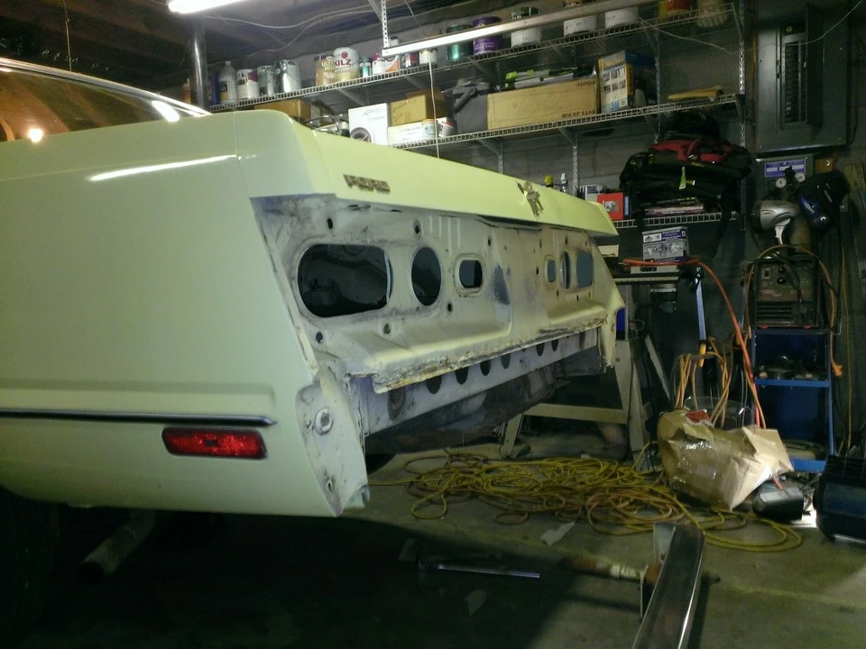

The Cougar tail lights are also going to be tough, primarily because they are not rectangular,.. they taper. I did not know that.
I'm still up in the air about them,.. it will be an irreversible "leap of faith" once I start tacking sheet metal together,...(I wish I could draw good enough to make a concept drawing to work off of)
The Fox tail lights look like they will actually work better,.. with less fabrication,... but in the end they'll still be Mustang tail lights

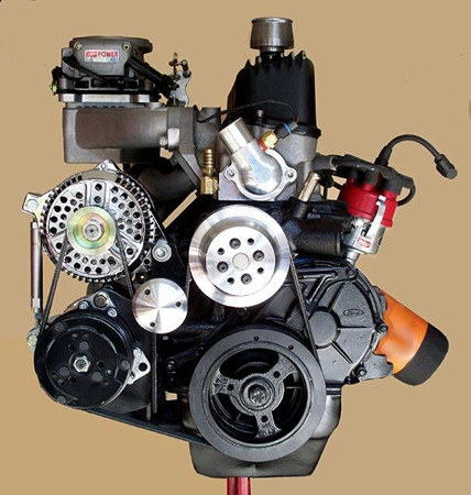

No,.. no aluminum head for me,.. That head pictured above costs 2 grand.
The Aussies did big stuff w/that engine,.. even had a canted valve alum head w/ intake ports on one side and exhaust ports on the other.
The head is on Australian eBay,..for 250-300.00 given the current exchange rate..but from what I understand most of the "mates" over there won't ship one to the states.
I plan on using a copper gasket, and an o ringed block. Now that I just sleeved the thing down to standard,.. it will supposedly be good for 20lbs of boost. The cast iron head will be the limiting factor,.. stopping me at 450hp.
If I could just get one of those Aussie Cross Flow heads........
