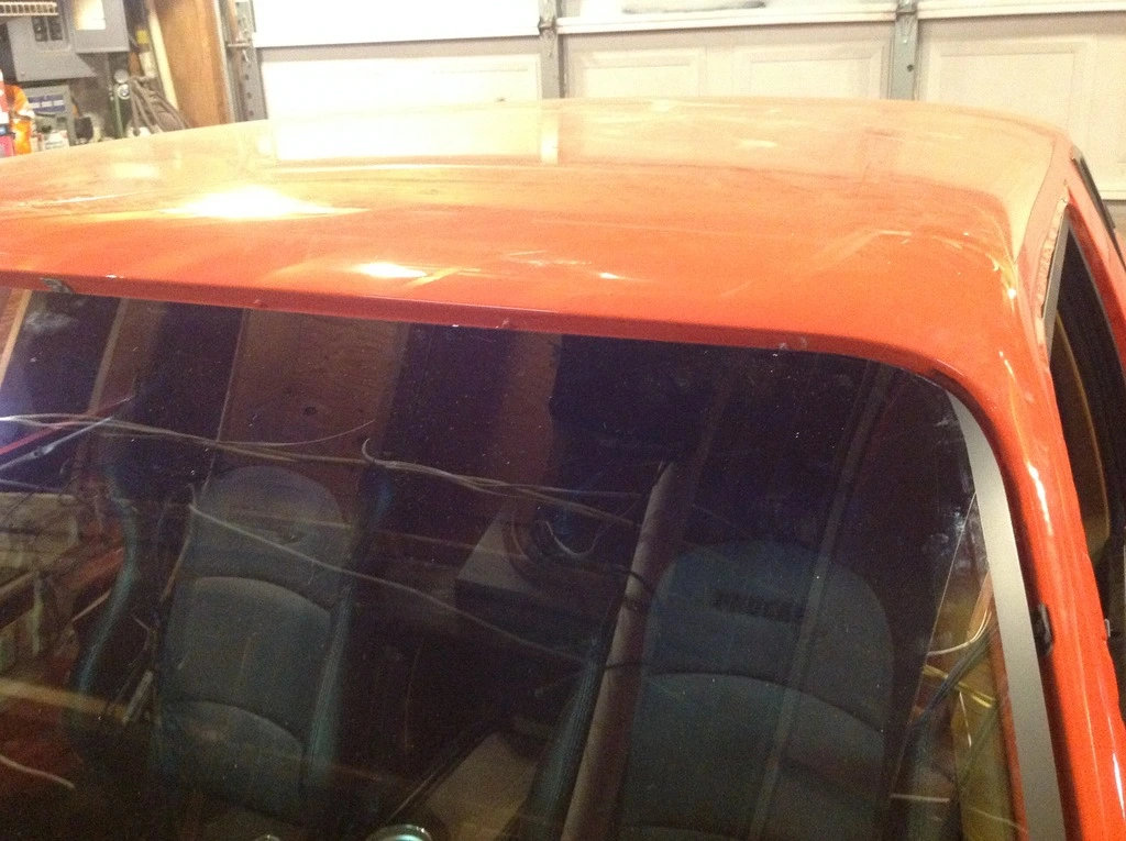

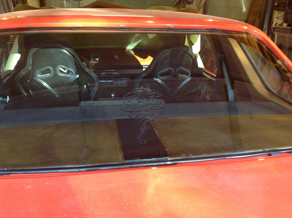

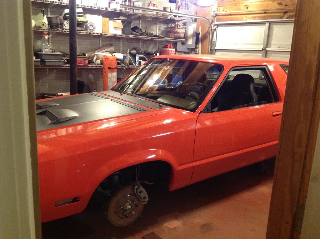

My guy gets here at 10 AM, and is done one hour later (Just like I thought). He does the rear glass first.
It goes on perfectly. But it ain't perfect. I just didn't notice how many scratches were in that damn glass for some reason when I was covering the big assed scratch with the Cyclone decal.
It's too late now, the glass is set. It wouldn't matter anyway,...I'd still use it. It will work until I get a hair to change it out.

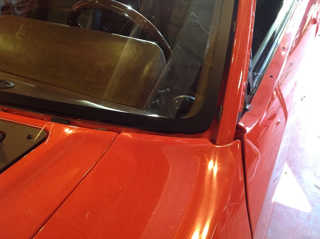

The front glass follows immediately. When it;s done, he looks at the front glass and says that he didn't think my trim was gonna cover the gap between the dash top.
He was right.

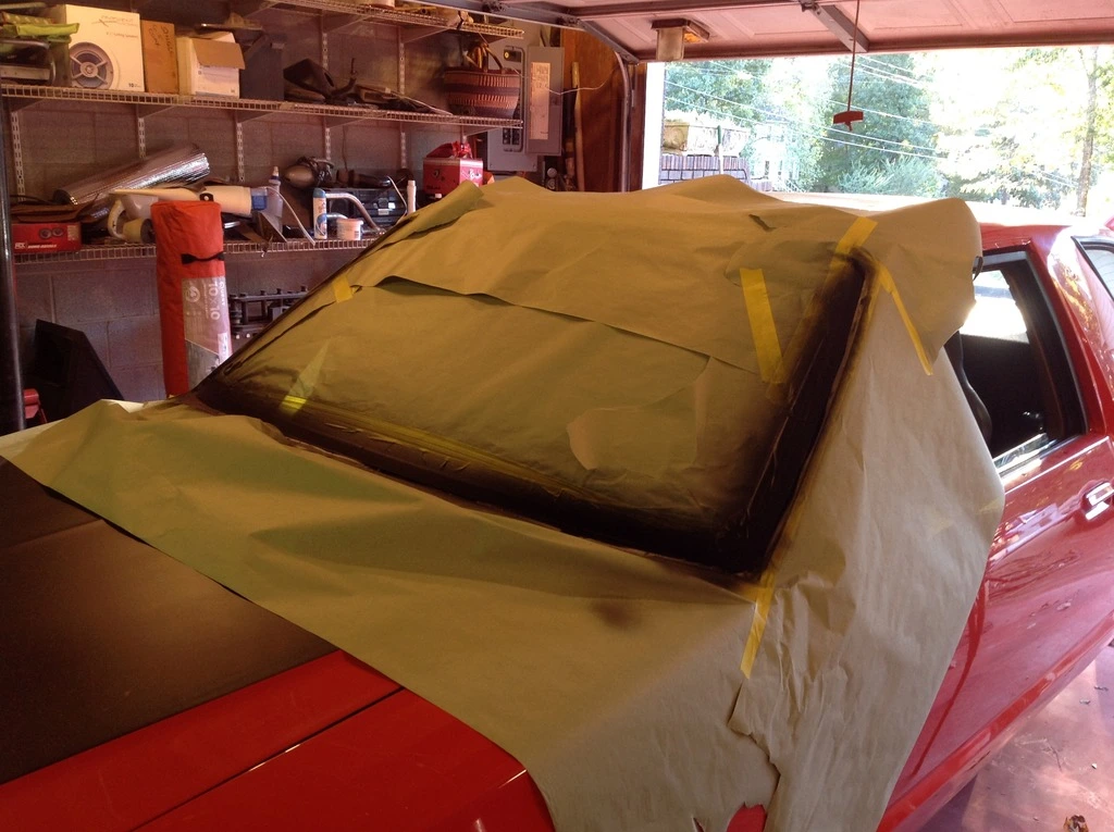

So I decided to scuff the margin, and paint it in.
But,...true to my SOP,...I didn't get it high enough. You'll still be able to look down on it and see that gap. You won't see it from the front, but it'll still be visible depending on where you look at it. Guess that means I'll be doing that twice too.

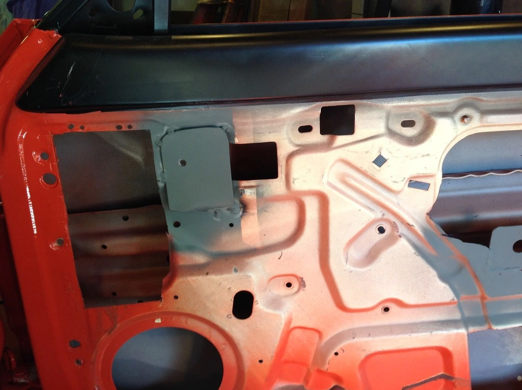

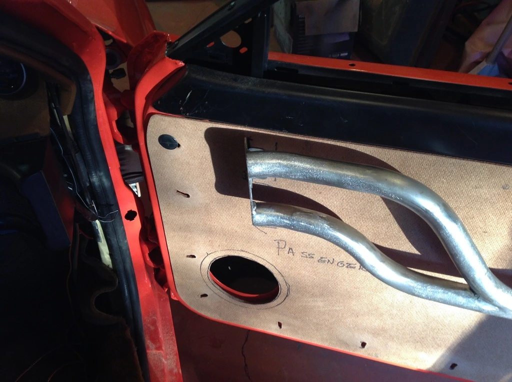

none of the holes were drilled this morning, so that is where I started. Once they were all drilled, I placed the panel in place so that I could locate the two center holes for the door bar. The "L's" on the yellow tape on top are the reference mark for the carpenters square that I used to do that.
Once I had the holes referenced, I made a threaded backer that floats on the door so that the door bar could be adjusted after it was bolted on. I bolted the door bar on, and made another reference mark so that I could locate the front mount.
This little dude is missing from the driver's door. I have a piece of 1" wide stuff that wedges against the door sheet metal and is on the back side of the where the factory door handle used to go.
You can also see that this door is butchered. Originally, I intended to stick that window motor mechanism inside, so this door was cut up to allow for that. That has changed however, so consider it door lightening instead.

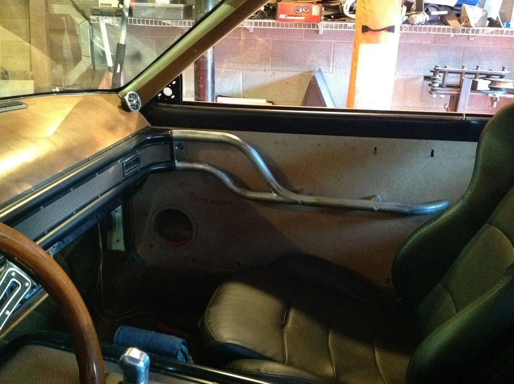

With that thing welded, drilled, and threaded,.I was able to bolt the door bar on again so that I could fabricate the piece of 1/8" plate the will become the cap that butts against the dash bars. (It doesn't butt actually,..there is an 1/8" gap)
And that looks like this when it's installed.
So all that's left to do to check my work is to shut the door....so that's what I did.
And that took the better part of the day to get to this point. There is still a day left on the door bar fabrication alone to build and bend the mesh and the trim pieces that go on that bar. Then It's gotta get smoothed,primed, and painted. (probably another day).
