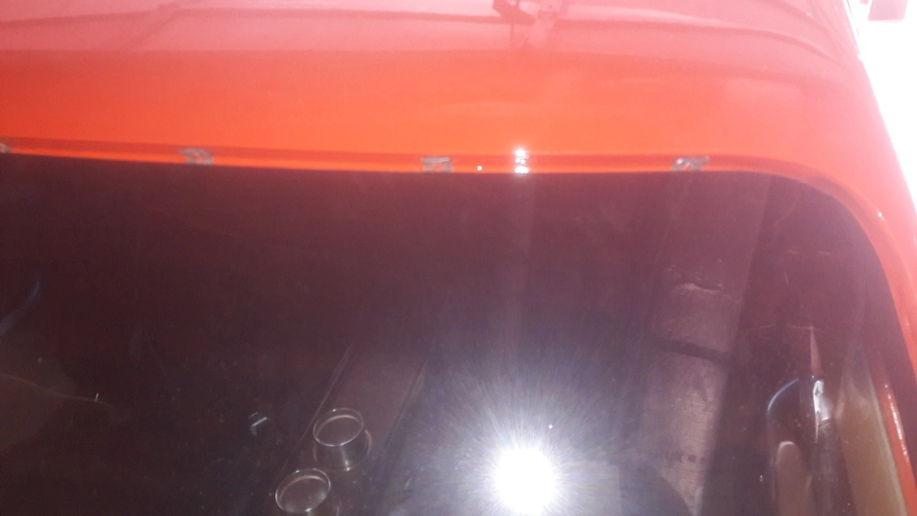

First,.....opened my envelope from Texas,.....(Thanks Allen) and popped the three clips onto the studs in 15 seconds.
I don't know what the difference between the old ones and those new ones are (besides being new) but the old ones only take a small bump and they're on. So now I'm able to fully trim out the front and rear glass.

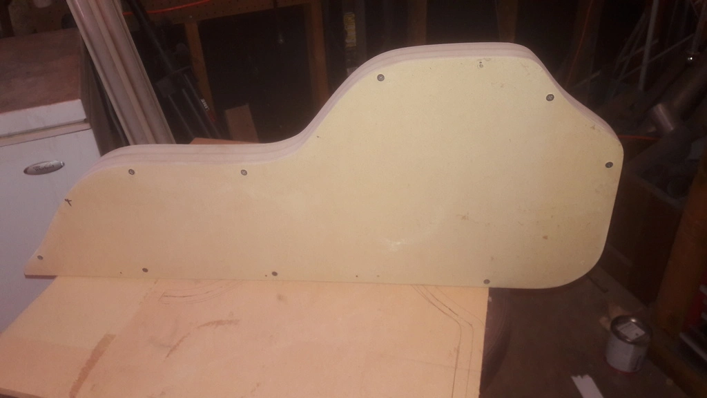

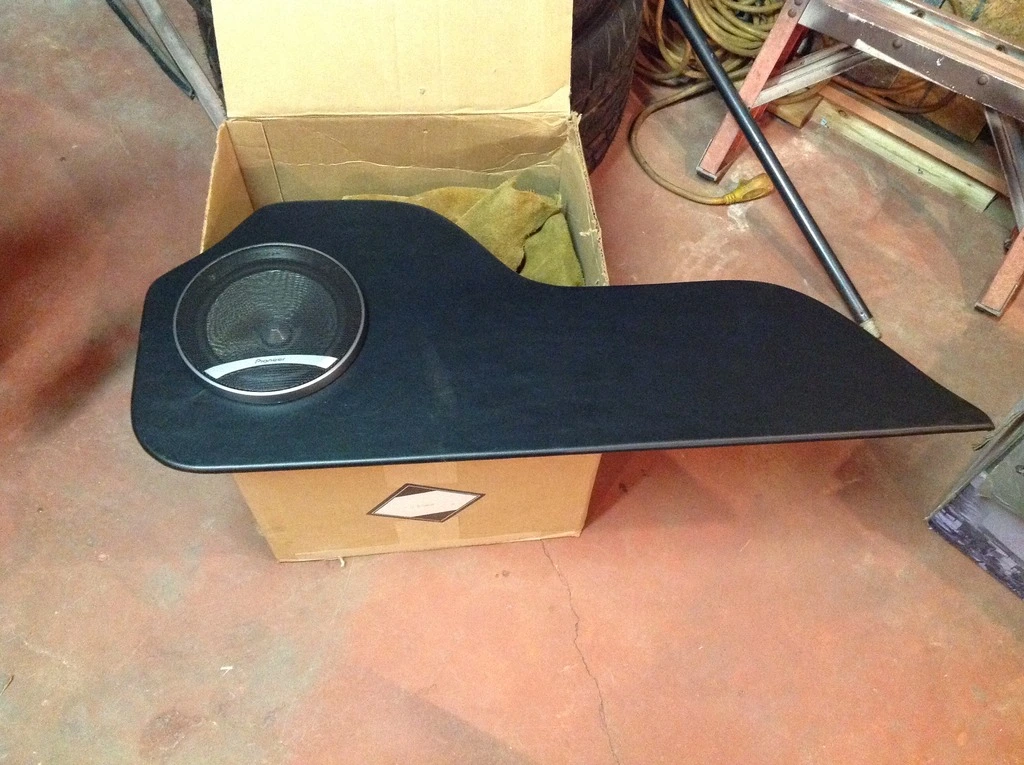

I made the speaker box with the rest of the time before I got to go to Costco and spend 200.00 on food and junk.
But,............ look at this now. (and I just went downstairs to confirm this).
Which side would this go on if you were looking at the remove-able cover?
You damn right.........I glued the "back" on the wrong side. I have effectively made another driver side box.:bang:
So instead of having this behind me,...I still gotta make another "side" and cut the old one off somehow.

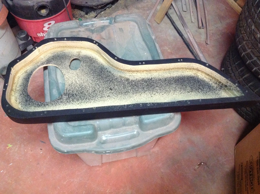

I fixed the backwards speaker box.
The piece that was on the back (that used to be the front) is now inside, and at the bottom. (You can see the 1/4" thick line at the top that used to be a solid piece). The piece fits really tight, and is glued in place. It ain't going nowhere.
I took the top and covered that btch, and mounted the speaker.

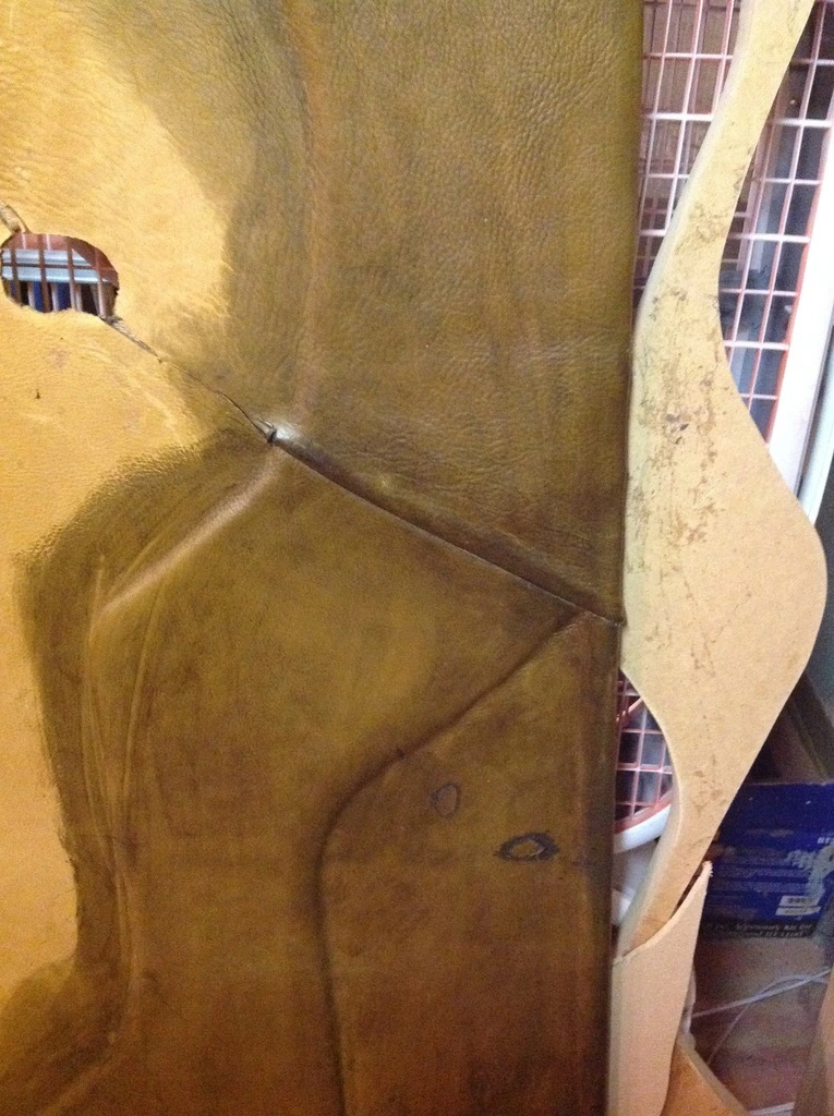

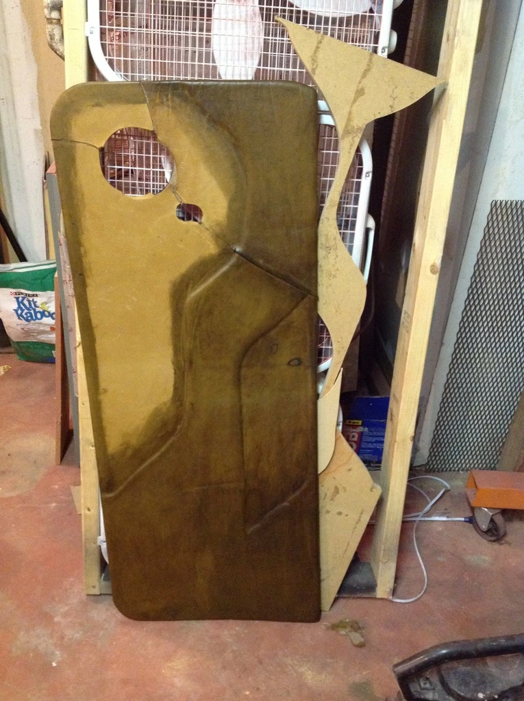

On the driver's door I used some vinyl roof foam to give the door panel some depth. I didn't have enough to do the passenger side. I had to cut and seam the remnants together. And while that in of itself isn't that big a deal,.....
I didn't have enough leather either.
I had to cut and seam it as well.
Now,...before I show you this, remember this is the Monster. The leather is already full of cuts, scrapes, and gouges. So when it comes to having to do a glue seam to "weld" two pieces together,...I don't think it's the end of the world. Had this been any other theme, and I'd be screwed. This "solution" wouldn't fly. But the Monster's like a honey badger........and Honey badgers just dont care.
So consider it before you flame me.
Most of that is gonna be behind the door bar, and the speaker box,..so I guess we'll just have to run with it.

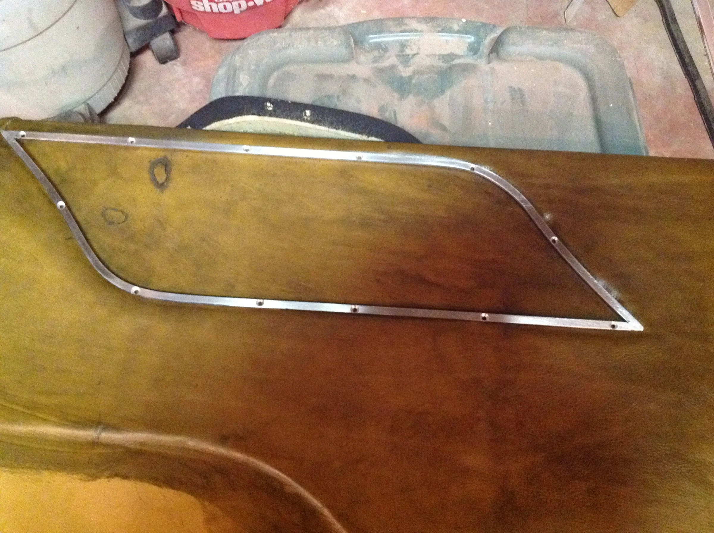

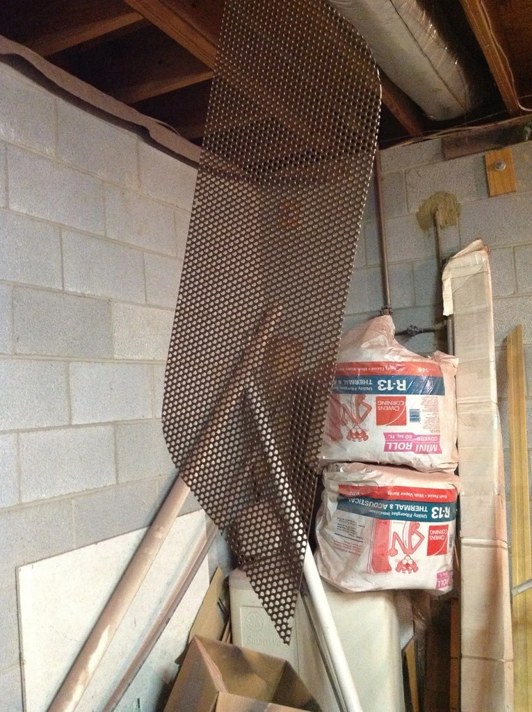

I made the center grille surround and mesh.
I ran out of this stuff too. This is 1/8" hole x 1/8" space stainless. All of the rest that's currently mounted is 3/32 x 3/32".
I have enough to build the front piece that mates the door bar to the dash, and I think that I'll be able to get away with this piece because it's separated from the rest.
