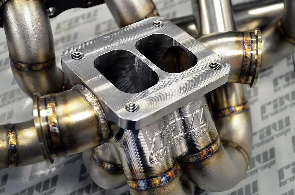

I don't know what twin scroll on a turbo is but if it's anything like twin screw on a supercharger then that means more boost down low aka no lag. :banana::banana: Say it with me.... **WHISTLE...................PPPSSSSSHHHH!!!!!!!!!!!**
In the time it took you to write that you coulda looked it up. Turbo class 101:
One bank of the engine that is on the power stroke is feeding one side while the other bank is getting rid of waste. There is a divided plenum in the turbo that acts like two individual smaller turbo's, with the one bank combined (three cylinders) feeding one half, and the other bank (the other 3) feeding the other half.
