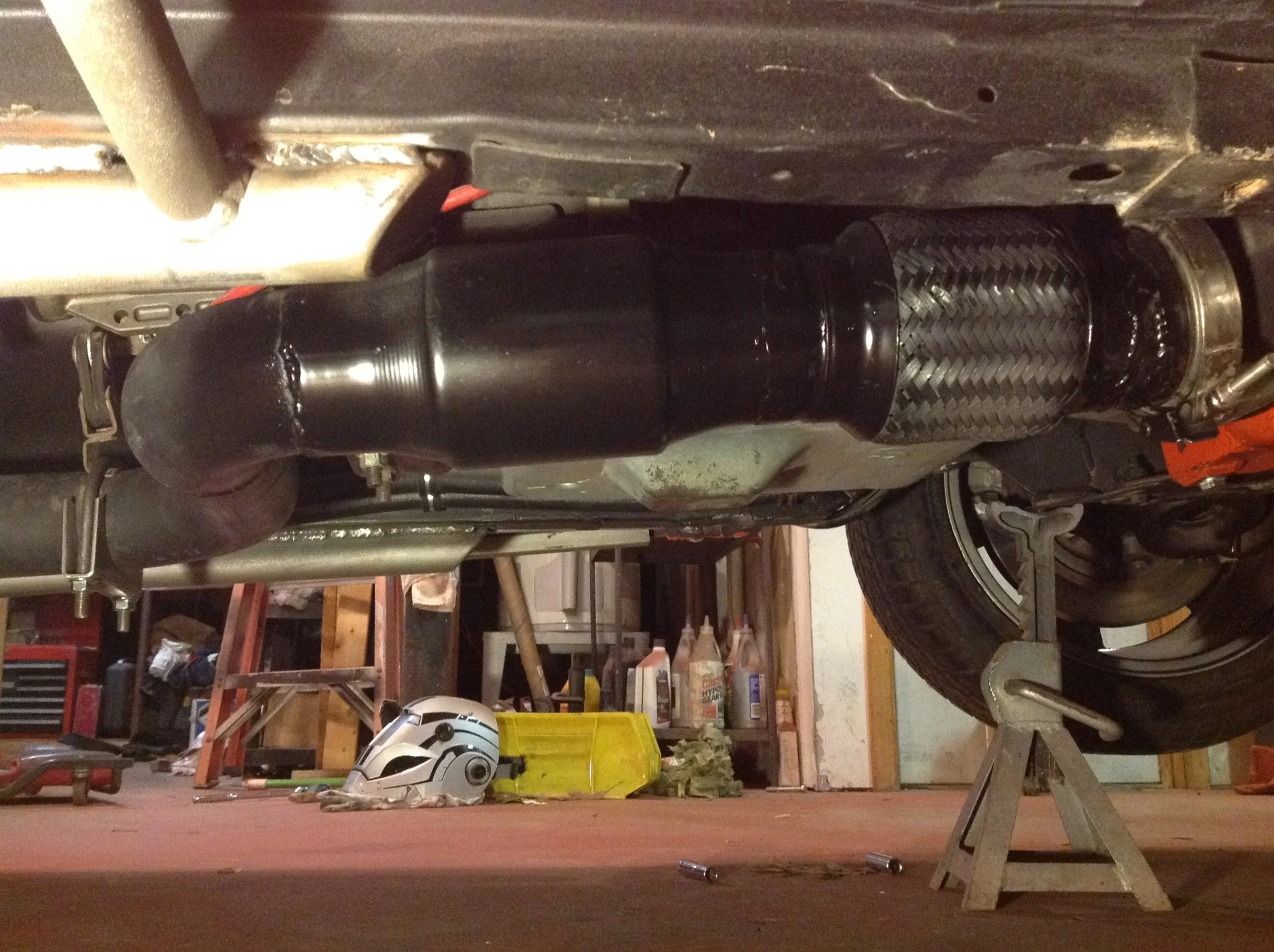

Today I installed the catalytic converter. To be sure I was installing it the right way (since there wasn't any reference for which direction it was supposed go,) I called Flowmaster.
"Install it with the arrow oriented in the direction of flow" Dude says..
"There isn't any arrow on it" I tell him. " It just says Flowmaster on it, and when you look in the end,..one end says WUP" I added.
The guy says "Install it so flowmaster goes from front to back w/ the f up front."
Uhhhh,.......OK...:shrug:
So,....here's where I start..
I wanted to keep that flex coupler in use, so the addition of the CC was a little more involved than just slipping it onto the exhaust pipe and welding it in in place. I only had 15" before the first bend, and both the flex coupler and the converter measured 10.5" long.......respectively.
Nothing that can't be changed w/ a cutoff wheel.

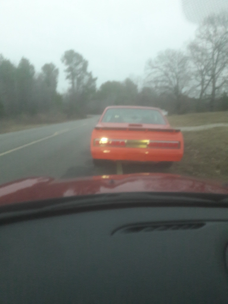

I start walking w/ my computer under my arm.
I get a half block away, and a guy picks me up. Takes me to the house. I call Steve,...He's not sure what has happened. I call a tow truck. I got 30-45 minutes to wait.....it's gonna cost me 70 bucks to get the monster home.
I get in the Mini, and go back to wait for the tow truck.

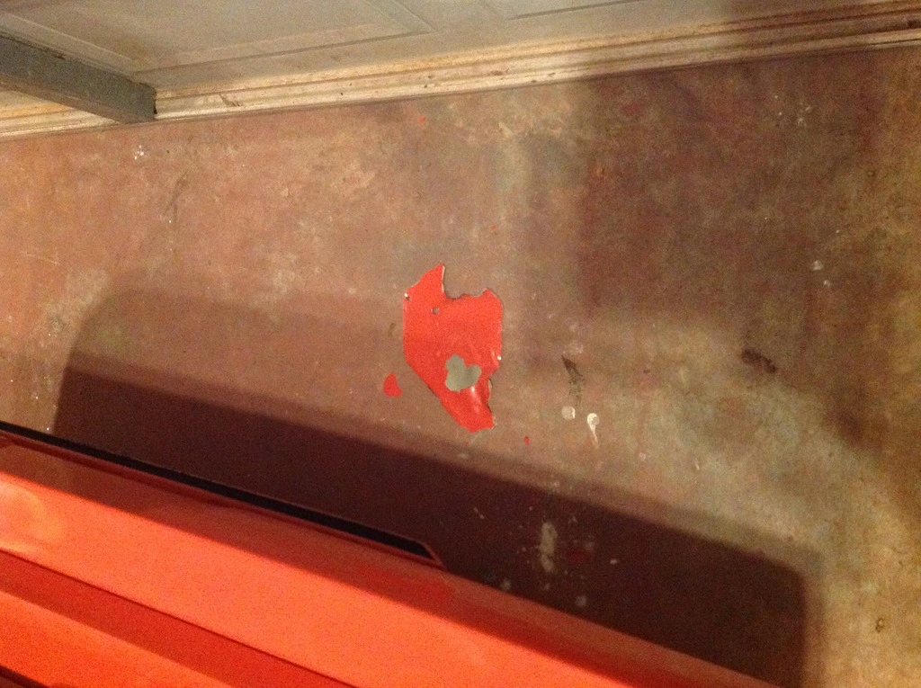

Plastic trim is cracked from being pushed and pulled on to move the car. Blacked out trim is flaking and scratched from the same.
When laying on the ground to help dude find an anchor point for his chain, I grab a giant honking piece of separated body putty covered in orange paint that is now hanging from the tail pipe.
This is giant piece #2.

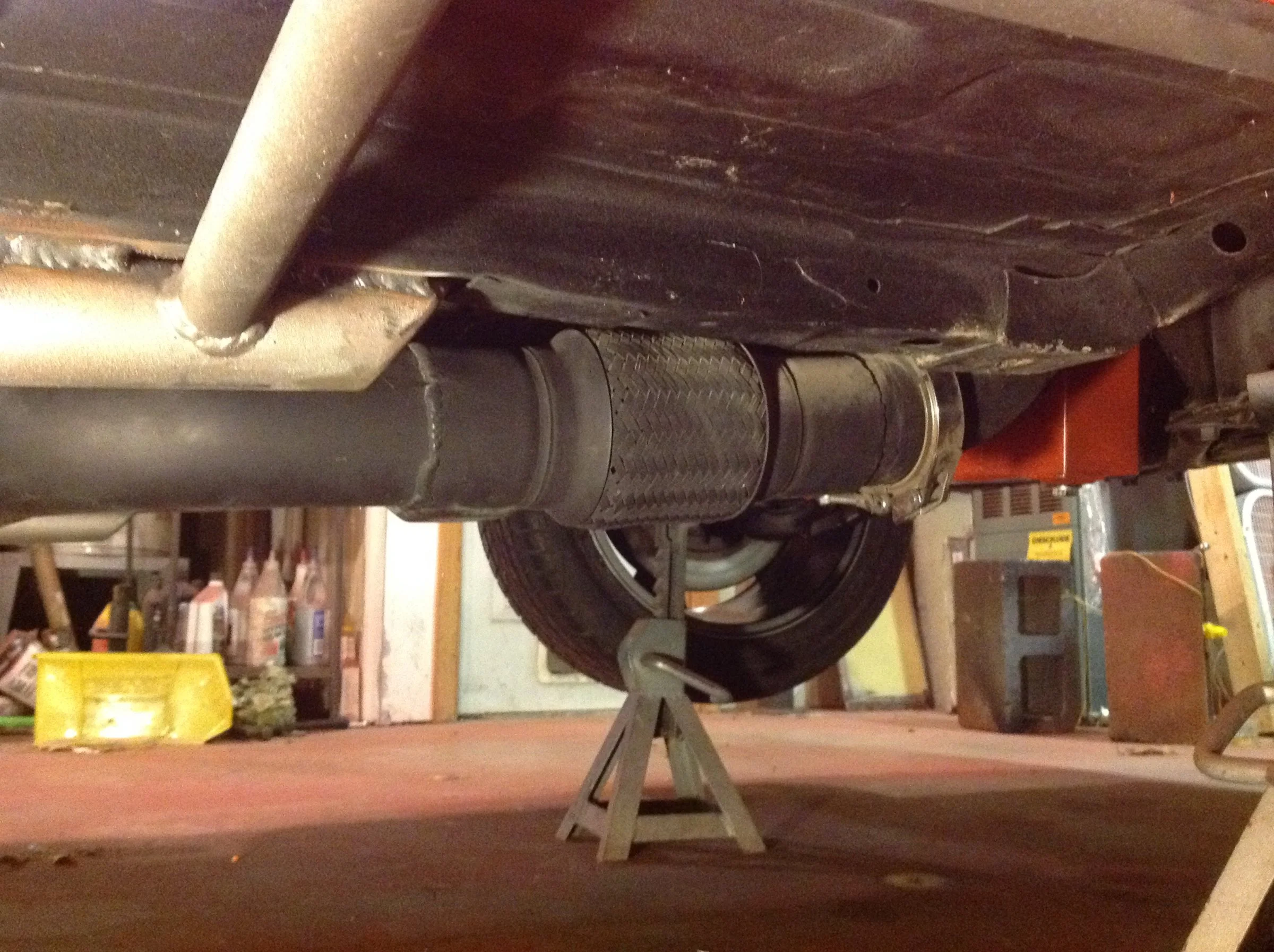

I just didn't think that tail pipe would get as hot as it does,..but clearly it does. the paint is all bubbly, and where there was body filler used to flatten the bottom of the thing has completely delaminated.
It's a complete do over in high temp black paint. w/o the benefit of any body filler to smooth the thing out....:nonono:
