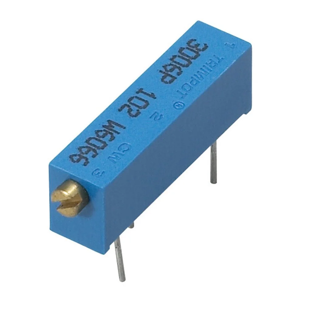

I knew that you'd be there w/ the answer. Great information as usual. Thanks.A handful of 50 cent resistors from Radio Shack and some jumper wires with alligator clips is the answer to checking your fuel gauge problems. The closest standard value to 70 ohms is 68 ohms.
Or if you want to do it the neat and easy way, here is a suggestion:
RadioShack 1K-Ohm 15-Turn PC-Mount Cermet Potentiometer/Trimmer - Catalog #: 2710342, cost $3.49. This option will get you from 1000-10 ohms with the twist of a small screwdriver.
