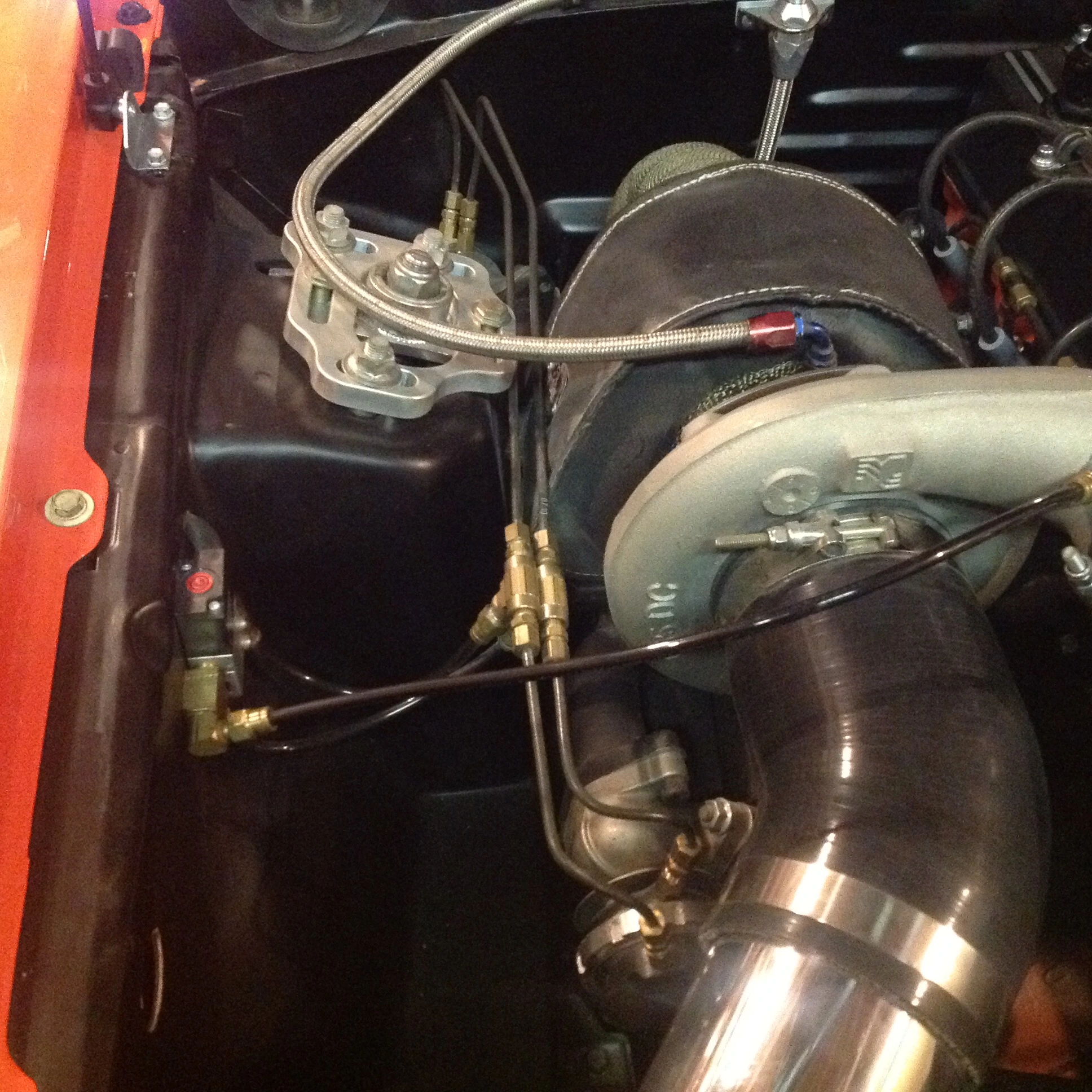

He thinks (for today) I should remove the line that goes to the dome so that pressure can escape to atmosphere ( just in case it isn't) otherwise, there's trapped air on top of the diaphragm that won't let the spring open at 5 p.s.i. He said that a crappy chamber like mine has will not be a factor that tuning can't deal with,..so yea.

Getting mikes mini washed at a car wash right now, as we are still restricted from water usage at the residence due to the drought. When that's done, I'll get what remains of my hair cut,...then eat, and remove those two lines from the wg's and see if this damn thing will stay at 5p.s.i.
