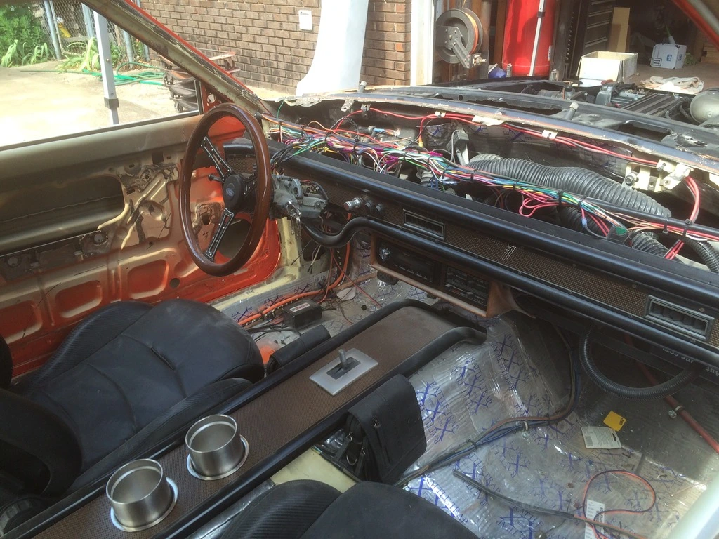

#1. I have a bad light switch. At least I think that's what it is. It is the switch that came in the Ron Francis kit is all I can say about it,...One minute you got lights,..the next second, you don't. Push it back in and pull it back out a few times, and the lights might work, or they might not.

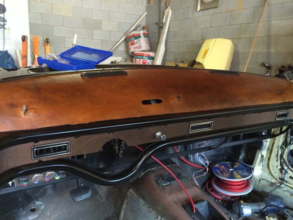

So I gotta pull the dash partially apart to get to that freakin light switch. I'll start w/ the minimum access option first before I end up having to go to the extreme route of removing the dash top. I'm hoping that I can just remove the trim pieces that sandwich the grille mesh, remove that grille mesh, and hopefully have enough wire slack to get at that freakin switch from the front.
Like I said,..If I can get this mesh to pull forward enough to expose the whole switch top,...I'll be OK.

It's got to be the switch or a ground, not much else should cause your problem i would think. Then again, you have a whole new harness, so you're out of my league.

Do you have a wiring diagram of the Ron Francis wiring harness that you can post? Yes/ No
Do the lights licker when you hit a bump? Yes/ No
Can you check the power feed going to the lights and see if it is losing power? Yes/No
Is anything else doing strange things when the lights quit working, or is it just the lights? Yes/No
Can you do a wiggle test of the wire connection going to and from the light switch? Yes/No
Is it all the lights or just the headlights or parking lights? Yes/No
@madmike1157
First step...
Make a peace offering with you wife so the you can avoid the angry vibes that might be a distraction...
Take her out to dinner or buy her something small and shiny that she has been drooling over...It doesn't have to be expensive if you shop carefully.
You are going to need all the peace you can get.
Do the lights flicker when you hit a bump? Yes/ No They randomly flicker sitting still. Pulling the switch will sometimes get the lights to stay on, but they'll just as quickly start flickering w/o any provocation.
Can you check the power feed going to the lights and see if it is losing power? Yes/No Not w/o removing the dash top.
Is anything else doing strange things when the lights quit working, or is it just the lights? Yes/No Other than p ssing me off?...
Can you do a wiggle test of the wire connection going to and from the light switch? Yes/No Not w/o removing the dash top.
Haven't checked the tails,..but the headlights and parking lights go out at the same time.
