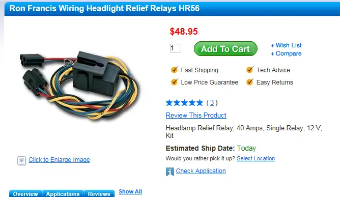

And on that note.... called the tech at Ron Francis. He asked if I installed their headlight relief relay when I wired it. I cannot say that I did.
He said that the symptoms as I describe them are exactly what I'd expect to happen when 4 halogen headlights are activated as a result of me pulling the switch in the circuit. Says the circuit breaker is tripping.I believe him.
He says I need this:
It's just a 40 amp relay, but it's obviously prewired w/ dongles, and it has the necessary instructions to tie it into the circuit. It goes between the switch output and the dimmer switch. But it is 50 bucks for a relay.
And I do have to take the whole dash top off to tie that relay in.

Why not just wire battery power to a relay by the core support....then the switch would cut the marker lights on ( as normal ) but when the headlight wire gets power it trips a relay. That would take the load of the four hologens off the switch and circuit breaker.....fixing your problem.
Its a simple relay, battery fused power, ground, trigger, and output to lights.

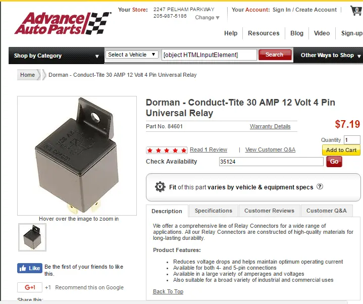

You can probably go to the pull a part and find a van or jeep with a little metal bracket that holds 2 or 3 relays, plus the relays, plus a few feet of wire for something like $9.31 and wire it up yourself. WHEN I ever get to my rewiring project I am going to relays for the headlights.
Let me think about that now Droop,.......:thinking:....Me,.....grubbing around in a JY for (2) 4 pin relays...:thinking:............ For.... What was it?......$9.31?o_O
Or,.........Going to Advance........and just buying them both off the hook for 15 bucks.

;)Thanks,.....,...I intend to install the relays,...(I'm positive that the panel already had one integrated into it), but evidently,..the halogens may draw more than the relay is rated for..
See.......^^^^^ they're already there.^^^^
Give me a minute....
Where'd I put that thing?............oh yeah!!.....Here it is.
:nono::nono::nono::nono::nono::nono::nono::nono::nono::nono::nono::nono::nono::nono::nono::nono::nono::nono::nono::nono::nono::nono::nono::nono::nono::nono::nono::nono::nono::nono::nono::nono::nono::nono::nono::nono:
Dorman? Really? It'll last shorter than the trip to the jy to get one off a minivan.
You could at least use your new found Amazon prowess and buy one there...preferably one with either a resistor or diode.

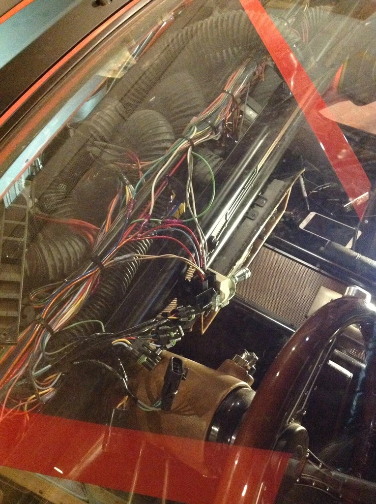

I go downstairs about an 90 minutes ago trying to figure out my flickering lights. The wife is away in DC participating in the 3 woman march tomorrow, so that leaves me alone tonight.
So what better opportunity would I have to figure it out then?
I remove Winkin (the gauge pod) and through a small hole on top of the switch stick my fingers on top of the wiring going into the switch and wiggle the wires....I'm able to make the lights flicker.
Perfect,...I gotta remove the rest of the dash now.
The dash top is is a btch to get off. Now that there is all of that junk under there I cannot see the three bolts that hold the dash top on. So,...I send in the marines to get to the bolts..
After that the dash is off in about an hour, fully exposing the top of the light switch. I stick my fingers back on the wires in an attempt to duplicate the flicker, and fix the loose connection, only now the thing wont flicker. I remove the whole switch from the dash....and try as I may..that freakin switch will not break contact... so I give up,..come back here and write...
Now what? There is just no freakin way that this short isn't in that switch. No freakin way that I was touching a wire and simultaneously the actual short is somewhere else?
