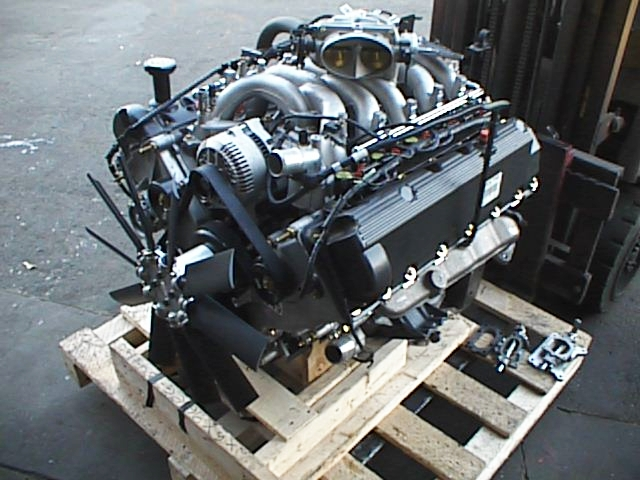

What is that? 5.4 or 6.2?
Ahhhhhhh, but you were considering it, huh?I just looked at the specs, and I like it...but it requires too much fabbing to be a candidate for me.
Firstly, only one year was the "good one". It has to come from a 2010 Super Duty pickup. That'll get you 362 HP, and 457 ft lb torque.
But it don't like to spin......5200 RPM is redline.
Secondly, it uses the Modular bellhousing.....My trans fits SBF.
Next,.....I aint changing the ECU,.....I don't know what will be required to control the ignition.
Then,...From what I read, the cooling system is pressurized......cold.
Lastly,...The engine control unit has some weird BS that shuts off half of the engine if it gets too hot...
That all boils down to a pass for me.....
