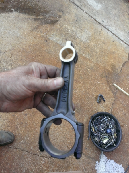

Low tension ring set?So where's all the blow-by coming from?
I think I have a hole in the rod big end that's purposed to oil the pin.Question: do the connecting rods have an oil passage to pass oil up to the piston pin?
The reason I ask is because the latest generation of DOHC V8 Ford engines use a pressurized oil stream to lube the piston pin. Along with that, there is a small hole drilled in the piston pin end of the rod to squirt oil onto the underside of the piston. This is used to cool the piston and reducing detonation. Maybe that could work for you...
