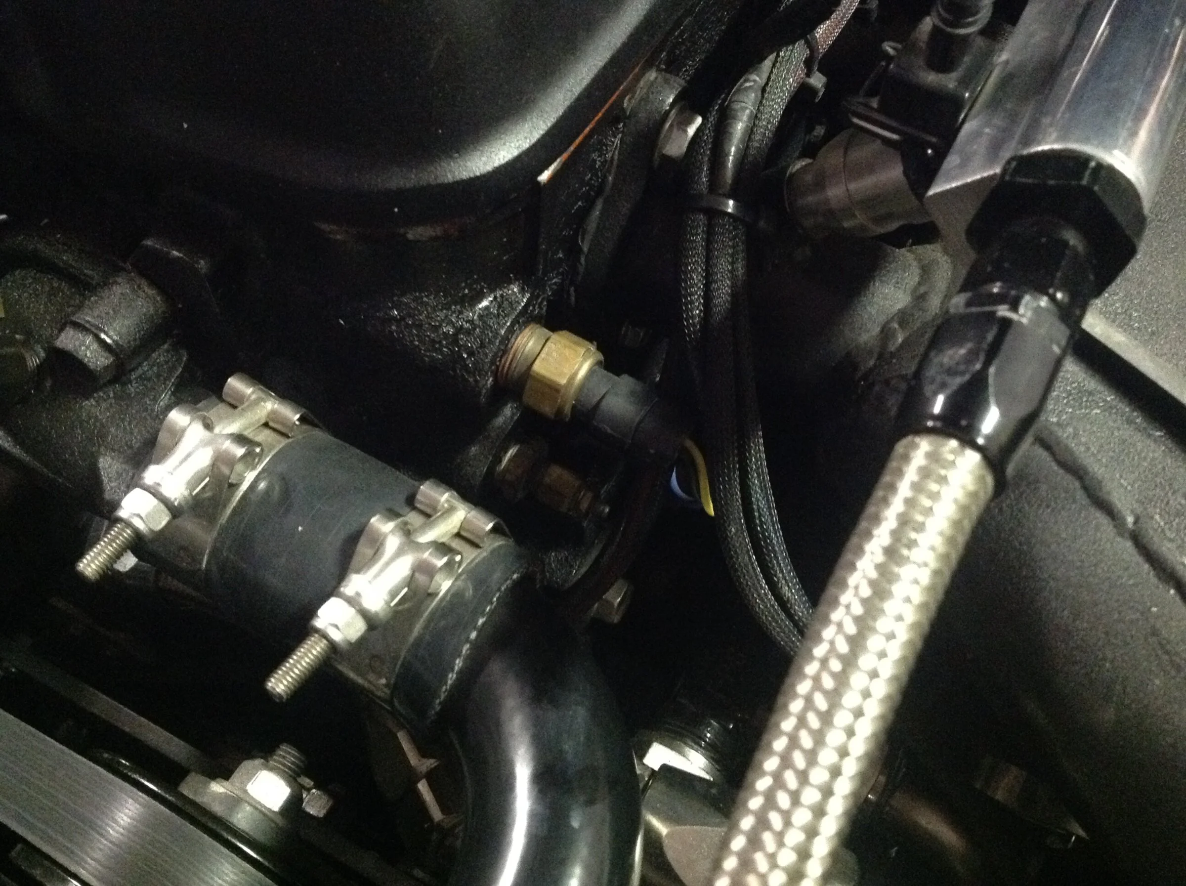

See,....the ECU has its sender mounted directly above the the gauge sender.....It's like this:
It's dark, but you can see that sender sitting about 2" below the other.
Shouldn't make that much of a difference though you'd think.......Right?

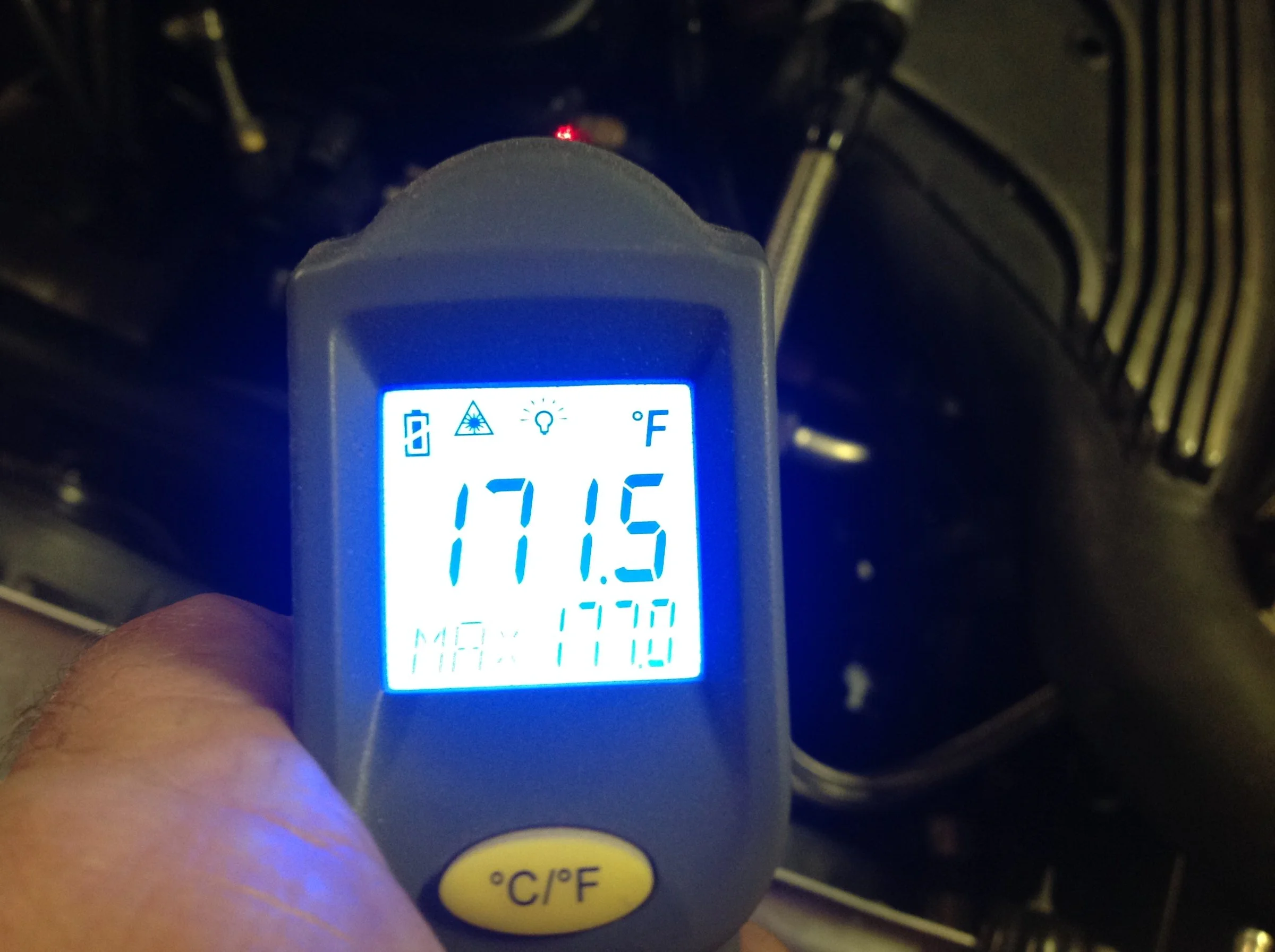

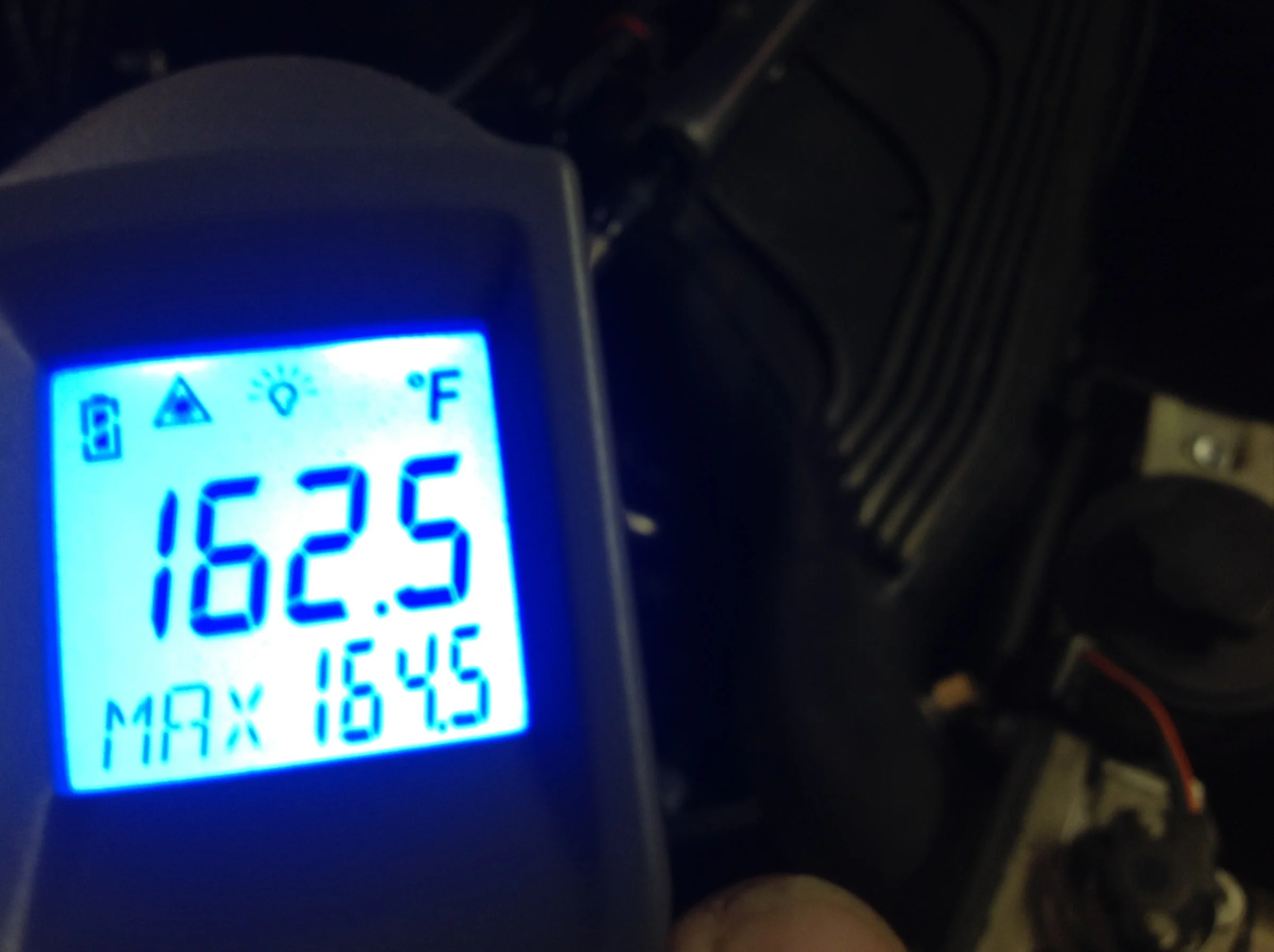

Let's just check shall we?
Top sender:......
Bottom sender:...
Can you freakin believe that?...All this time, I'm blaming my junk POS digital gauges,...and here it is...the higher up on the head,...the hotter it gets...Looks like I'm gonna have to block off the one,...and install a "T" so that both senders are tapped into the same high point...
Live and learn.

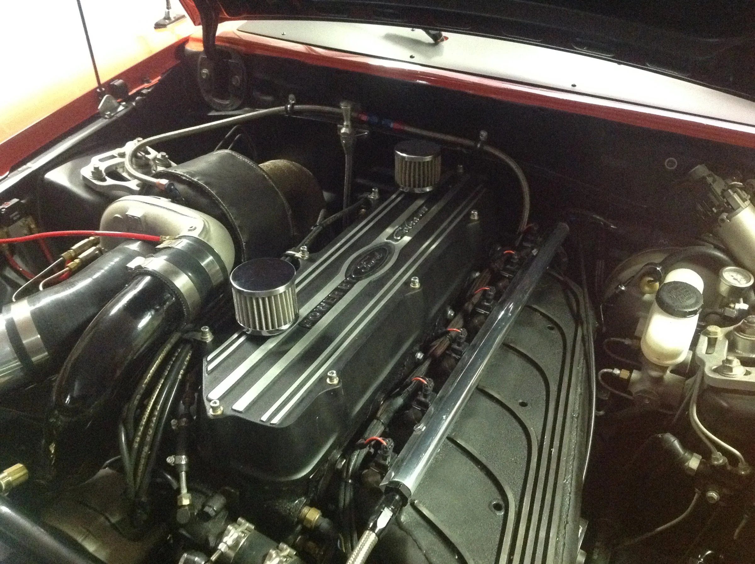

I decided to get rid of my HD oil catch can, and install a second oil breather instead...I built a baffle to try and keep the wet oil in the engine, and out of the breather as well. Additionally the base of these breathers are tapered so that they'll drain back, so any oil that does get past, should drain back...
But once the engine gets up to 190 somethin....these dudes are smokin like a train....Just what the Doctor ordered to impress the kiddies at the Saturday night cruise-in.....
The car still rattles, when you floor it in high gear,...and today for the first time I believe that I caught a glimpse of a significant blue cloud in the rear view when I floored it...
So now, I got smoke coming out from both ends....Perfect.
