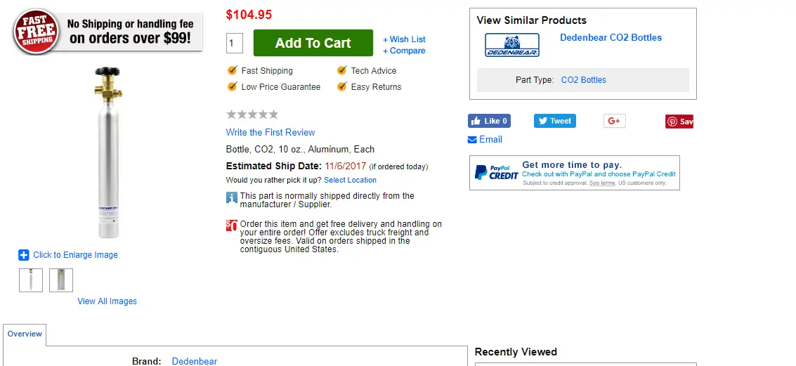

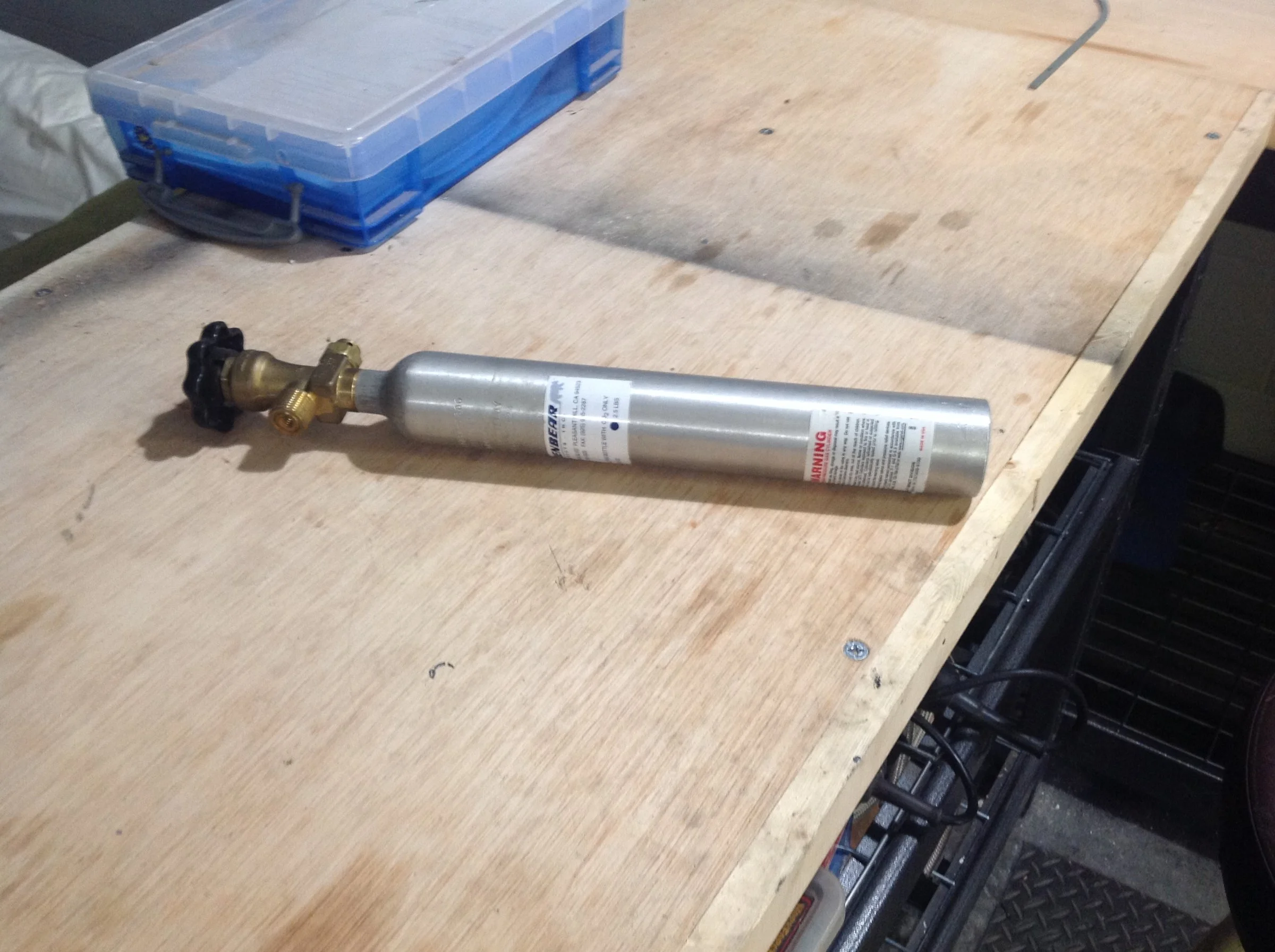

See this thing?
Its a Co2 bottle. Intended for all kinds of pressure activated crap on your average drag car. Stuff like shifters, throttle stops, and just about anything you can think of that could benefit from a shot of high pressure compressed air.
I have two of them. I used them on my orange and black 86 drag car to apply pressure to the dome of my wastegate to allow for sequential increasing boost control back in the days when it was not as easy as it is today. ( That'd be like 2006, when I thought I was gonna be a big time X275 drag radial HU racer):rolleyes:

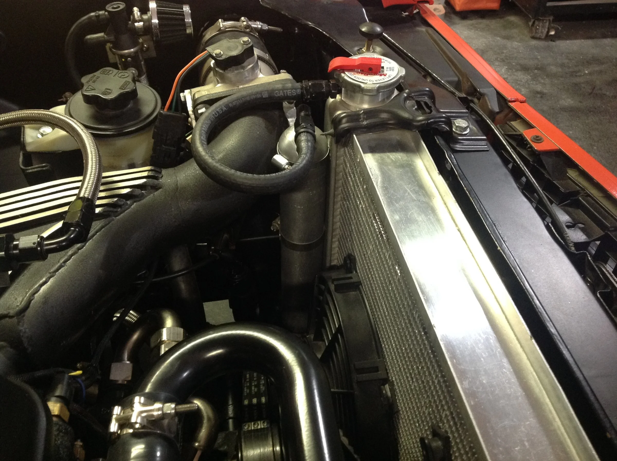

Last night when I went to the cruise in, I opened my hood when I got there only to find that antifreeze had shot all over the engine. Now that I have the engine getting hot, sometimes there is a temp spike (temp goes to like 220 for a few seconds)
Evidently,...one of my temp spikes got my radiator cap all hot and bothered, and it blew a load of green Jiz all over my intake manifold.
No,....I did not have a catch can... AND No, I didn't even have as much as a piece of rubber hose diverting that possible eruption to the ground.
So I had green jiz on my engine istead.
This morning, I decided to correct that. To fix that meant that I needed a long skinny aluminum bottle.
Something like this:
These things have been banging around in one of my spare tool box drawers for over 10 years now,...it's time I put one of them to good use.
I had to cut the top off, (it was too tall), tap the hole for pipe thread, and drill a drain hole, and a small vent hole on top to allow the thing to accept the overflow should it happen.
Now the bottle looks like this:

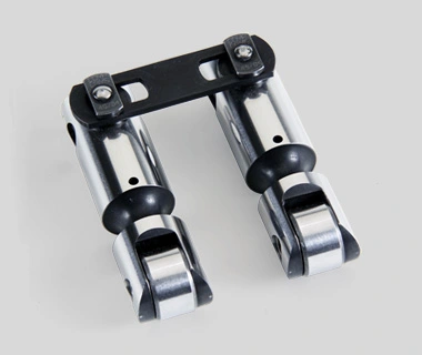

Changing this over to a hydraulic roller, requires that I also come up w/a re-link-able set of link bar lifters that are currently in the engine. I have Comp Cams working on that now too. The lifters currently in the engine are Comp BBF lifters..
I can just turn them sideways to un link them from each other. Those vertical slotted fasteners are only held on by an Allen headed screw that has been loctited, and peened over on its end to keep it from coming apart. I had to remove one of them when I put the thing together because I could not get one set of lifters to swing out far enough sideways to unlink the bar on one end.
So there's a lock-nutted screw holding one of them together presently.
I asked dude at Comp if they could just sell me a partially finished set of hydraulic lifters w/o the link bars attached, and I'd use the existing link bar set off of my solid versions, and convert the hydraulic set over to this style...
He's checking if they can/will do that, and if both the Endure-x solid and Pro-Magnum hydraulic lifter will allow me to do that if they will.

Spoke with all parties that would be involved. The lifters are a potential problem. Nobody makes a lifter to give me what I need w/o custom dollars entering the picture. But,....I can have the existing solid roller ramps ground less aggressively, and that would significantly reduce my noise issue while still allowing me to keep the existing solid valvetrain. I’d be able to change the valve springs to lessen the spring pressure as a result, and get some potential durability too. I may even be able to get a better cam profile to take better advantage of the turbo to top it all off.
So,....springs, a regrind, and a head gasket,..and a bunch of labor on my part....less than half of what I originally expected.
