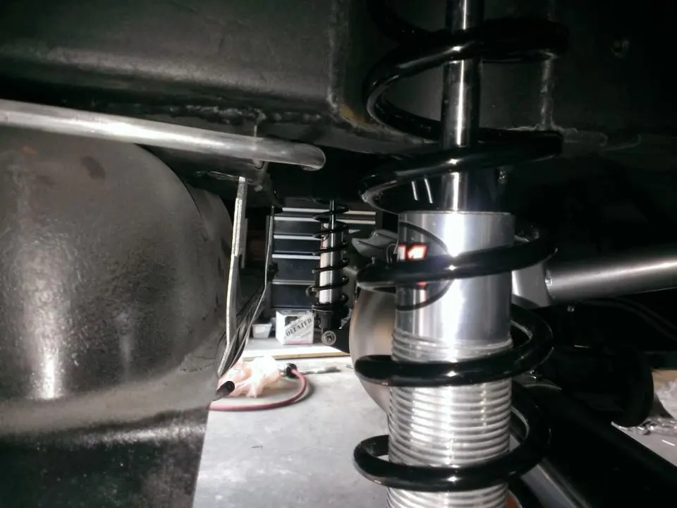

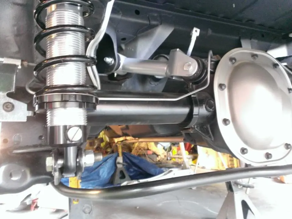

Finally got the rear end off the floor, and hung. Permanently. Assembled the QA-1's, cranked em' up an inch, turned the knob 4 clicks, done. Opened up the box that the UPR C/A's have been in and bolted them in place.

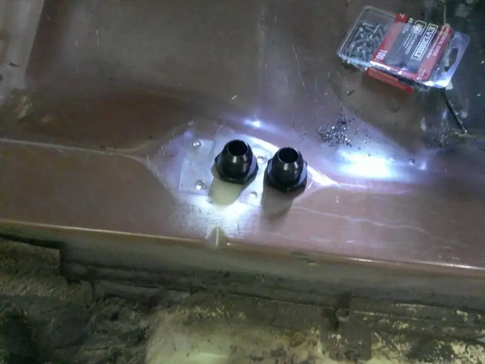

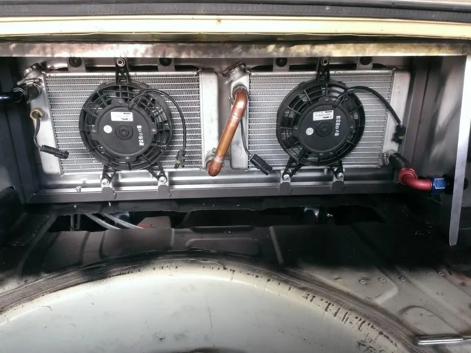

I came to a decision on how I was gonna get the water from the radiators to the intercooler.
It ended up costing me another 200.00 in hoses, and AN fittings,...but what the hell.
Since the first plan involved using rigid copper, I made use of some of it and made the bridge to connect the inlet of the one rad to the outlet of the other. Water will enter the circuit at the red/blue end, and leave at the black end. I gotta decide whether I want to pump the water through the radiators first, or push the water to the intercooler after it comes out of the radiator. (and in effect, suck water through the radiators from the reservoir.) It probably wont matter one damn bit where I put the pump, I just didn't know if pushing it through the rads first will cause a flow restriction.
It's gonna come and go through the floor under what used to be my back seat. Now it's just gonna be a dummy box back there to provide clearance for all of the junk to run.
I also made a cover to cover the cowl panel. Presently the glue I used to bond the metal cover to the warped, cracked, and broken urethane junker that used to be there is setting up. Since the AC system I'm using is an aftermarket piece, and it gets it's air from the cabin, so I can seal off the fresh air duct the cowl used to feed.

The car has been sitting on four jack stands at the outer most edges of the frame rails. After hanging the rear today,..I was sealing up the gaps on my airbox that the rear radiators are housed in. That process was proving to be a pain in my ass, as the trunk is so deep, it was just too much of a reach to get the caulk gun where I needed it.
So I thought I'd just crawl into the trunk to get a better angle.
I put my knee on the rear bumper, and just start to apply my weight, and the front end of the car starts to come up. With the weight of the now hanging rear behind the rear most jack stands the added weight of me pressing on the bumper was all it needed to rise up.
And it really, really rose.
By the time I realized what was happening, and got off that back bumper, the front end was 2' high. Now that I was off it it was coming back down. I panicked, and tried to press down on the rear bumper, so that I could help ease the front end back down, but it was coming down too fast to stop it.
I was expecting it to have somehow shifted, and that it was going to miss the front jack stands enough to cause the whole freakin thing to come off, and end up on the floor...but it didn't. It just hits the jackstands w/ a loud bang.
All Over and done before I could whack out.

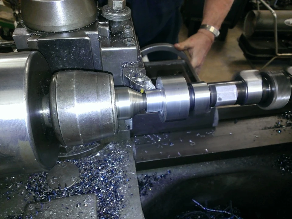

madmike1157 said:
Today was a "Mike has to see his machinist buddy to get things done" day.
The list of things I need the "special talents" of my machinist for are as follows:
1. Machine the nose of the cam, turning it down from the worthless stock 250 cam gear size, down to SBF size, and then drill the face of the front journal to acommodate the dowel pin.
(Lets discuss this for a minute shall we)
Anybody that knows anything about billet roller cams knows that one of the processes they all go through is a final heat treating to harden all the lobes and journal surfaces. That heat treat makes the camshaft extremely durable, hard as a diamond, and basically is one of the things in an engine that doesn't wear out because of that.
It also makes it impossible to machine.
Had I known at the time of building the cam that there wasn't a decent gear set available, and I was gonna have to make a SBF gear fit,..I just woulda had the cam grinder modify the cam before the heat treating in the beginning. Unfortunately, I just assumed that you could get a decent gear set for just about any engine.
I chose,.................poorly.
Fortunately for me however, The Australian cam grinder I used used a different heat treating process called induction hardening,...that only hardens the lobe and journal surfaces to bearing race hardness,....all the rest of the cam is pretty much just north of standard hardness.
That nose turned down like butter.
Now the dowel pin,..........that was a different story.
Because the 250 journal diameter is much smaller than a SBF, drilling that 5/16" dowel pin got real close (w/i .250) to the journal surface of the first journal. The further away from center, the harder that damn cam got. the initial 1/8 pilot hole drilled easily enough, but the 3/16" bit was starting to complain, the 1/4" bit would actually snap and chatter,..and the 5/16" bit actually walked in the hole,..preferring to drill the softer metal towards the center, as opposed to the kryptonite at the outer edge.
The hole ended up being unusable.
So plan B was to keep the hole smaller, and closer to the center,...so we drilled two 1/4" holes at 90* perpendicular to the now mangulated hole.
That worked. but the cam took the better part of an afternoon, and shot the day.
Moving on,...back to the list:
2. Cut the crank keyway deeper to the front of the crank journal.
3. Mill the mating surface of my exhaust manifold ( Medusa) as it had crowned slightly from welding.
4. Open the center of my 36-1 crank trigger wheel to pilot over the hub on my SBF harmonic balancer.
5. Make three aluminum plugs to replace three of the five freeze plugs so that I can re-direct the water from the pump into the side of the engine, as opposed to the front. I'll drill and tap these three plugs 3/4 NPT, and block the front WP hole. I'll build a manifold to distribute the water after I figure out how I'm gonna get it there.
6. Build 4 spacers to properly space my rear calipers off of my $200.00 Cobra caliper brackets.
After all of that is done,....I'll be able to mock up the crank, and the cam,...and see if the custom roller chain I had to find ( That comes as a replacement for no Ford product) will fit my Ford product.
THAT, will be the next hurdle to jump.

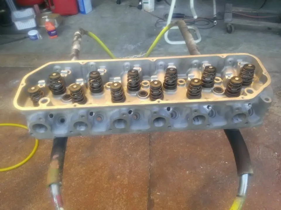

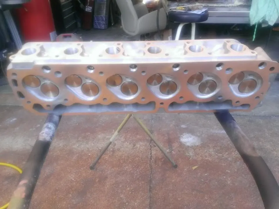

I Picked up the head today, commensurately completing my initial decision to invest in the ordeal involved to build an inline six cylinder.
The total machine bill came to 812.00 there, plus the 125.00 at another shop to get the recip assy balanced. The odd-N-ends that require the services of a "job shop" machinist adds about another 250.00 to that bottom line. Total to make a 6 cylinder in a Fox body keep up with a stock Terminator.........about 5k.
(Hell, If this thing makes the power people are telling me it'll make,..that Termi better pile on the mods)
Those are BBC beehive springs holding my weenie 1.8/1.5 valves in the head. The holes on top of the exhaust ports are where I drilled and tapped additional water circulation holes, given that I had to block so many on the deck side.
The six holes at the top of the pic that appear to be tapped for plugs are in fact, tapped for plugs. The bottom three lowest holes, plus the two slots at the rear are the only way water from the block would've been able to get into the head. Now that I've drilled and tapped my little "high air pocket escape" runners, and given that there was an unused 3/4 plug at the back of the head that I'm gonna use, I'm confident that I'll be OK.
Now I gotta tackle the valve cover. For months now, I've been PM'ing Australian ASSHOLES to help me find one of the stock cast covers Ford made for the head,...to no avail.
I guess like all of rest of the engine, one more custom, one off, hand made item is in the cards.
